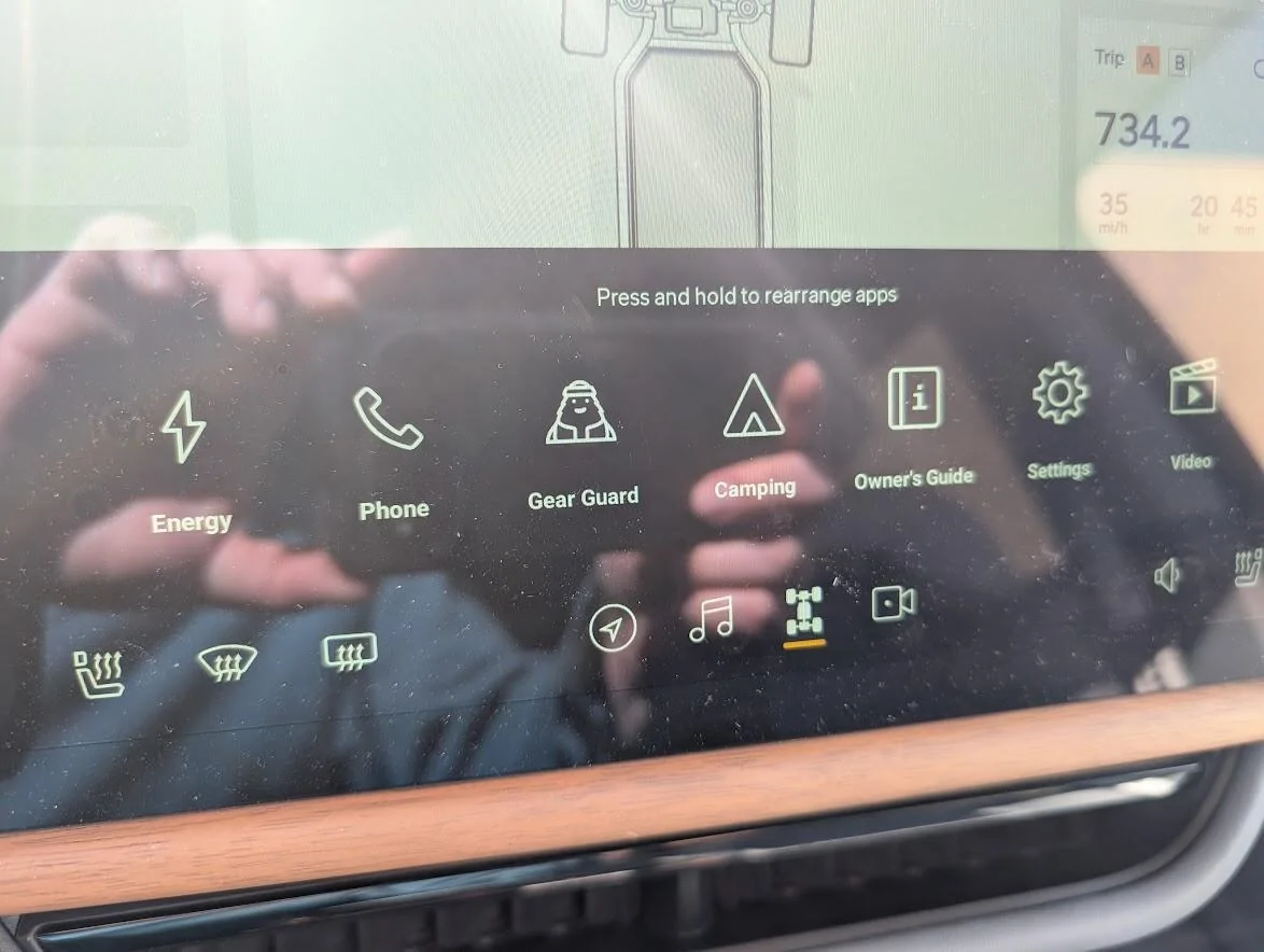

swipe up from the tray for the missing icons.
133
11,942
23,861

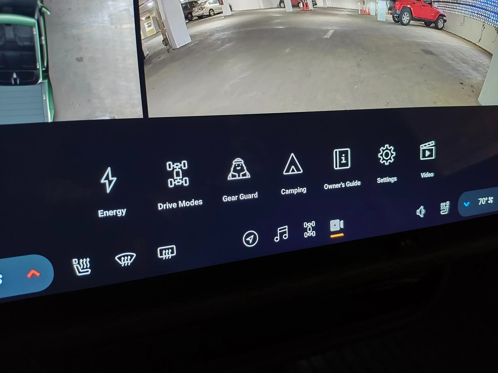

That was the first thing that I did, alas I no longer have a Phone icon! Do you? Do others?
I sure do still have it. What happens if you go into one of the other upper tray items? I know there was a bug a while back where the last used icon sometimes went missing.

Is Bluetooth on? Is your phone paired with Bluetooth? And do you allow it access to your contacts? You may need to cycle all of those settings.
Bluetooth was on (for the both the truck and the phone), and the phone was paired. None of the icons were incorrectly mapped to the phone. It has been this way since I installed 10.30 on 4/9. A soft reset had no affect on things.
However, this morning I did the hard reset and it restored the phone icon! Thank you all for suggesting it. Still, not something a software update should be doing to vehicles.
