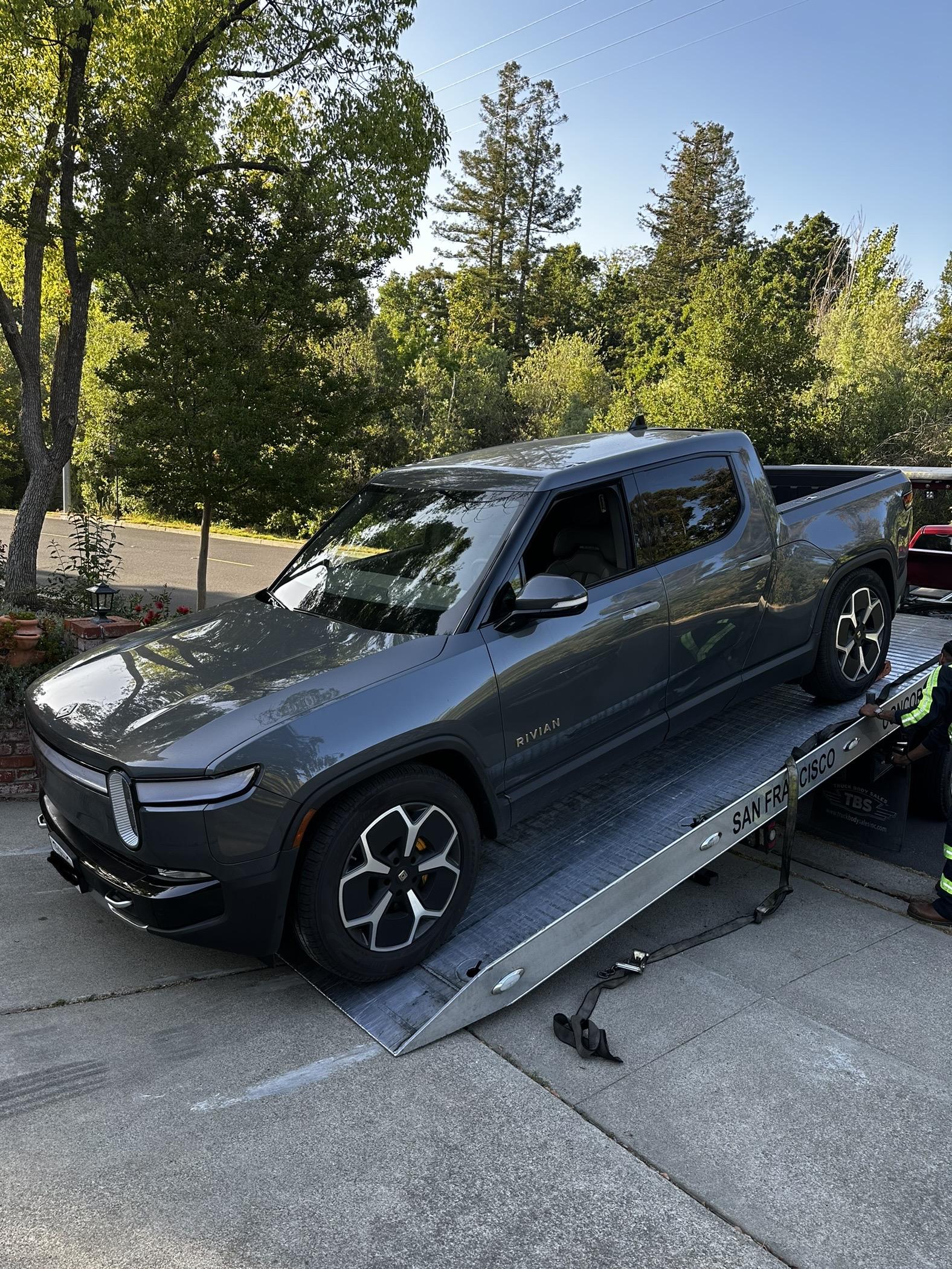

Started getting intermittent messages about getting 12V service after the .10 update. That was about a month ago, nothing that affected vehicle performance.
Just had the 12V batteries replaced by mobile service and now the car is bricked. Something about the software being too old and the car is now draining the 12V system. I guess I should’ve left well enough alone 🙁

Yeah I’m amazed that Rivian doesn’t have a contingency for this. There should be a way for the tech to somehow bypass the 12V system with a jump box so that the OTA could be applied. Poor girl has been towed away :(
