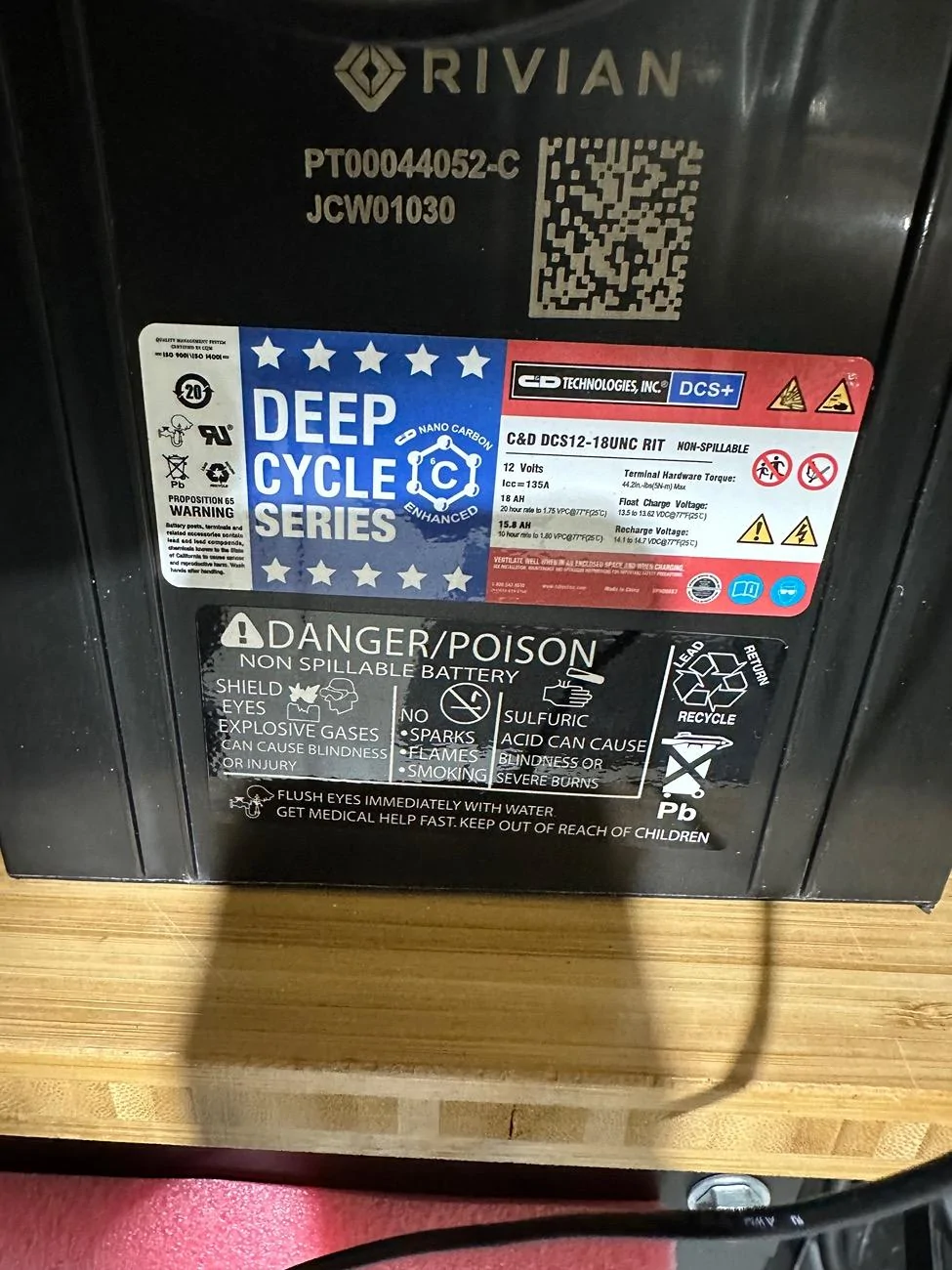

Miketz
Apr 17, 2023
46
Florida
R1T, Lucid Air, BMW IX
As I face my first long summer road trip I remain concerned about 12V failure. 2023 R1S only one battery.
I have tools etc. to get into the frunk if the 12V fails.
If I stored a backup 12V in the frunk (OHMMU) and connected it in parallel with the existing failed 12V would that likely revive the vehicle or would it just try to charge the existing dead battery?
Would a swap be preferable ?
Yes, I do check the 12V in the ride menu-- so far no issues.
Yes, I know that if the HV battery is the problem this is not the solution, just talking 12V here.
Yes, I know I could get into the vehicle using the trailer hitch leads with a portable jumpstart but that would not solve a dead 12V.
Thanks in advance for your suggestions.
Bringing a spare 12V battery on your trip is a good idea. My 12V battery dropped from 12V to 6V overnight and will not accept charge. I was lucky that it happened with the R1S parked in the garage. Rivian replaced it the same day. The original battery supplier was C&D technologies. I have not checked if they do direct sales to consumers but you may be able to purchase a spare 12V from C&D to take with you for peace of mind.

dradam
dradam
Sep 18, 2022
321
357
Maryland
Yes I would like to find this OEM battery-- but so far no luck-- I do not belive Rivian would just sell me one, but I may visit my local service center and inquire. Ohmmu would likely be a drop in replacement but they are super expensive for something I hope not to use or need. I have seen a few vendors of c/d technologies batteries, but not this one : DCS-18UNC RIT. If anyone know a seller please let me know. In the ride menu which I check periodically my voltage for 12V reads slightly above 13. I will be keeping an eye on it. THX

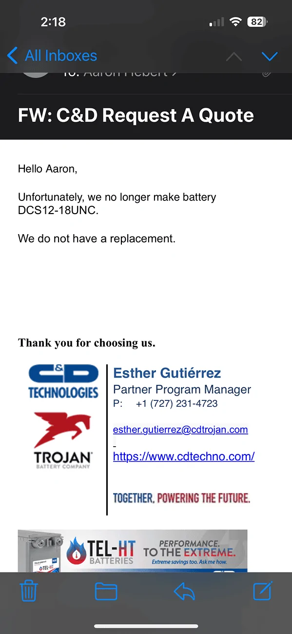

Hebdog
Aaron
Jun 11, 2024
Fort Worth
I have tried that route. They say they no longer make that battery and also don’t have a replacement.
