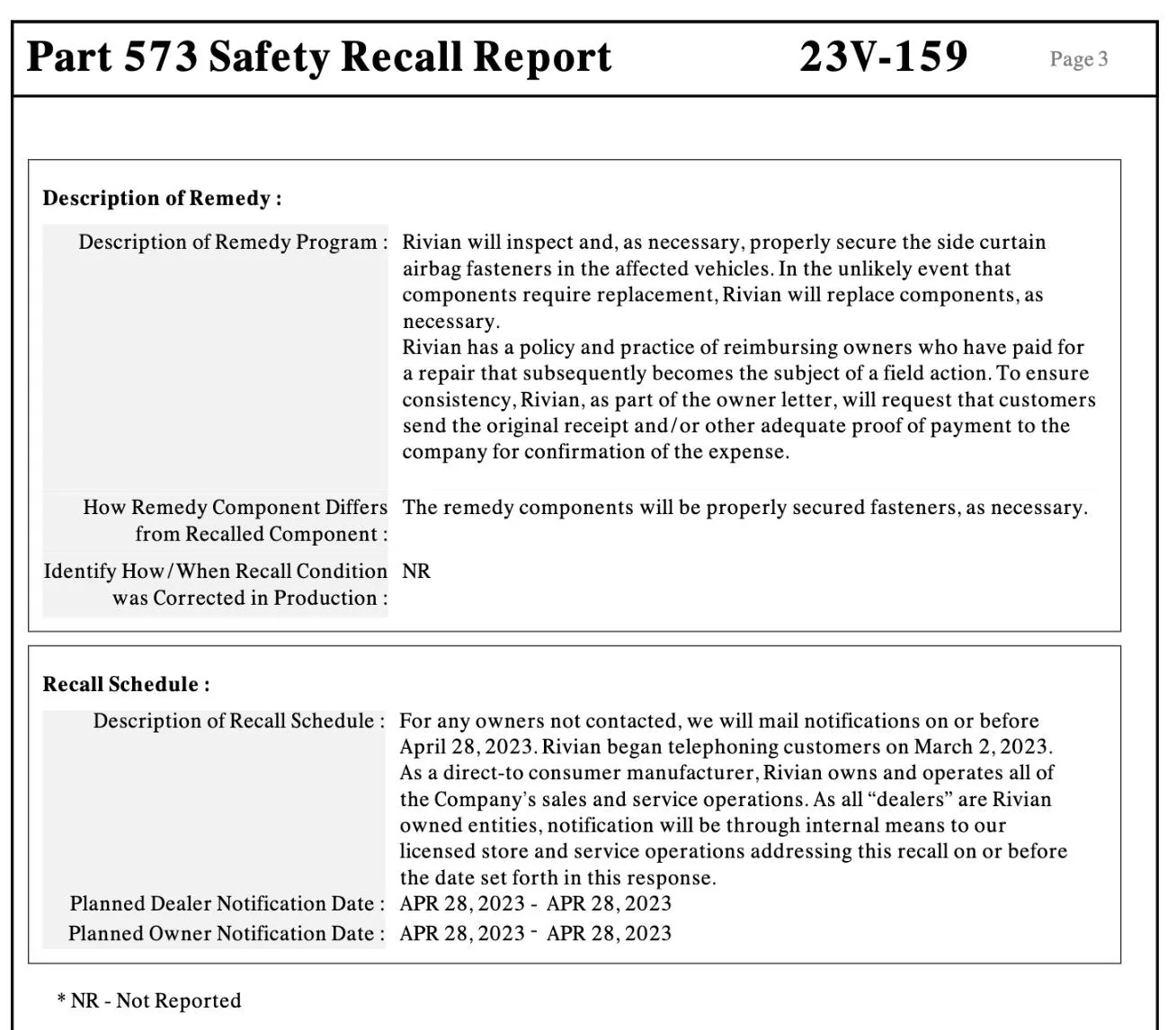

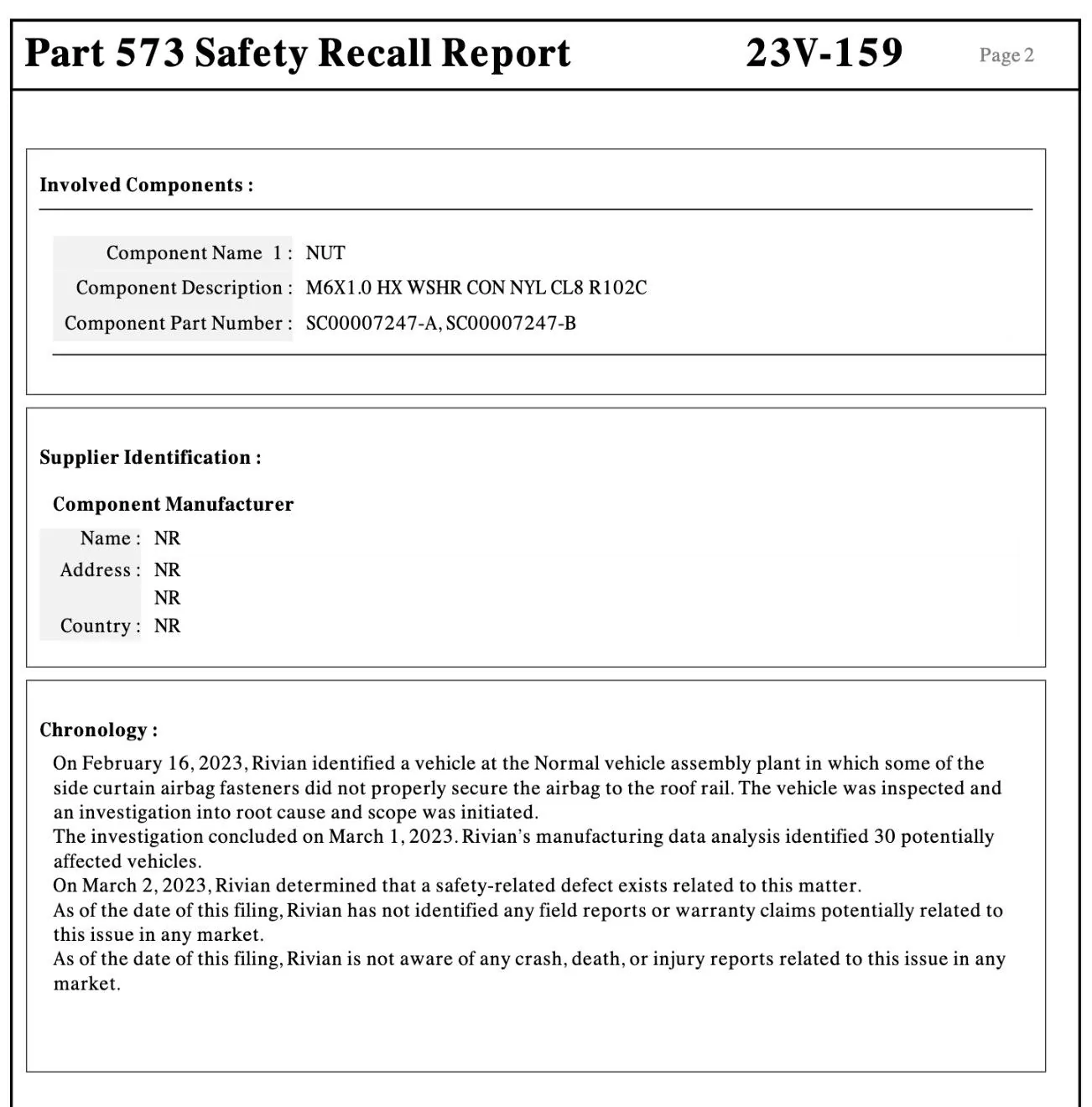

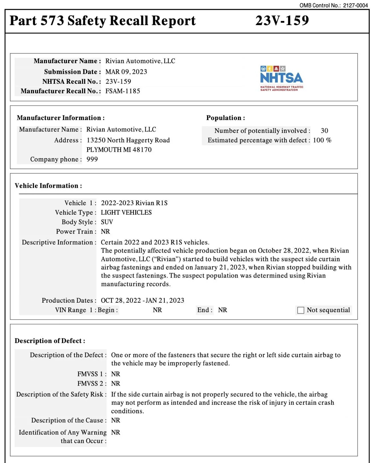

Rivian has identified and issued recall for potential issue with the side curtain airbags in the R1S. The problem is related to the fasteners that secure the airbags to the roof rails. The loose fasteners could cause the airbag to deploy improperly, increasing the risk of injury in the event of an accident.
The company first became aware of the issue on February 16, 2023, when a vehicle at its assembly plant in Normal, Illinois, had a loose airbag.
No reports of accidents, injuries, or deaths have been connected to this part / issue.
Production units covered are those produced between 10/28/22 - 1/21/23 (covers both MY22 and MY23 vehicles).
Rivian will start contact affected R1S owners on April 28, 2023.
See official NHTSA notice:

You can kind of guess the month built based on vin and looking at vehicles delivered on this forum plus looking at the sales on cars and bids. I was able to guess the month of my build before I picked it up. They say they are not built in sequence but they are close.
Something here does not add up though, the date range says 10/28/22 - 1/23/23, there were thousands built in that time frame not 30. Maybe it is related to a specific interior like OC that did not have a lot of early builds.
Will be interesting to see what this actually ends up being.
