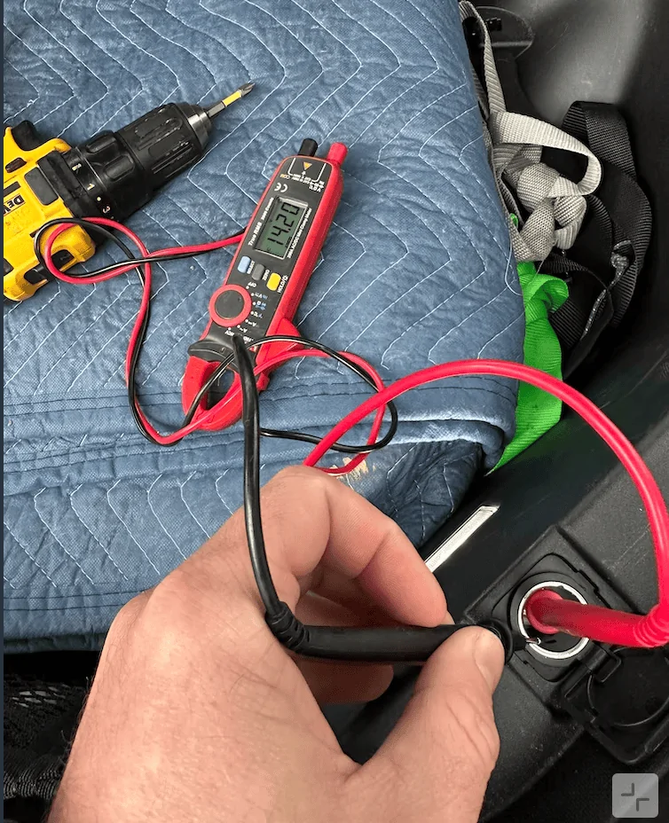

Well, seems like update didn’t come fast enough. I believe I’ve been hit by the 12V issue now. Need to call in. Sigh.
seatosummit
Austin
Can you check the voltage on one of your 12V plugs?
If you are totally locked out, what happens if you apply a 12-14V source to the "jumper leads" near the trailer hitch?
did you do anything different? Software reset? Or did it just brick without anything different?
when I got into the truck first thing this morning, it wouldn’t allow me to go in reverse. I had to hop out and get in my other car to get to an appointment. Once I got home, my husband had gone out to check and he said the screen came on and then went black. By time I was back home, it’s now just dead. Has 130 miles in charge, so I know that’s not the issue.
I called Rivian and they are supposed to call me back with next steps.
Checking the voltage? Eh. I’m not a handy person with cars lol I’ll see what Rivian says when they call back and go from there. 🤷🏼‍♂️
Sorry to hear that. Sounds like a big inconvenience.
When I first heard about this, I went and checked the voltage via a multimeter on the 12V plug in the frunk. I saw 13+ volts which means the 12V battery was being charged by the high voltage, traction battery. I would suspect that in your case the voltage is less than 12 if the issue is the 12V battery being discharged.
Curious to hear what Rivian recommends, and it will almost certainly involve tow + battery replacement, but you could "jump" it via the jumper leads at the rear to at least restore 12V to get doors open, etc.
If you have 130 miles of range, it is most definitely not your fault so Rivian will have to cover it.
