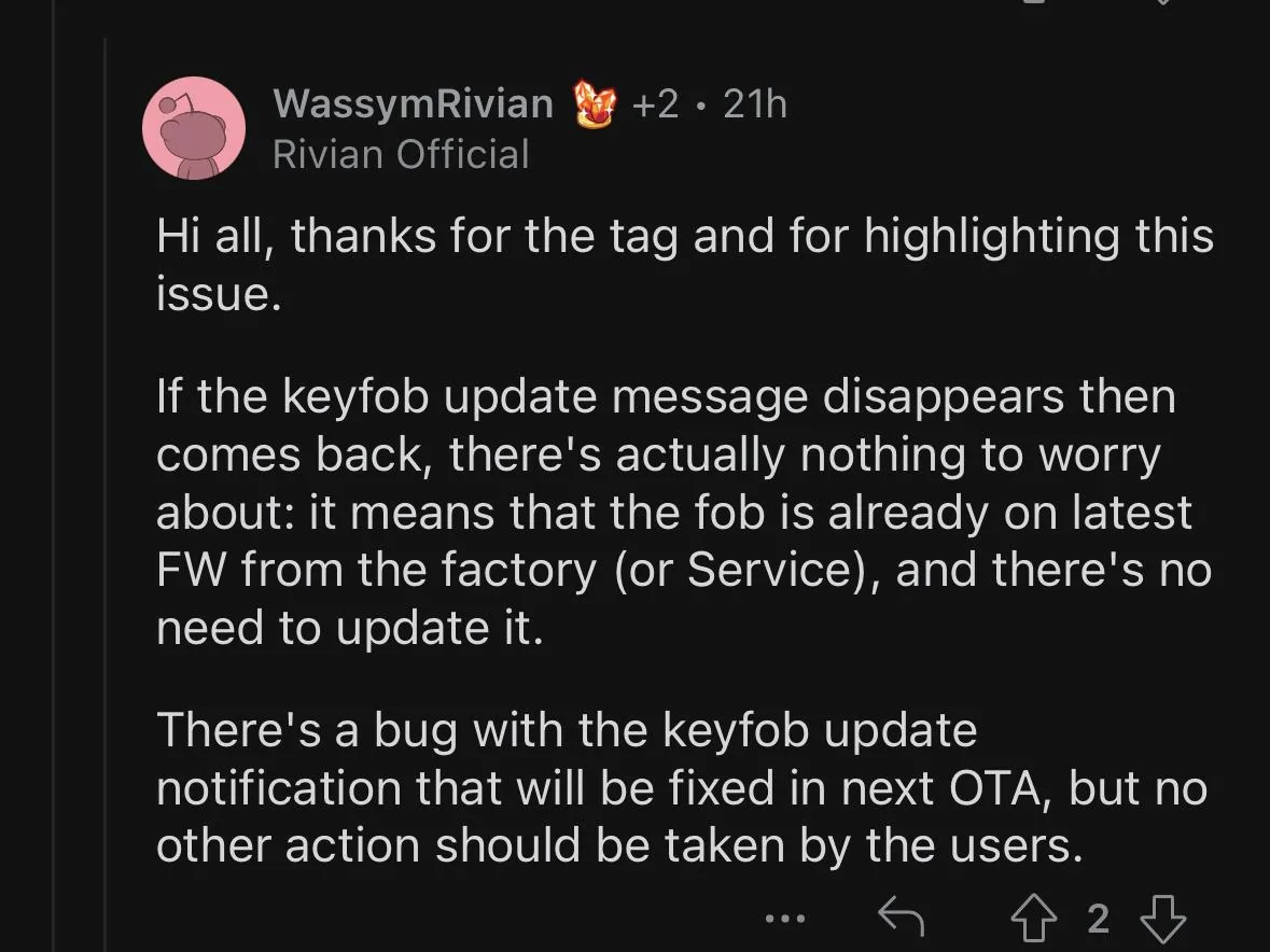

Regarding the fob update this is from Wassym on Reddit:
Rivian R1T R1S 2023.6.2 OTA Update Released to Public 3ACDCA02-E70C-40E7-B52E-96EEBD48E3AE
