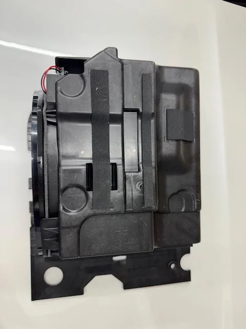

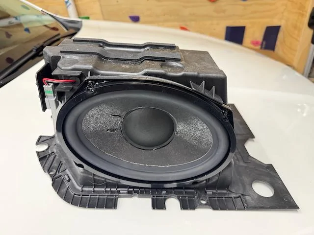

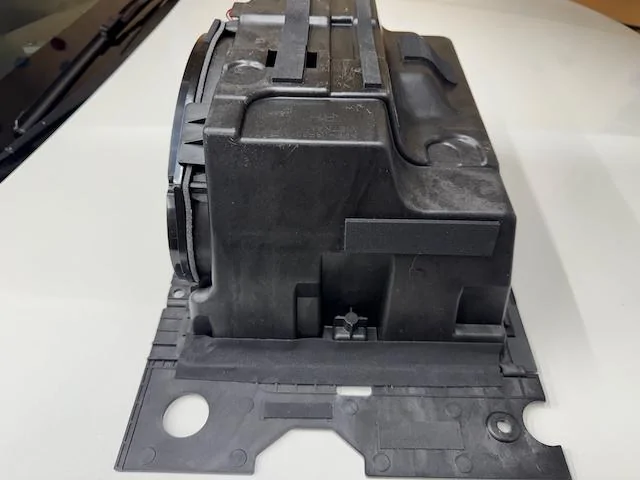

Would you happen to have any pics of the original speaker you pulled? Wondering if we can pull a spec sheet or something if a part number or manufacturer is available. If not, no sweat.

Photos of the OEM "sub".
Rivian R1T R1S 2025 R1T Tri Max - Subwoofer Replacement - Upgrade to Premium Audio IMG_4487
Rivian R1T R1S 2025 R1T Tri Max - Subwoofer Replacement - Upgrade to Premium Audio IMG_4488
