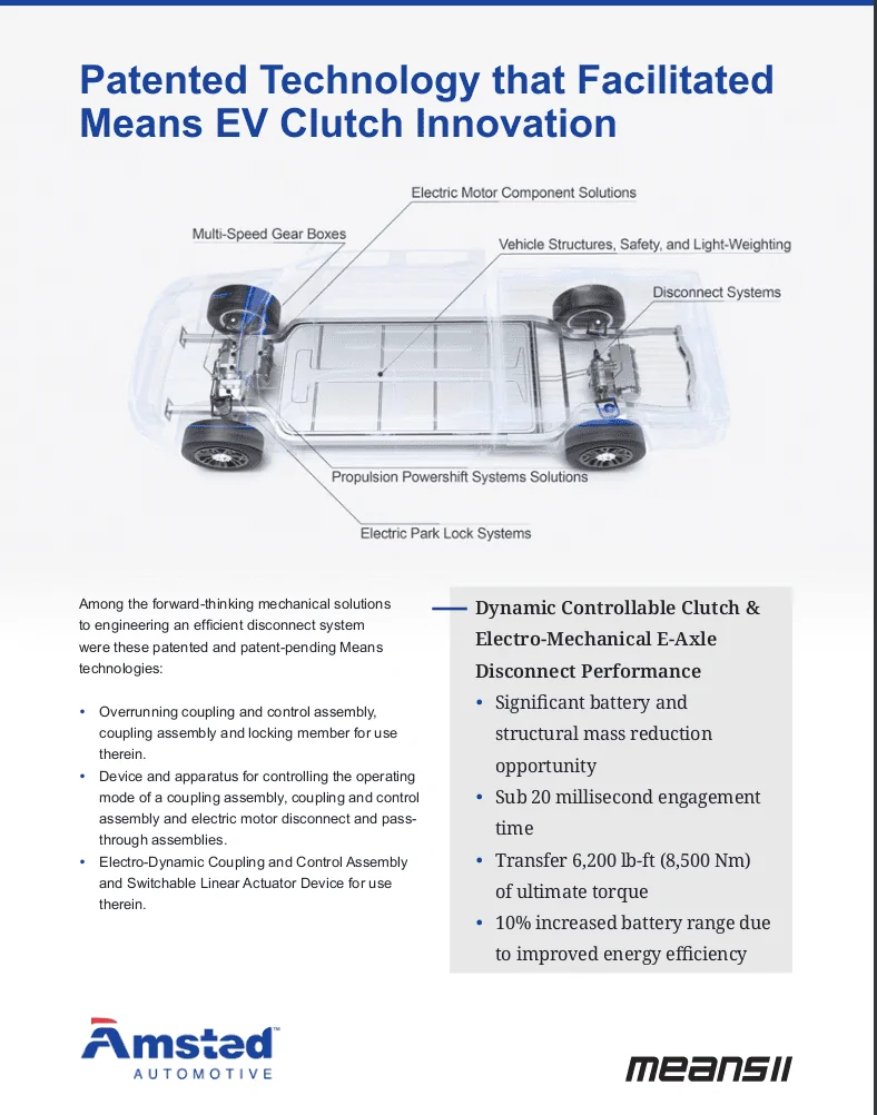

Interesting that it was just announced today. I guess it's for a future iteration of the RIvians. Should help with range.

Pretty sure it’s what they’re using now for decoupling the rear motors in conserve mode.

I agree but it says “in current Rivian production trucks.” I would have thought 4 motors would negate the need. I need to study more.
IPTV65
May 19, 2020
261
391
Mount Pleasant SC
Jeep JLU Sahara,Jeep JKU, Infiniti G37X, R1S
Engineering Exec
I bet that is it. No “vectoring” function needed with 4 motors.

Interesting. Wonder how much torque that electro-magnetic clutch can hold. And what the power requirements are to actuate and/or hold them open or closed.
Cutting power to the rear motors isn’t sufficient, the rear wheels need to be decoupled from the motors otherwise the rotation of the wheel will turn the motor into a generator. This would produce drag on the remaining powered axle.

Interesting info. We obviously knew there was some kind of electronic disconnect/clutch for the rear motors, but I also enjoy seeing the details of how they've implemented things.
Based on their product sheets, this system would easily be responsive enough for Rivian's use of "conserve" mode. It looks like it could re-engage quickly enough for any safety situations if Rivian chose to put power to the back wheels for stability, etc.

Now I'm curious after watching @OutofSpecKyle 's road trip video about regen in Conserve mode. If the rear motors are physically decoupled in that mode then are they not able to regen?
Or do they recouple during a regen moment?
Or do the front motors alone provide more regen than the battery can take so it's a non-issue?

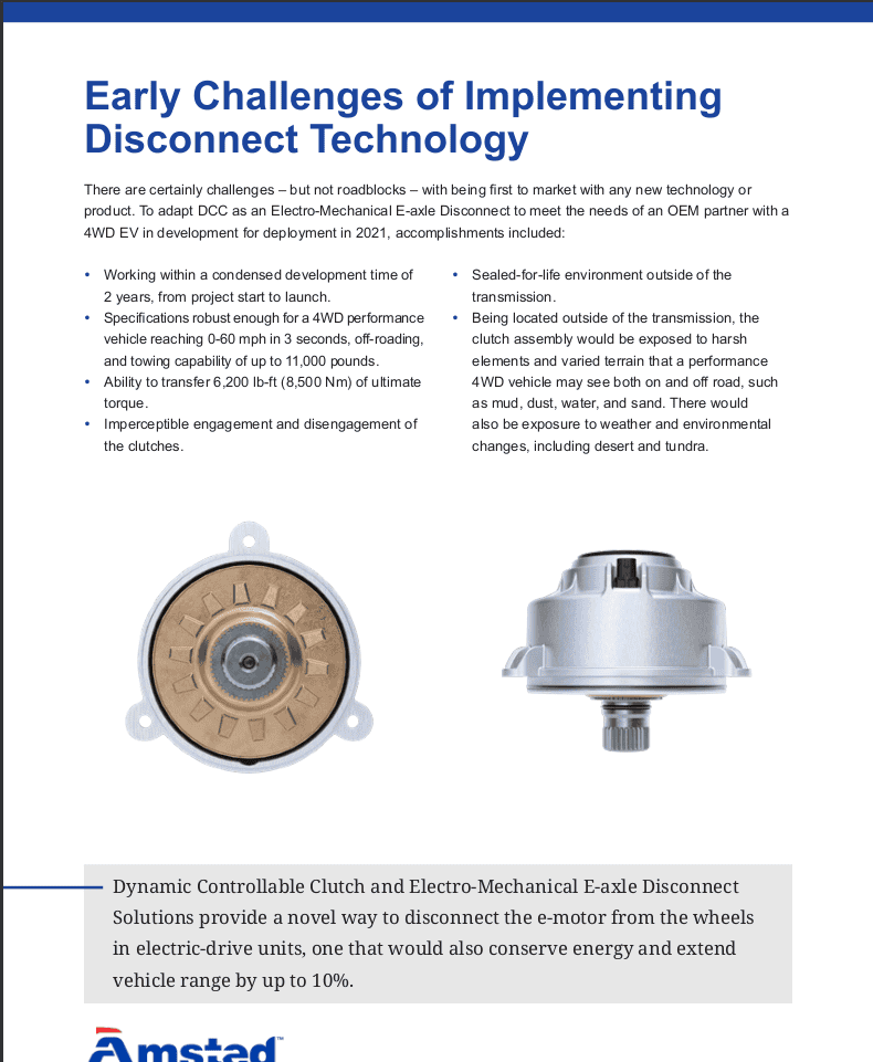

Say you made something capable enough for a Rivian without saying Rivian:
"Specifications robust enough for a 4WD performance vehicle reaching 0-60 mph in 3 seconds, off-roading, and towing capability of up to 11,000 pounds."

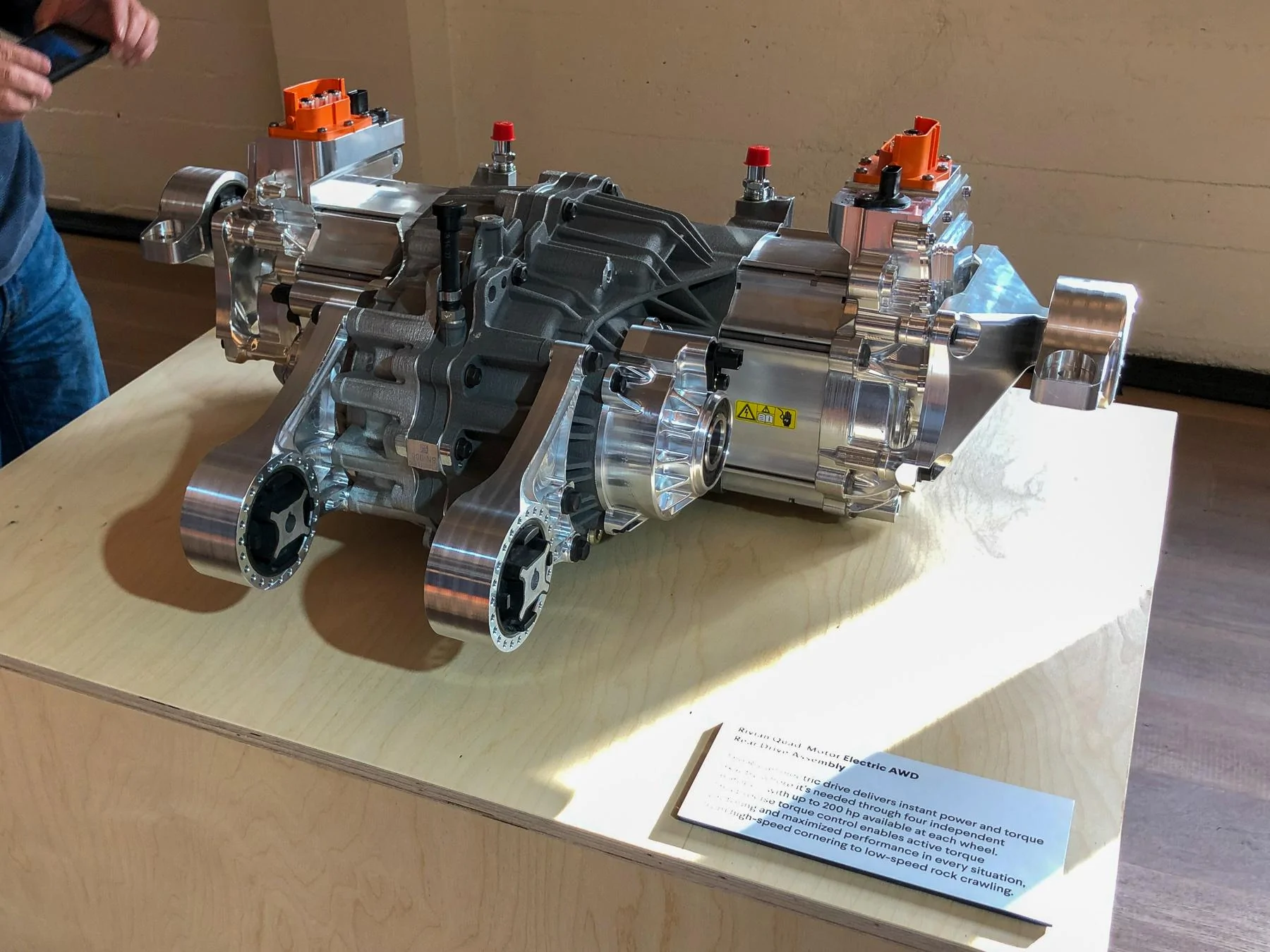

Here's a photo of the rear drive unit that I found in a post from September, 2019 (Seattle event) on this forum. Can you spot the disconnects?
Rivian R1T R1S Amstead Automotive E-Axle disconnect used in Rivians rivian_rear_driv
zefram47
Aaron
Feb 6, 2022
2,750
4,513
Rivian R1T, Alfa Romeo 4C
@OutofSpecKyle certainly look present in this assembly. Wonder if they made it to the production model.
