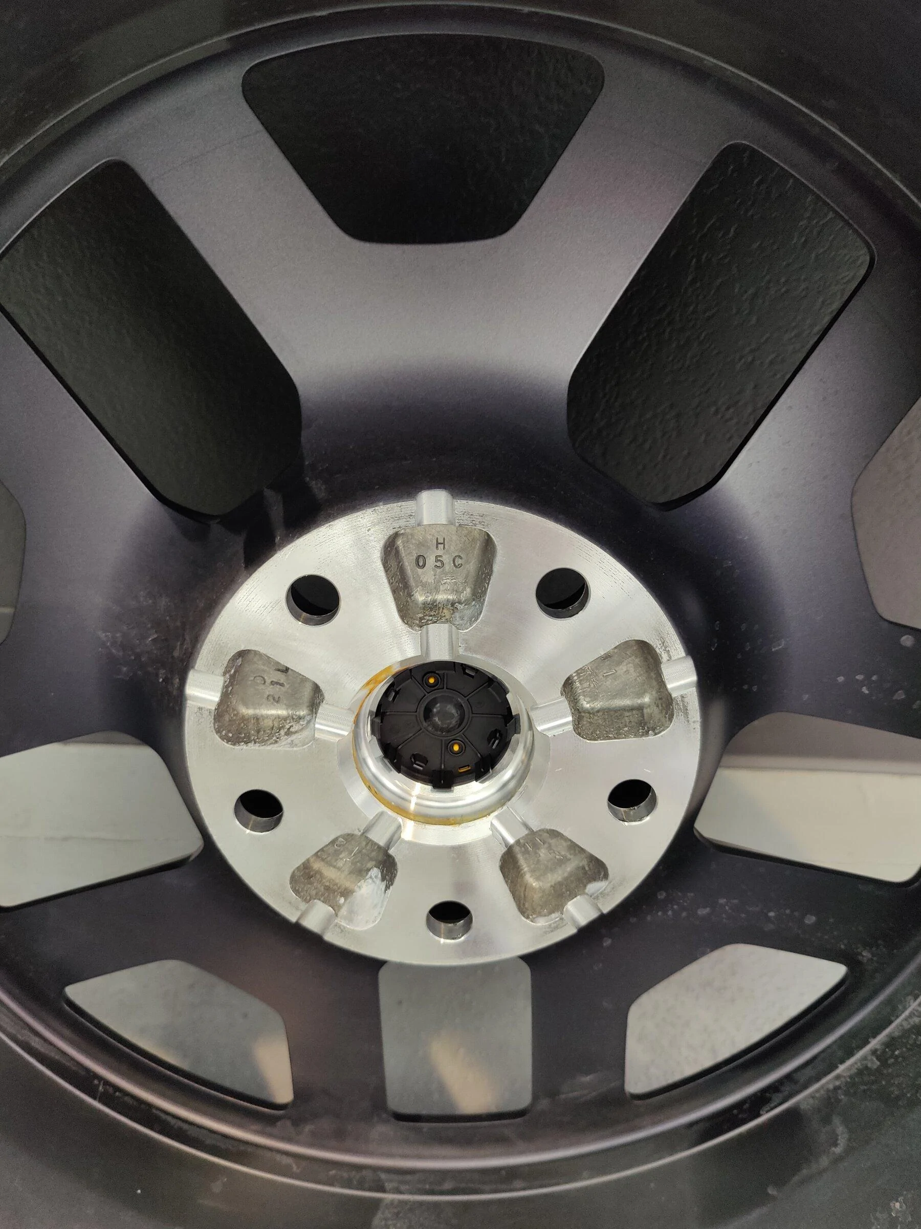

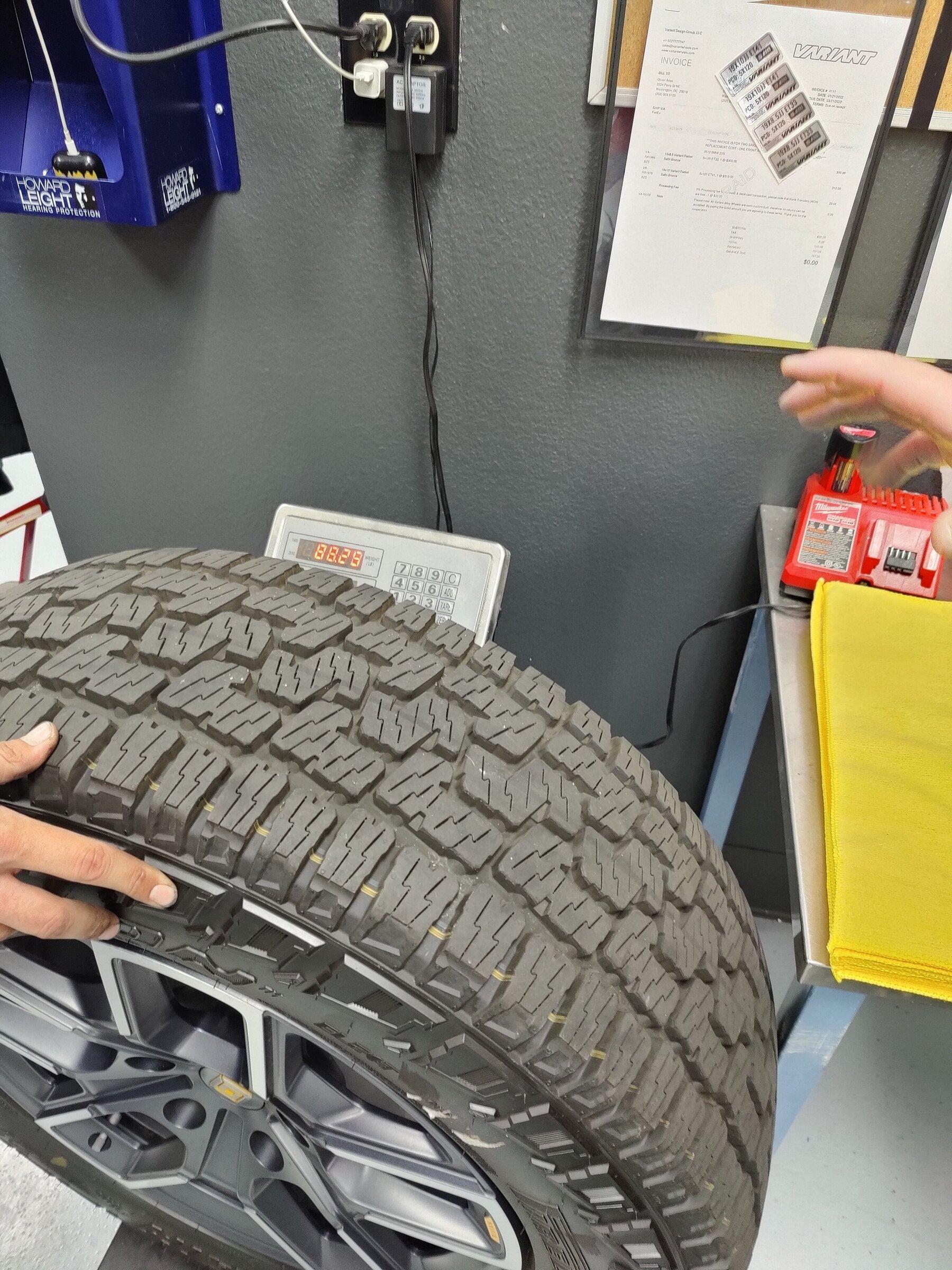

  • Weight: 88 lbs (with tires mounted)
  • Size: 20x8.5
  • Offset: +48mm
  • Bolt Pattern: 5 x 5.5
  • Hub Bore: 64.1mm
  • Construction: 20s are forged, while the 21" and 22" options are cast.

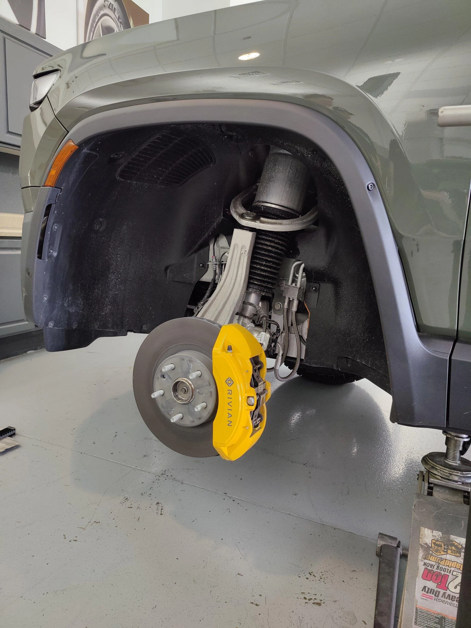

We collaborated with my aftermarket wheel manufacturer (Variant) to cook up some custom forged designs for the R1T. With that +48mm offset and Rivian's beefy OEM calipers, there’s nothing off-the-shelf that clears—so we’re going full custom. Think off-road vibes in bronze or gunmetal (my picks), but the sky’s the limit on design.

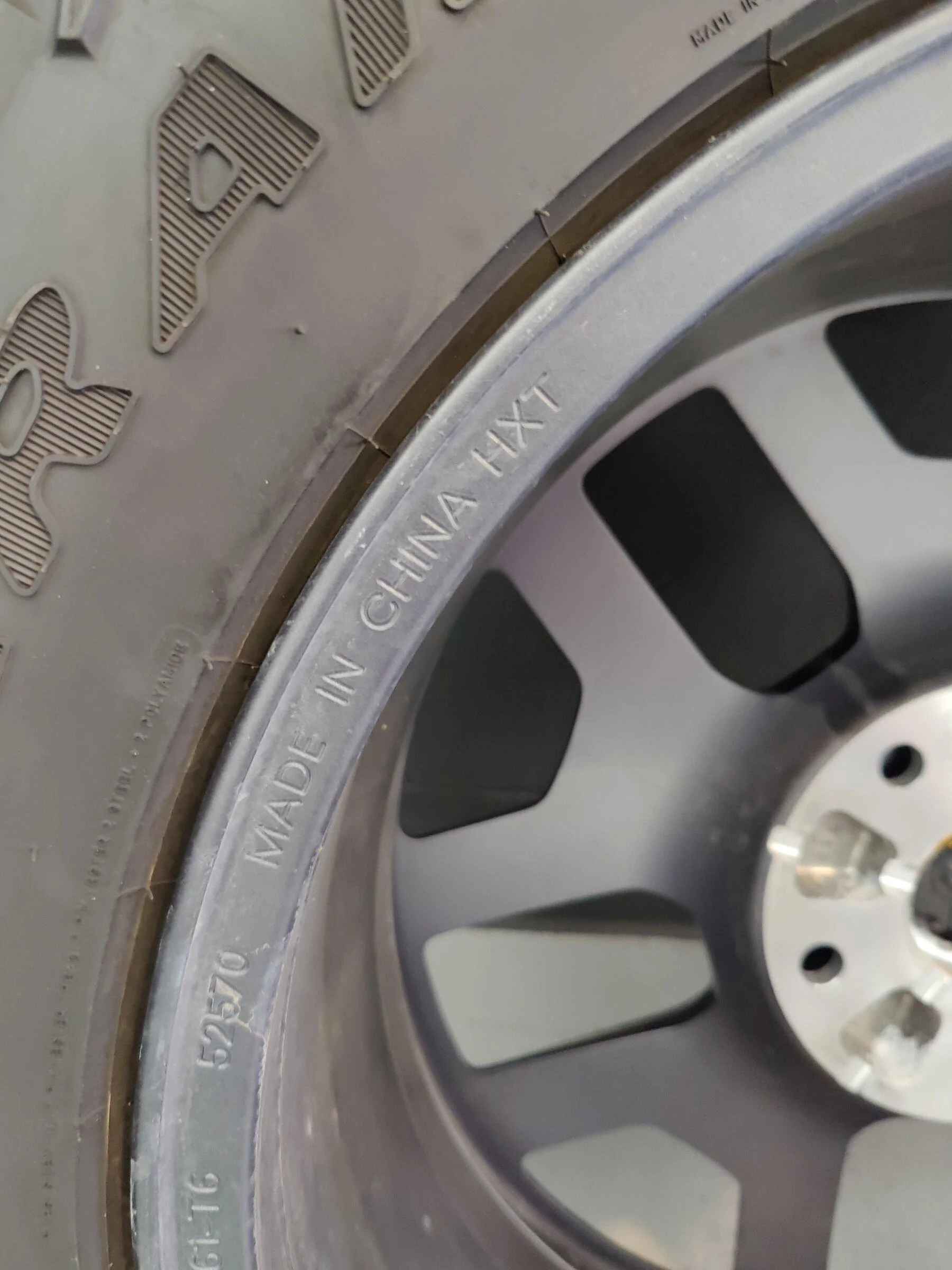

Fun fact: A full 20"/AT setup with Pirelli Scorpions weighs 88 lbs. That’s reasonably fair for a 275-wide, 34"-tall all-terrain setup. Also worth noting: Rivian’s OEM forged wheels are made in China.
Oh—and the suspension travel on the R1T? Wild. We had to keep cranking the floor jack just to get it off the ground. This truck continues to impress. Absolutely loving it.

Where are the other wheels made? That may change my wheel choice.

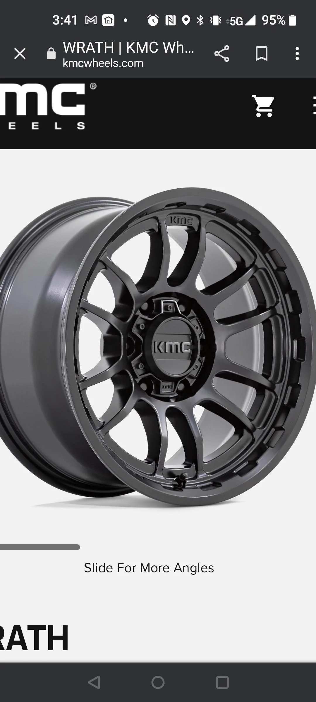

How does one go about finding a custom wheel manufacturer? This seems like one of the more unique humble brags I've heard in awhile. I'd love to see what you come up with!
My business (automotive aftermarket performance) works with a few companies in this world of custom wheels and this one is in my personal backyard and are friendly people.
You could have HRE, Forgeline and a host of others build custom wheels, but that's a bit beyond what I'd like to spend for the R1T. I personally like the pure off road look even with some standard designs from Method Race Wheels or even KMC. KMC style design would look great in black, titanium or even bronze.
Having said this, I really like the factory wheels.....

@Mark_AZR1T what width and bolt pattern did Rivian spec? 20x? 5x? et48mm

I’d also please be interested in learning how they fit hubcentric specs and how customized that effort is vs standardized fitment.

Is there any chance that a custom 18" wheel could be made to fit over the calipers?
Good question...I would guess no because of the monster truck calipers....but TBD
