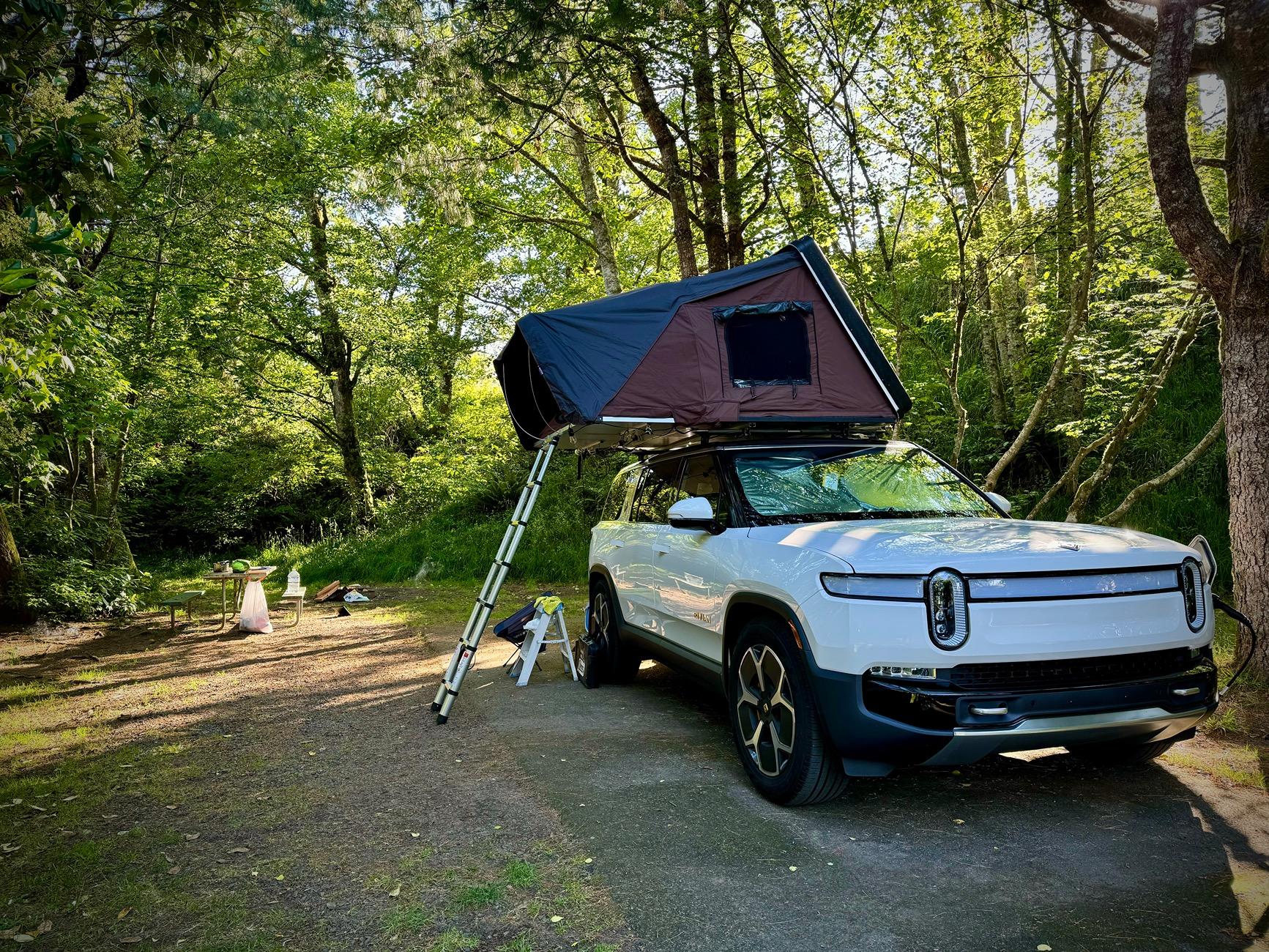

Agree that speed affects efficiency and range, but it's the same whether you're in an ICE or EV. If driving in an ICE SUV (Range Rover, for example) with a roof top tent, your range hit (decrease in mpg in ICE vehicle) would essentially be the same as driving a Rivian with a rooftop tent (assuming cross-sectional areas of both vehicles are generally the same-which they are).
Drag equation doesn't change just because you're in an EV. I can't remember the equation exactly, but the force of drag squares as speed increases... OK, I looked it up. Neglecting minor changes in density of air, Drag= velocity^2/2, assuming the areas of the vehicles are the same (or very similar).
This means that going even a little faster creates a LOT more drag (square of velocity divided by 2) and kills mi/kwh and mpg.
We all hate this law of physics because we want to get where we're going faster! LOL.
Thanks. I've been meaning to TRY and do some math around this but there are so many variables that the margin for error is huge so I'll have to stick with experiential tests. One thing to add is that I find driving the Rivian so comfortable that I don't mind going a bit slower (assuming that we have the extra time).

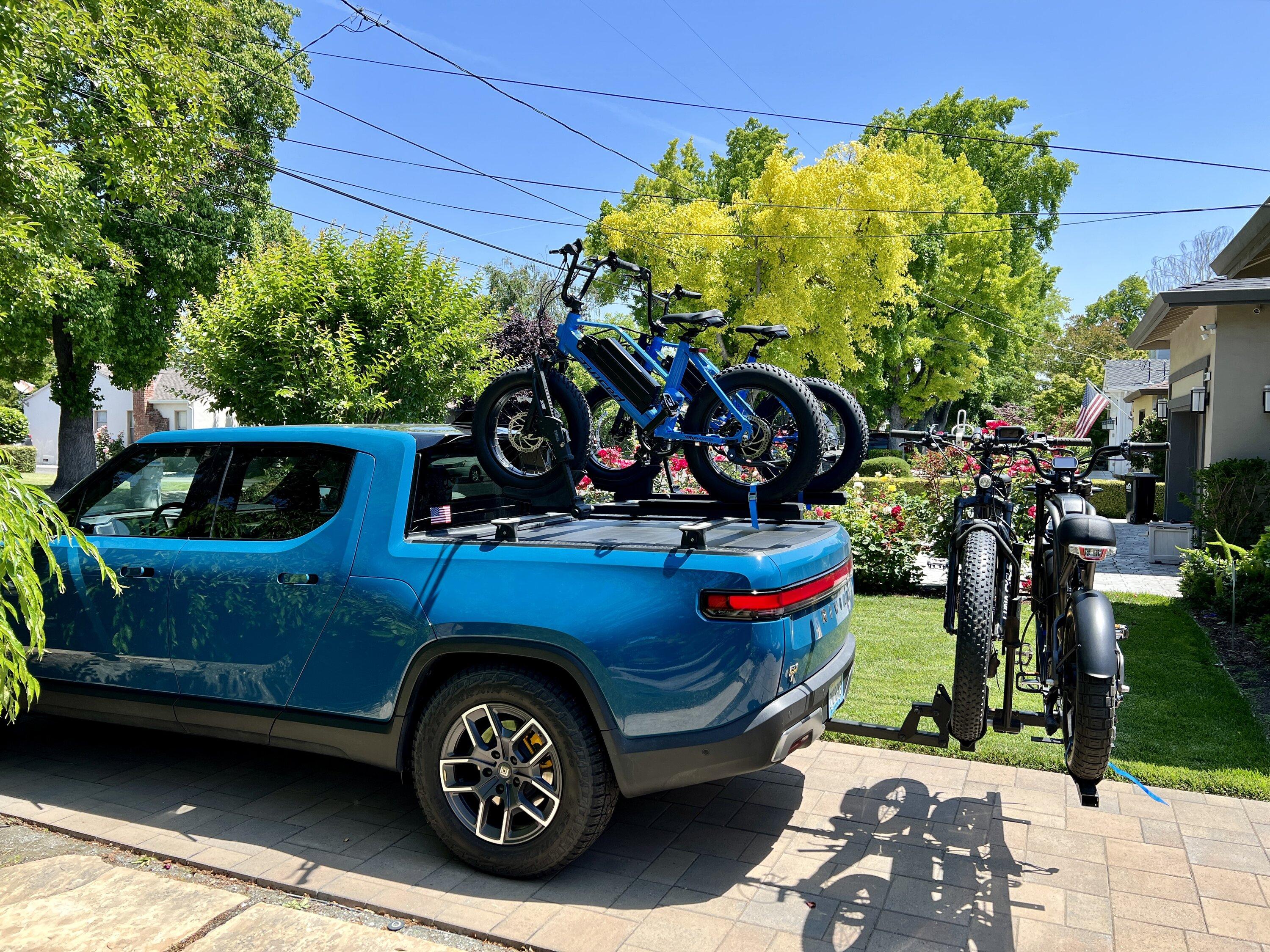

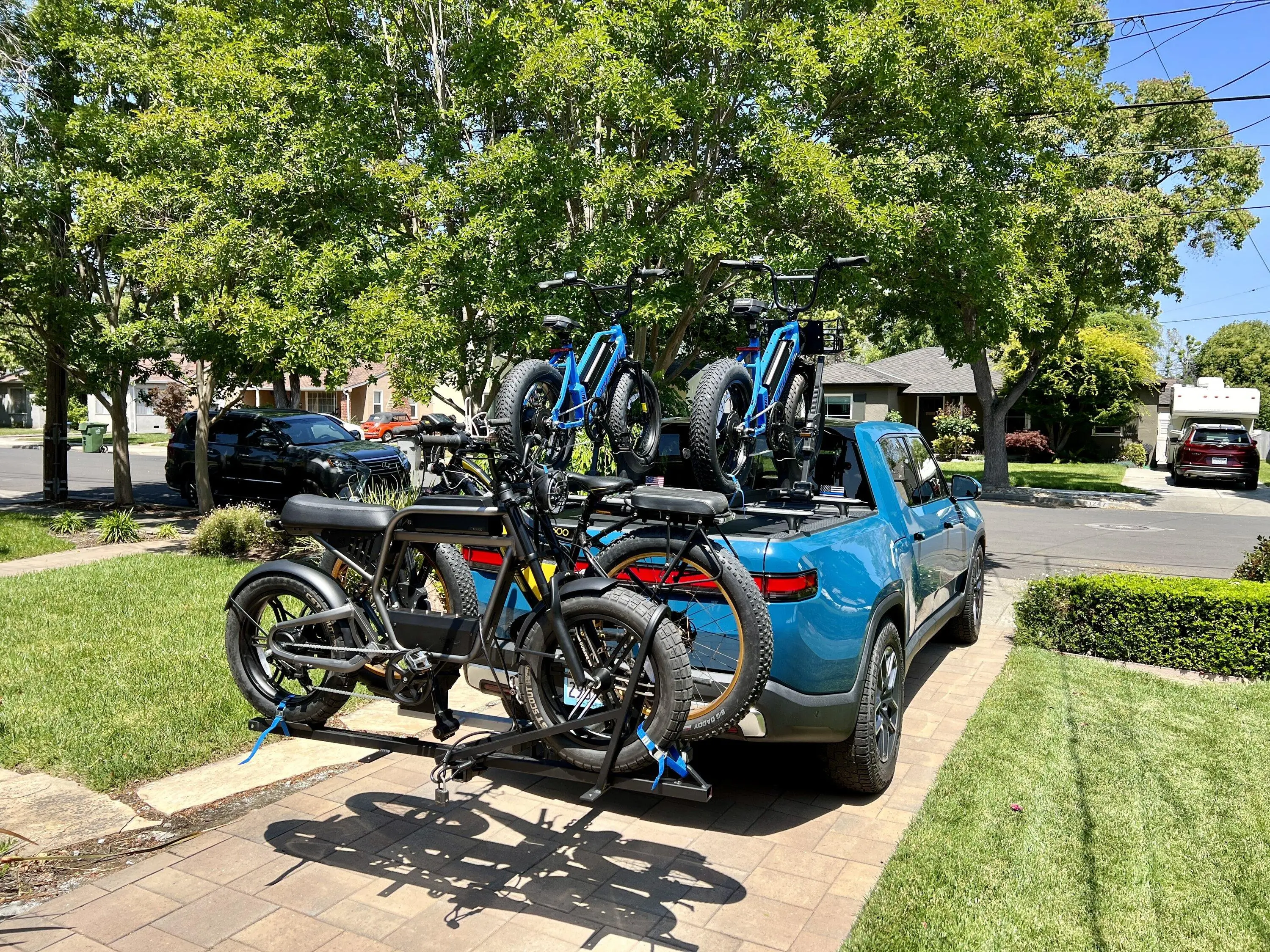

Thanks. (can't argue with the channel size thing! - best way to help BTW is to watch, like and comment on the video itself - and share).
I'll bet you won't see much impact on range. Of course there will be some, but with all of the other factors, like hills and wind, you won't be able to single out that small of a difference in aero. would love to know your results! I do know that the thing that will impact the range the most is speed. When we went from 75 to 65 I saw a big jump in efficiency, maybe 20% or more.
I think you're right about not being able to tell. I tried to do some testing for an hour with all the bikes on, but I couldn't get consistent enough speeds at the time to tell. You can see in the photos how much the bikes over the bed stick up in the wind. There's a cost for sure, but I don't think it's worth trying to actually measure it. I'll just assume -20% and plan accordingly.
