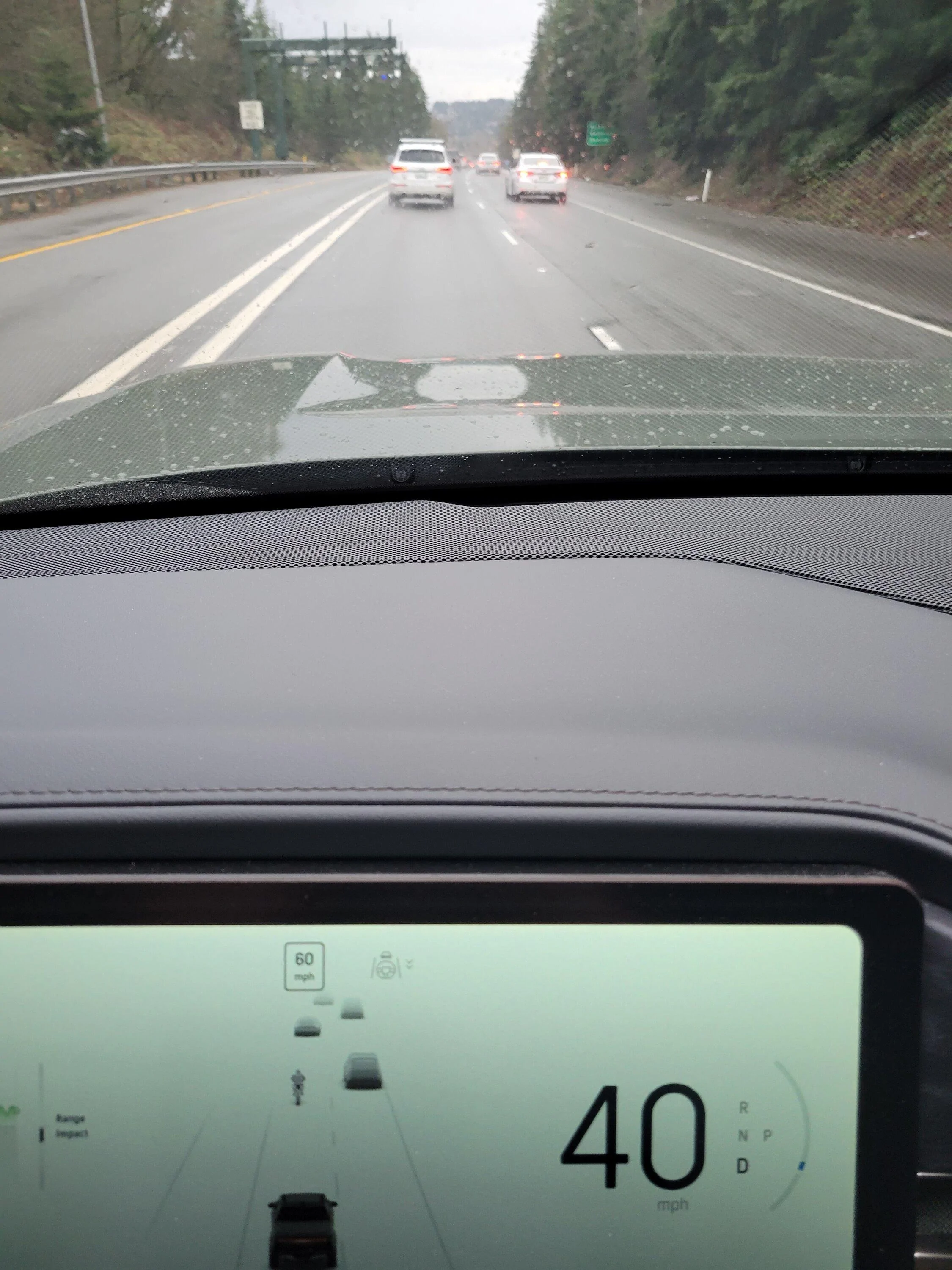

What about the Mitsubishi motorcycles? No matter how much we drove and moved positions around the truck was convinced it was a bike.

@Thedude - yes, we’ve seen that but not at freeway speeds.
Sorry, couldn't see past the efficiency gauge!:clap:

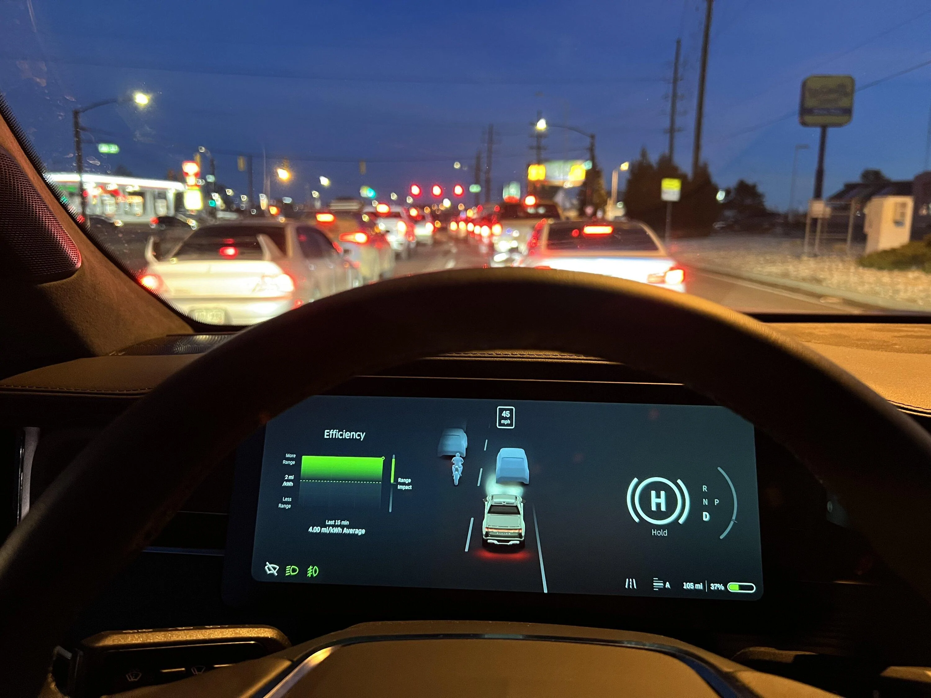

I had just coasted down from the mountains for 20 miles, I wish it was like that all the time.
I assume the readout maxes at 4.00, that kinda sucks.
