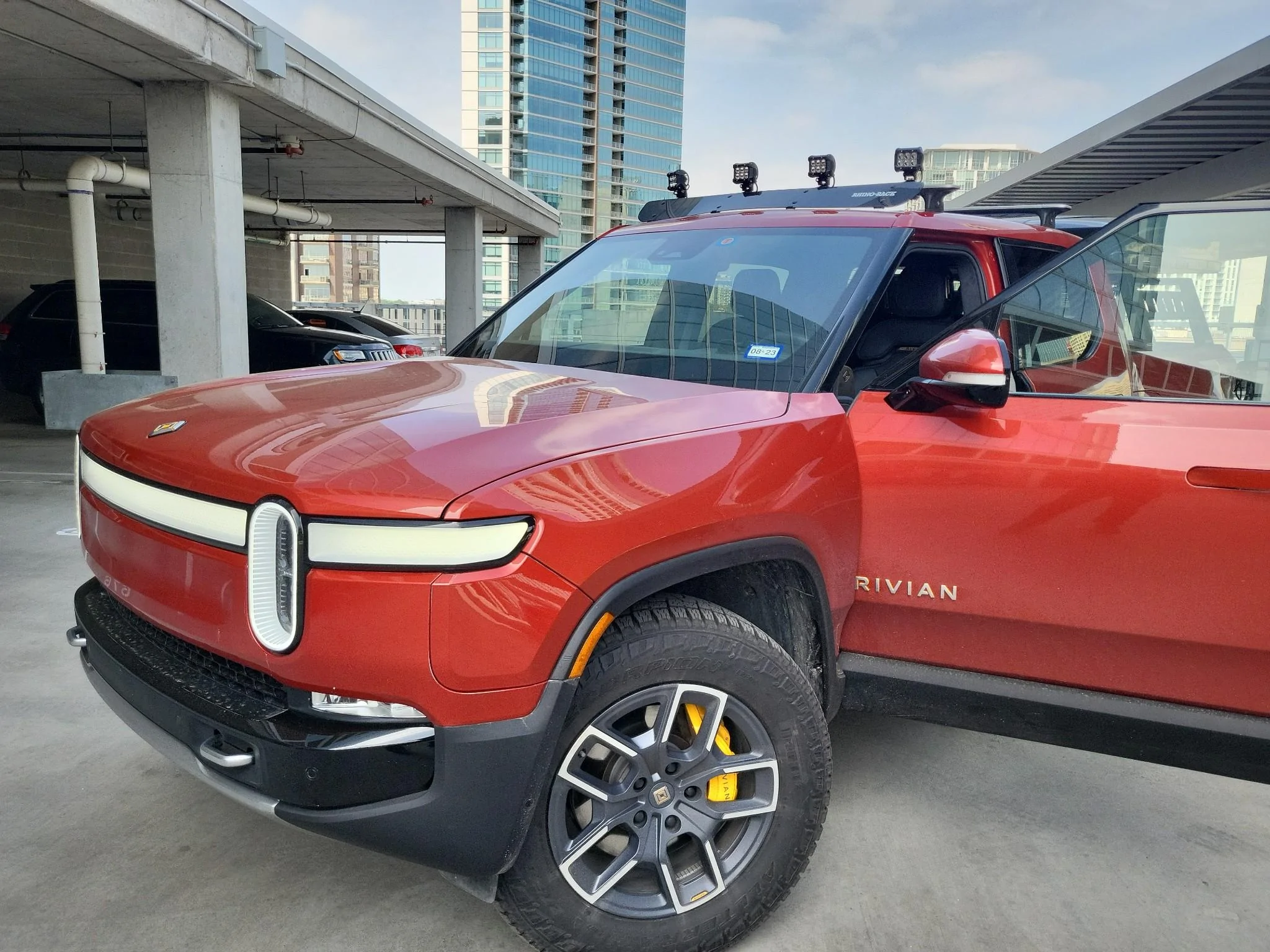

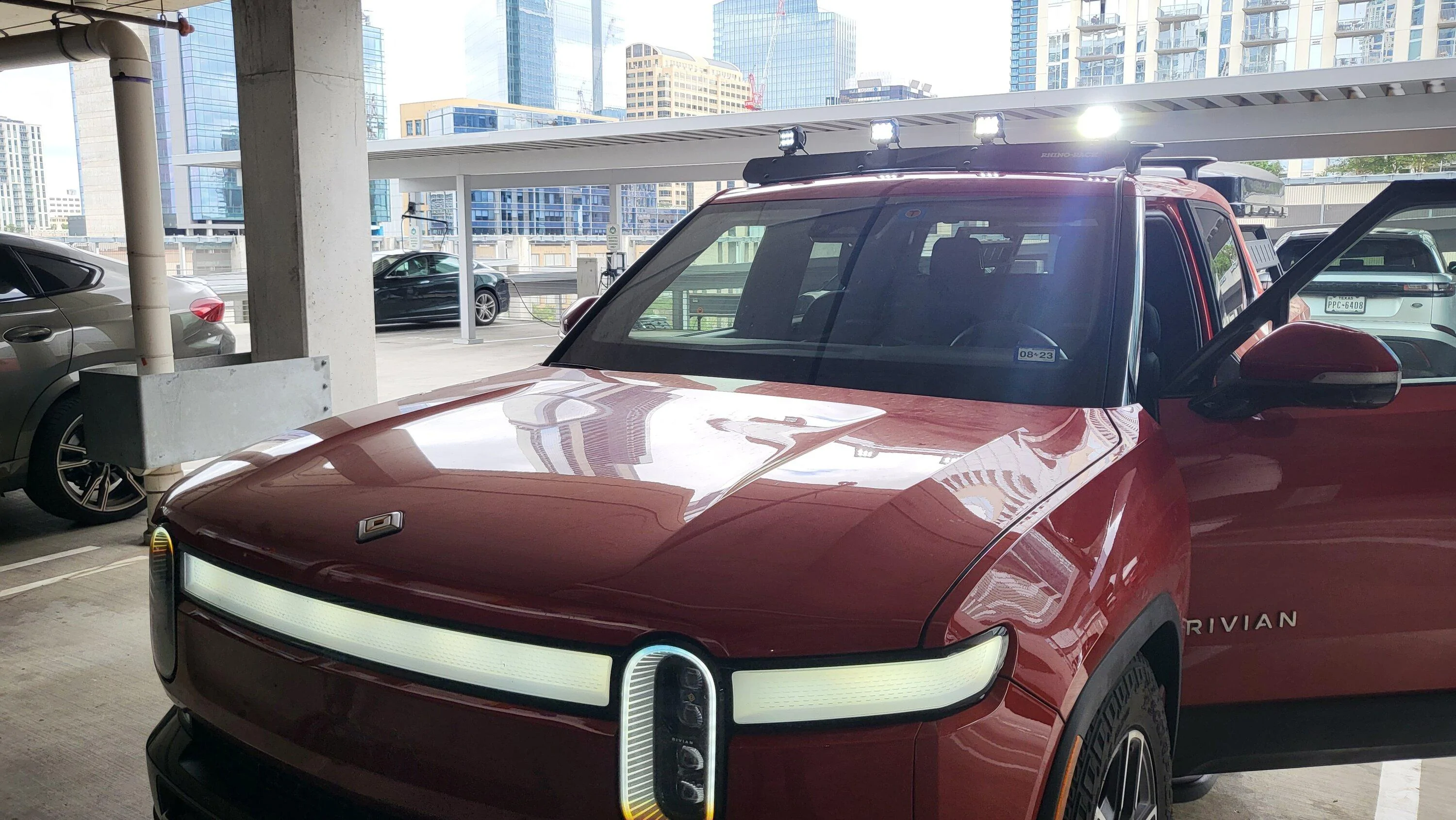

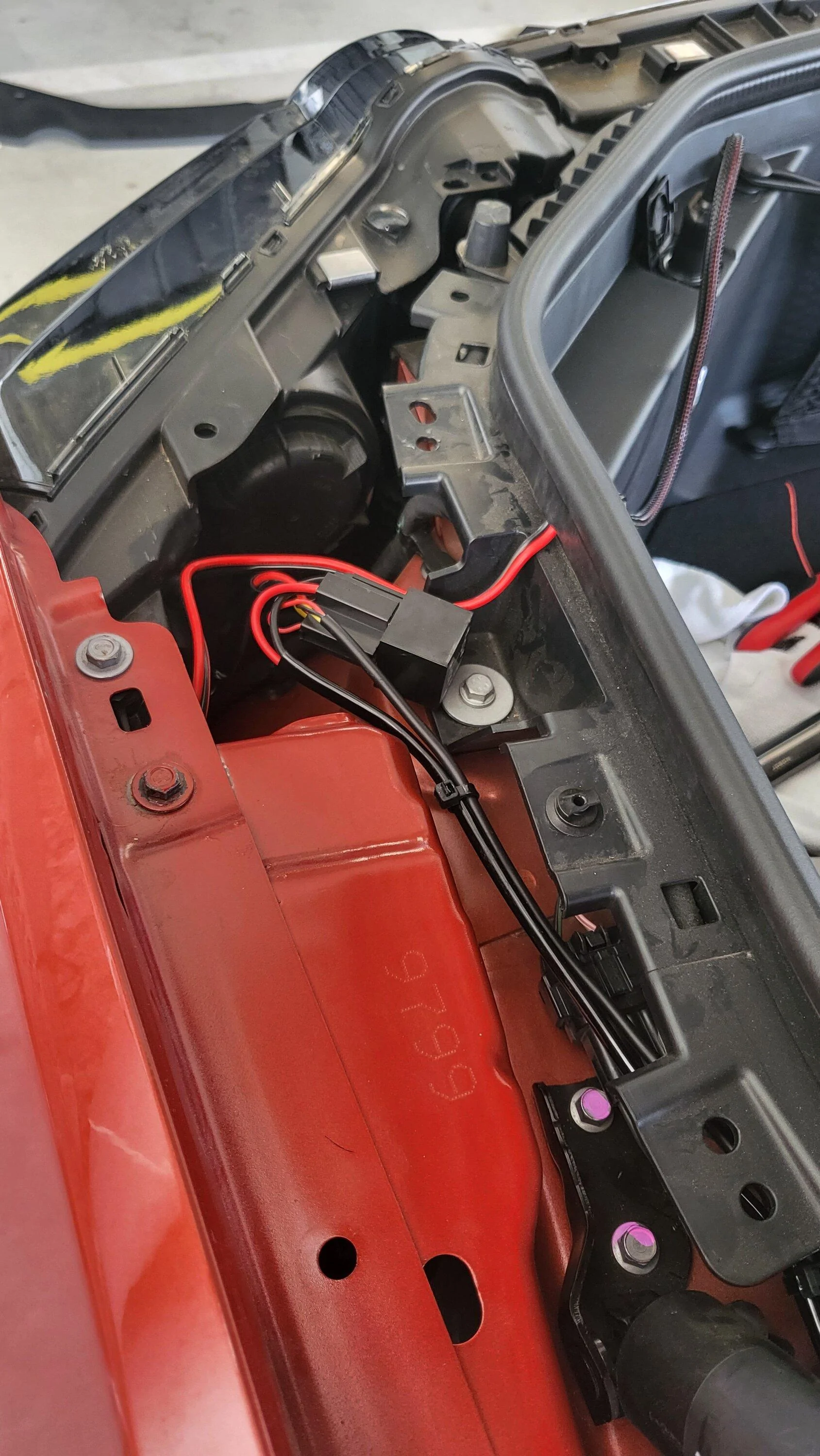

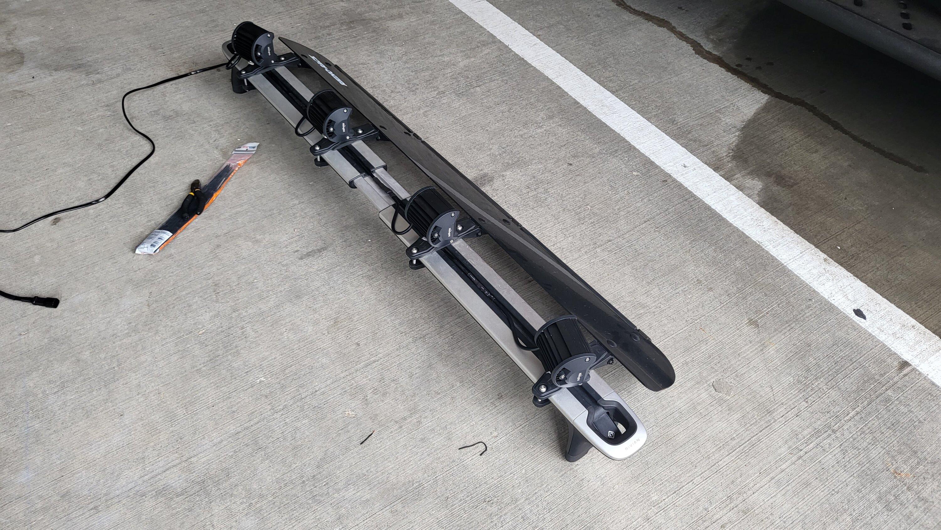

...just to give some of you frugal folks an idea about what you can do with a little elbow grease and about $200.

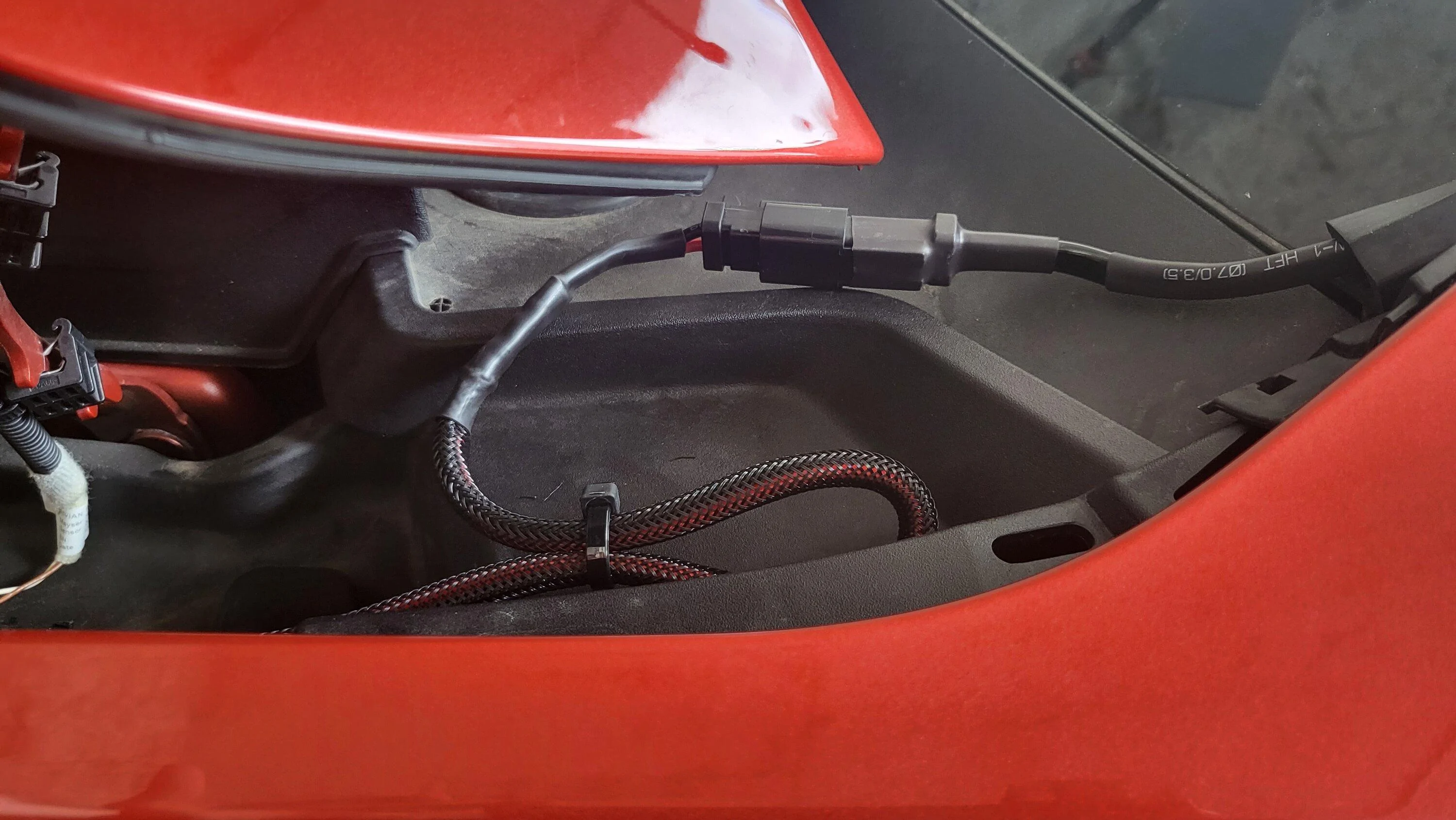

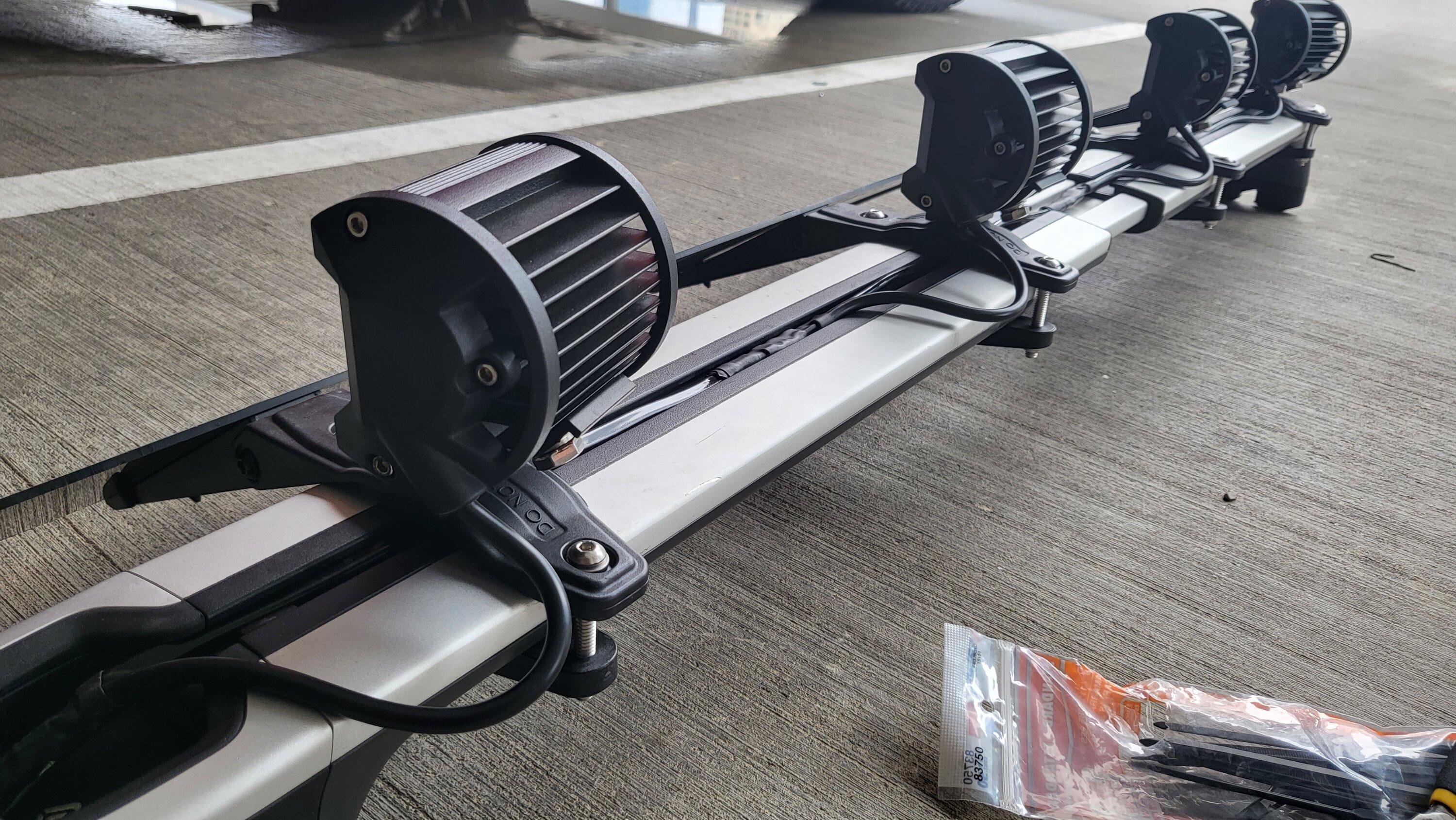

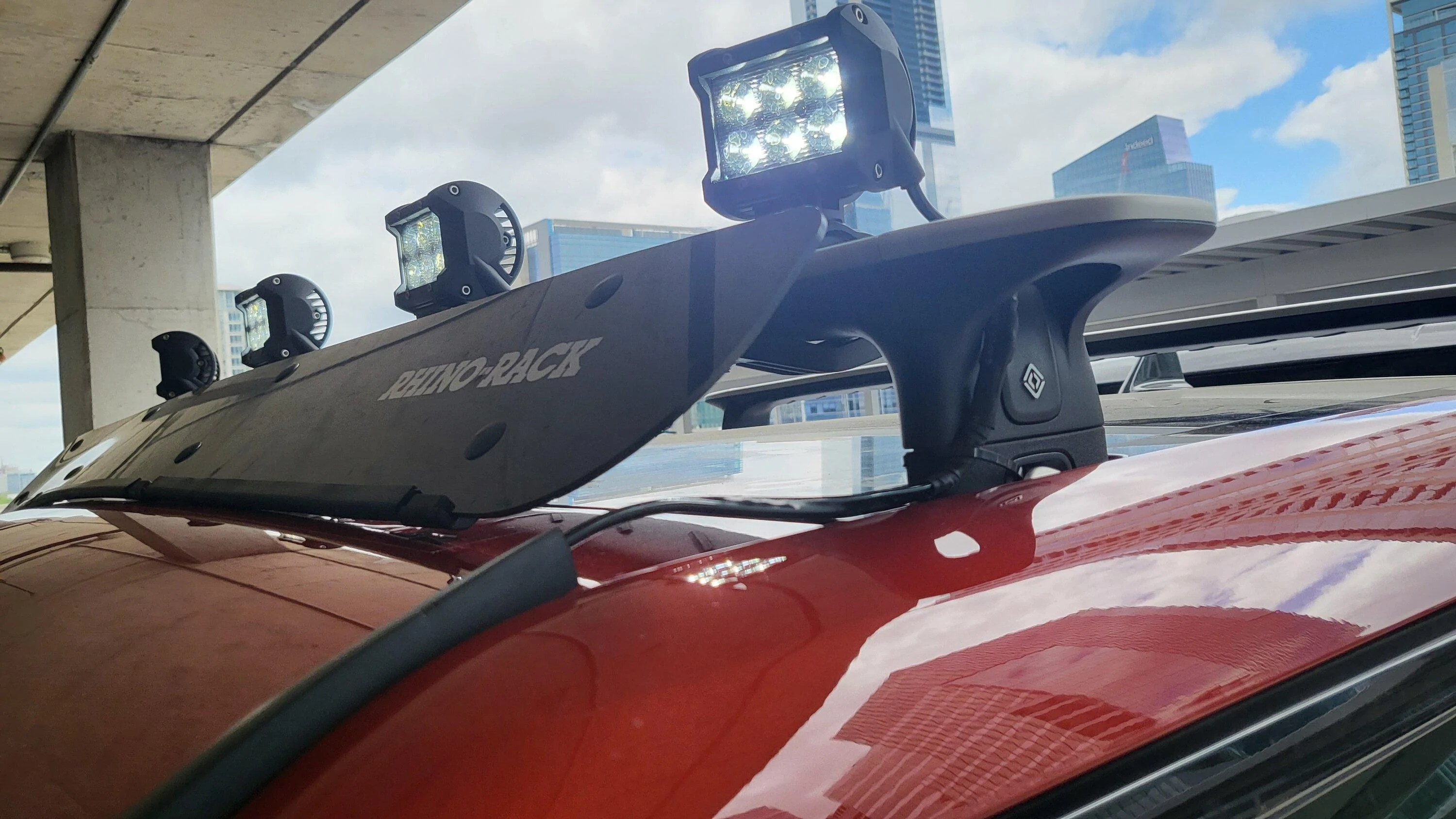

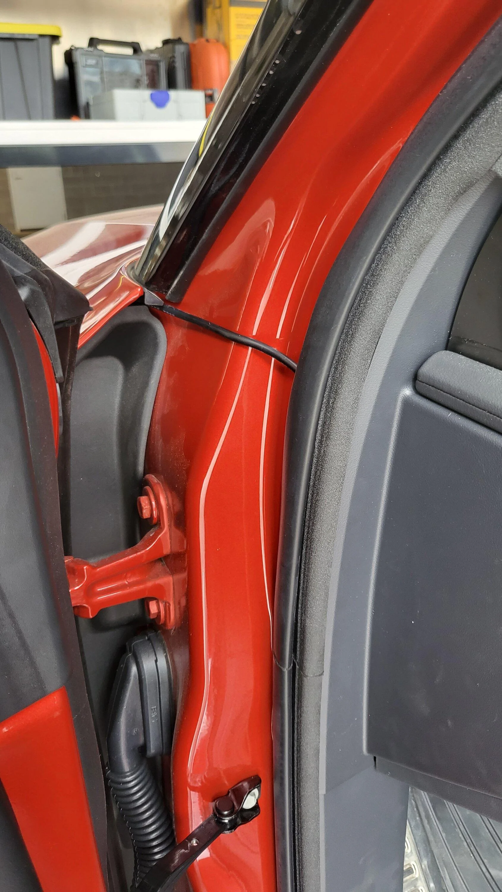

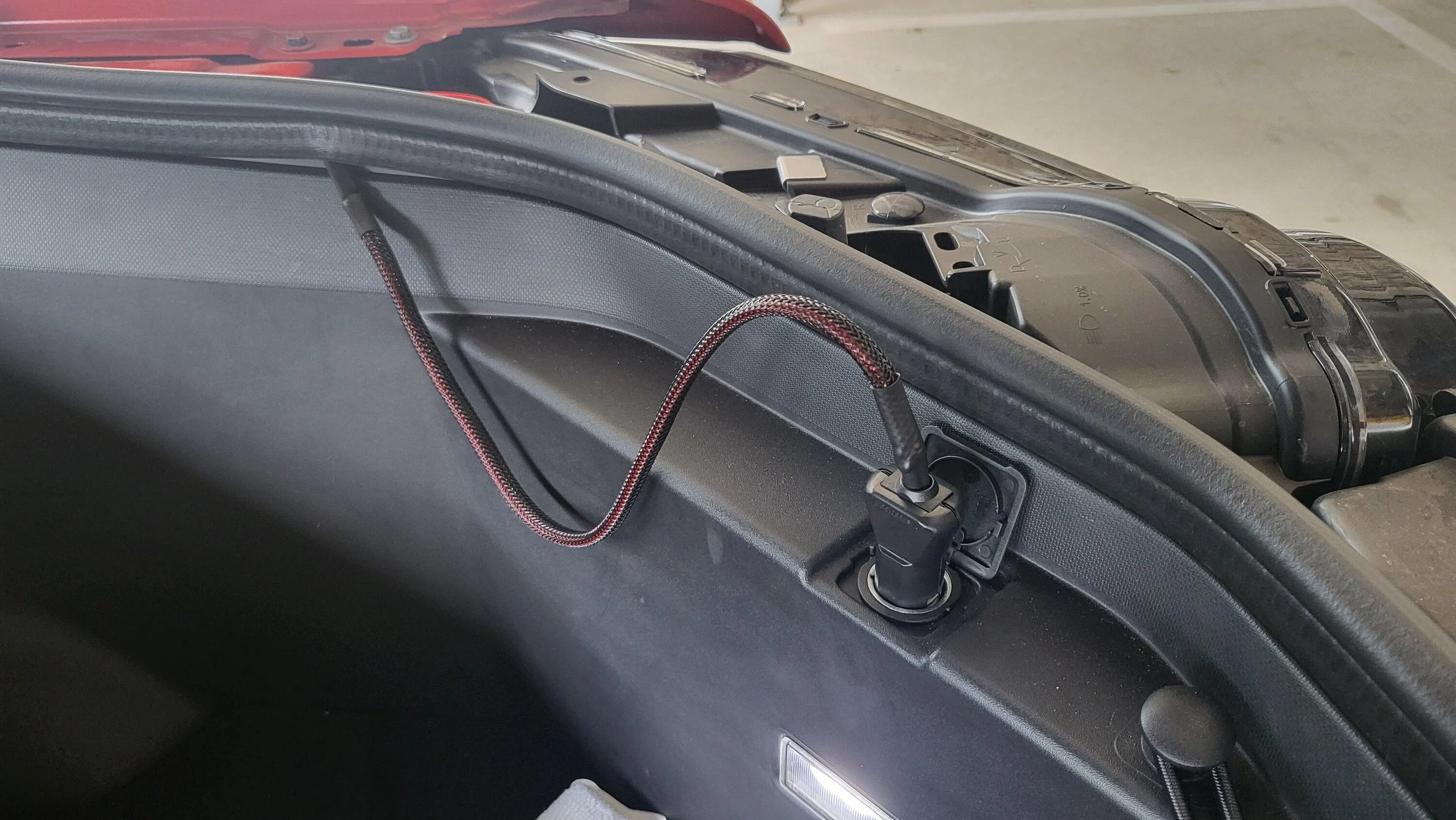

Rhino Rack fairing mounted to crossbars, Pod lights mounted to that. Wiring harness run down windshield with KC wire hider. Quick disconnects make the entire rig easily removable.

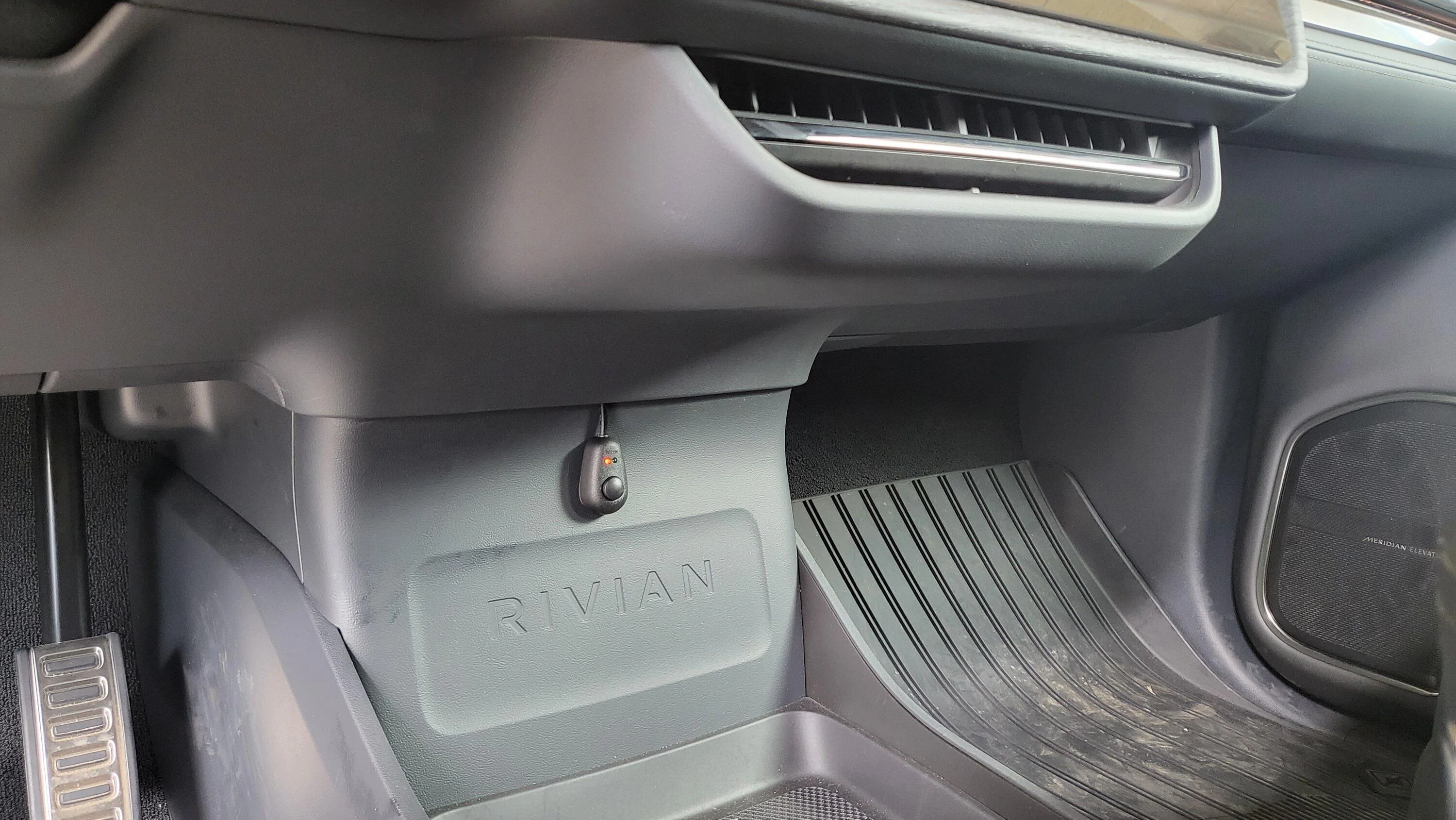

12v supplied in frunk from the outlet there, relay mounted up behind tub, switch in the cabin.

Cool,
Im thinking about adding lights.
How does the routing for the wiring to battery look like.
Also the switches.
Im looking for some bluetooth enabled switches so i dont need a switch in the car.

How are you delivering power?

Would love to see and hear about the details of wiring. Just got our S and looking to mount my emergency lights, when needed - don’t want them on all the time. Unfortunately, our S does’t have the 12v under the dash - was hoping for that. On my Discovery, ran a pigtail out the B column and plugged in just closing the cord in the door (padded area on wires). Rivian not being overwhelmingly helpful regarding power supply for lights and sirens. ’Don‘t support 3rd party options.’ Professional installer looking around at options and would love to see yours. Thanks for sharing!

Unfortunately, the frunk and under dash 12v got deleted on our S… seems to only push us towards putting items directly on the 12v batteries.

The wiring harness is still there, FYI. There's another thread on here describing it.
