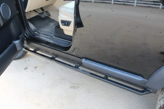

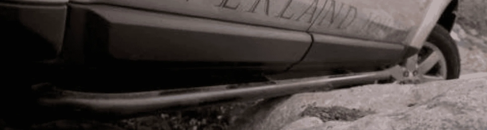

Having functional sliders on the Rivian is complicated by the fact that the door sills wrap under, and there isn't a frame that sticks down below the sills. They will probably double as steps when the door is open but I'm hoping the design we settle on doesn't stick out farther than necessary. Will end up losing a small amount of ground clearance, but I think it won't be that big of a deal.
I think the LR3/LR4 is the same in that the door skins cover the rockers so the dirt stays outside. This pic does a better job showing what I’m trying to describe where the lighter gray rocker cover plastic stays with the door, so it’s absent on the open front door and shown on the closed rear door:
Rivian R1T R1S Aftermarket Rock Sliders options? lr-slider01-555x370
It may be worth looking at how some of the LR3/LR4 rock sliders are fabricated to see if someone already has a solution for this.
Most likely they are going to end up with a design similar to the bronco ones here. Much heavier duty than any of the ones I've seen posted up so far for the Rivian. (more mounting points than the Bronco ones though)

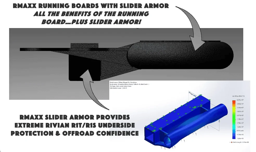

Guys, pretty straight forward. The rocker sliders provide underside vehicle protection - you can 'slide' your truck over rocks or obstacles without damaging it. You can slide the truck up into an obstacle and not destroy the rocker panel...basically, if you're offroading, it's a good investment.
Running boards are just steps.
On the Rivian, we made two products:
Running boards - for those that just want steps for kids, mom, or whatever.
Running boards with integrated Rock Sliders - all the benefits of a step, PLUS a full hard-core rock slider. You can slide over rocks, jack up the truck, step into it, etc - all that.
