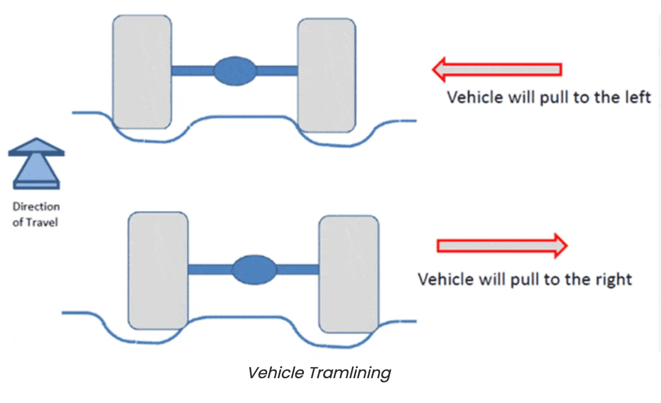

Mine still pulls slightly right after a SC alignment where they acknowledged my previous ā€œpulls rightā€ complaint.
However, Iā€™ve noticed if I drive in the left lane on a highway, the truck will pull LEFT.
This leads me to believe that the truck, because of its weight being 2X any vehicle Iā€™ve ever had, just wants to follow the crown of the road. It wants to fall down the slope gradient.
Not saying anyone is wrong - my first complaint was obviously valid for them to do the work. I was just surprised I could make it go the other direction in the left lane. It still doesnā€™t drive as straight as my rental I had the first 5 weeks of SC visits.
This is known in the industry as "tramlining".
I was thinking the same was possible. I tried to get a feel for it on stretches of I-80 that had the least amount of visible "crown". However, I also let it go into some right hand, subtle curves and it still wanted to go right, where the force of the weight should have carried me into the adjacent, left lane. It wasn't the drive assist causing this to happen.
