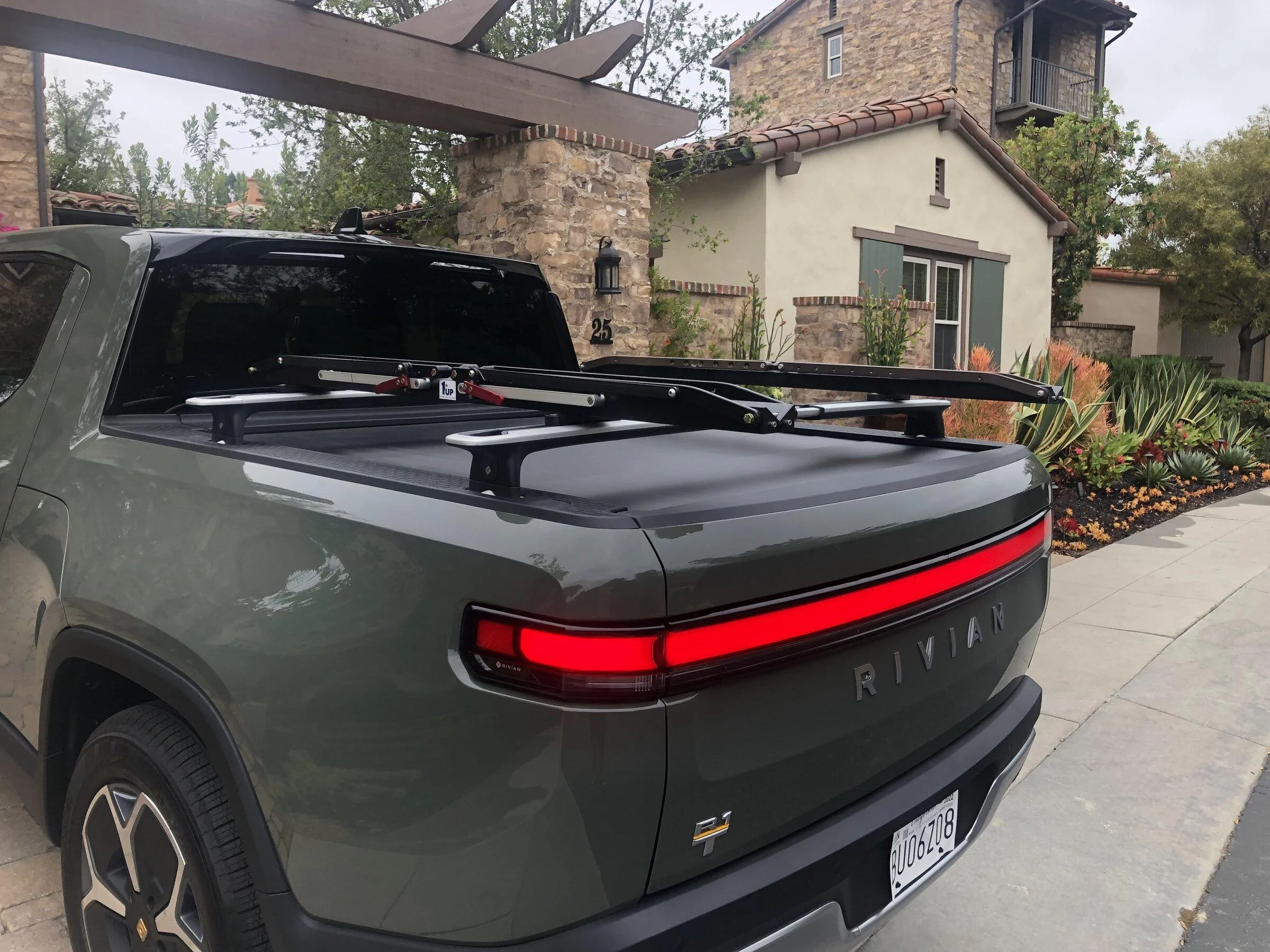

I'm a big fan of the 1Up bike racks and have had one for several years. With the purchase of the R1T and the Rivian Crossbars, I had to switch from the traditional 1Up mounts to what they refer to as "flush mount". I've added some pictures for reference.

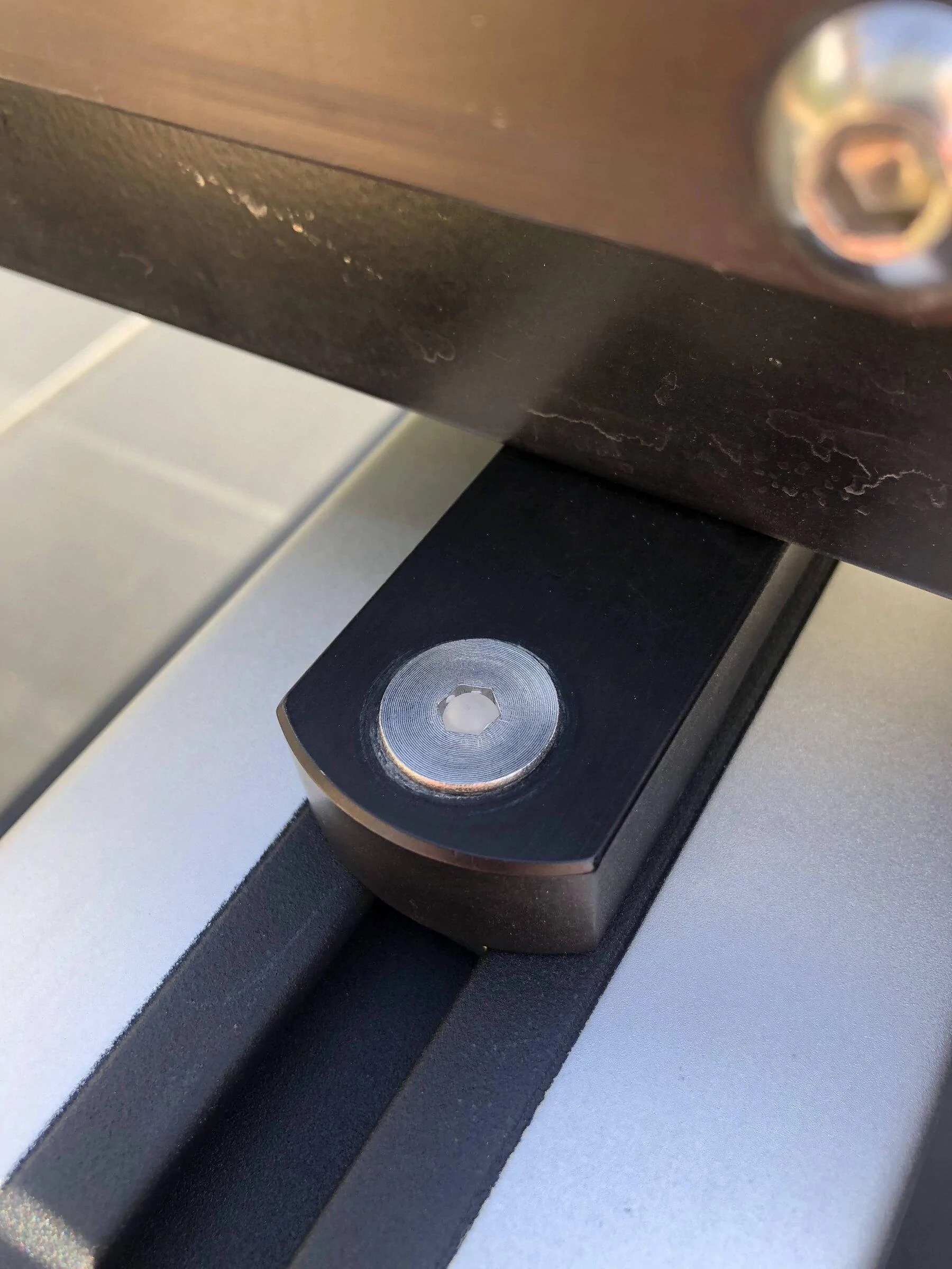

This new flush mount however has a security flaw. The hex bolt that secures the rack to the cross bars is easily accessible to anyone with the right sized Allen wrench. It would be fairly easy to unbolt the rack with or without a bike on it.

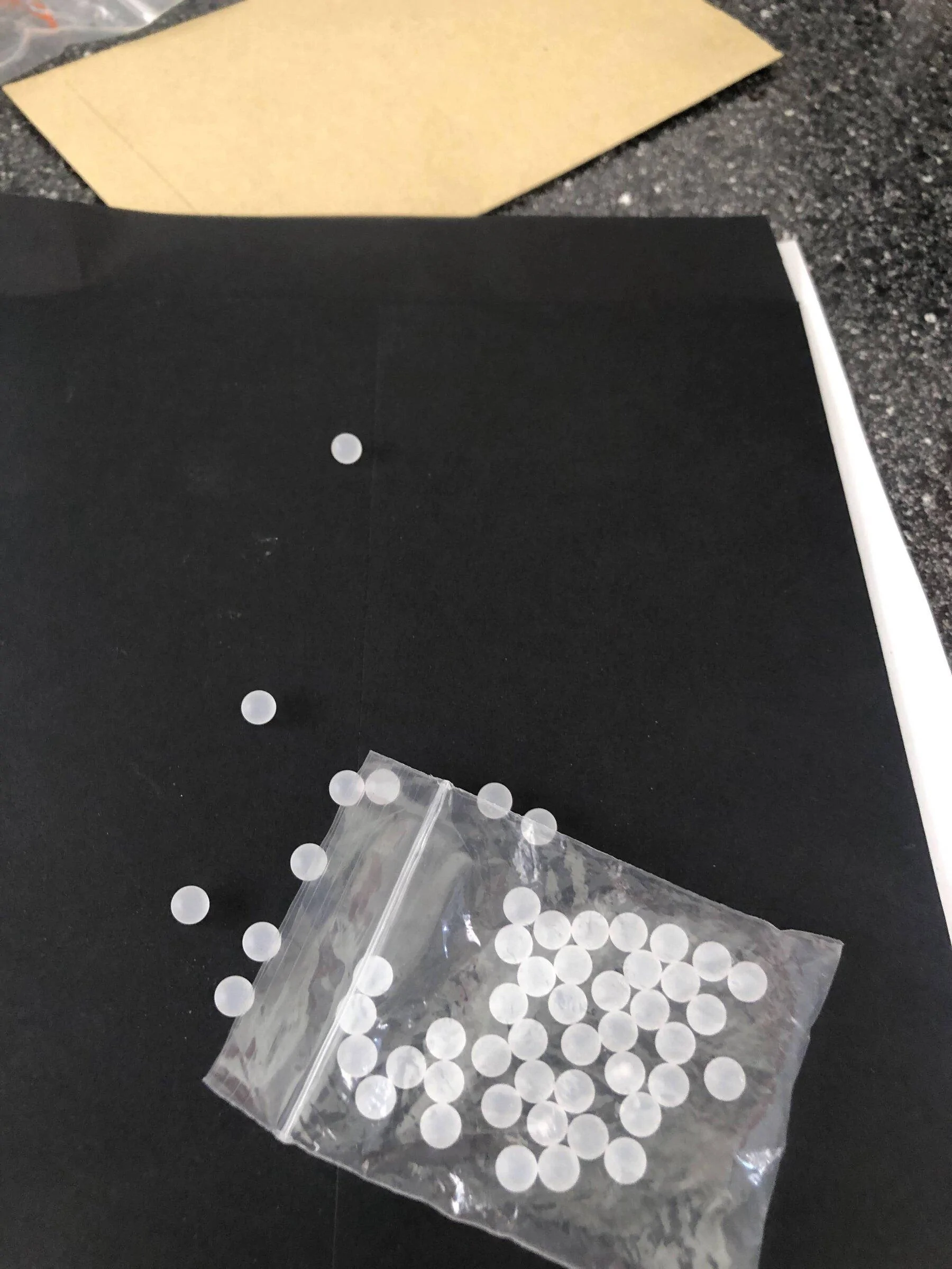

I can't take credit for the idea because I got from a buddy but I thought it was such an elegant solution that I had to share. I purchased a small bag of 5mm solid plastic ball bearings. Had to order a 100 even though I only needed 4. I then took the plastic bearing and tapped them into the hex bolt. The bearing are just a little larger than the hex and with a slight tap of a hammer, they are nice and snug.
So how does this prevent theft, you might ask? Well, it simply prevents an Allen wrench from fitting into the whole. Can't get the wrench in the whole, can't unscrew the bolt, can't steal the rack or the bike.
If I ever have to remove the rack from crossbars, I can simply pry them out with a pick or drill through them with a small drill bit. Plus, I've go 96 more available!

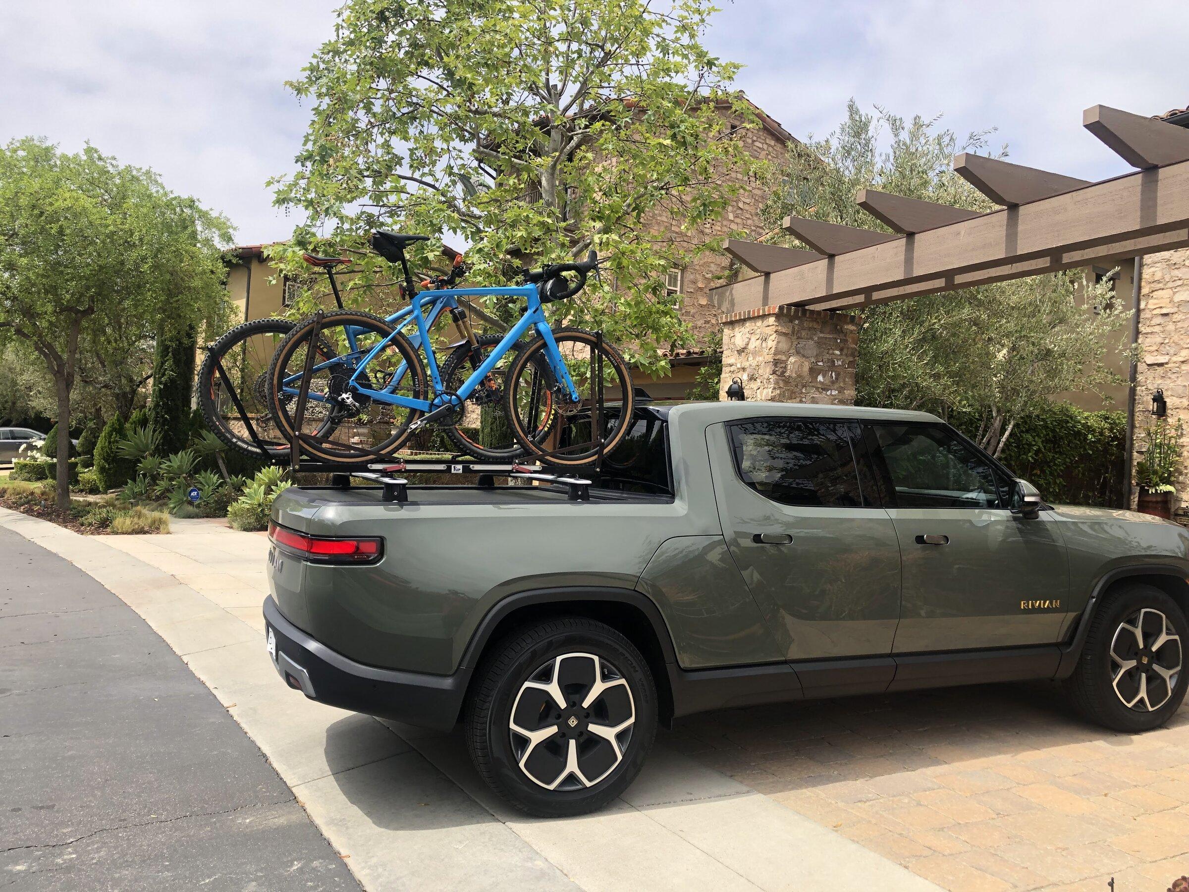

Rack solutions aside (well done there), love those bikes! Wouldn't worry about the rack as much as that beauty of a Ripmo.
2 questions for you: What size are the bikes? How do you make sure your front wheel holder on each rack isn't going to contact the spoiler /lip?
marbro67
Marc
Apr 22, 2022
Southern California
employed
The RIPMO is a 29” wheel and the gravel bike is a 27.5. To prevent the tire rubbing the spoiler, I used a sharpie to mark the rail so I know how far to lift the front part of the rack. So far so good.

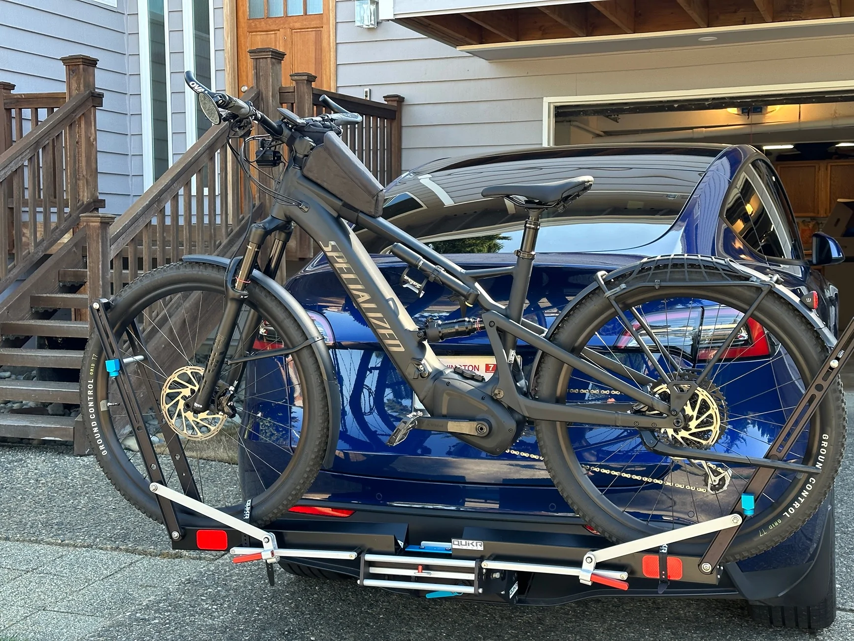

Can you explain more about the "flush mount"? The only thing I see on their web site is bike racks that are hitch-mounted. Are these flush mounts made by 1Up and can you buy them individually? thx

The ball bearings are a great and cheap solution. Not knowing what size that bolt is, I was going to ask if you could replace it with a security style like these:
I wanted to replace with tamper-resist, security bolts. I asked 1UP the size of the bolts used. They are 5/16-18 x 3/4" long. These are the correct size and in stainless steel. The replacement bolts and tool are less than $30 shipped.
Tamper-Resistant Torx Flat Head Screws
5/16"-18 Thread, 3/4" Long, pack of 10
McMaster Carr part number: 91870A270
https://www.mcmaster.com/91870A270/
Tamper-Resistant Torx L-Key
with Standard Tip, T40 Size
McMaster Carr part number: 55525A32
https://www.mcmaster.com/55525A32/

It worked like a charm. See pic for fix. I replaced all four bolts.
