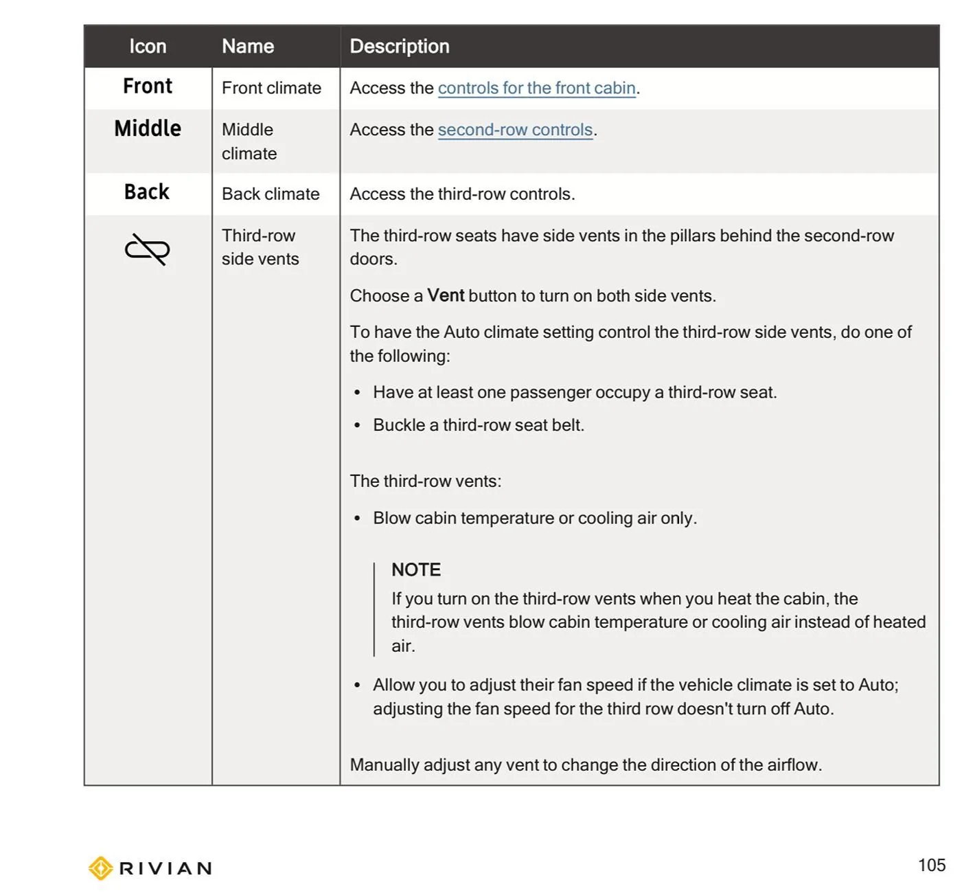

I have an idea - read the manual. The Third row has AC cooling, no heat.

@Zoidz no need to get snarky. Thank you for the pointer to the info.
I am trying to get 3rd row air cooling and heating.
Also, I have removed the seats and seatbelts in the 3rd row, so it seems "auto" climate setting will not work for me.
So, I am still looking for a creative solution.
