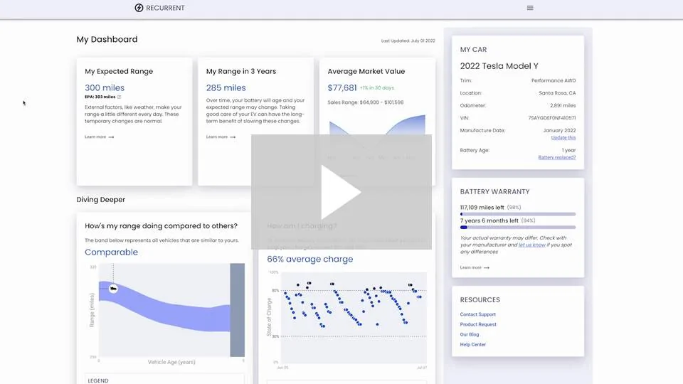

Recurrent Auto now has R1T as a choice of an EV. It's an easy way to get a monthly report about your EV's battery capacity and range degradation. I've been using it for my almost 5 yr old Model 3 and plan to use it whenever my R1S is delivered.

Interesting - give data on the owned vehicle for them to sell and make money so a monthly report can be given to the vehicle owner
