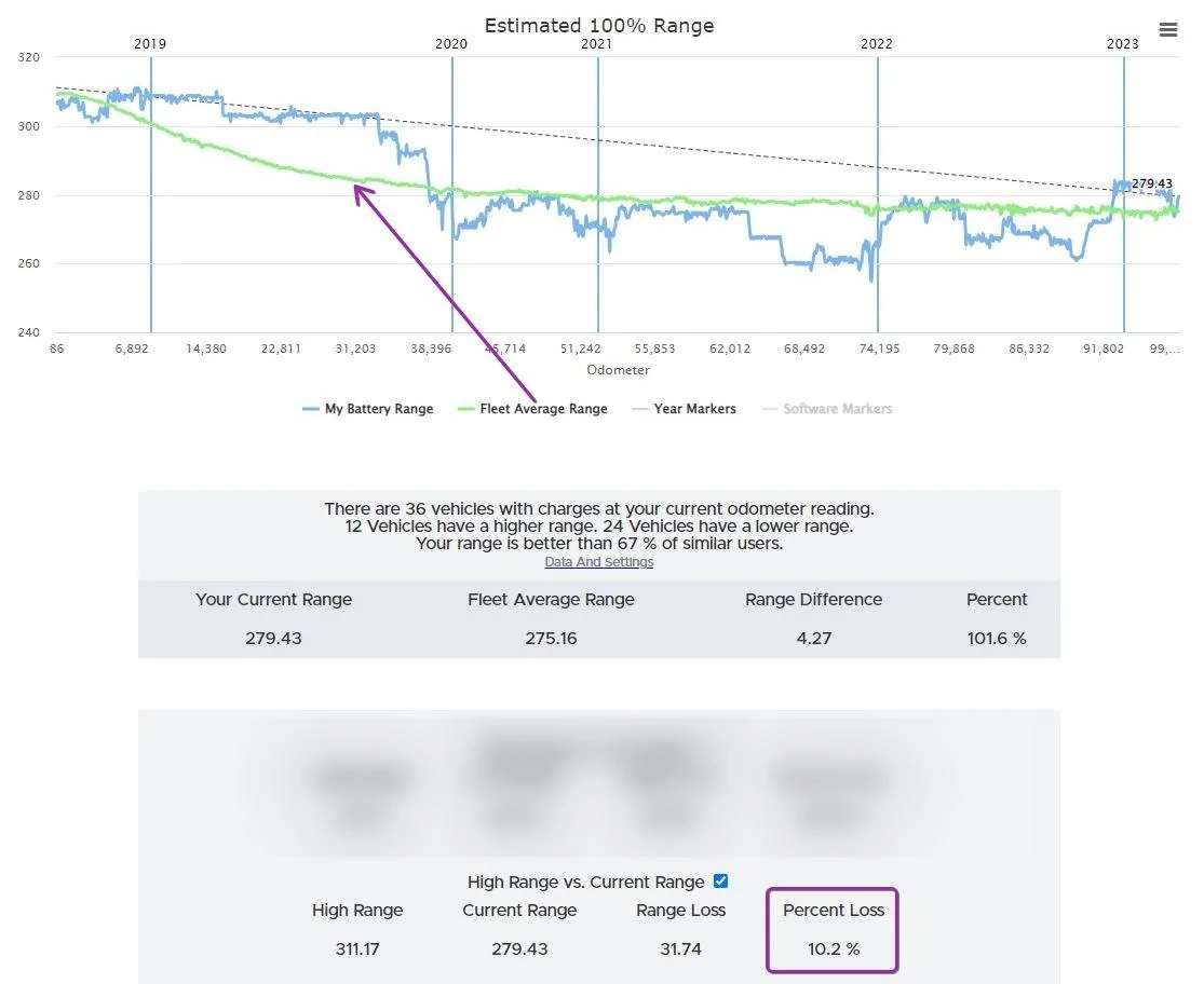

ASIDE: Re: Tesla Model 3 degradation
Here is my kid's 2018 TM3 (blue) and similar TM3s averages for the TeslaFI-COM 3rd party tool for comparison which is all pretty close to 10% it seems.
