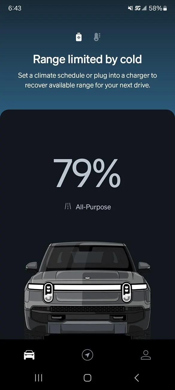

You have to click on the little battery symbol for the text to show. My battery was at 16°.

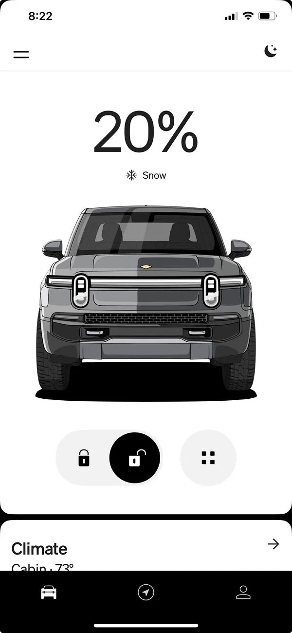

What operating system does your phone use? I don't have that 2nd row of icons across the bottom. I also haven't even seen the battery symbol. But my battery hasn't been as cold as yours was. I wonder if it's set at the same point as the truck warning that regen is reduced etc. when the battery is cold. I don't remember what that exact temperature is, but think it's around 20F or so. Screenshot of what I see on my phone (old iPhone X).
Rivian R1T R1S Anyone noticed latest update notification of lower range from cold ? iPhone display

Are the battery and temperature icons always displayed? Or do they only appear when the battery is cold?

I'm guessing only when cold. Battery is 45 now and no icon on app
