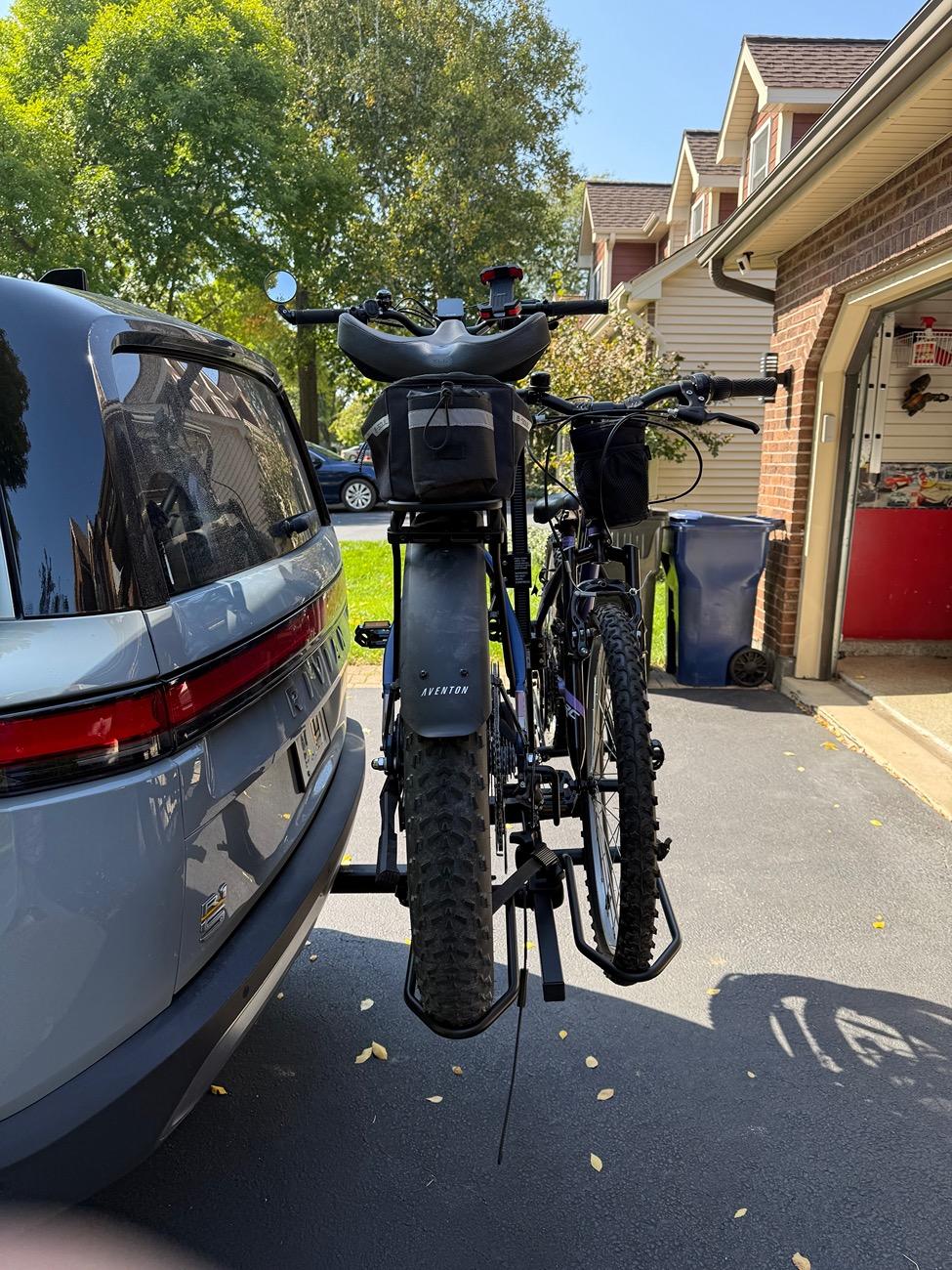

My ebike is pretty heavy and may be buying my spouse a new ebike. But because hers new one potentially has a dropped center bar, and I am a little tired of the workout I get while lifting up my bike on a conventional horizontal bar rack, am looking for a heavy duty e-bike specific rack.
I think mine is easily over 70 lbs with the batteries taken out, then adding a second bike, safely the rack should have 160-200lbs capacity along with fitment for a pair of fat tire bikes.
I'm wondering if anyone has done this yet, given that the R1T has a slightly inset trailer hitch and a long flip-out on the tailgate.
So it might be similar to this type of rack, but with higher weight capacity, and a longer stand-off from the truck; Standard fat tire bike rack
All of them seem to have a marginal capacity 60#/bike which is a little light of what's needed.

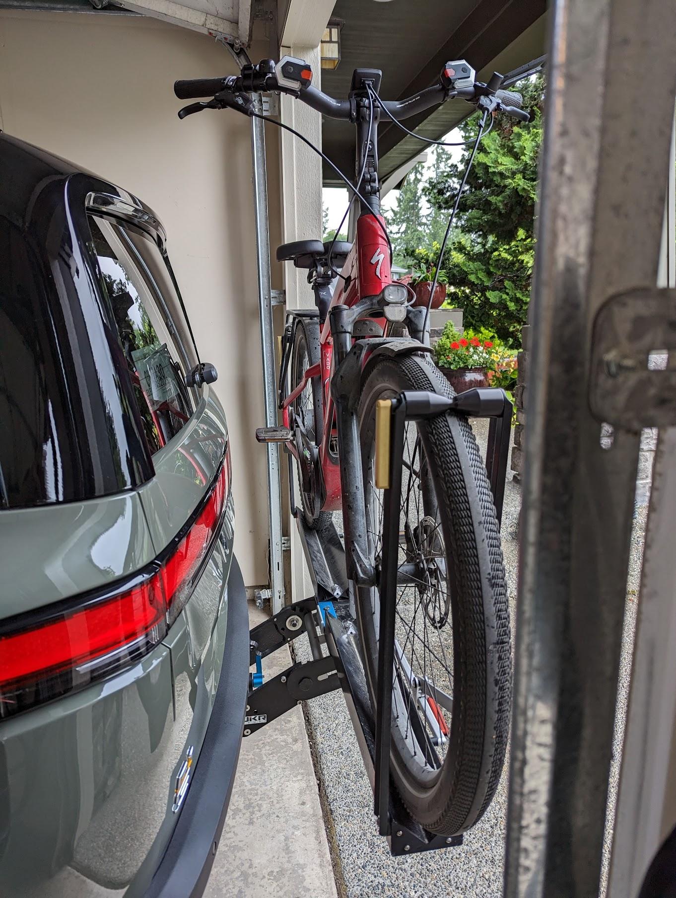

I have the 1UP Super Duty hitch rack and have been using for years to haul my heavy Specialized Turbo Levo which is also not light. Works perfectly

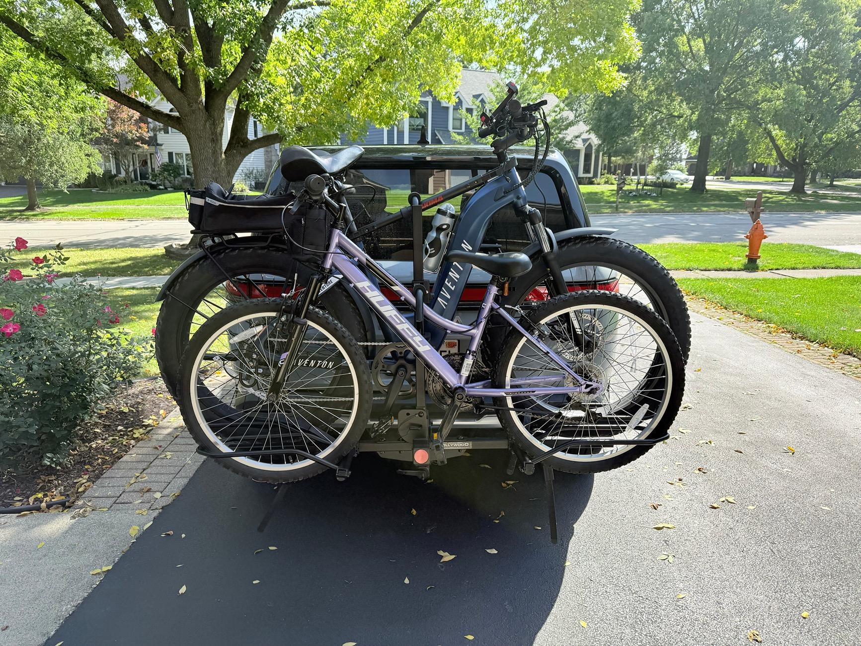

I also have the 1UPUSA Super Duty for my 2 e-bikes, Rad Power, weighing 70lbs each.

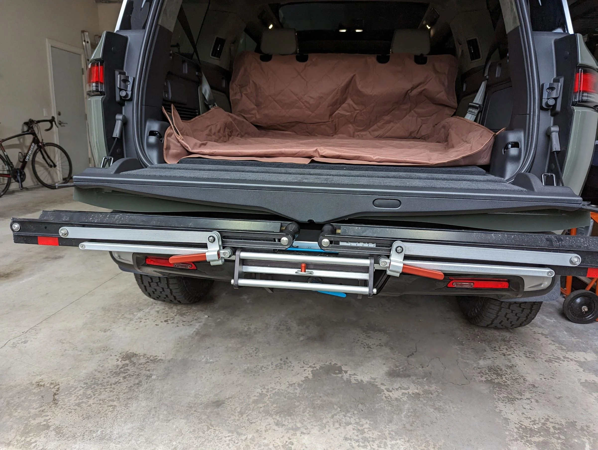

I got the follow-up to 1UP's product, the Quikrstuff Mach2. Largely because it doesn't need a hitch pin, but it also happens to support 120lbs per bike (at least for the first two). And because it secures the bikes by their tires, it doesn't matter what type of top bar your bike has. It works with fenders (at least on my bikes), although you want to stuff a rag over the fender to prevent rubbing.
I only have a single-bike rack because my wife's bike fits in the car, but they have modular add-ons that allow you to carry up to 4 bikes. They also have a ramp that locks on to the rack; you can use that to roll your bikes on rather than lifting them.

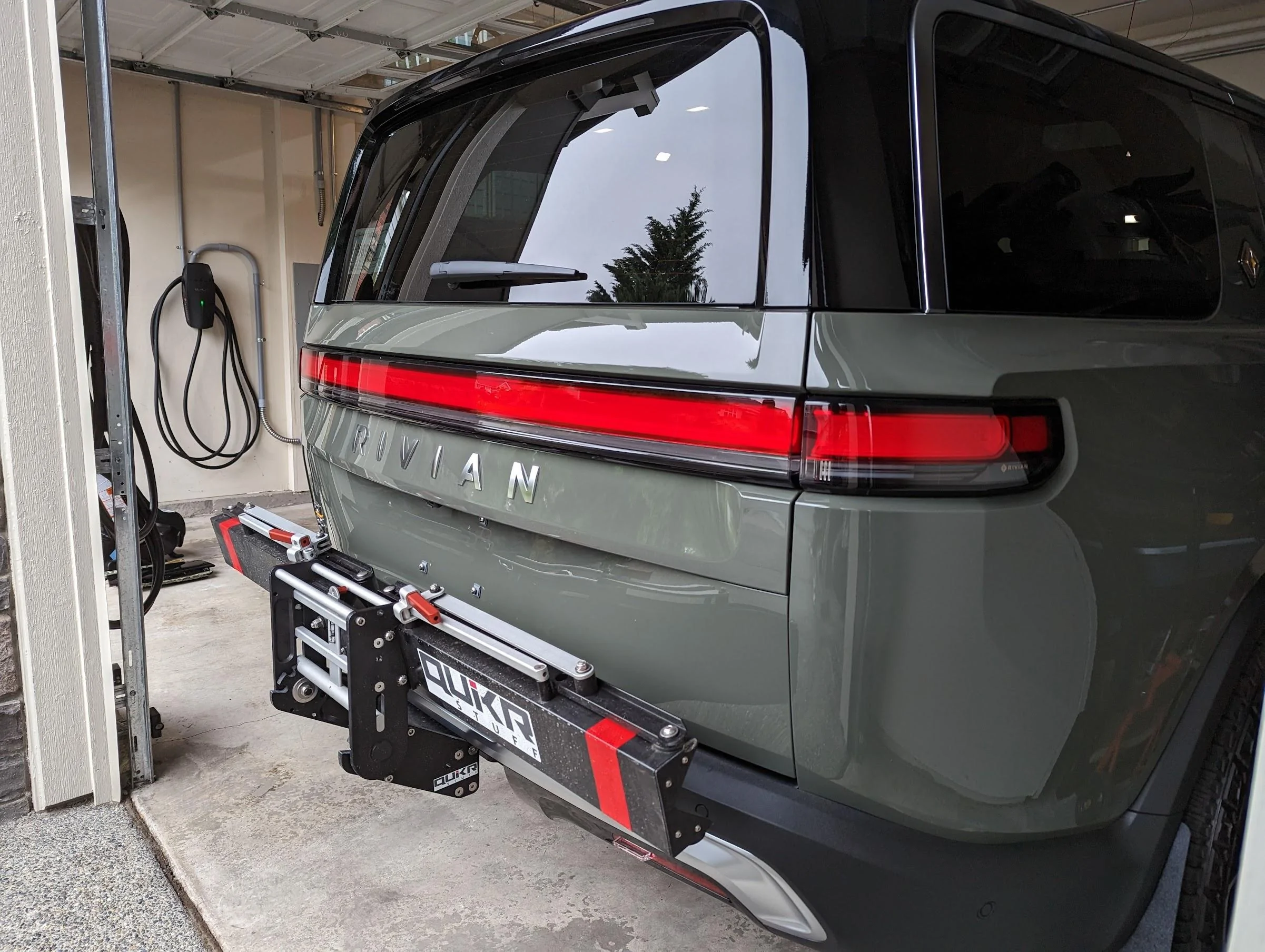

I don't know how it will work on an R1T, but here's some pictures of it on my R1S. It's almost frighteningly zero-tolerance, but everything works and fit. I love that the entire thing can be operated and adjusted without tools, and how easy it is to put bikes on and take them off.

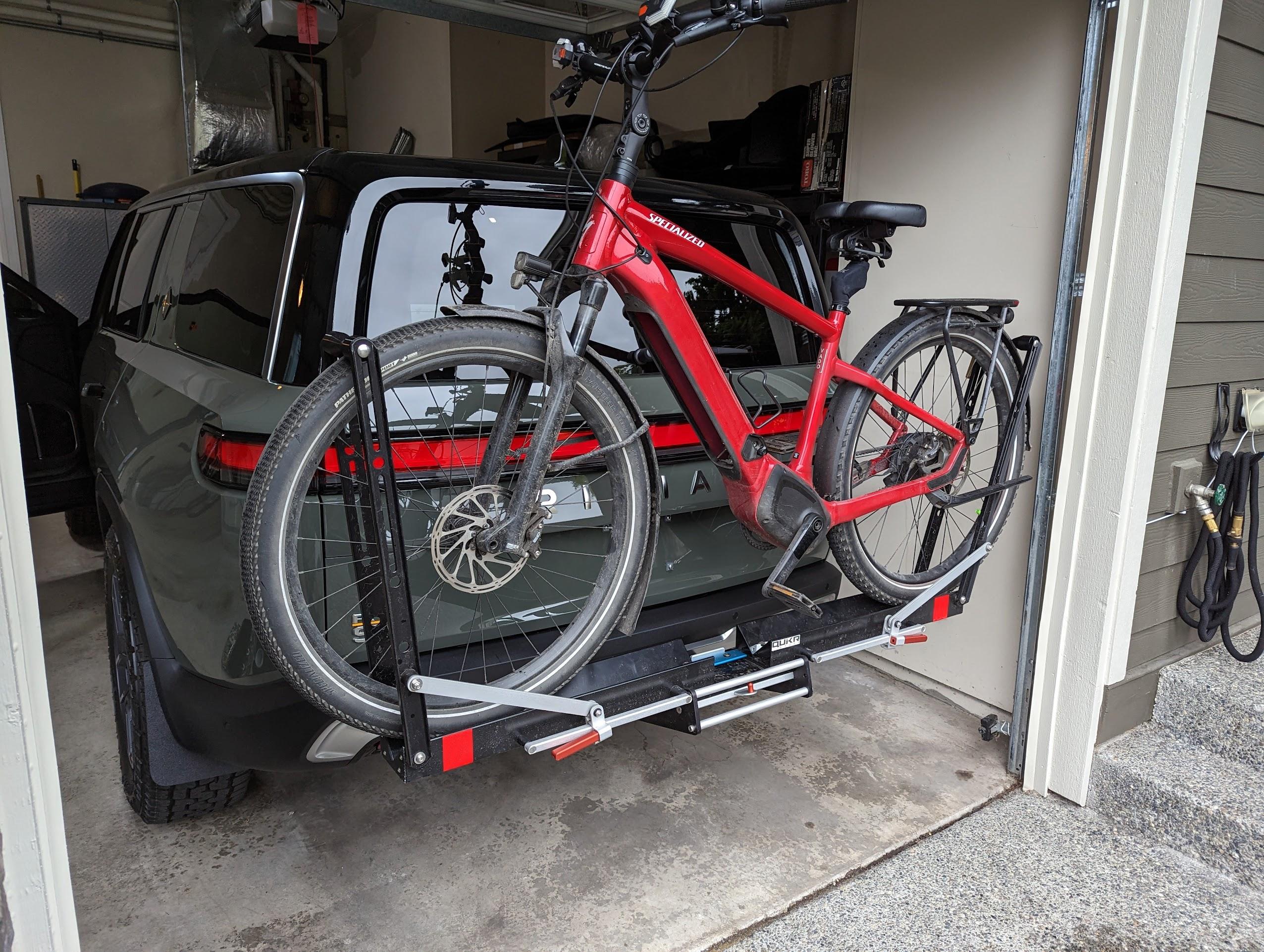

Here's my 60lb ebike on the Mach2 rack. It's up plenty high, nothing is ever going to scrape...
Rivian R1T R1S Anyone racking Fat Tire E-bikes with their Rivian? BikeOnMach2

Here's the rack empty:
Rivian R1T R1S Anyone racking Fat Tire E-bikes with their Rivian? Mach2 empty

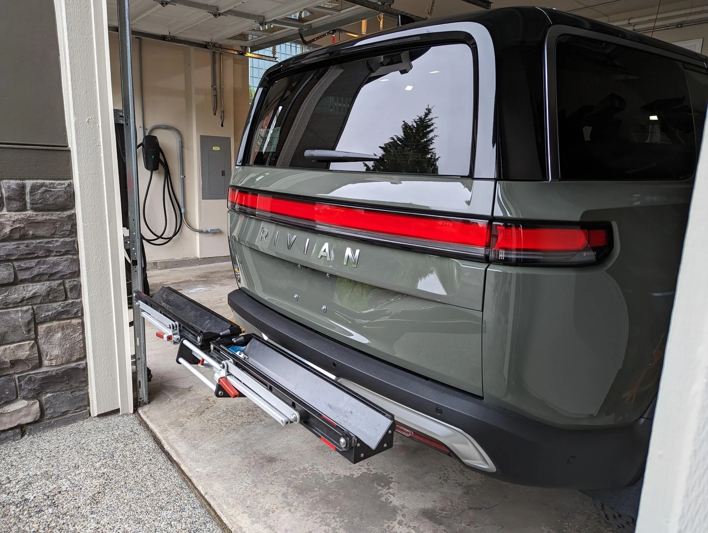

And here it is folded. You can still open the top part of the hatch, but not the bottom:
Rivian R1T R1S Anyone racking Fat Tire E-bikes with their Rivian? Mach2 folded

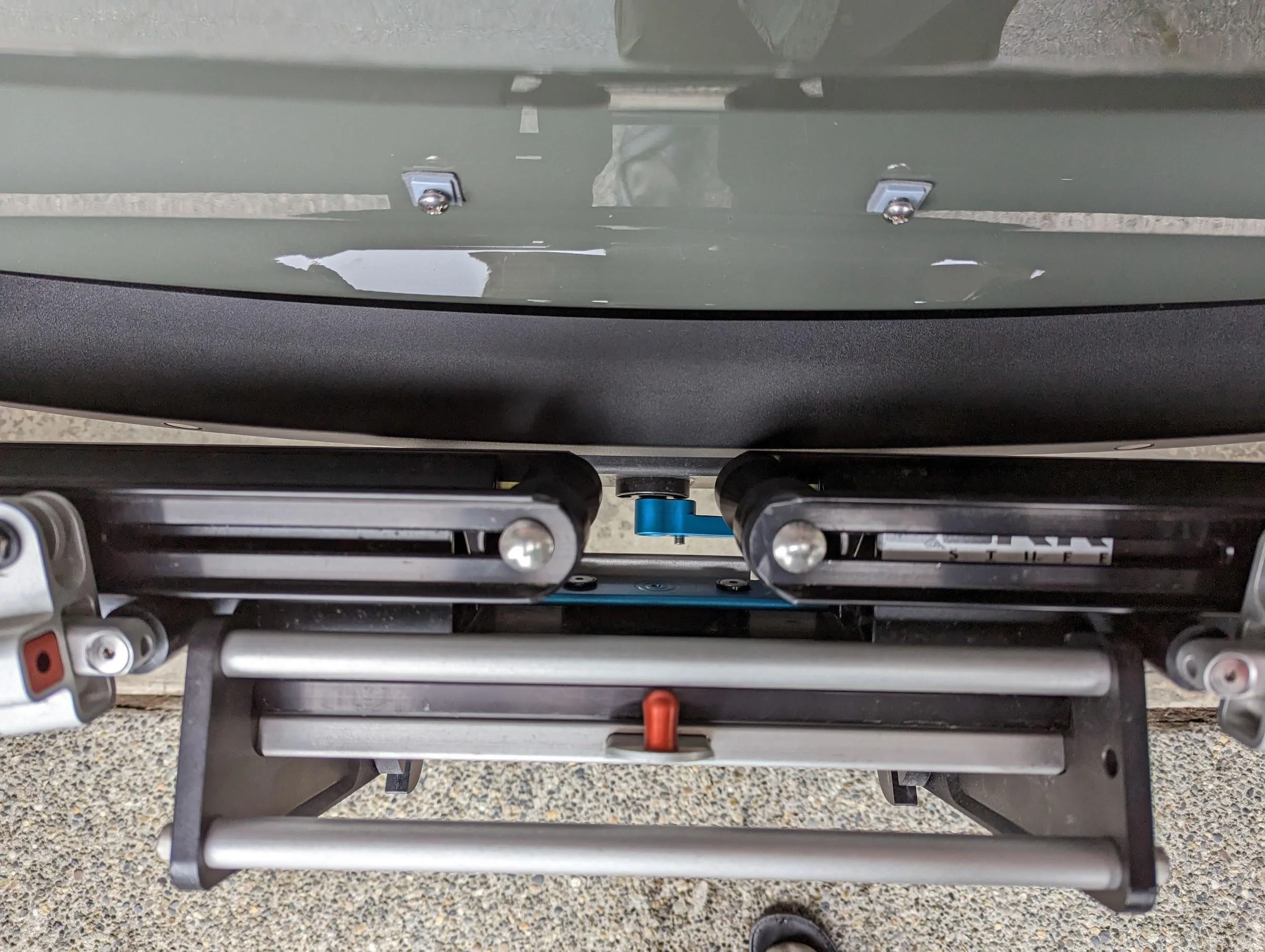

This is looking down when it's folded. This is what I mean by zero-tolerance:
Rivian R1T R1S Anyone racking Fat Tire E-bikes with their Rivian? Mach2 folded, top view
If you leave it flat rather than folded, you can open the bottom part of the hatch - once again with almost zero tolerance:
Rivian R1T R1S Anyone racking Fat Tire E-bikes with their Rivian? Mach2 flat, hatches open

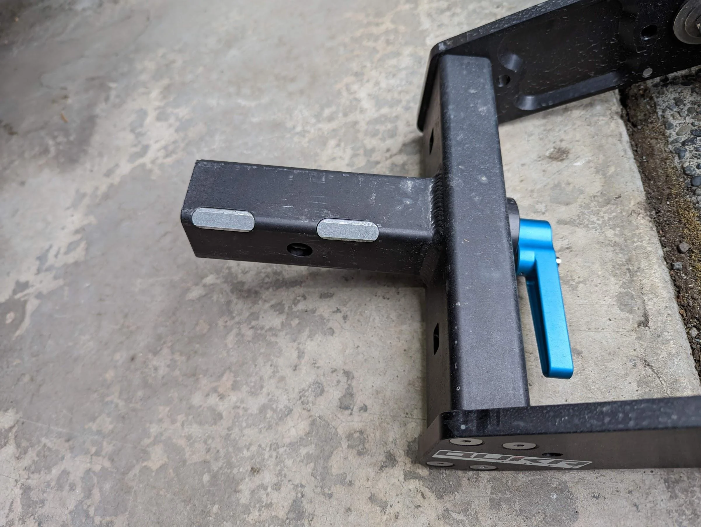

Here's what you plug in to the receiver. Note the two silver "pressure pads" that secure the rack in the receiver when you turn the blue handle on the front.
Rivian R1T R1S Anyone racking Fat Tire E-bikes with their Rivian? Mach2 stinger

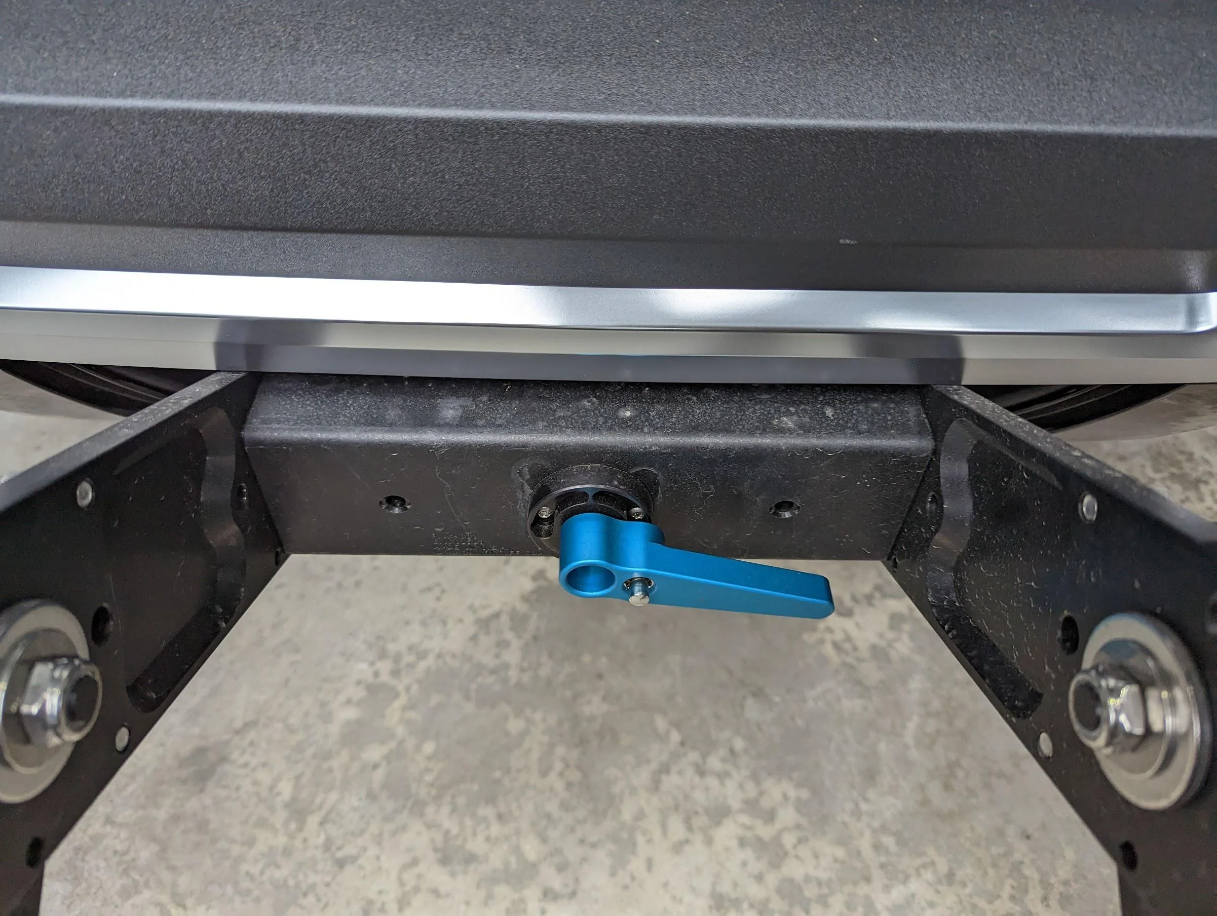

Here's what it looks like when inserted. Note that you can just barely see the end of one of the pressure pads. They are supposed to be entirely inside the receiver; but this is as far as I could get it, and I'm pretty sure that's going to hold it in.
Rivian R1T R1S Anyone racking Fat Tire E-bikes with their Rivian? Mach2 inserted

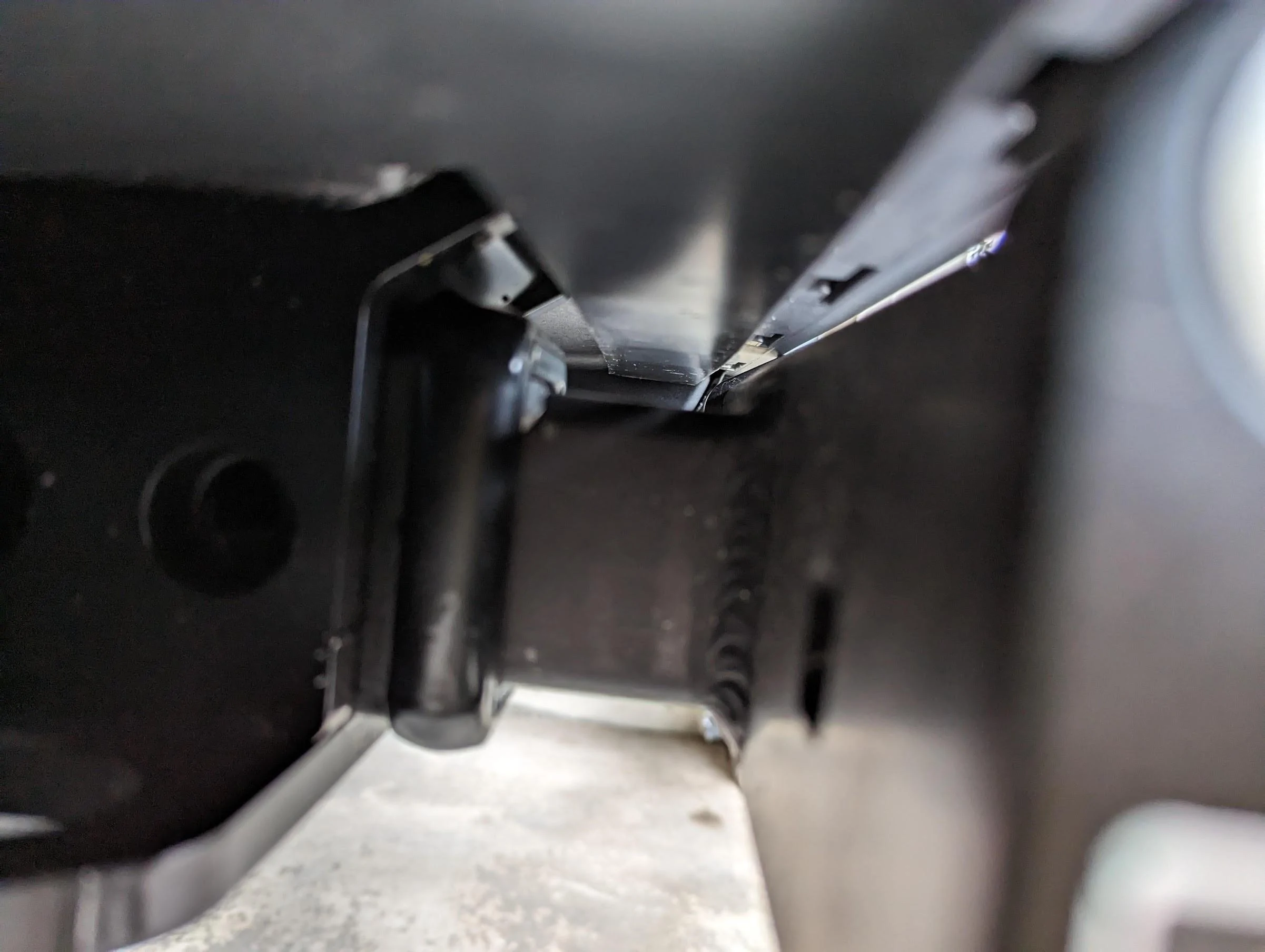

Since it's pressed in all the way, the side risers press against the trim, which I'm not terribly happy about...but I guess even if it gets damaged, you're not really going to see it there.
Rivian R1T R1S Anyone racking Fat Tire E-bikes with their Rivian? Mach2 inserted, top view
