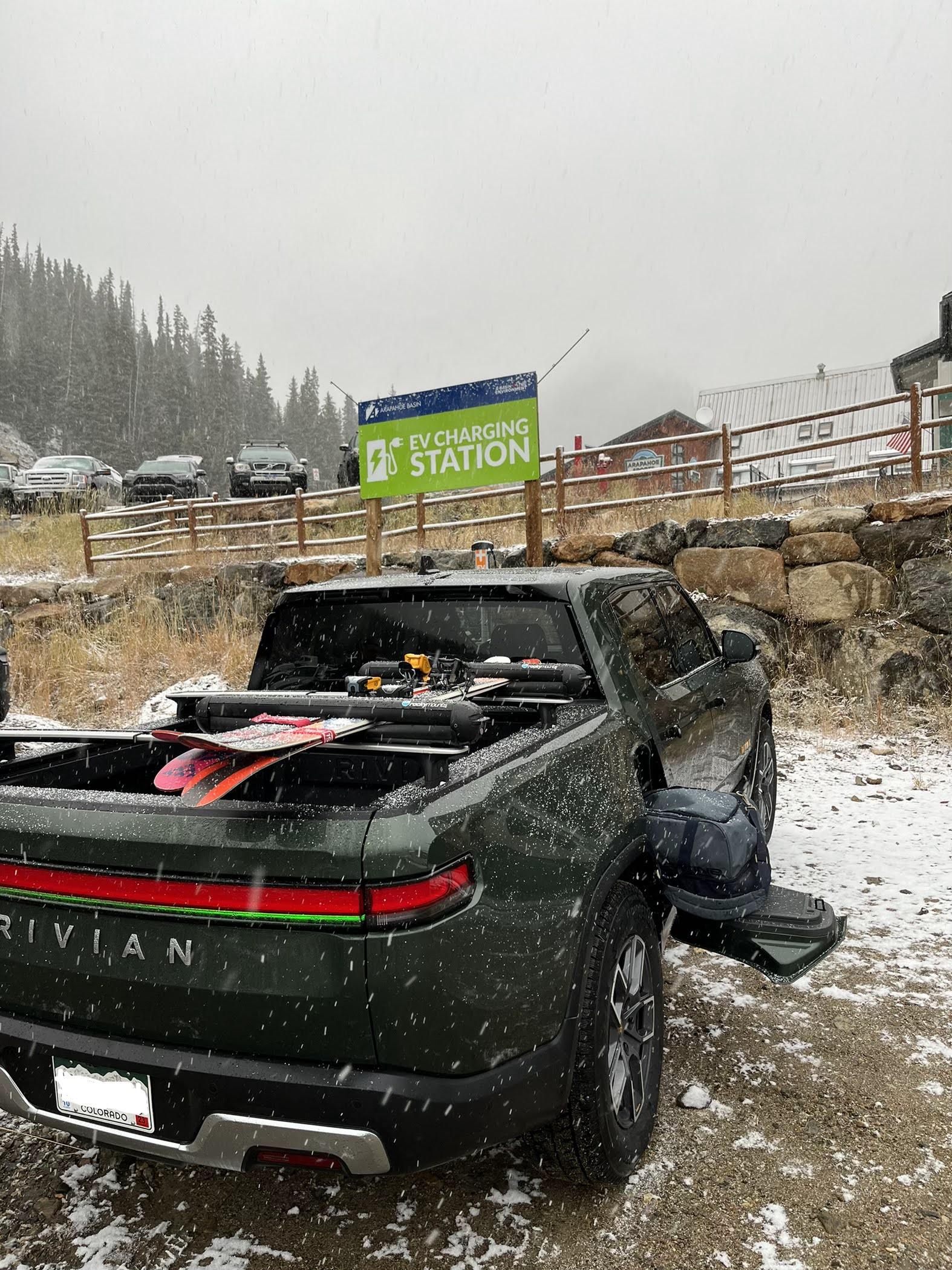

We’ve got a rocky mounts one with a t slot connection. It’s a little close on the t slot, right up to the edges of the t slot extents. Skis hang off a bit, but I also try to keep them away from the window.

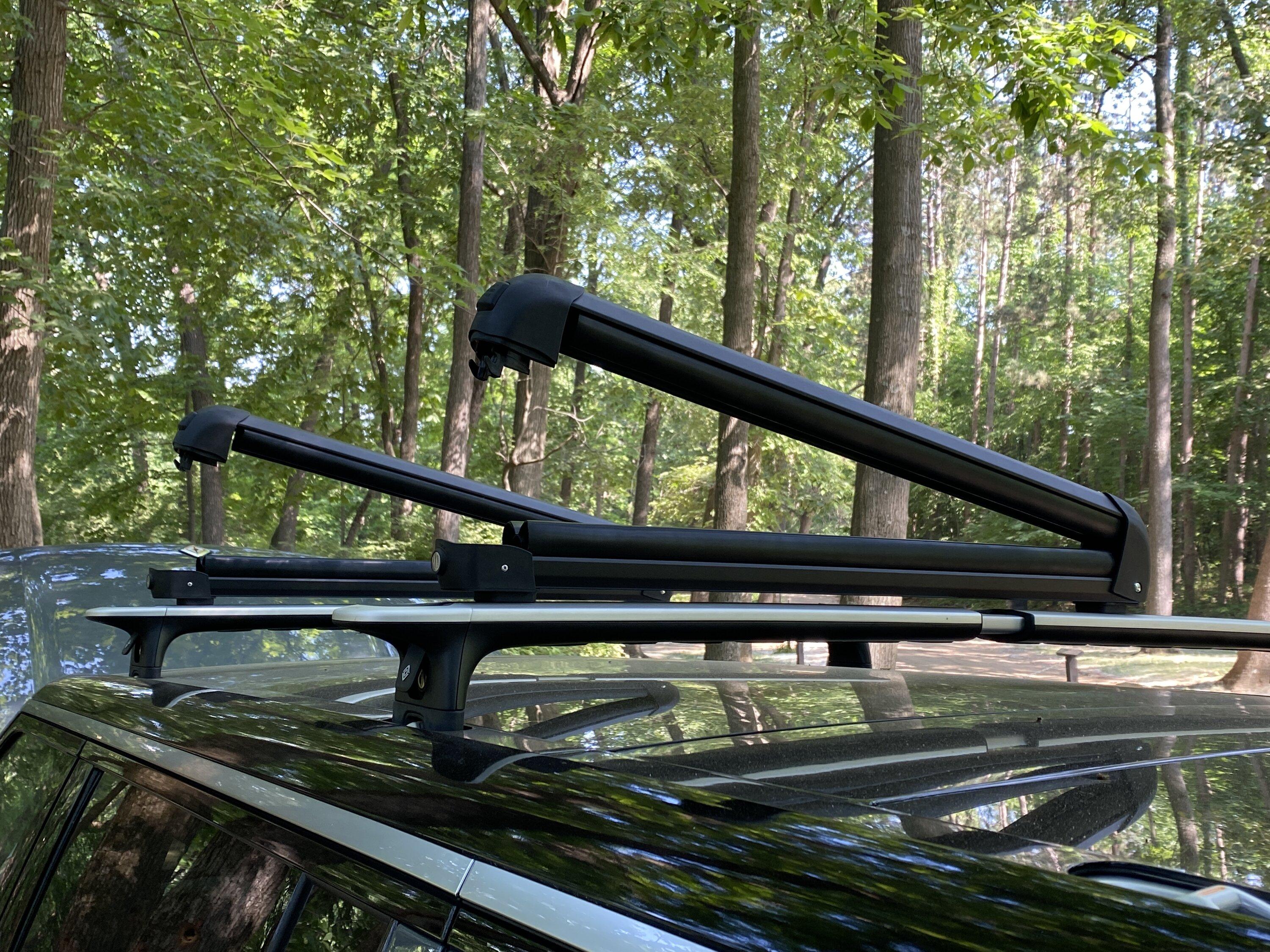

I mounted a Rhino-Rack 566 on the crossbars above the bed. Had to get eight longer metric bolts because of the thickness of the Rivian crossbars. Easy install.

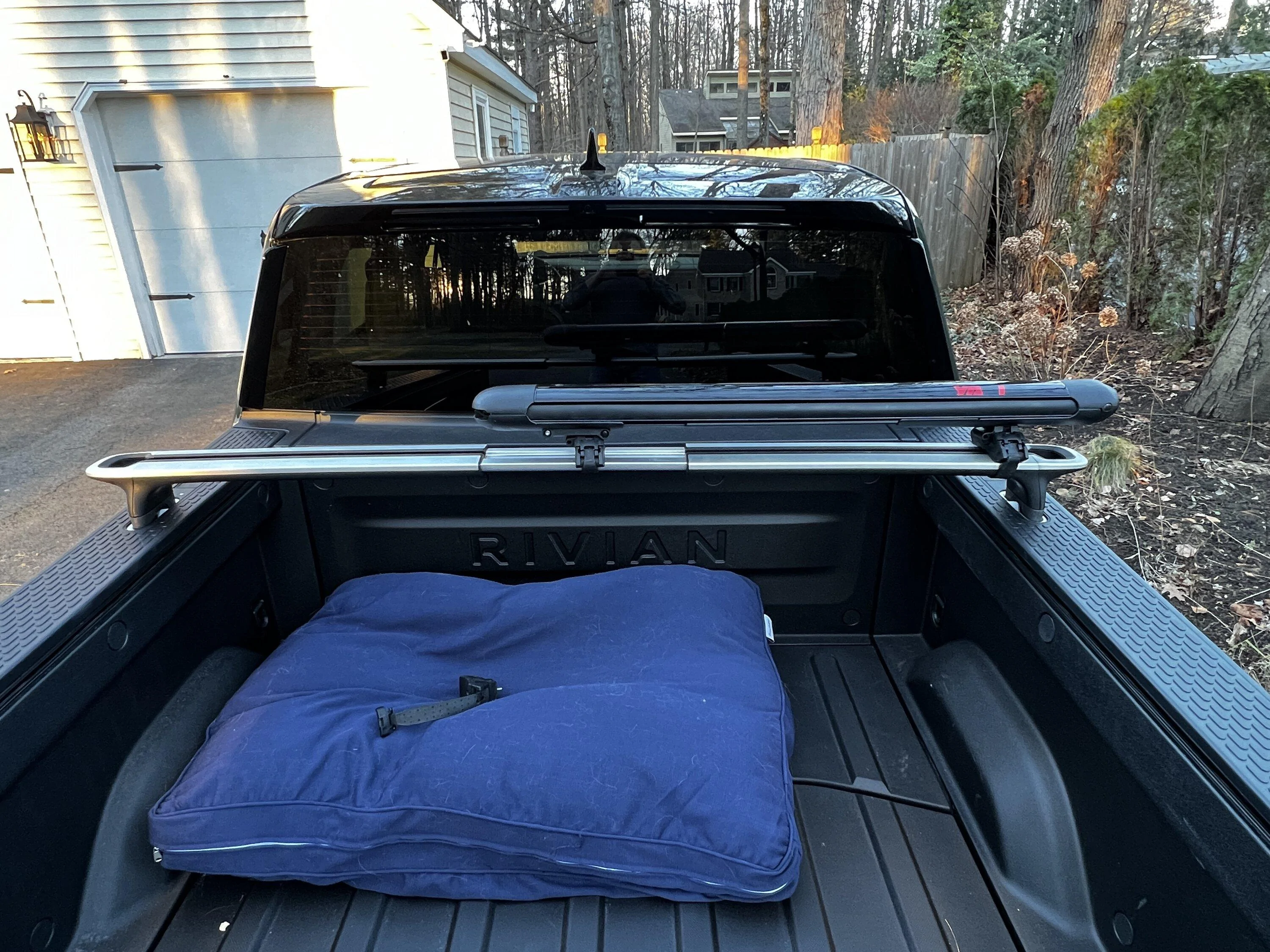

Ended up finding a used Yakima Fatcat on Facebook marketplace for a nice discount. Broke on of the twist knobs that attach the universal mount to the fatcat, but it looks like I can just use a standard nut to tighten it.
What is everyone’s opinion on lateral placemet of the rack on the crossbars. I want to mount it closer to the side for easier access to my skis. This places one of the mounts over the telecescoping sections of the crossbars. Is this okay? Or is the telescoping section not meant to bear any load?

You should be fine for skiis and boards, IMO. Regardless, the only way I could get those telescoping bars to sit down without movement is to cross mount an accessory that bridges the telescoping part and anchors each end. No big deal but feels like one shouldn't be testing the 250 lb capacity on the telescoping part.
Heads up it is only 17" from front cross bar to the rear glass so be careful with longer sticks.
FYI…I took those feet off my rhino rack, and the t bolt that’s included slid perfectly into the rack. Didn’t need to buy longer screws and gave it a clean look!
