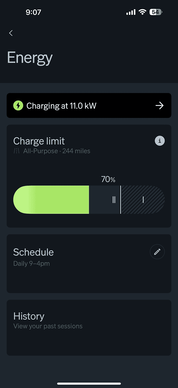

No problems here. iPhone 14 iOS 17.6.1 Rivian app 2.12.1
Rivian R1T R1S App not showing Charging Speed IMG_4324

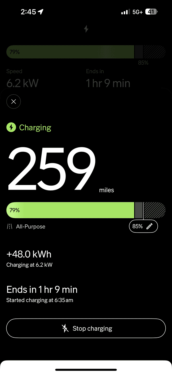

I updated my iOS to the latest release (out today) and it fixed the charging page on the rivian app.
Rivian R1T R1S App not showing Charging Speed IMG_0997
