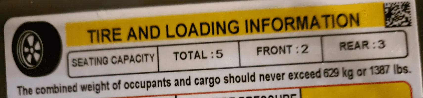

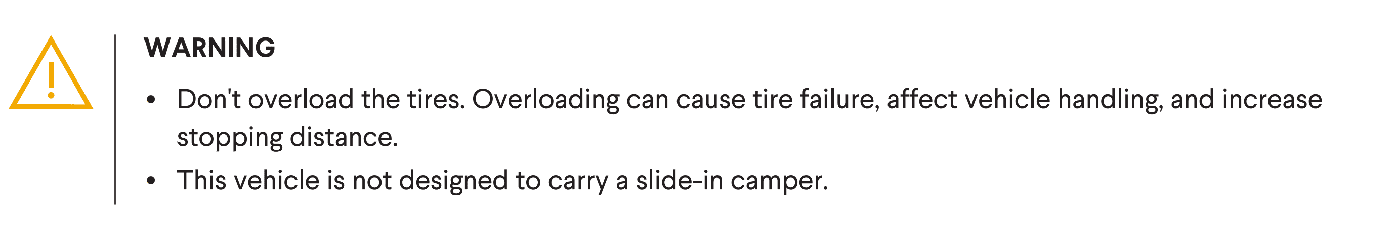

Believe me, I went down many rabbit holes before the truck was released in terms of a slide in. I then got the truck, looked at the manual, looked at the load sticker, did some math, and decided that even if I wanted to possibly void the warranty, the load math did not work.
Page 204 of the December manual:

My sticker (22" wheels, full size spare, underbody shield):
Rivian R1T R1S Campluxe Cabover for Rivian R1T 1675049272516
There is no way to make the load math work with a slide in...passengers, clothes, food, water...
Roof-top tent, tow, or traditional tent camping are the alternatives.
Just to save you some time :)
