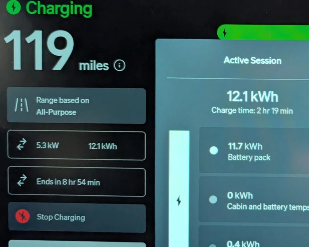

We've had some record winds whip through Western Washington last night, enough to down a healthy evergreen that luckily threaded between my neighbor's house and propane tank, and we've been without power for a while with restoration not likely for a day or two. I got a 13kW Generac wired in for cheap, $7500 all in, in 2020 after getting a lowest bid of $30k for 8kW solar system. 22 year payback period in our area is too long on a not-forever home.
Since we're running the generator anyway for the normal uses and filling the pump house tanks every few hours, I figure why not plug in the truck and try a load? (that's what she said) I either need to charge here or at a DCFC on the way to work tomorrow, so let's math it.
13kW 1/2 load consumption: 1.47 gal/hr
Max load: 59 amp
Charge off laundry plug: 24 amp, 5.5kW
Mathed consumption: 1.2gal/hr
Propane: $2.71/gal
Cost: $.49/kWh
$.49/kWh isn't terrible, cheaper than Shell and EA around here, but the Tesla near work is charging $.35/kWh. That's pretty cheap compared to across the water, so I wonder if they intentionally lowered during this major outage period? Granted it's way more than my standard $.08/kWh off-peak rate.

Yep, it's been running for a couple hours now, no problems!
Rivian R1T R1S Charging Rivian with Home Generator 1000002854
EVSE is on my main panel, not the generator's subpanel. If I put it on there, I'd be pulling almost max load just to charge, not worth running the generator so hard or stressing other items with load fluctuations.

Comes down to convenience if you ask me. Tesla is $0.14 cheaper per kWh but you have to find something else to do while it’s charging.
What I couldn't find from Generac is the minimum load/consumption of the generator. What's the overhead cost? I'm sure a fair amount of it running for the basics is excess production, so I'm putting that towards the truck. When I started charging, I didn't hear it kick into a higher gear, so I think it's either 1/2 load or full load.

I know this next question is irrelevant to your situation because you don't have the EVSE on the generator circuit, but if you did, could you set the charge current in your R1 to a lower amount to avoid stressing the generator?
BTW - I have an Emporia EVSE and it the current output can be controlled via the Emporia app. Pretty cool. I have never needed to drop it from 48 Amps, but if charging off a generator, I would do what you did.
Yes, Chargepoint make it easy, plus the Rivian can be lowered as well
