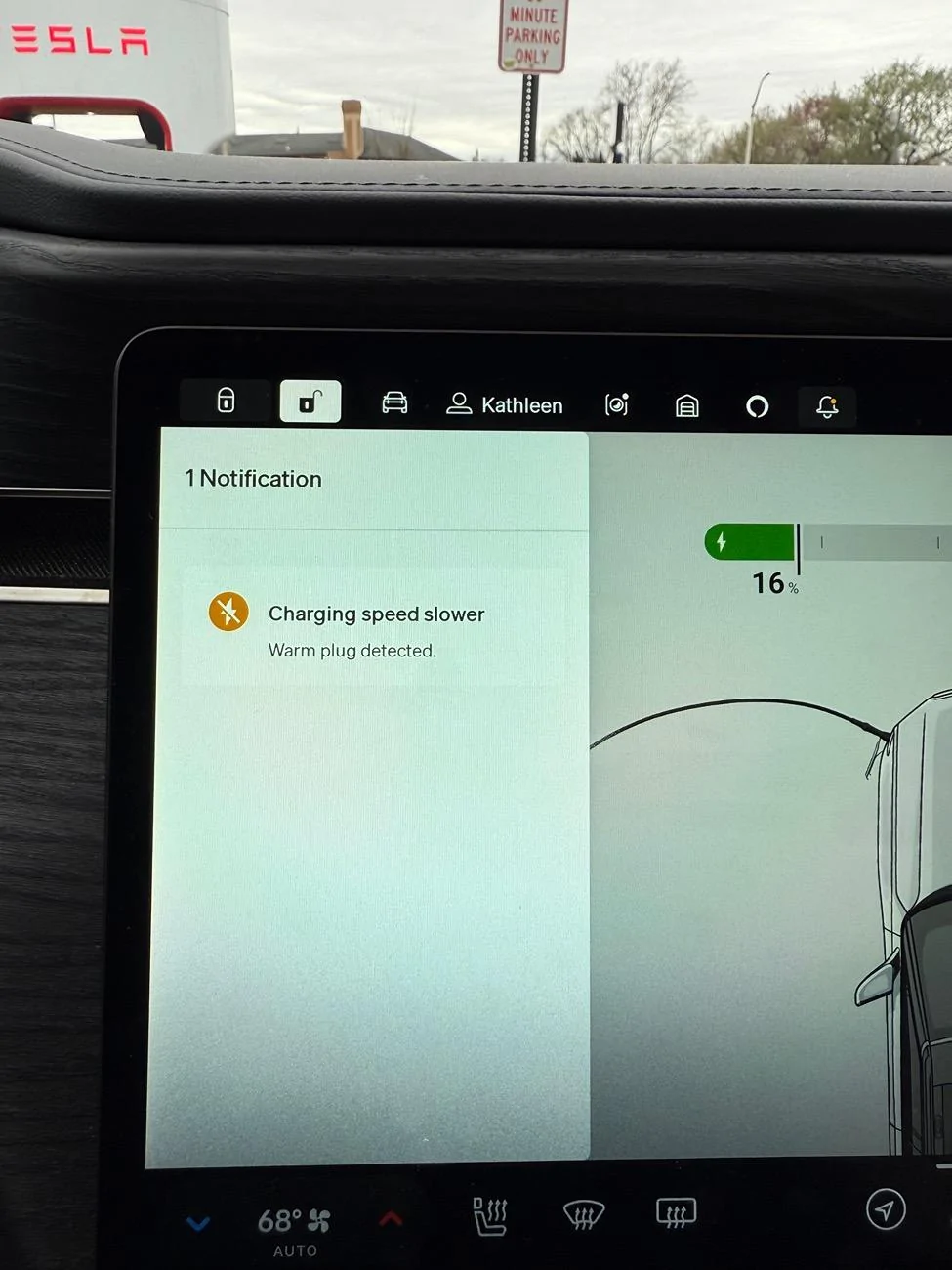

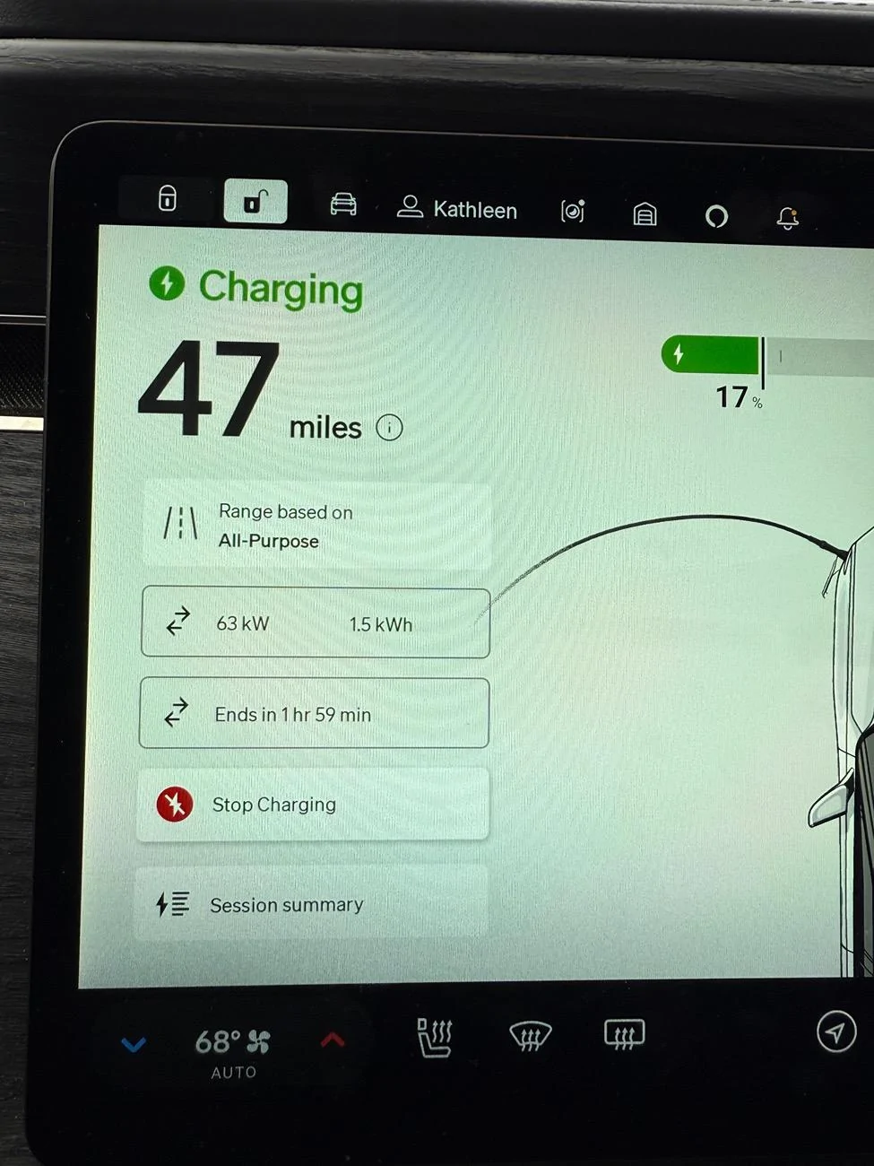

2025 Rivian R1S
Over the past few days, I’ve been getting a “Warm Plug Detected” error at various Tesla chargers with my Rivian. The vehicle hasn’t been sitting in the sun, and the weather has been relatively cool, so I don’t think it’s a temperature-related issue.
Curious if others have seen this recently or know of a fix.
Rivian R1T R1S "Charging speed slower - Warm Plug Detected" Message IMG_1550
Rivian R1T R1S "Charging speed slower - Warm Plug Detected" Message IMG_1551

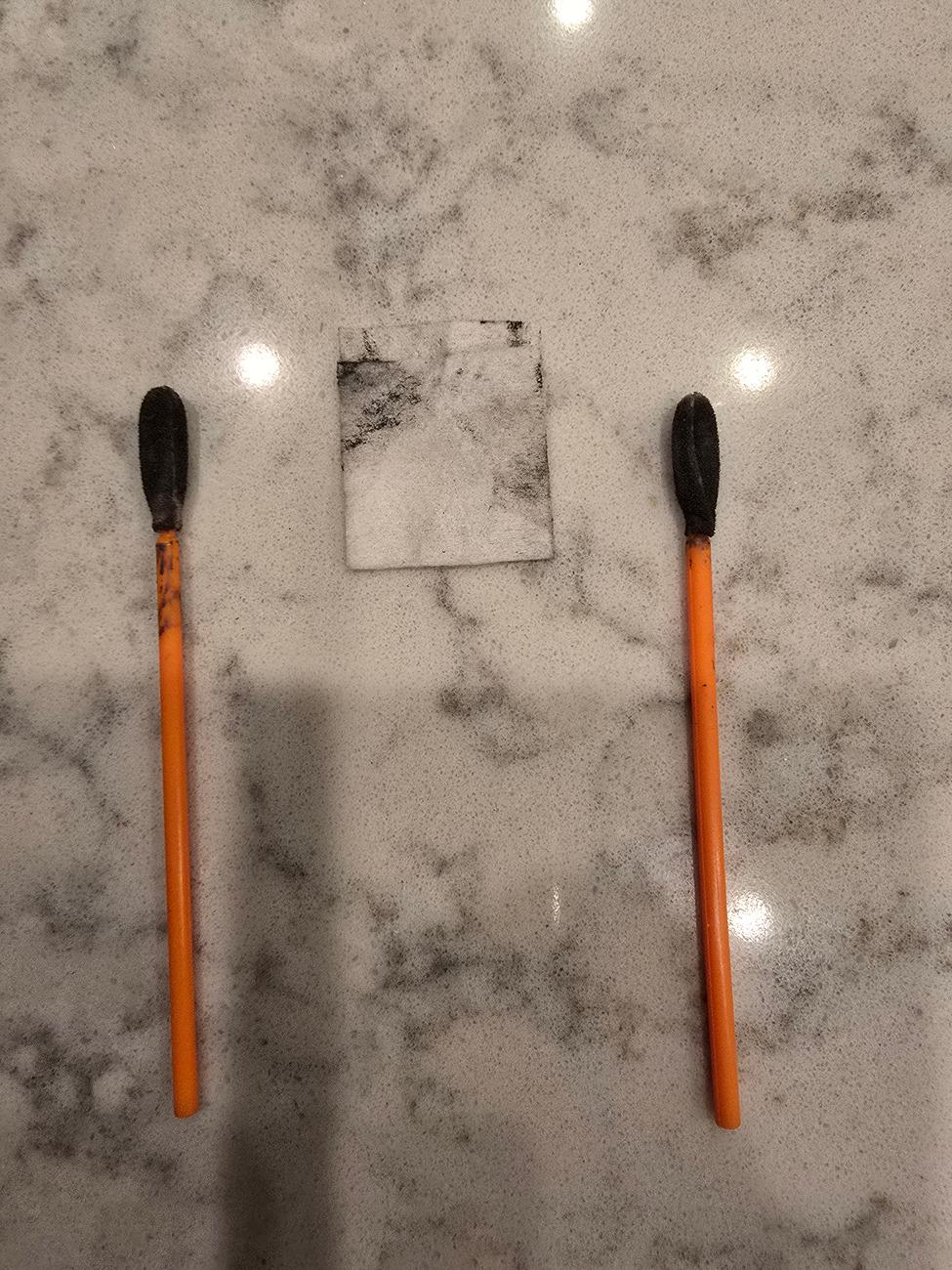

If the truck detects the charge port getting too hot too quickly, it will reduce the charging power to protect itself. This can happen when the cooling system on the charging cable isn't performing well or there is contamination in the charging pins. I'll add that I'd the truck didn't protect itself, the cable could get welded to the truck.
I am going to vote for dirty pins even on less than 3 month old SC. Here's a picture of my swabs at 2 different SCs from a couple of months ago.

coney129
Jun 16, 2024
Philadelphia
2025 Rivian R1S
Update: Tried 4 different Tesla chargers and even an EVGO DC fast charger. Also hard reset — same error every time. Looks like the issue is with the vehicle, not the chargers.
