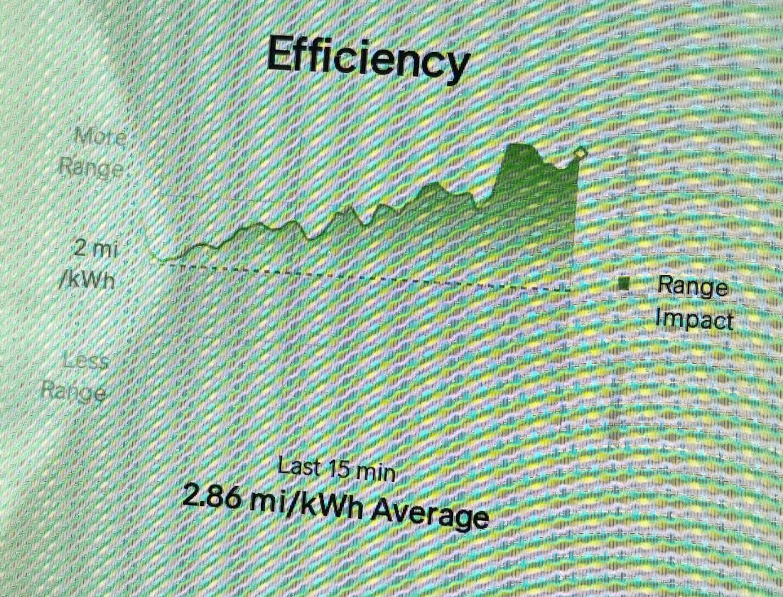

My trip to work often gets me pretty good numbers as I get closer as there is about 200 ft of elevation drop. I was able to capture the somewhat rare "above rated" range impact:
Rivian R1T R1S Consumption needed to hit advertised range? 1722075110451-z2
Typically this shows as a tiny black square below the centerline as I'm not often above 2.5 mi/kwh which actually does appear to be the point at which it goes above/below the line. I'm assuming people with other configs have a calibrated "Range Impact" indicator - for example 2.69mi/kwh for those with 22s?
To be perfectly fair to the rest of the graph, Rivian has vague "more range" and "less range" labels, and not more useful "above/below rated" labels. Perhaps this is not dishonest, but still misleading.

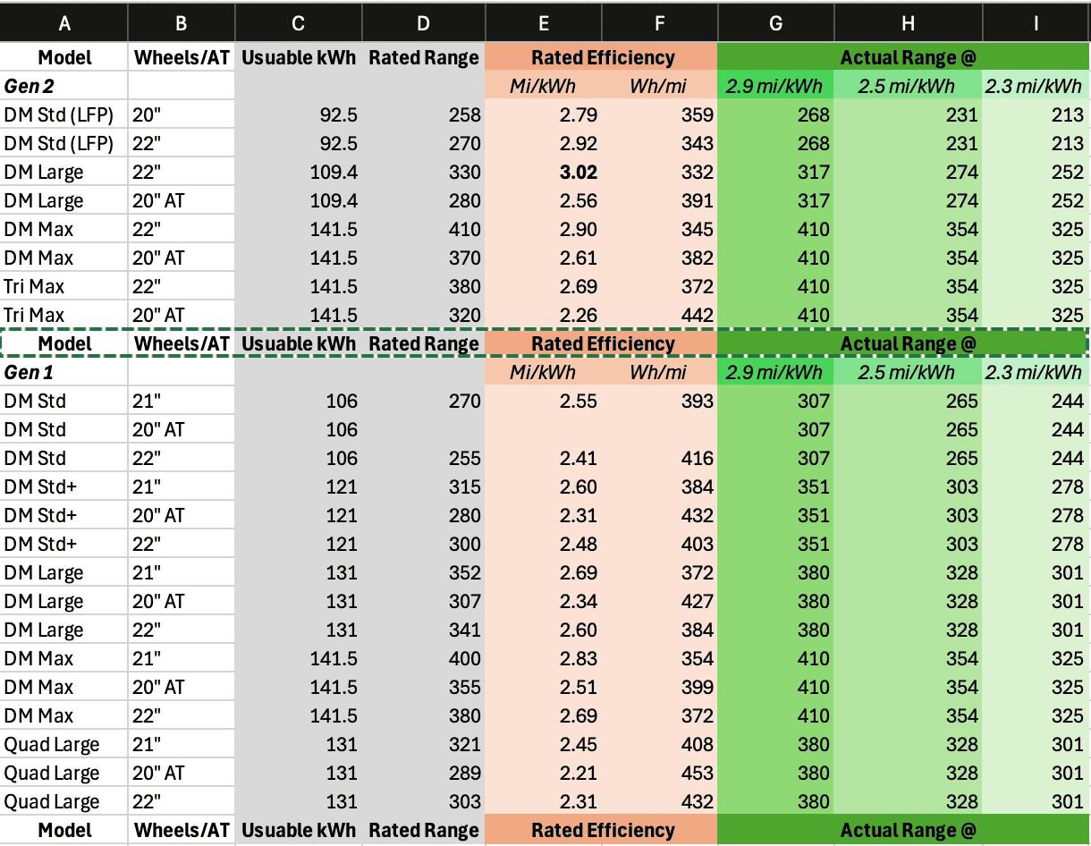

Rebooting this thread for others to reference for the future. R1S Gen 1 and 2 usable kWh, rated range/efficiency, and 100%-0% ranges at different efficiencies:
Rivian R1T R1S Consumption needed to hit advertised range? 1724349850401-ey
The new DM Large battery rated range/efficiency stands out to me the most and seems suspect at best

Thanks for the correction on the rating on DM Max, 20AT. I originally thought it was 2.5, but it's more like 2.6, and the graph tracks with that.
