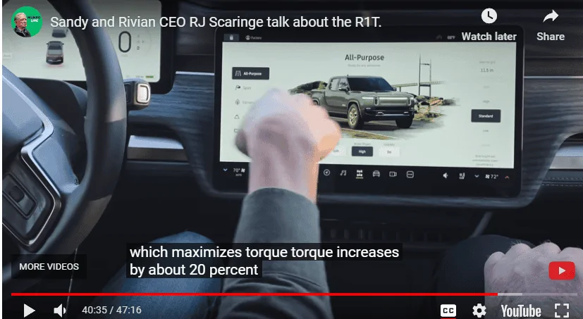

In the Munro video with Sandy and RJ, RJ indicated that Sport mode maximizes torque increasing it by about 20% (presumably over All Purpose, the mode they were changing out of).

Thank you for posting that video that is exactly what I was looking to find out. I feel like starlight from RJ is the best source but would love to see some data on a chart one day vs just verbal with the word " about" in there. So assuming the 908 FT-lbs claim is the max this would mean that all purpose would have about 726. now I'm going to want to drive my truck in sport all the time but unfortunately I don't like the low height as much.
