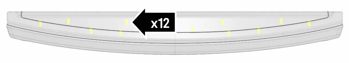

Is there an easy way to remove the plastic tailgate cover so I can vacuum or blow all the dirt out of the tailgate?
Do you mean the top liner? If so, yes, there are 12 clips. And service warns:
CAUTION:
Potentially non-reusable fastener(s).
Use a trim tool to pry near the highlighted tab(s).
CAUTION:

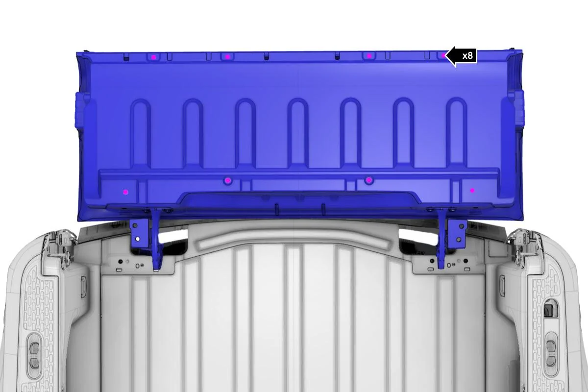

That might be part of it but I want to remove the hard plastic bed liner material that covers most of the inside of the tailgate.
130
11,848
23,617
Once the cap comes off, it exposes a couple of torx screws for that panel to get removed.
