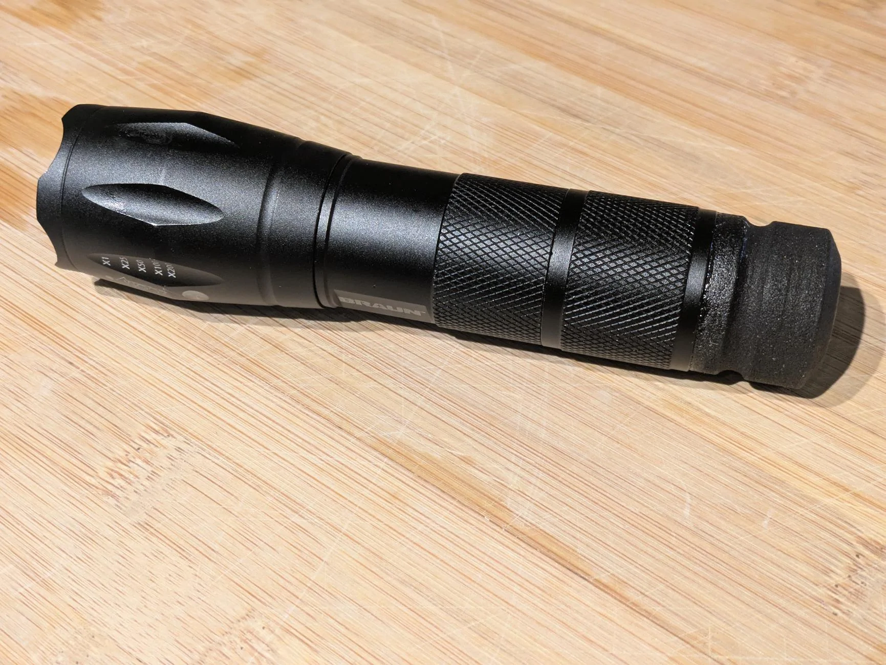

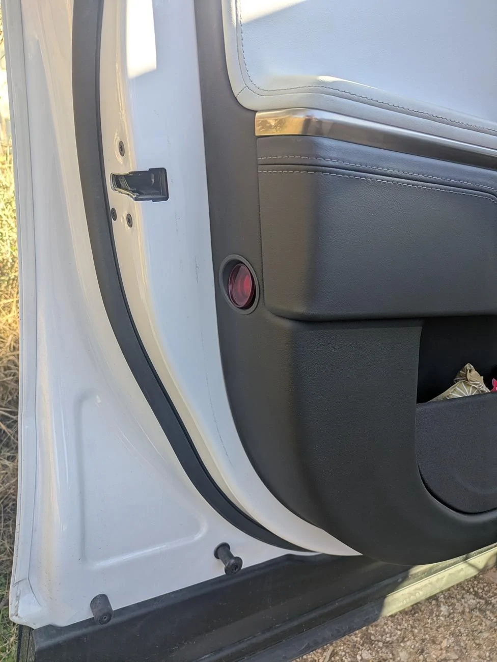

My salvaged R1T had the handy flashlight in the door pillaged (along with the camp speaker, first aid kit, and some other standard stuff).
I just couldn't stomach $175 to replace a simple flashlight, so I worked up a 3d printed adapter that fits that catch mechanism in the door. Epoxied on to an inexpensive Harbor Freight flashlight, that just happened to be a perfect fit. Kind of eyeballed the shape looking at photos of the Rivian one.
100 lumens dimmer and doesn't charge in the door, but also $150 cheaper. Adjustable zoom allows a wide or narrow light beam.

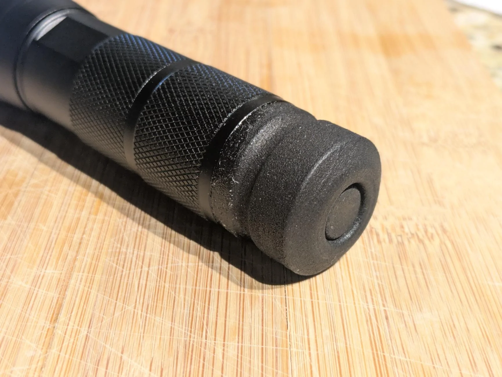

The adapter is actually 2 pieces, allowing one to push the activation button at the end of the torch.

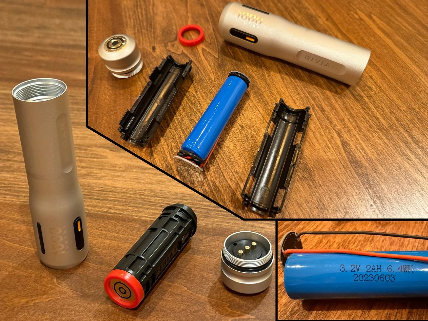

What is the capacity of the currrent Rivian power bank? It isn't stated on the website but one of the photos has a 7000 on it. So I assume it is 7000mAh?
A forum member took one apart, it's 2170 cell only has a 2,00mAh rating.
