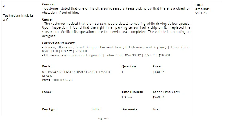

I just had one replaced due to having a chip right on the edge and it did exactly what you're talking about, so you're going to have about a $400 bill to pay if it's damaged.
I took a video as it was repeatable on mine by going about 10mph, then letting regen take me down to 2-3mph, it would flick on at the closest dark red proximity only. $140 for the sensor $260 labor

Can you provide a screenshot of the bill? I'm awful curious if we can pull off sensors from different parts and just replace ourselves.
