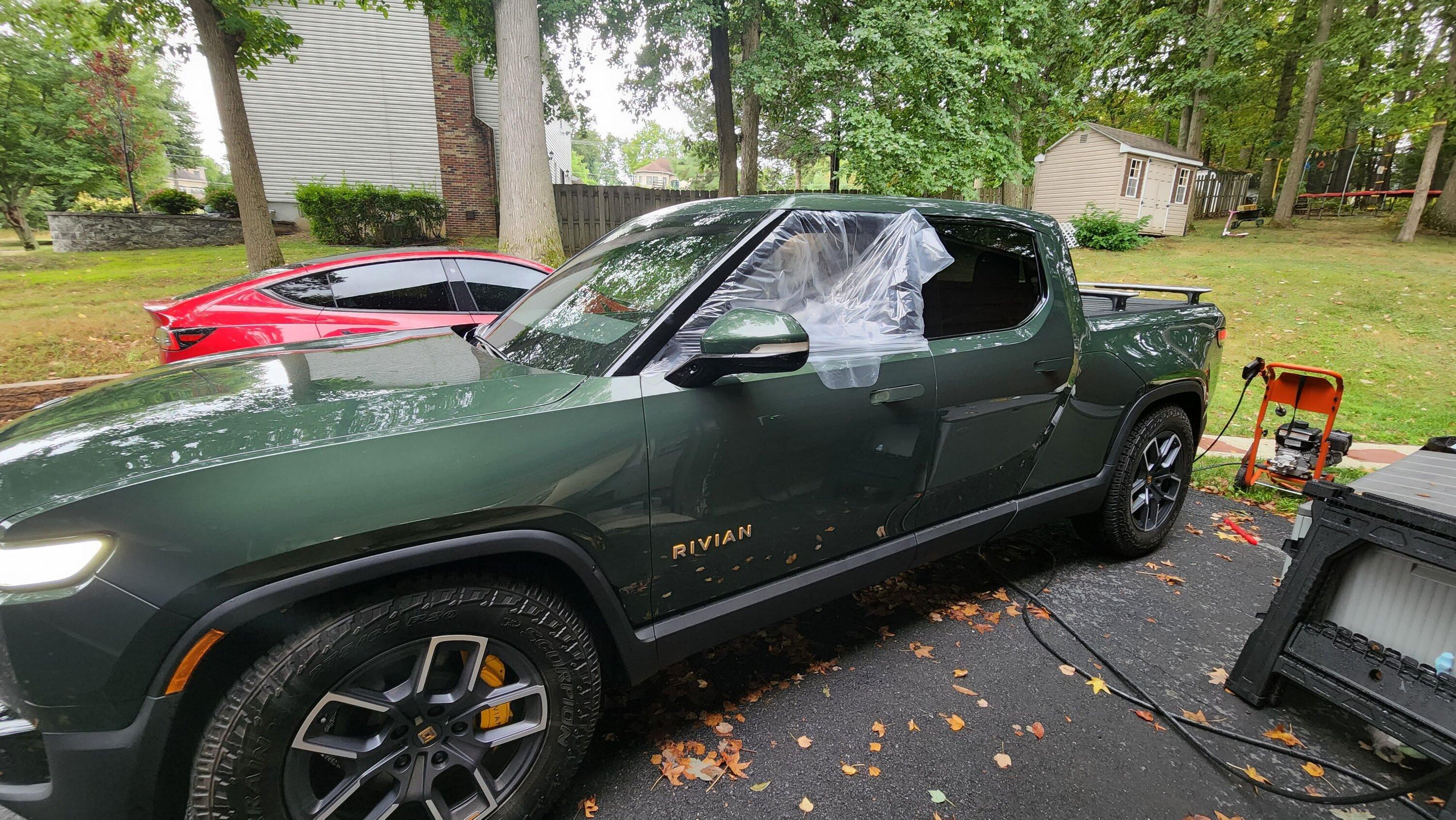

2500 miles in, first major issue. While backing up today from driveway I rolled window down to clear it from droplets since it's been raining all night aaaaand now it wouldn't go up no matter what. Had to put garbage bag over the window so the rain wouldn't get inside. What I tried doing:
- Reset whole car first time
- Did the hold-for-5-seconds-trick to reset regulators
- Called service (still waiting for response)
- Drove around on a bumpy road in case something got loose
- Moved the harness between the door and vehicle's body in case there's a loose wire
- Reset car 2nd time at the same time keeping rolling both front windows up and down to see if problem is with hardware or software. Passenger one was working fine, no response from driver side at all
- Very carefully tried lifting window up with pliers wrapped in rubberized fabric while pressing the switch, no good.
- Closing with fob - all windows except driver work.

Did you try the 30 minute walk away with all keys etc deep sleep trick? A guy was having an issue with the charger not working and had to walk away and allow the vehicle to deep sleep in order for the problem component/code to reinitialize.

Guessing it's a bad switch

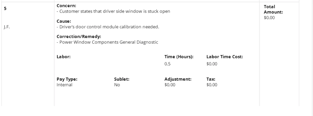

I picked up the truck yesterday, the SA said the driver door window module had to be reflashed. I asked if that's something myself or mobile service could do and he said no.
That's pretty much all the info I have.
“Reflashed” makes me think I was completely wrong and would have been sorely disappointed after removing the door panel LOL. As long as your window got fixed that’s all that matters
Some here know what this means, but for those that don't, it's a term used with embedded controllers that essentially is the procedure to write the program code and variables to the controller. You need a PC and appropriate software to flash a controller. In the automotive world, that software has been historically proprietary, but with the "Right To Repair" movement, some manufacturers are making it available for a fee. Or sometimes you can find hacked versions of it online, lol.
