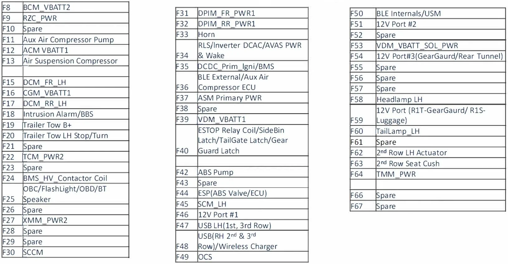

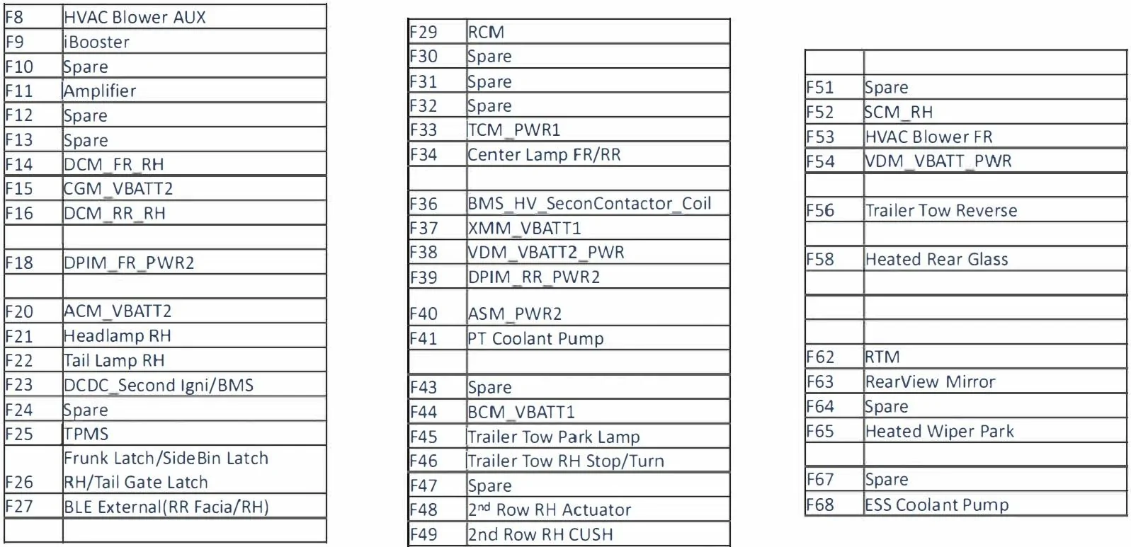

I figured the fuses are as follows:
LH headlight F58 driver's side
RH headlight F21 passenger's side
(pictures I found on other threads/reddit are attached)
Driver's Side:
Rivian R1T R1S Driving in Blizzard with Fog Lights Driver Side list of fuses
Passenger's Side:
Rivian R1T R1S Driving in Blizzard with Fog Lights Passenger Side list of fuses
Driver's Side:
Passenger's Side:
I haven't personally verified these yet but just thought it may be helpful to have the info in this thread.

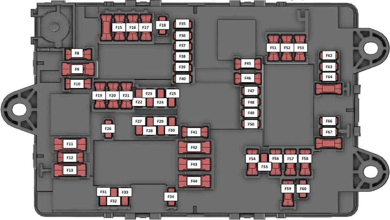

Driver's Side fuse box:
Rivian R1T R1S Driving in Blizzard with Fog Lights Driver Side fusebox

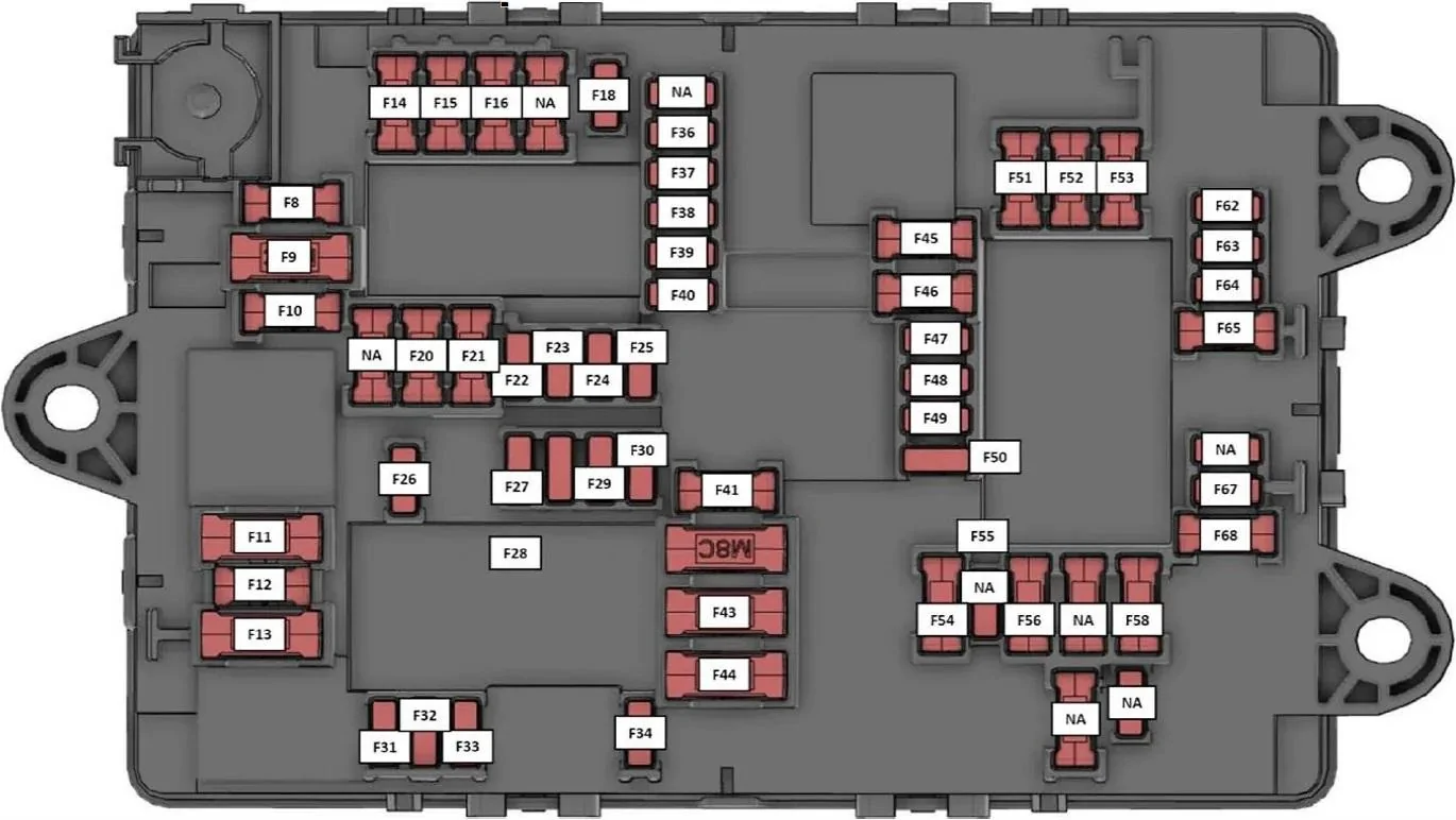

Passenger's Side fuse box:
Rivian R1T R1S Driving in Blizzard with Fog Lights Passenger Side fusebox
