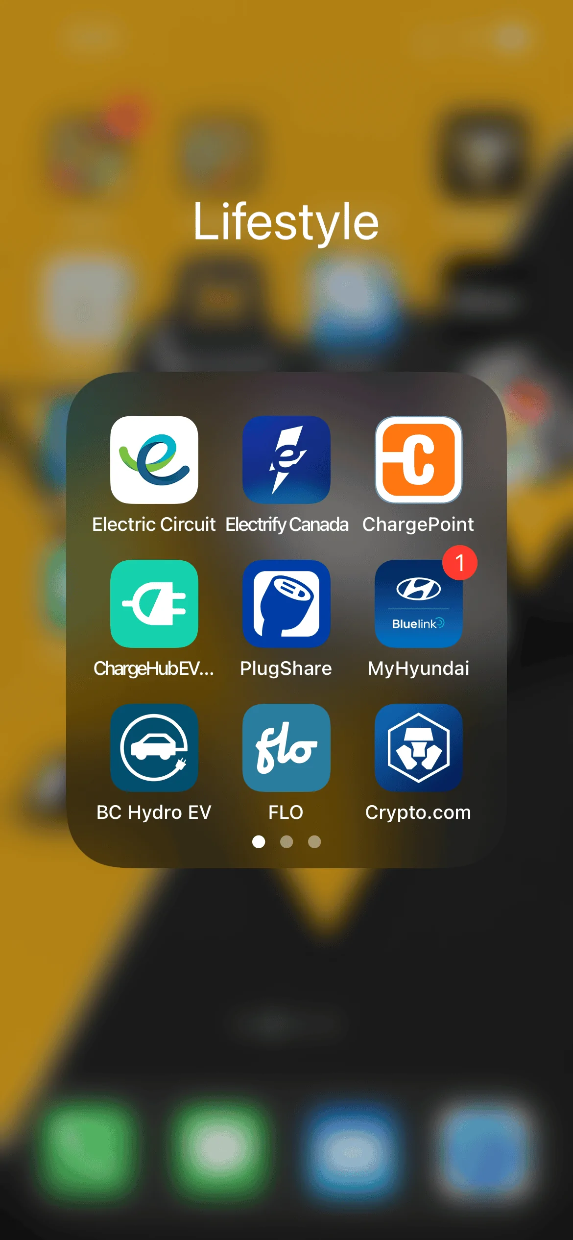

I use PlugShare, FLO, bchydro, and ChargePoint. I wasn’t sure which I needed when I got my Ev so I installed like 6 or 7 of them. But the ones stated above are the only ones I’ve used so far. I normally just preload a balance onto them and too it up as needed. But I think plug share is one of the better ones as people will often leave a note on there saying things like “just topping up, go ahead and disconnect me if you need the charger” or saying how long they will be at the charger.

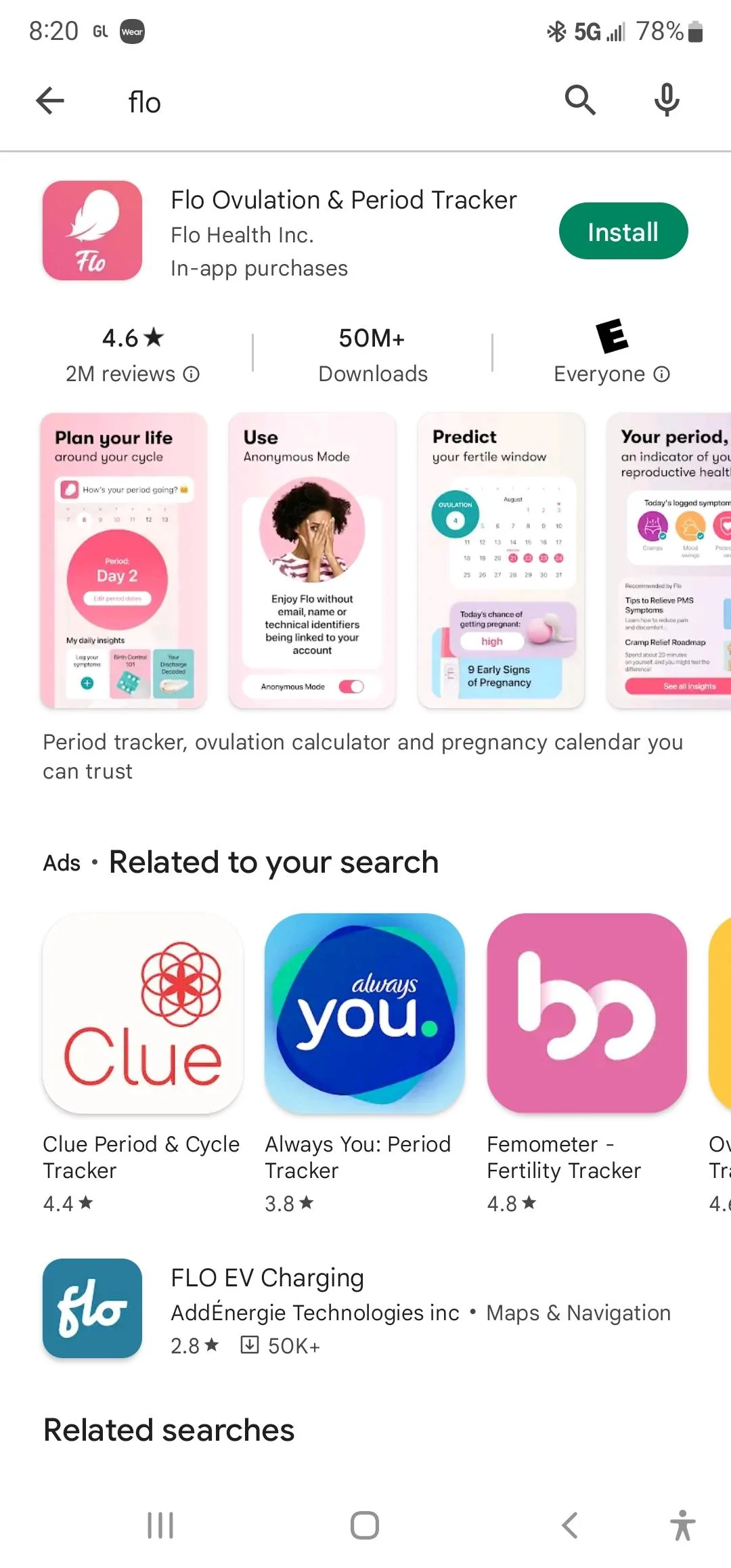

🤯 I'm guessing it's a different FLO app...
🤣 yeah different one. Although to be honest I’ve never looked to see if it has an ovulation thing in there.
This is the one I mean lol.
