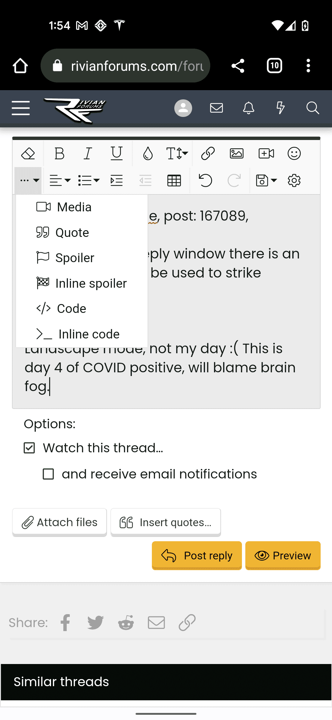

At the top of the reply window there is an S symbol that can be used to strike through text.
Landscape mode, not my day :( This is day 4 of COVID positive, will blame brain fog.
It's not there. On a computer it is right next to the underscore U.
Hope you have a speedy recovery!
Loved how we got off topic, but it is there if I move to landscape mode.
