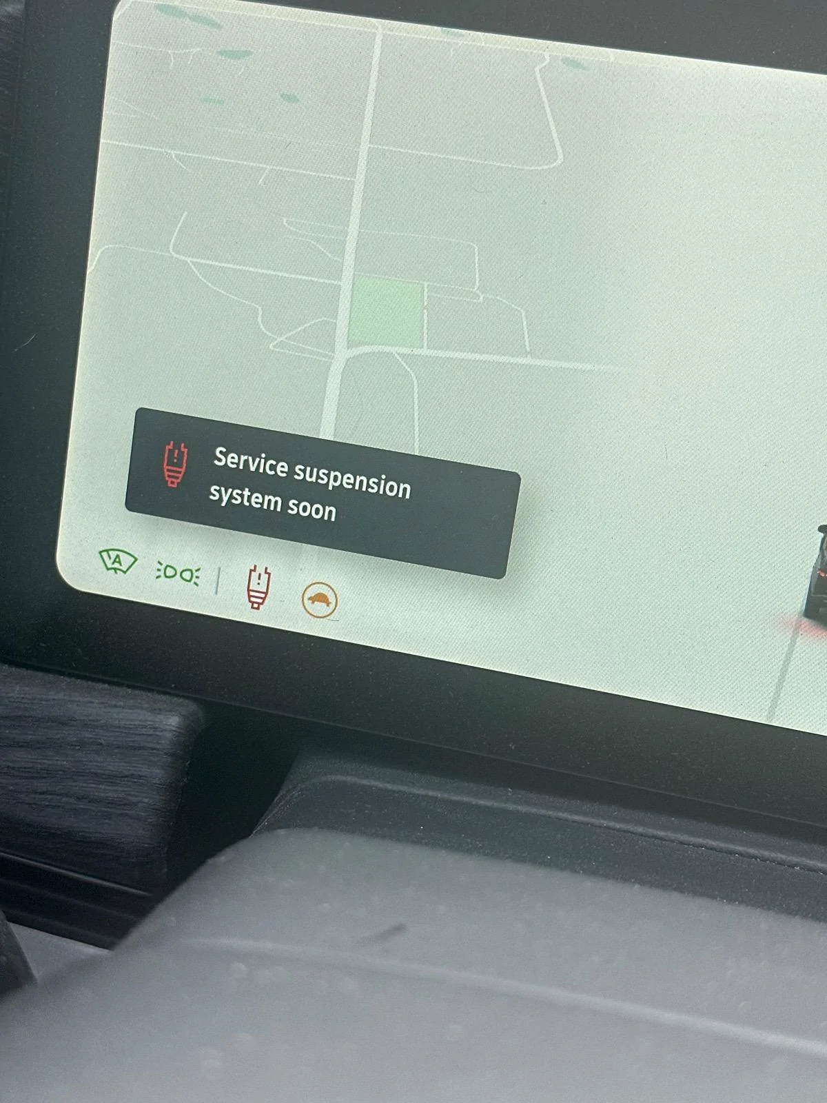

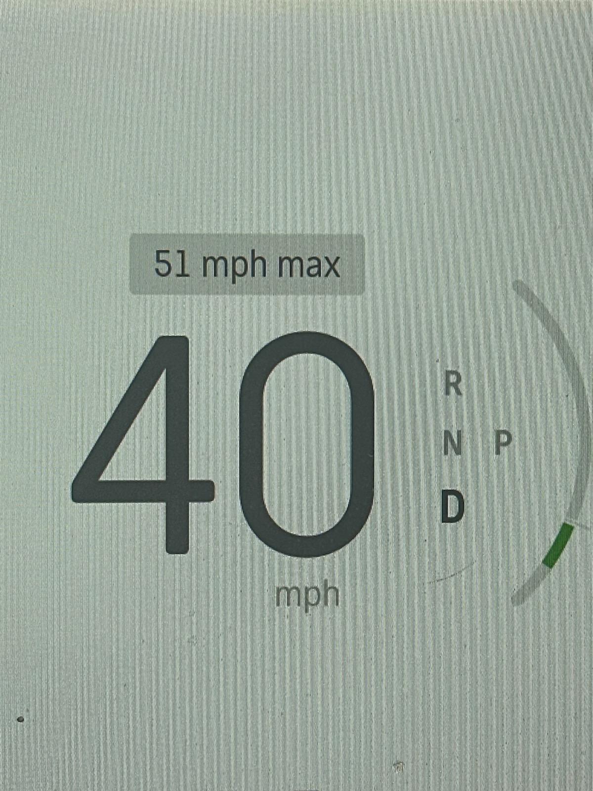

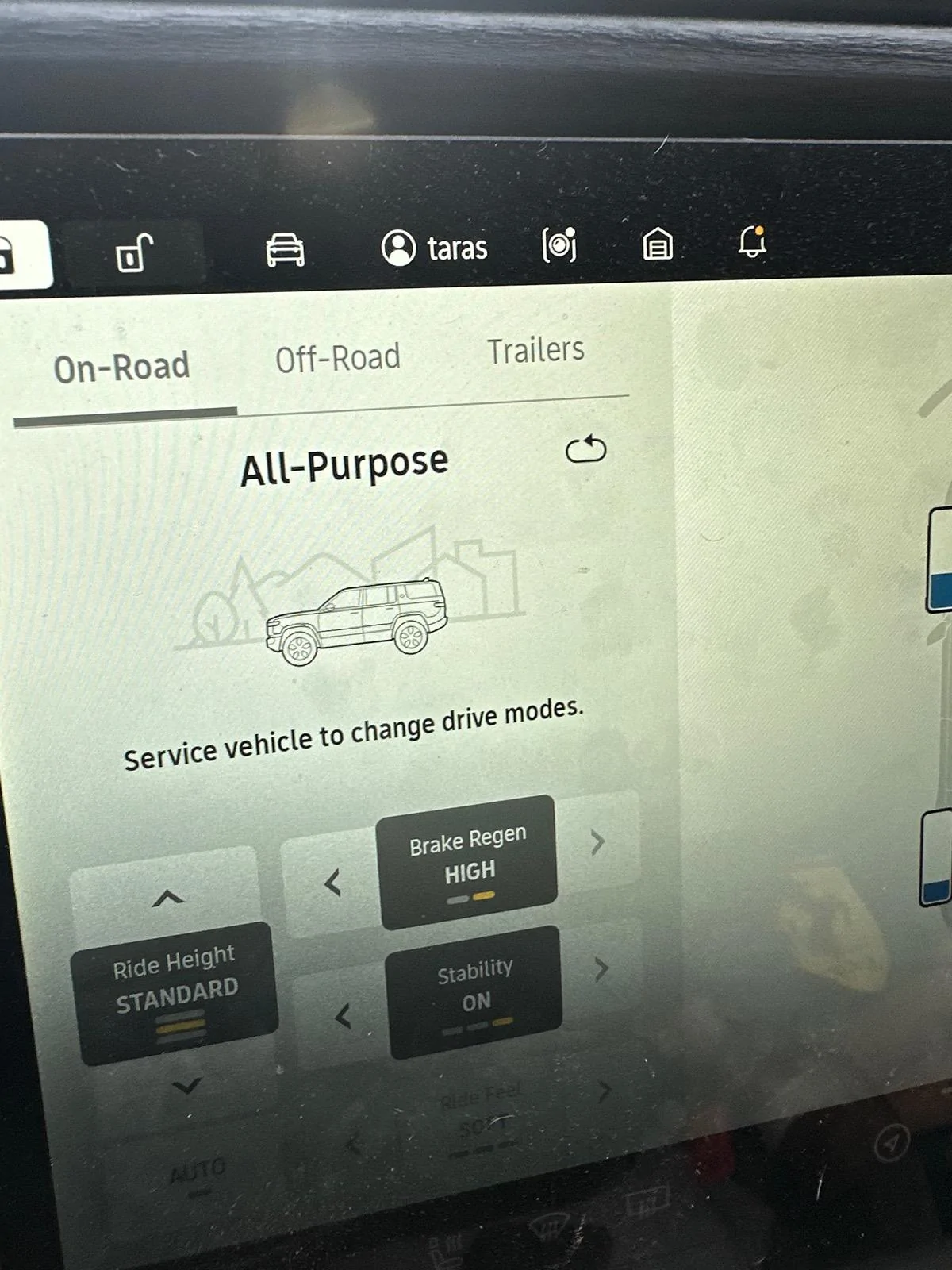

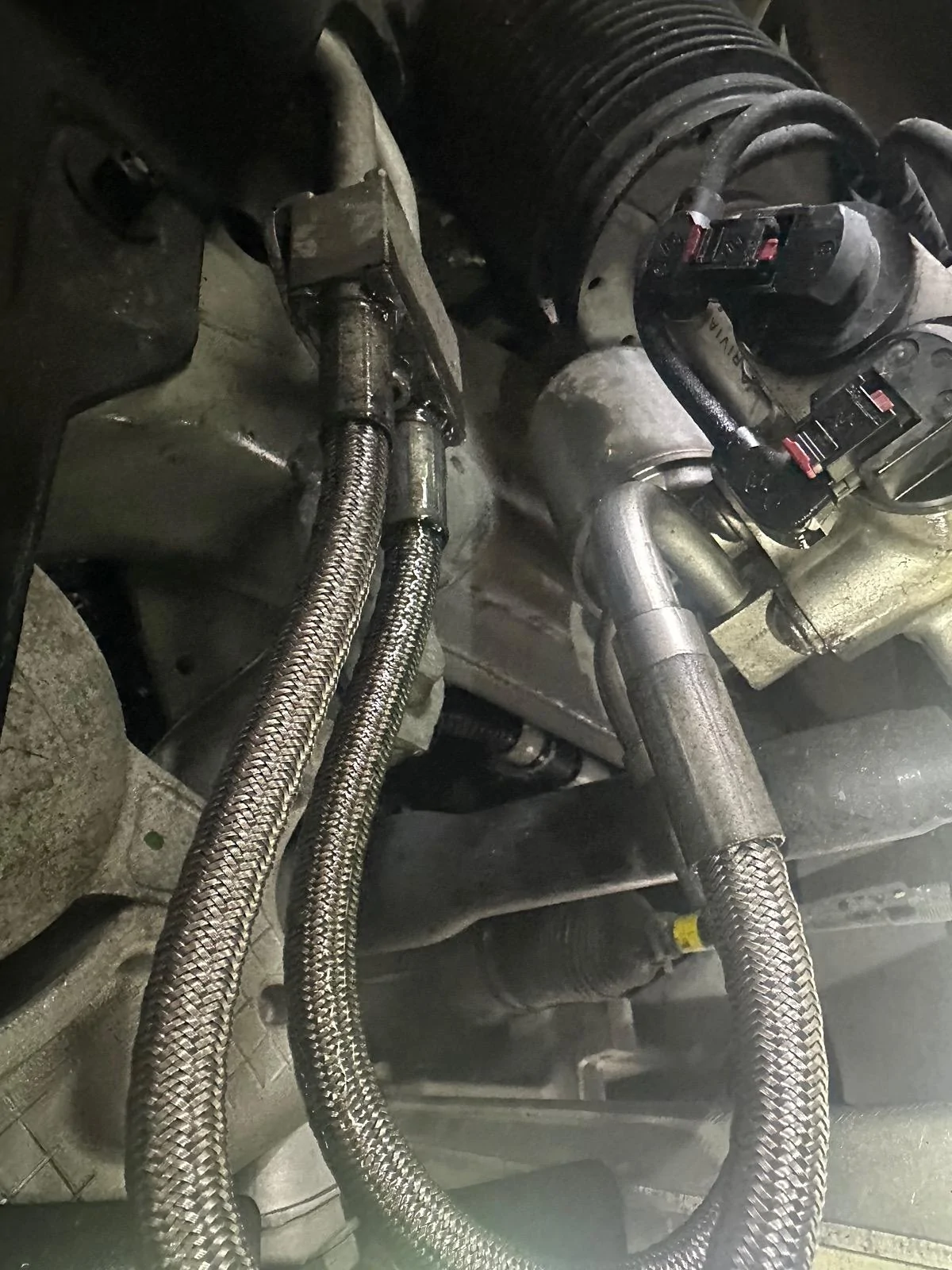

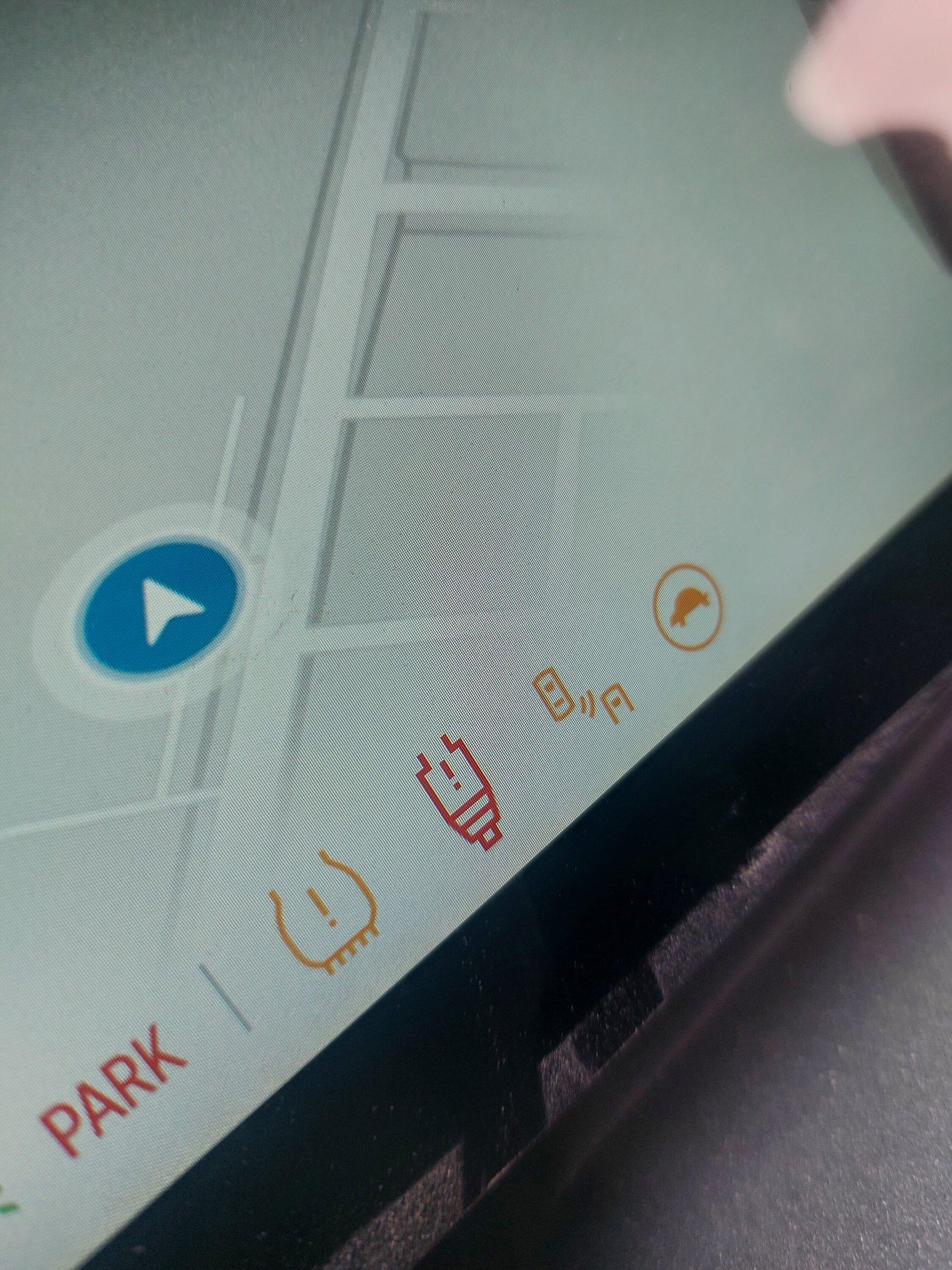

Bumpy road - suspension on high setting.
5 min later, suspension warning.
tried soft and hard reset.
messages didn’t go away.
warning returned when making left turns

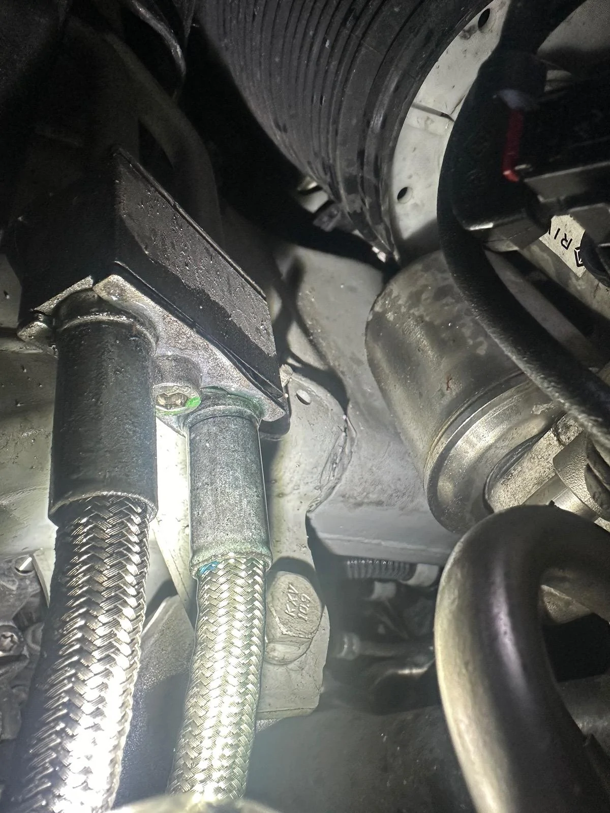

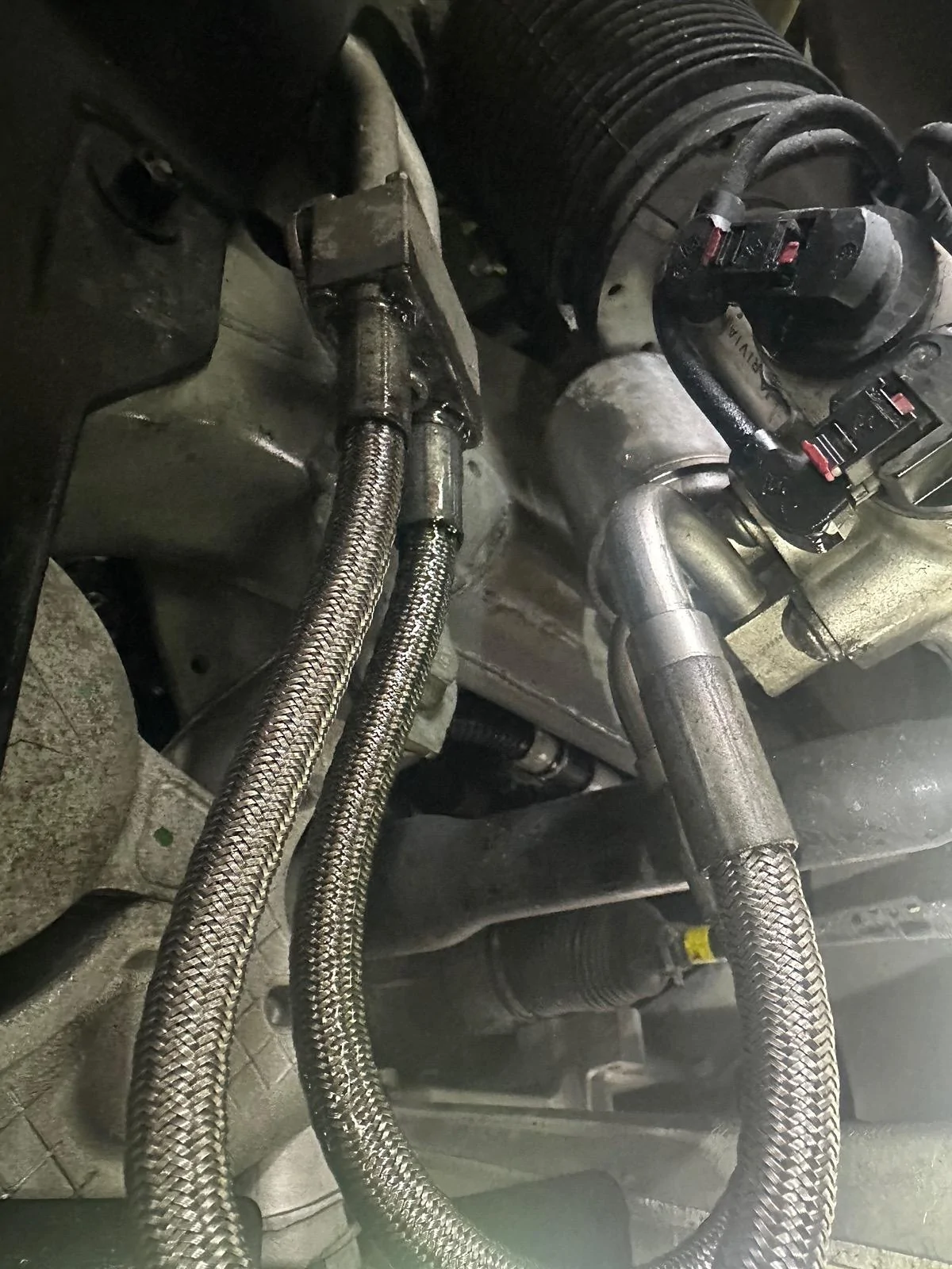

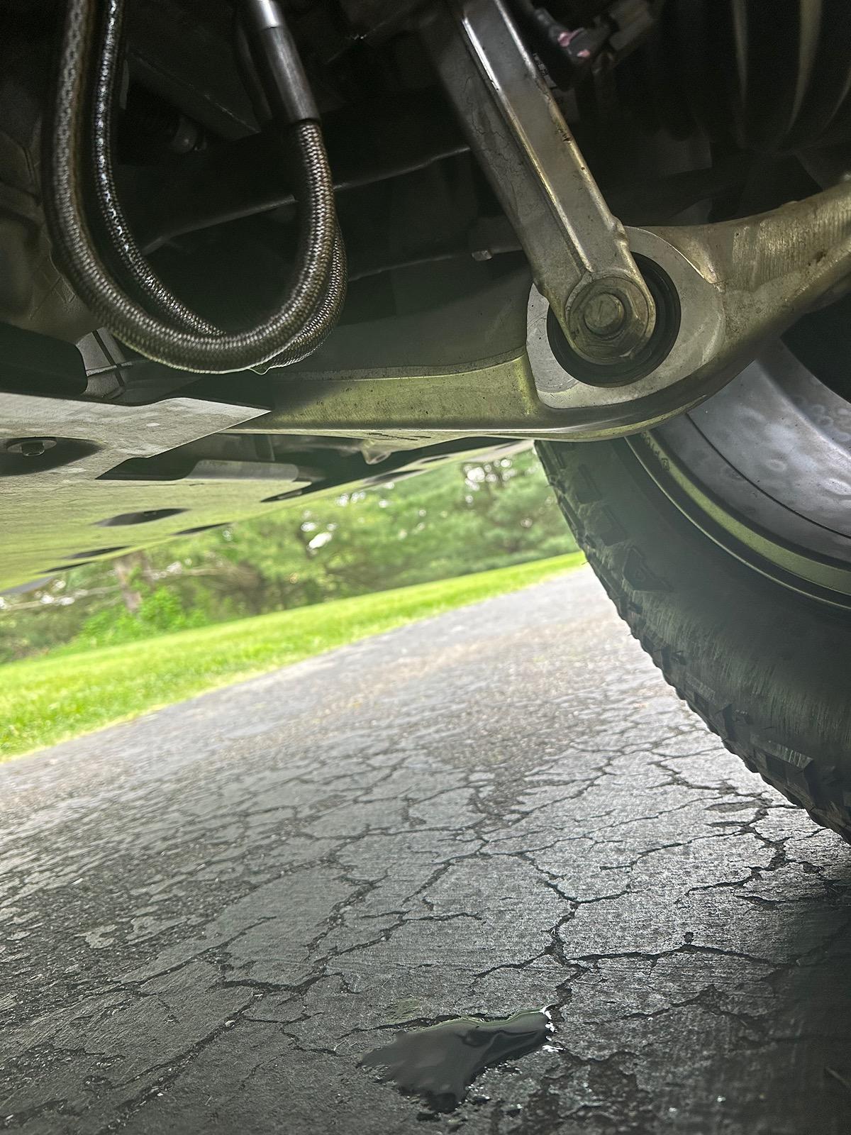

crawled under car and discovered that under front right wheel the hydraulic hose was leaking (green-blue fluid)
