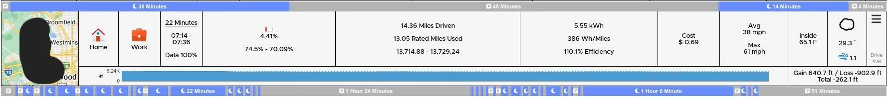

At least yours doesn't do this all day...constantly wake/sleep on short duration because the phone is apparently too close, despite being 50+ feet away in a garage through several walls. In my case, this behavior started after one of the software updates that claimed to enhance the PaaK sensitivity. And even while my truck does this, I still sometimes have to take the phone out of my pocket before the truck will unlock as I stand right next to it, or literally lean against the driver door.
