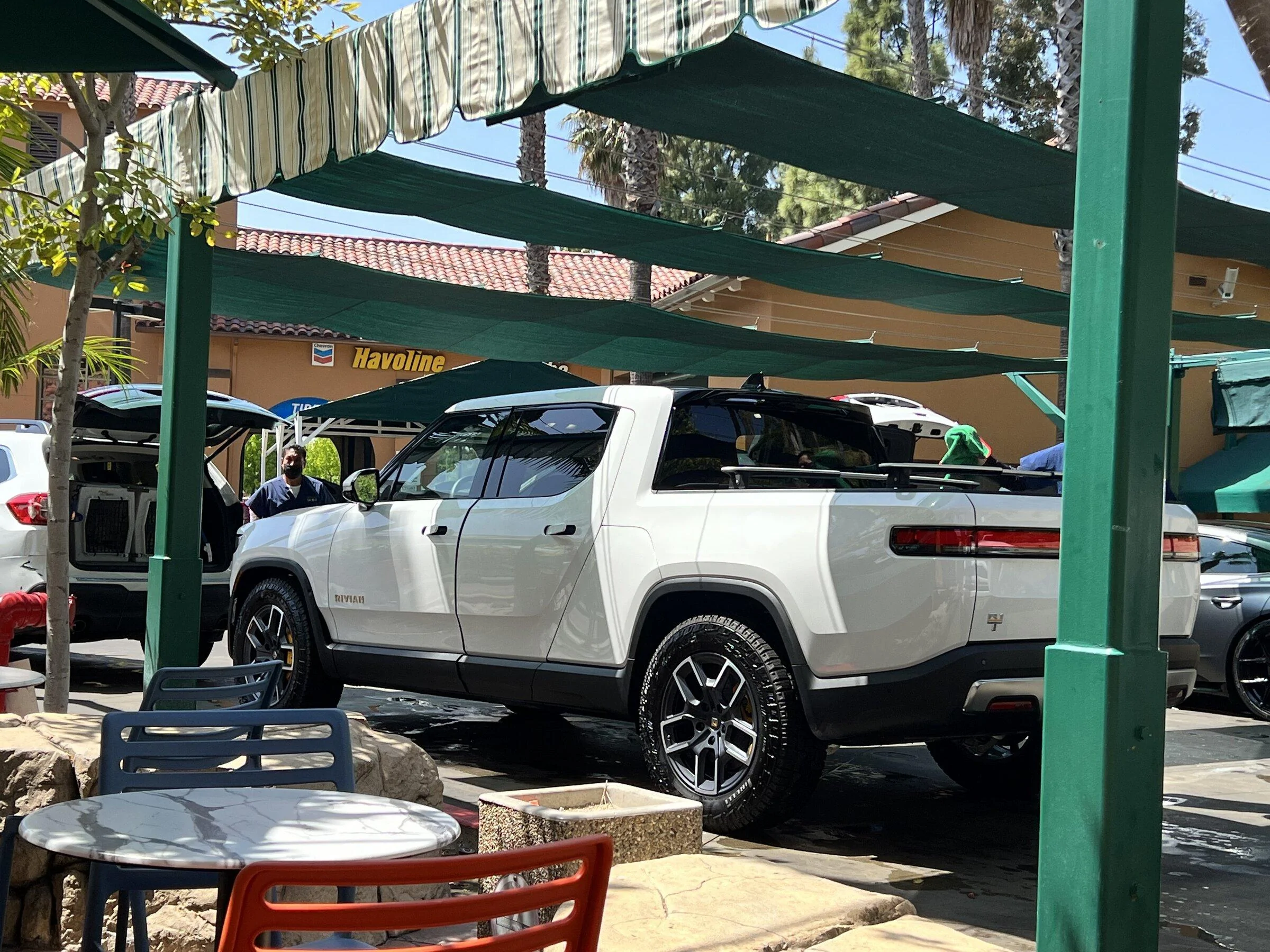

It works, but it needs some work.
it only stays in that mode up to 10mph. So if the attendant goes to 11 he automatically cancels the mode.
also, it’s still Confusing to get the truck in neutral for those no familiar with it. Mostly because you can’t do so when the truck door is still open. Car wash attendant won’t know that. So someone ended up driving the car through. I wanted to stay out of the equation as much as possible to see how it goes.
Edit: This is a full-service car wash. Not self-service. So you don't drive your own car through, they just send it through.
On a positive note, your truck looks fantastic freshly washed! :like: I hope you have fun with your R1T this weekend, even if it gets dirty again in the process.

Does anyone know how to tell the truck to stay in Neutral?
I can put it in neutral, but as soon as I open the door and the truck begins to move it automatically shifts to park. Pretty annoying cause ideally once it’s in neutral it would stop trying to save me from myself.

I guess I need to explain how like 100% of all car washes work.
the car gets loaded in neutral and is pushed through the tunnel by the wheel conveyor mechanism. If you wash your car at home then you don’t have to deal with this problem of course, but if you take it to a car wash then …

Okay, I'm starting to see where the disconnect is. Lol. My bad.
This is not a self-serve car wash. Its a full service car wash.
They take your car, and they feed it through the tunnel, then they polish and dry it for you. Very typical for CA car washes at least.
Would be cool to have them limit the speed in car wash mode to 10 mph.
We know they can because rock crawl mode is limited to 20 mph.
