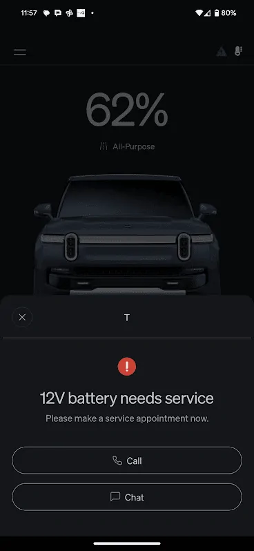

Wasn't this just an update or so ago that Rivian is monitoring the condition of the 12V battery and should be able to (preemptively) alert us if there's an issue through the app?
That was my understanding.. maybe I missed something?
My broad assumption is that these things will go bad over time (assuming we're not leaving front seatbelts plugged in and walking away from the vehicle); so it shouldn't be a sudden 'gotcha,' when you walk out to the vehicle one day (anymore).
Are we still seeing surprise battery drain since 2023.10.0 (March 2023)?
Worked in my case. Vehicle was still drivable but I opted to take something else until I drove my R1T to service later that week.
Glad to see it is being monitored-- I did not know that was in the app. I wish the status was shown in the car image on the vehicle dash screen as well.
