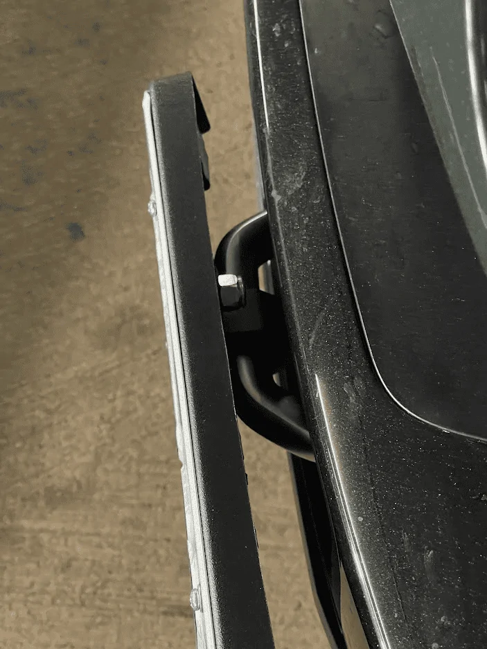

this is how mine is mounted…
Rivian R1T R1S Homemade front license plate mount for tow hook ABFF2E1B-E46F-4170-998D-650CA618D396

@godfodder0901 taking inspiration from you I'm using those same mounts, but along with the Rivian provided mounting plate. Turn it up side down and it slots right onto the mount. Works really well. I put a bolt through to be extra secure, but you could use it as a clip-on without.
I just used this method to mount my plate.

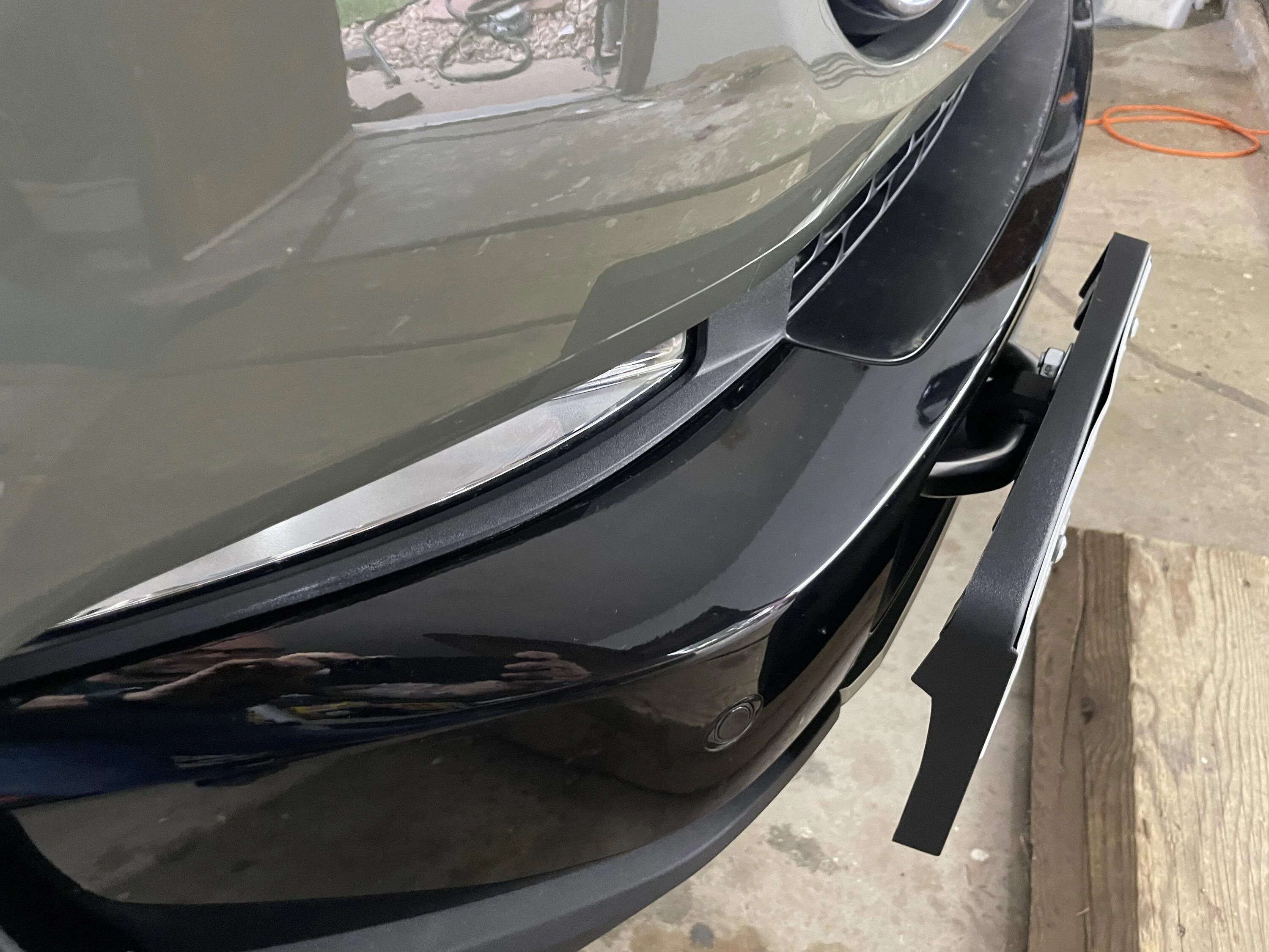

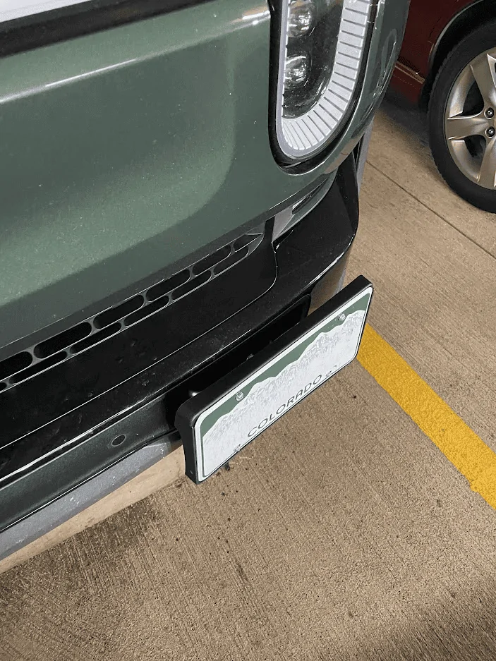

Also copied the approach from @boardthatpowder, bolted it through the stock mount as well for extra peace of mind, and drilled holes on either side for use. I preferred to move it to the driver side as the passenger side had a threaded hole behind the tow hook for a tow eye if ever needed.
Rivian R1T R1S Homemade front license plate mount for tow hook 1669146903003
Rivian R1T R1S Homemade front license plate mount for tow hook 1669146929274

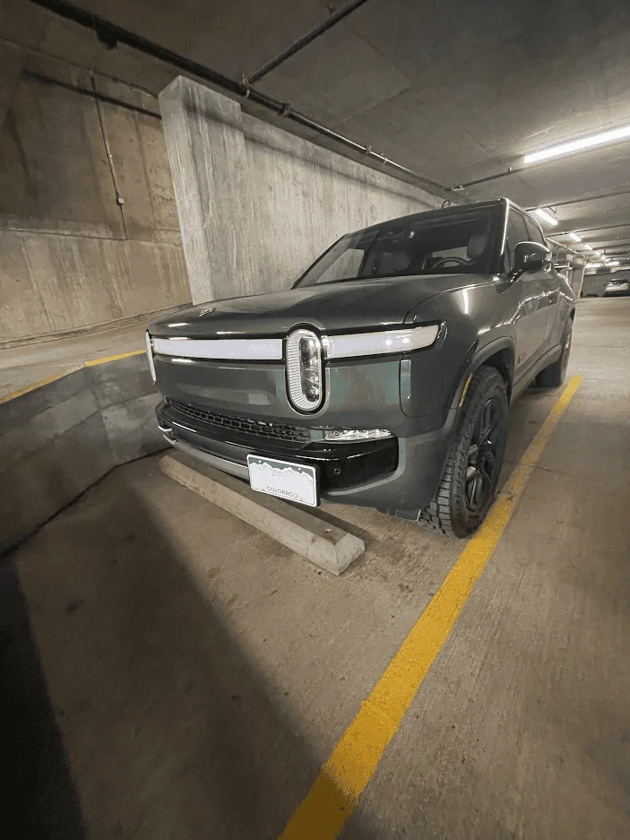

I know this isn't a largely beneficial post given that the SnapPlate is available, but here is my homemade front plate mount.
I used these brackets:
Motorcycle Mounting Bracket 2Pcs...
https://www.amazon.com/dp/B0824JR9PX/
