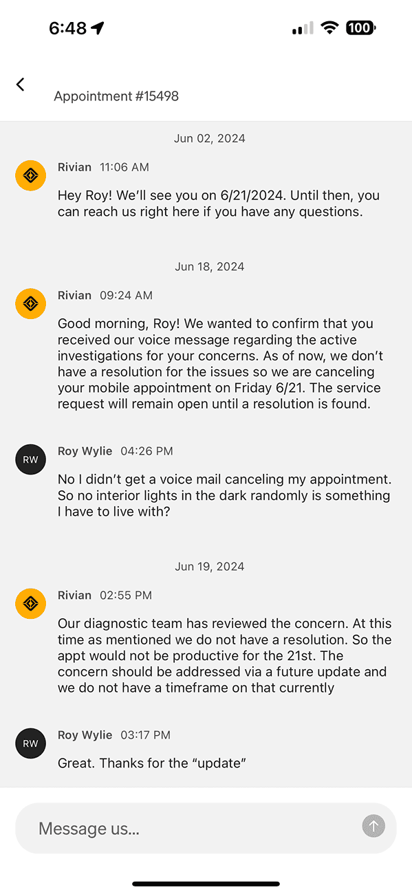

Hey all,
We recently moved into a house where I get to park the T in the garage. It’s an older garage door so it’s not always bright in there so this is how I figured out my overhead interior lights don’t come on with the door opening every time. It’s random and seems to be when the truck is in [deep?] sleep mode. I created a ticket and they set up an appointment then cancelled it. I was hoping it would be fixed with the latest update but no dice.
Anyone else experiencing this?
Door open=lights on doesn’t seem to be too much to ask for in 2024 on a vehicle of this caliber.

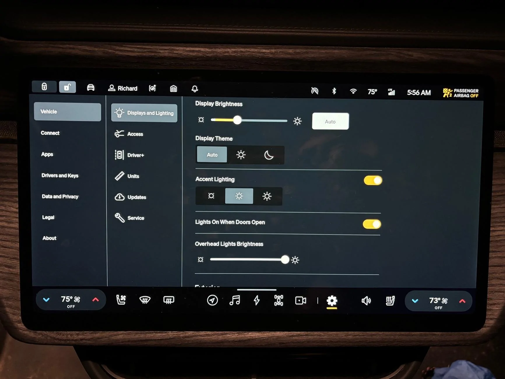

Mine is delayed coming on when it’s been sleeping but it does come on. I’d you haven’t, check this screen setting.

Thanks for the reply. I have checked that screen. Clicked all the buttons, done both kinds of resets and it still happens. Walked though it with a service rep on the phone and was able to catch it happening and create a log file. Not delayed but won’t come on at all without some kind of intervention from me, tap the light. Switch gears. Issues are going to happen but by their response I assume this is a widespread issues without a resolution. If it isn’t widespread, I don’t understand why they’re blowing me off and not even attempting to throw parts at it.

No resolution yet. I'm not sure whose customer service is worse, Rivian or Verizon. The tech has been out multiple times, sometimes with parts, and sometimes without. He replaced the light assembly by the rear view mirror but that didn't fix it. He said he sent a video of the issue to whoever, (engineering, tech support, a crystal ball reader) but nothing yet. Think I've had to call this in at least 3 times, so frustrating. I hard problem to fix I can understand, but the fumbling of communication and lack of follow up is astonishing. SHIT, I didn't realize this has been going on since July.... ugh

The Atlanta SC had it for two days and sent me a generic “all done” message. Long story short, they had it for two weeks and told me no problem found, it’s a known issue, they can’t warranty an intermittent issue, their supplier won’t let them warranty it, to finally it’s going to be fixed with the next update. Something about the BCAN firmware needs an update. I figure they’ve spent a couple grand between the multiple mobile tech visits, the loaner vehicle they gave me, and the new hubs and half shafts I got installed as a consolation prize. Seems it would have been cheaper and quicker to just fix it the first time.

Yeah, let me know how you fair. I almost forgot the best part. From my invoice. Lights have been turning on in cars with doors opening for over 70 years. Now it’s normal to be in the dark!? Smh
Concern:
- Customer States: their overhead lights do not work when trying to open the door and this is the third time addressing this concenr
Cause:
- The customer's concern pertains to a characteristic inherent to the vehicle, which is considered
normal. Expected improvements to be implemented in a future firmware update.
Correction/Remedy:
- Interior Lighting General Diagnostic, No Trouble Found | Labor Code: 825599112 | 0.5 hr* |
