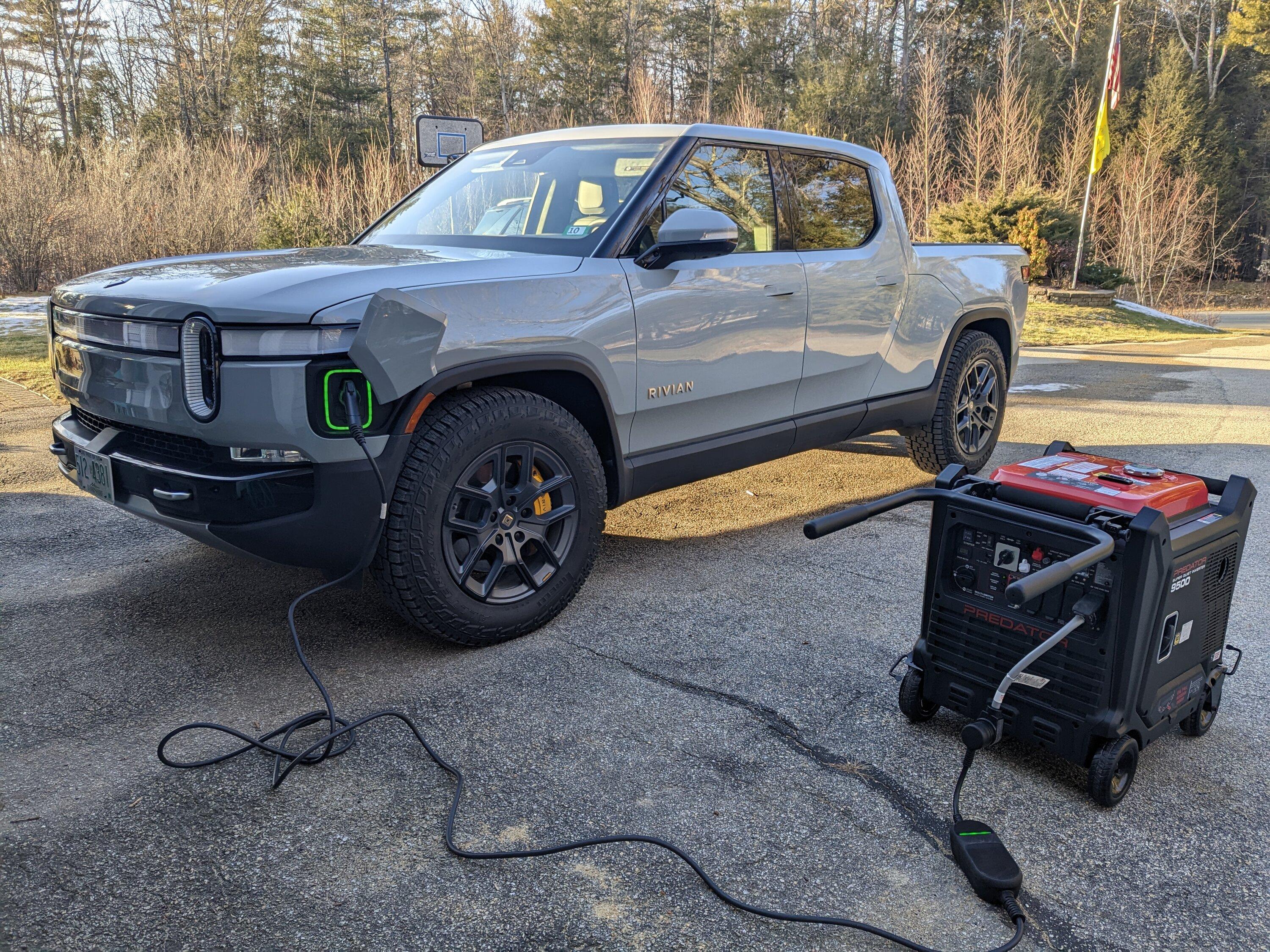

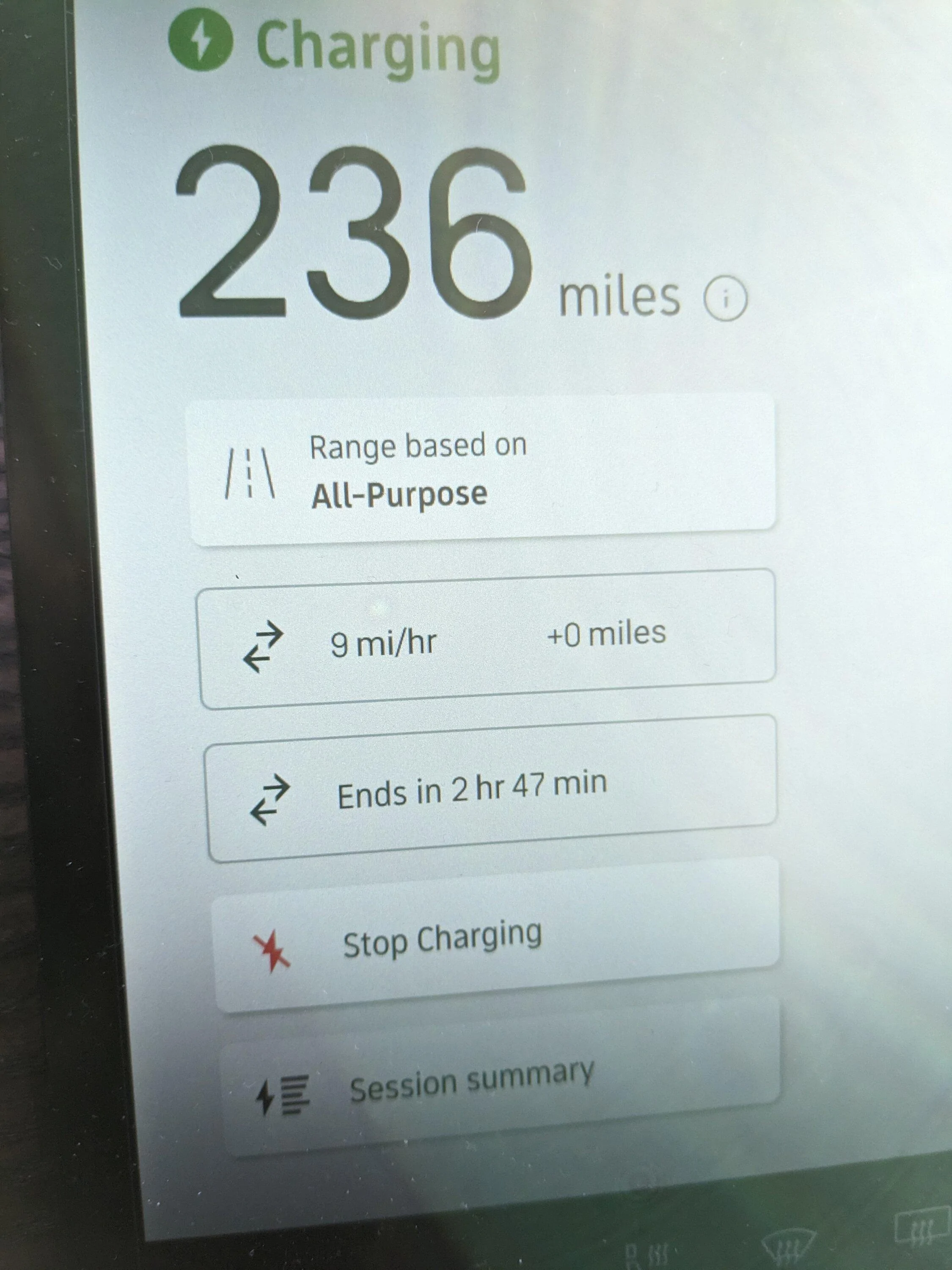

After a recent power outage here in NH I decided to upgrade to a nicer generator to power the house and found an adapter to run the mobile charger from it as well. It powers right up and provides 5.2 kw to the truck. This could come in handy to charge the truck in the next outage in a pinch or to carry in the bed to extend my off-grid range for longer distance overland excursions in Northern Maine and NH where you're much more likely to encounter a moose than a source of electricity.
AC WORKS Electric Vehicle Charging Adapter (L14-30 30Amp 4-Proing to 14-50R) https://a.co/d/hQqXuOo
https://www.harborfreight.com/9500-...enerator-with-co-secure-technology-57080.html
Rivian R1T R1S It's a hybrid now... R1T charged at 5.2kw with portable generator and charging adapter PXL_20230110_201505062.MP
Rivian R1T R1S It's a hybrid now... R1T charged at 5.2kw with portable generator and charging adapter PXL_20230110_201618637.MP

I'll have to do more comprehensive tests at some point, this was just an initial test as proof of concept. My complete SWAG is that about 9 gallons of generator gas should charge the battery from nearly empty to full in about 18 hours at 5.2 kW given that the generator is marketed to have 12 hours run time on 6 gallons. It's a complete guess, so don't put much stock into it, I'll run an actual test at some point. In any case, what I really need is the ability to drive to the northernmost charger on my way to the north woods and 150-200ish miles from there into a campsite with the ability to explore around up there and then get back to the charger without range anxiety. This will easily allow me to do that with just a full generator tank and no need to carry a jerry can.
If so that's in the ballpark of 30mpg which is about what I'd napkin'd out when thinking about a similar setup. Someone just needs to make a 5.2kW generator that fits under the tonneau and we're in business!

You’ve found an Adventure extender @ElectrifiedOverland ! …but was it SUPER QUIET as advertised or just QUIET?
I'd say just "quiet" but I suppose it's in the ear of the beholder. It's much much quieter than the generator it's replacing

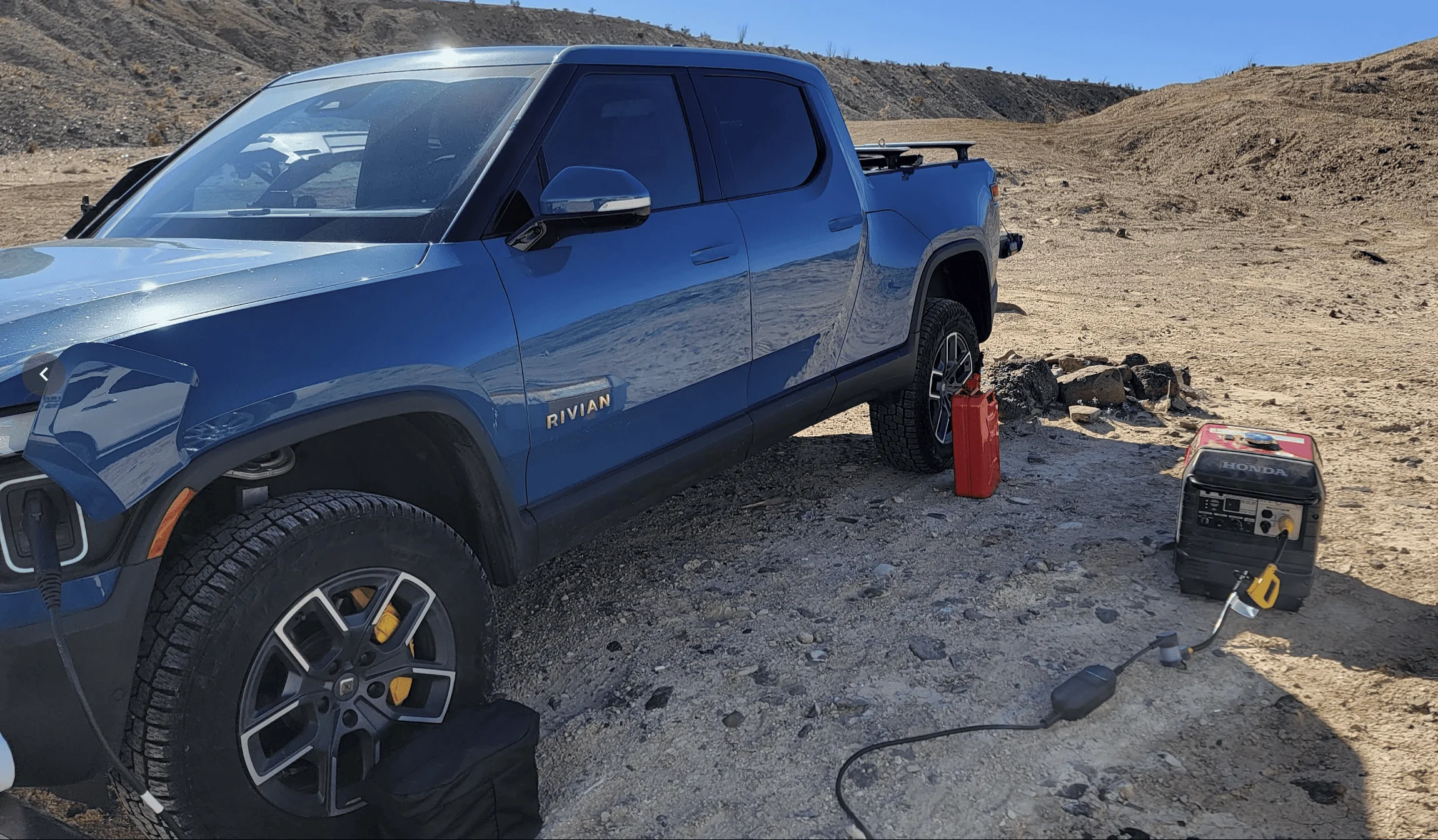

Was out in the dessert east of San Diego. Did not have enough juice to make it home towing. Honda generator did the trick with the right power adapters. Took a while but I wasn't going anywhere.
Rivian R1T R1S It's a hybrid now... R1T charged at 5.2kw with portable generator and charging adapter 1673411422987
