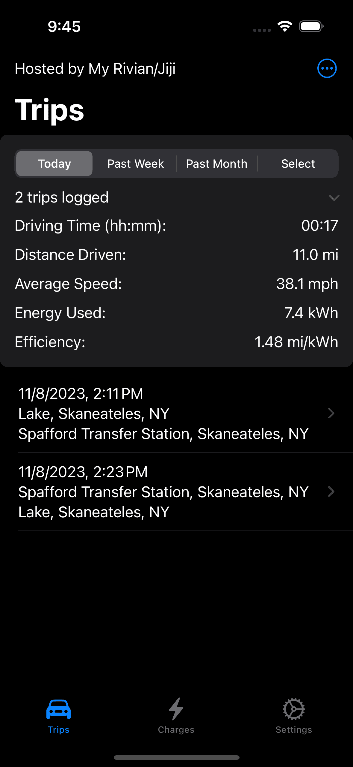

The results of a trip to the local transfer station at a higher elevation (~750') was not exactly unexpected but when I looked at the details I found the ride back was free.
Here is the overview of the trips out and back:
Rivian R1T R1S Just how much does elevation change affect your efficiency? 1699498091275
Not great efficiency but with temps near freezing (seat and steering wheel on with the cabin temp set to 72ÂşF) and carrying a trash hauler on the trailer hitch are obvious hits to the efficiency. And before the complaints start, the efficiency result is an estimate since it is calculated from the change in SoC so while it may be off from the true efficiency the relationship of two efficiencies should be accurate.

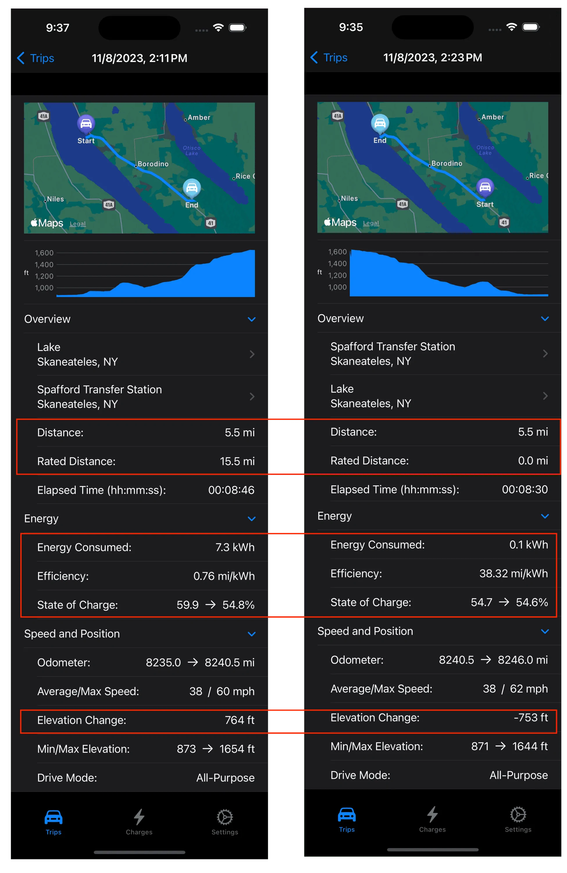

Looking at the details of each trip, the elevation profile shows how the outbound trip did all the work and the return trip was a free ride. (And as an aside, the screenshots are cut and pasted since there is more information than can be viewed in a. single screen.)
Rivian R1T R1S Just how much does elevation change affect your efficiency? 1699498711660
Of course the actual distance is the same for both trips but the rated distance, which is the change in the distance to empty from the trip start to the trip end, are very different. The energy use and the change in the SoC dramatically show the effect of an elevation change on a single trip (but doesn't matter so much on a round trip).

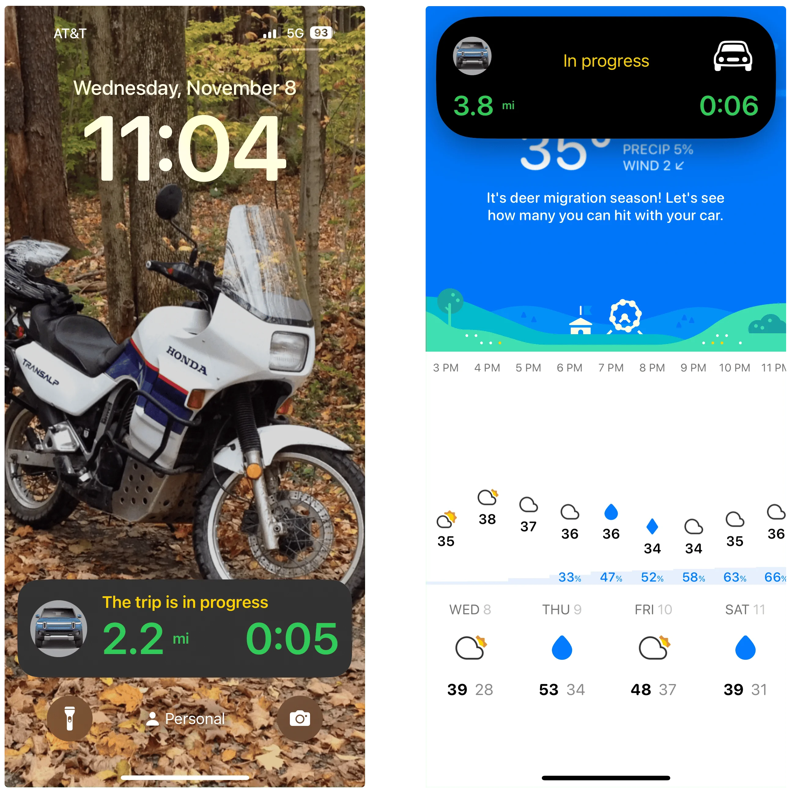

This is just a fun winter project where I like to explore new software development tricks and techniques to exercise the gray matter. While I am happy to share the results there is no grand development plan or strategy other than my personal satisfaction.
Here is a peek at the next update which adds Live Activities so you can see the progress of a trip or charge in the lock screen and support for devices with the Dynamic Island:
Rivian R1T R1S Just how much does elevation change affect your efficiency? 1699501546445
