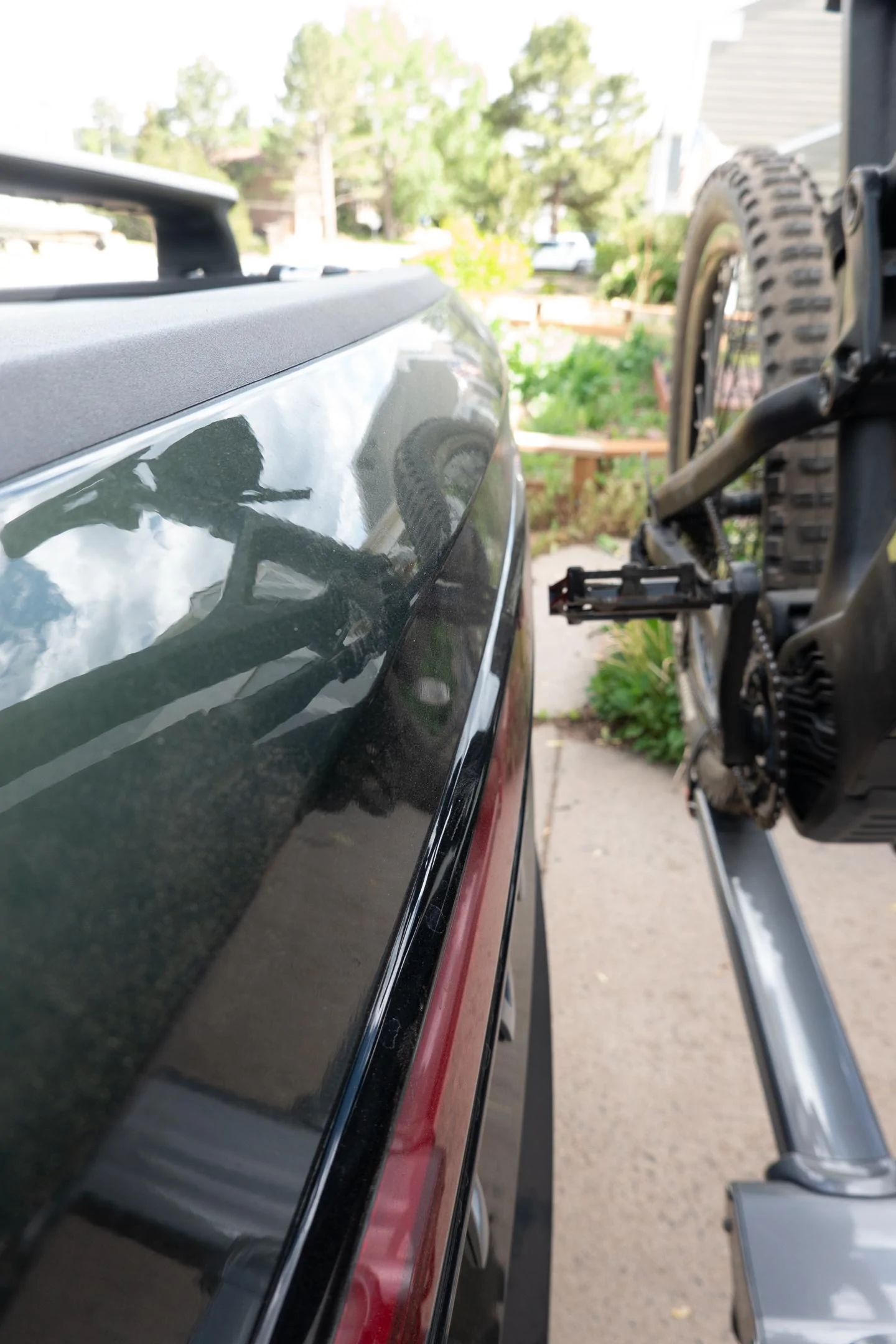

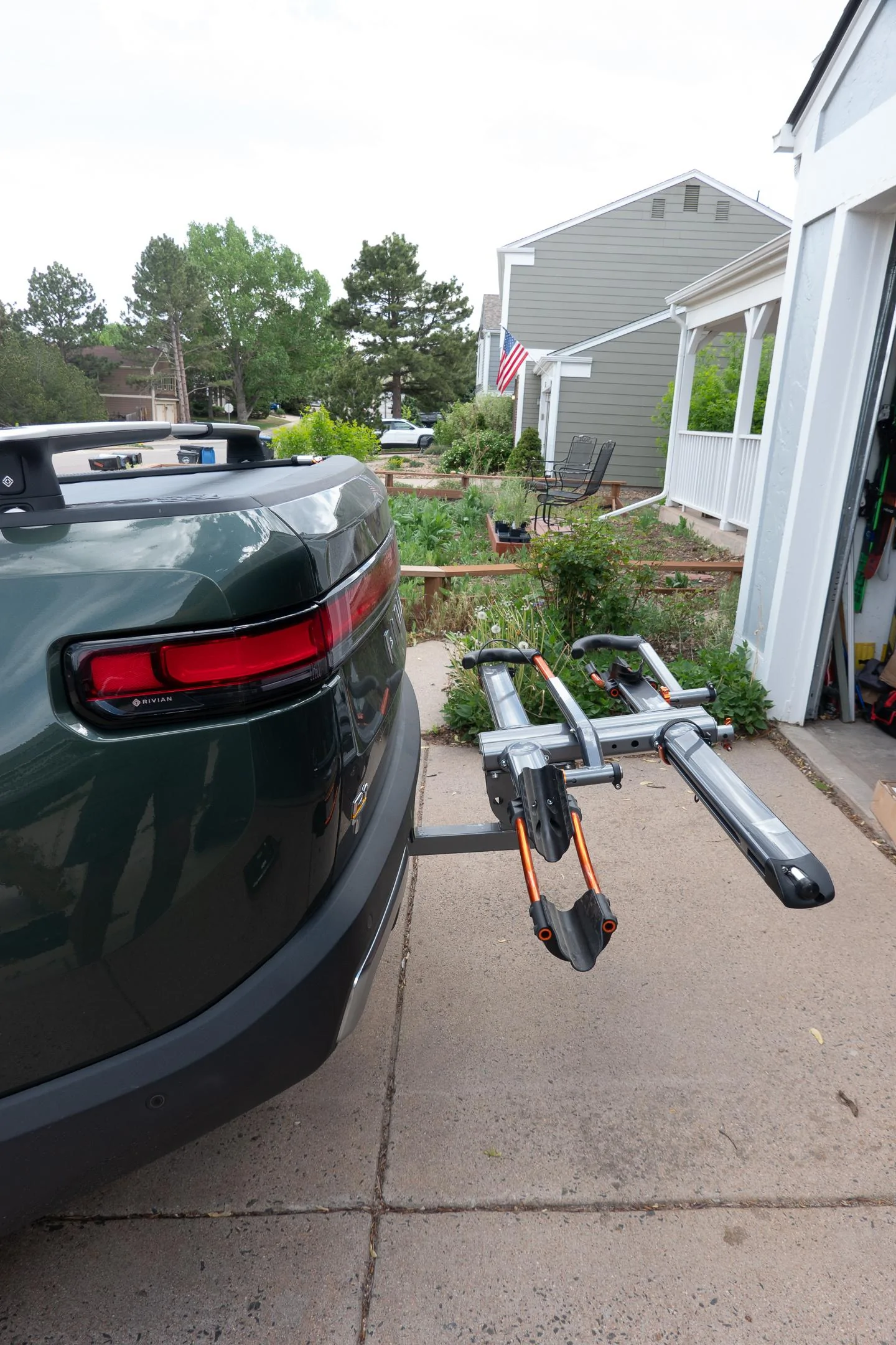

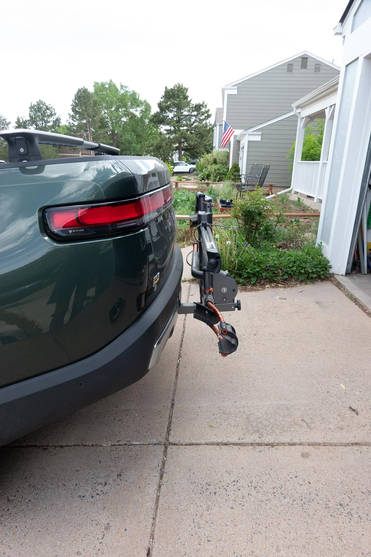

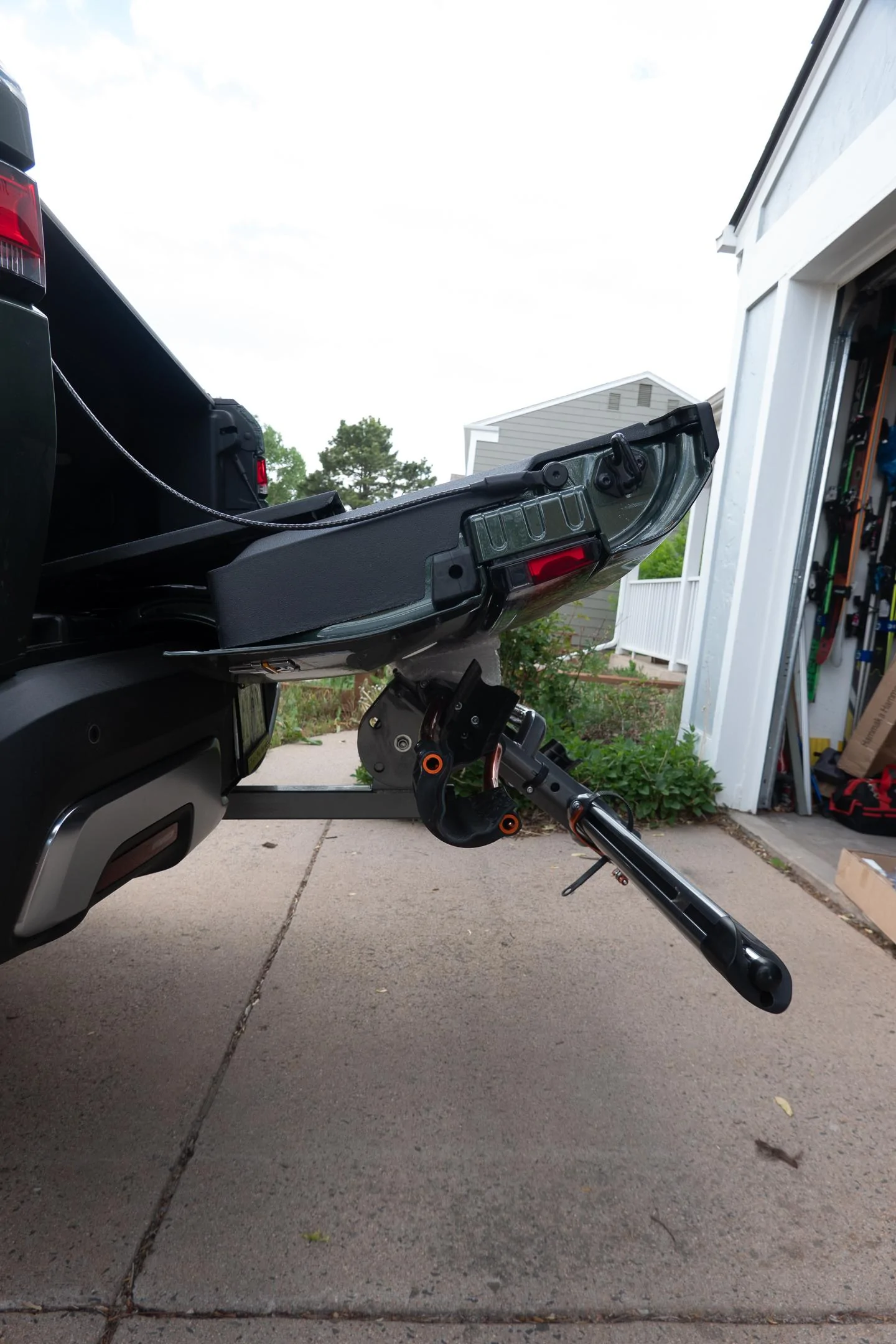

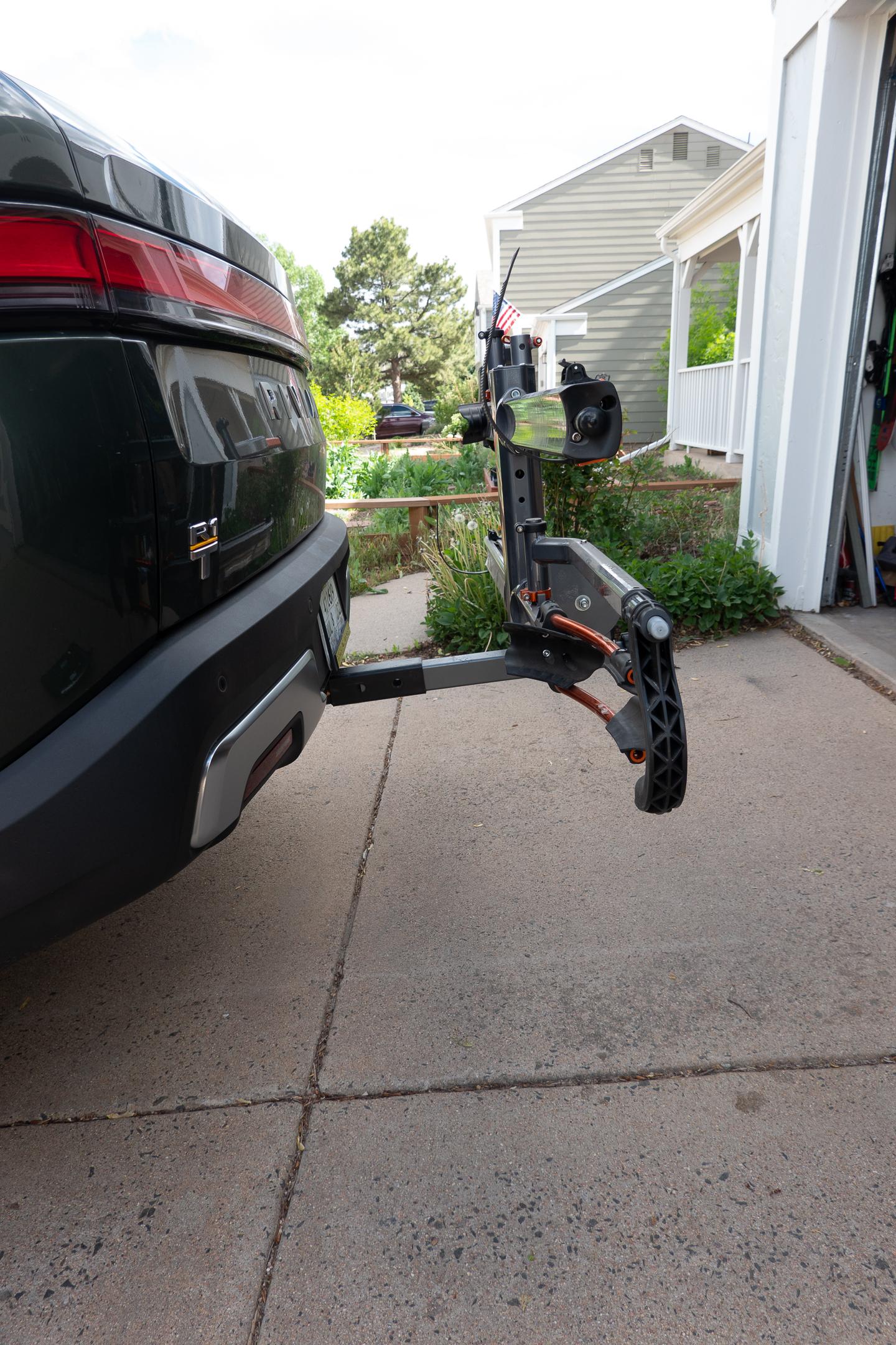

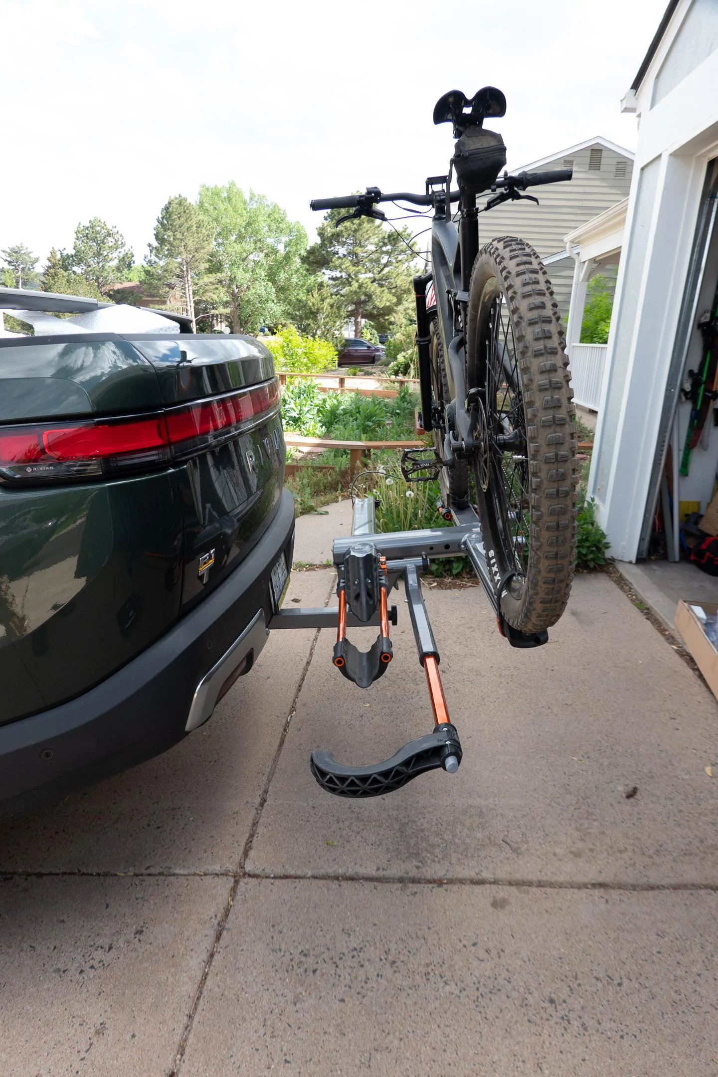

For those of you who might have a Kuat NV2 bike rack you want to use with your truck. It fits, but with a bike mounted inboard the pedal is dangerously close to the tailgate. Also, when dropped down the tailgate hits the rack, even without a bike.

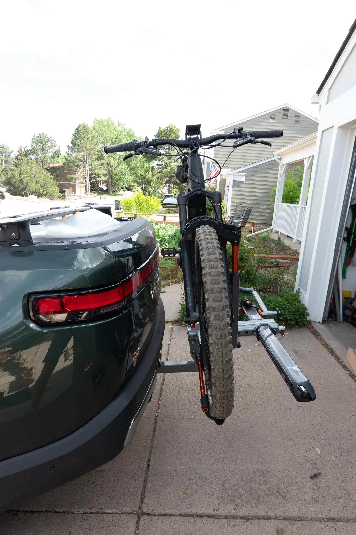

With the bike in the outboard spot there's of course more room, but still won't be opening the tailgate safely.

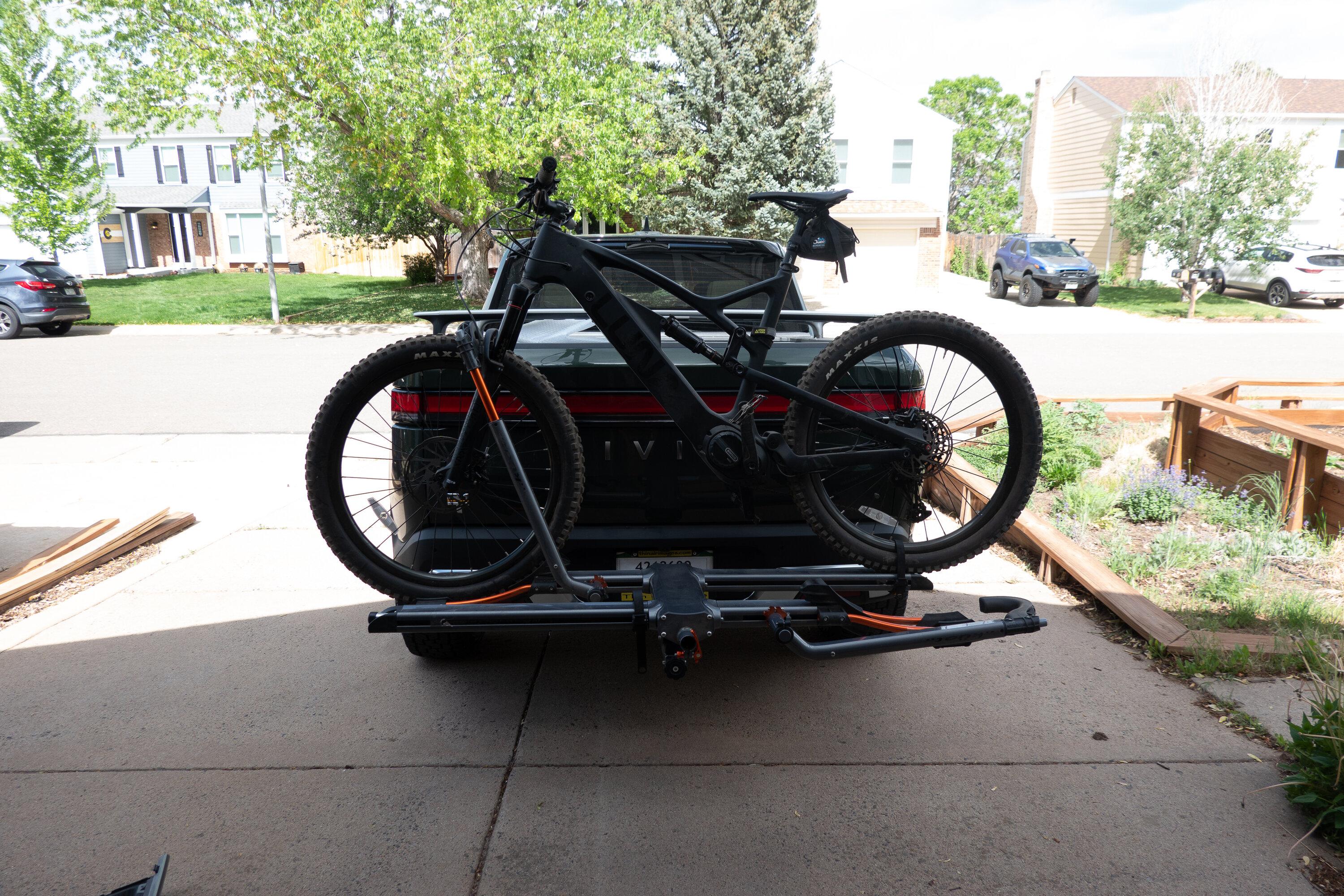

Adding a hitch extension doesn't solve the tailgate problem, it still hits.

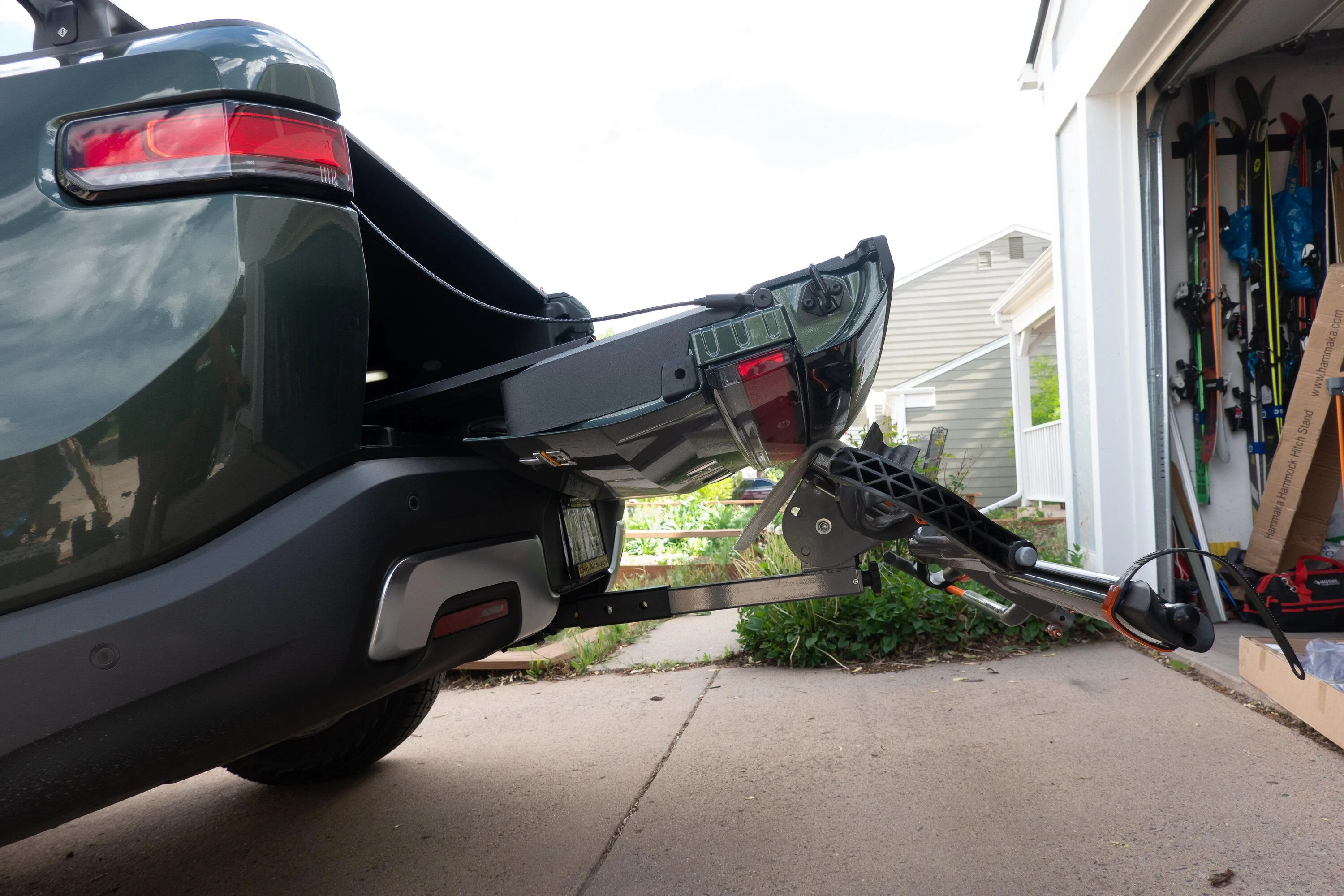

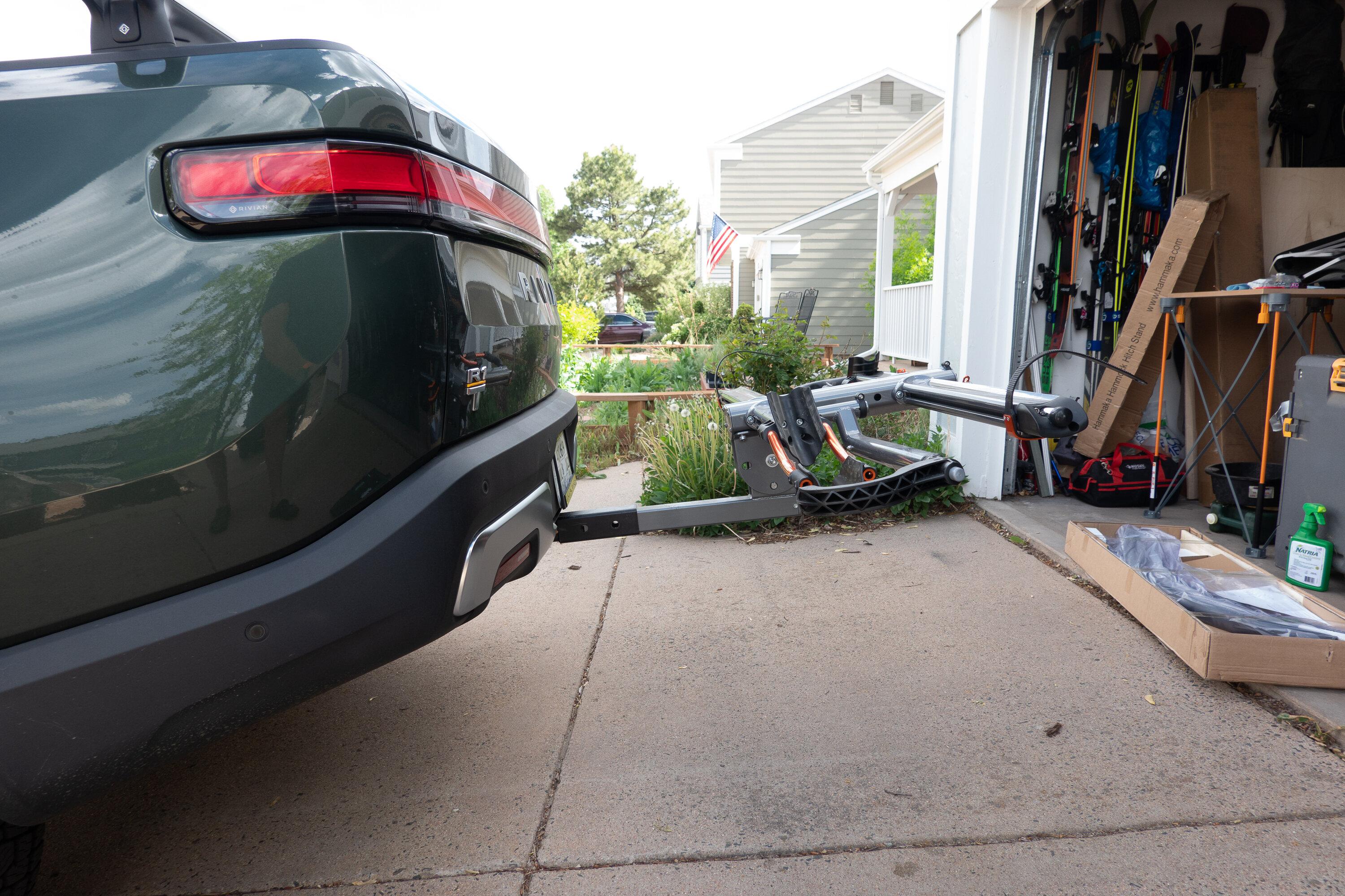

I ordered a 4" drop/riser extension from Amazon and it arrived today.
With it in the drop position, I can now open the tailgate fully as long as I don't have a bike in the inboard position. There are 2 holes on the extension and these pics are with the pin in the hole that minimizes extension.

No surprise, but it improves the space between the pedal and the tailgate.

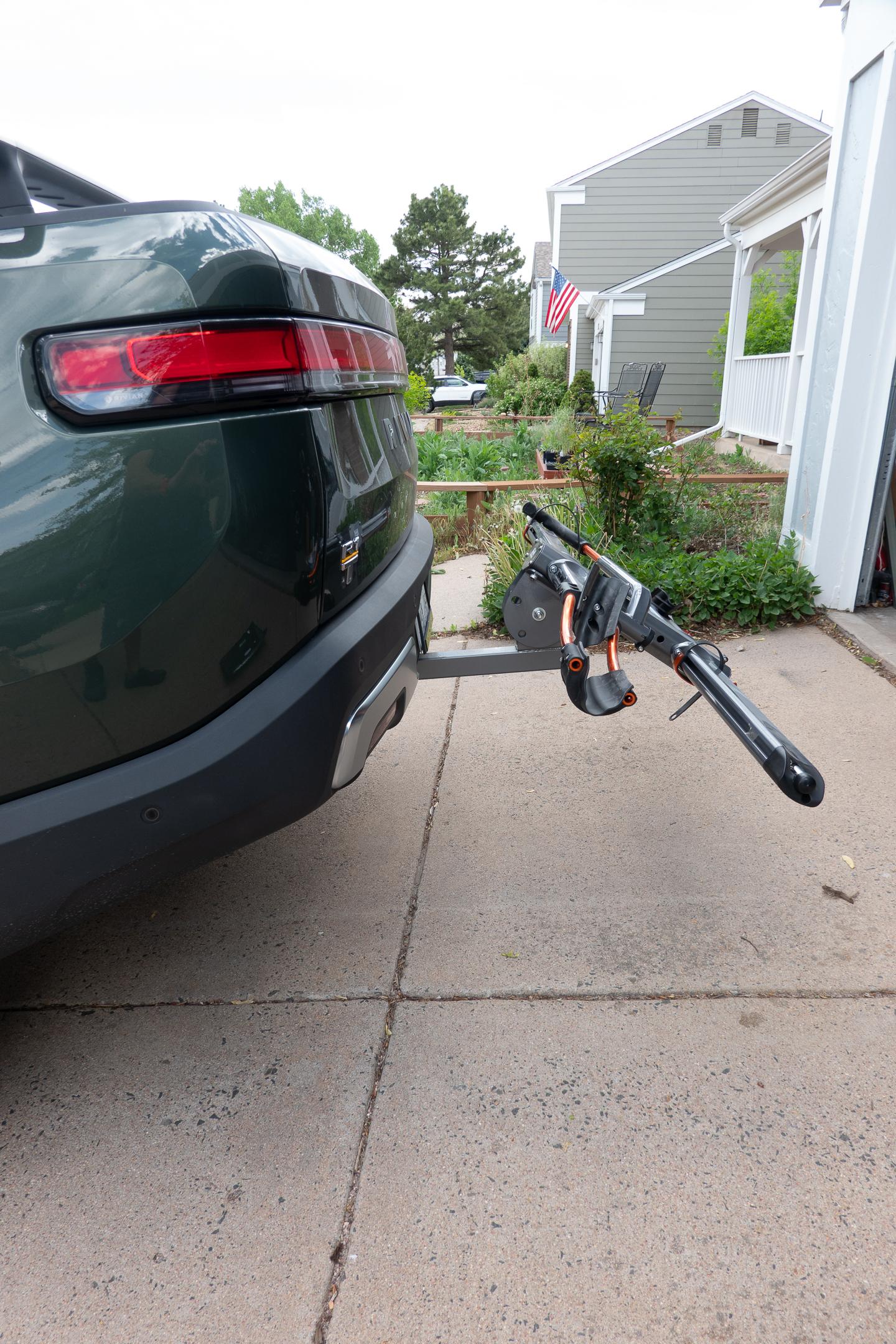

Sliding the extension out further and using the 2nd hole with the pin still won't allow opening the tailgate with a bike on the rack in the inboard position. I didn't try, but looking at the pic it "might" work if the pedal was in the 12 o'clock position.

I don't see 6 being a good position, though I didn't try it. I may try again later in the week. I'd consider a swing-away adapter, but don't want to add that much more weight. I may borrow my neighbor's older 1-up to see how it fares.
