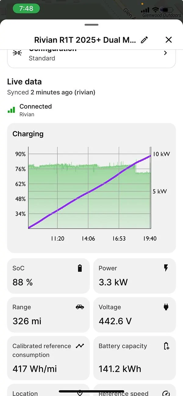

Super disappointing. Charging from 20% SoC. Battery steadily warmed up from 43F to 54F at 80% SoC. Hoped for great things. Battery now at 54.7F. But charge rate has exhibited the same step function. Now 3.3kW at 88% SoC. So 50F is not the magic threshhold, at least not for the R1T I have.
Do you have a 48 Amp EVSE? Is it true your EVSE never hit 11 kW during the entire charging cycle, starting at 20%? This problem is even worse than I thought (if you are using a 48 AMP EVSE).
40A charger. ~9A is max output.
54 degrees is not that cold. I still cannot believe it is throttling charge when the battery is 54 degrees. I could understand it if the battery was actually frozen, or something below 0 degrees, but 54? Seriously?
My garage rarely drops below 60 degrees, even in the coldest months of the winter. Can I even get a good charge in my relatively warm garage? At what temperature does the Max pack allow full L2 charging speed up past 90%?
When I travel, hotel parking garages are not heated, and they can get very cold. This is what really concerns me about this problem. Because this is the main reason I have been considering a Tri Max.

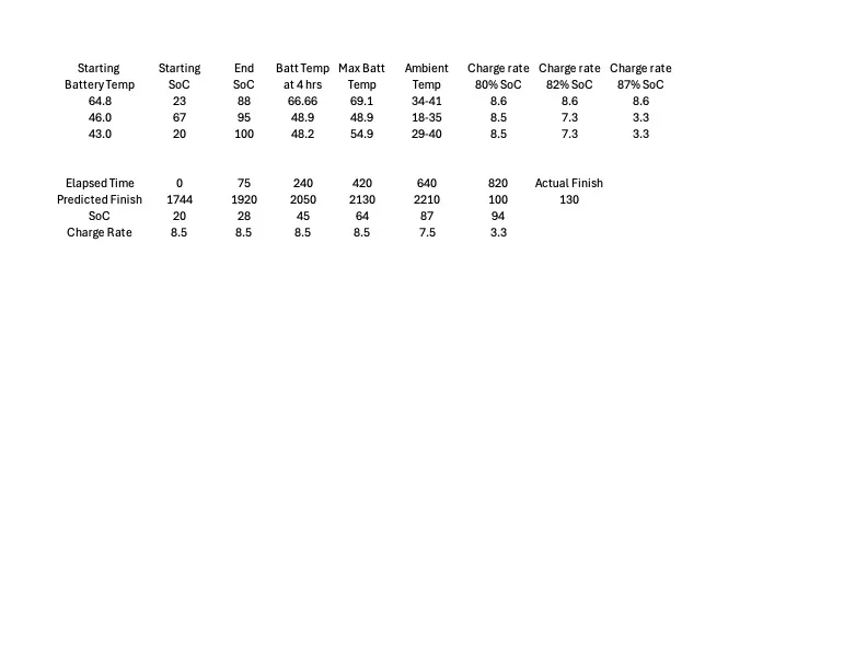

Took it to 100%. "Good" news is that it stayed at 3.3kW the rest of the way to 100%. The bad news is that it still took over 17 hours to charge from 20% to 100%. If I had a 48A charger, it would have still been over 15 hours. That's not overnight.
Ambient temps were 30-40F.
Summarizing my 3 charging sessions since the software update;
1 - No charging loss when battery temp was in mid-60s.
2 - Inconsistent heating and final battery temperatures with the two long charge sessions (2nd session peaked at 49F even though the battery was warmer to start than in 3rd session where peak temp was 55F)
3 - There is no apparent correlation between ambient temp and battery start temp (ignore first session, as that was started immediately after truck was driven.
4 -The truck has no clue as to how it is going to charge - predicted finish time was originally 1744, and it finally finished charging at 0130, 7 hours later than originally predicted and taking more than twice as long as predicted. I see similar behavior with L3 charging.

My R1T is a Tri Max with a delivery date of December 9, 2024. Charger is a 48A Rivian hardwired to 60A circuit. Ambient temperature is 20-50F outside. Have never experienced throttling issue in 3 years of Gen 1 R1T Quad ownership. I drove 420 miles round trip for a service in January, service advisor did nothing except noting an OTA 2024.51 will fix the problem. Problem remains the same after OTA 2024.51. Would not have gotten Gen 2 if this was disclosed.
SeaGeo
Brice
Jan 12, 2021
5,539
10,020
Xc60 T8
I have a weak theory: there is no buffer at the top of the pack. Because there is no buffer, they have to be very careful how it charges to 100%. The previous max pack had a bigger battery, and a bigger buffer, so it could handle a full L2 charge for longer.
Gen1 max and Gen2 max are the same capacity. Same cells, and same number of cells. Unless they snuck a change in there that nobody has documented.

Hey everyone, I've decided to try and get a bit more organized about this—let's get some solid data so we can push for a resolution or at least closure:
Edit: removed extraneous content
Note: these tables originally came from running OpenAI's o1-pro over this thread, so may well have a load of errors:
Group 1: Users Experiencing the Issue
UsernameVehicle Model & PackMotor / GenApprox. Delivery/Build DateCharging Slowdown PatternAmbient / Battery Temp RangeCharger (Amps/Type)Preconditioning AttemptsService TicketNotes on Root-Cause Variables
@GlogicR1S (Likely Max Pack)Gen2~Mid-Dec 2024Drops sharply above ~80% SoC (from ~11 kW to ~2–3 kW or lower)~20–30 °F ambient (Massachusetts winter)Tesla home charger + adapterTried battery heat from short drive; still inconsistentPossiblyNever saw this problem with his Tesla in same temps. Finds it “unpredictable.” Does not mention exact battery temperature data. Concern about overnight top-offs.
@portdirectR1T Tri Motor Max (stated)Gen2~Nov 12, 2024 build (mentioned)“Stair-step” throttle above ~75–80% SoC in cold; reminiscent of BMS limitOften <50 °F; battery remains coolerRivian Wall Charger, Wallbox Pulsar, Clipper Creek testedNo mention of purposeful “DCFC route” trickYesOwns a Gen1 for comparison. Notes Gen2 is significantly worse above ~80%. Hard to sustain higher charge rate if battery never warms enough.
@MarkNormanR1S (Dual Motor Large)Gen2Early Dec 2024Steps from ~11 kW → 8 kW → 4 kW → ~1–2 kW as SoC rises (80–90%+)Battery stable around 46 °F during chargeNot specified EVSETried partial DCFC before L2 with varied successUnclearProvides extensive logs (via ABRP). Observes battery is not heating enough to avoid throttling. “Thought it was a bug, but remains an issue.”
@COMtnEVR1T Dual Perf. MaxGen2~Sep 2024Consistent “stair-step” from ~9 kW → 6–7 kW → 3–4 kW as SoC climbs (75–90%)~40–50 °F (battery often ~45–55 °F)40 A Eviqo charger; sees mismatch across data toolsHas methodically tried driving first; partial successYes (filed)Very detailed logs show repeated throttling above ~75% in 40–50 °F. Reports it severely impacts daily use. Data conflicts between ABRP & truck’s readouts.
@OYLmanR1S (Likely Max)Gen2Dec 6, 2024Very slow topping from ~80% to 100%; can’t reliably reach 100% overnightNot specified (car in unheated garage ~50 °F)Not specifiedPossibly attempted partial “drive then charge,” still limitedPossiblyService center had the vehicle; no resolution. States charging might drop to near trickle after ~80%. Big complication for road trips.
@Chi_GuyR1S Dual MaxGen2Not specifiedConfirmed drop above ~80% SoC; even limiting amps from 48 → 40 didn’t helpTypically <50–55 °F battery for the slowdownNot specifiedHas used DCFC preheat route to push battery above ~65 °F, which helpsNot reportedSays it’s consistent “stair-step” at 80% with battery <50–55 °F. If warmed to ~65+ °F (via nav to DCFC), can maintain 11 kW for longer.
@RiouxgrandeR1S Tri‑MaxGen2Factory-gated Sep 17, 2024OTA updates have not solved the severe L2 throttling above 80% SoCNot specifiedNot specifiedHas tried each new OTA; still sees no fixYes*Has an internal perspective (employee?), says Gen2 architecture “does something weird” with AC charging. Filed a ticket.
@bfilippoR1T Standard LFPGen2Not specified~13–15 hrs to fully charge to 100%; becomes near-impossible for daily useNot specifiedNot specifiedTried 100% charge multiple times, fails or takes >13 hrsYesIndicates LFP BMS also shows big slowdowns approaching 100%. Not purely a Max-pack phenomenon.
@SparkyR1tNot specified R1T or R1SGen2Not specifiedMentions initial throttling, minimal details providedNot specifiedNot specifiedReached out to Tesla’s charger support, but presumably truck-limitedUnknownDetails are sparse. Possibly overcame a separate home-charger overheat, but acknowledges the Rivian side was also throttling.
@MrMechanic2025 R1S (Gen2)Gen2Not specifiedObserves the same stepwise L2 drop at higher SoC, consistent w/ othersNot specifiedNot specifiedNo mention of preheat strategies or partial DCFCNot specifiedConfirms “same behaviors,” presumably in moderate ambient/cold.
@SSFC5Possibly an R1T/R1S w/ MaxGen2Not specifiedSays the latest OTA didn’t fix throttling; still slow at high SoCNot specifiedNot specifiedDoesn’t mention preconditioning or other attemptsPossiblyFrustration that software updates had no real improvement.
@windblowlcTri or Dual Max R1TGen2Not specifiedMust start L2 hours earlier than normal to reach 100%; big scheduling issuesNot specifiedPossibly Tesla Universal Wall Connector or others in other postsNot indicated (some manual preheat?)UnknownSevere slowdowns hamper using the top 15–20% of SoC effectively. “No fix from Rivian.”
Group 2: Users Not Experiencing the Issue
UsernameVehicle Model & PackMotor / GenApprox. Delivery/Build DateAny Throttle Observed?Ambient / Battery TempsCharger (Amps/Type)Preconditioning AttemptsService TicketNotes on Root-Cause Variables
@SeaGeoR1T or R1S (Max Pack)Gen2Not specifiedNo—no major throttling reportedNot specifiedNot specifiedNone needed (didn’t see slowdown)NoSuggests personal usage may keep battery warmer; never replicates others’ slowdowns
Group 3: Users Commenting / Concerned (No Personal Issue Reported)
UsernameVehicle Model / PackMotor / GenHas This Issue?Approx. DeliveryKey Comment / ConcernAmbient / Battery TempsChargerTicket FiledAdditional Observations
@mkhuffmanNot an owner yet; possibly looking at Tri MaxGen1N/AN/AStates the throttling is “unacceptable”N/AN/AUnknownWorried about low-temperature top-off; says it’s a deal-breaker if not fixed
@tbross319N/AN/AN/AN/AOnly inquires about software release evidence; no personal charge issuesN/AN/ANoHas no reported throttling, just verifying if new OTA is real/fixes anything
@hobbyjogger71Not specified; a friend’s Gen2 is impactedLikely Gen2No (just referencing friend)N/AReports friend’s issues (matching slow L2 speeds); worried about reliabilityN/AN/ANot reportedPossibly sees same pattern with a friend’s Tesla UWC EVSE. Concerned by cold
@DeafPugNot specified; offers advice onlyAdvisoryDoes not say if impactedN/ASuggests calibrating or topping to 100% as workaround; no personal dataN/AN/AN/ANot personally impacted—giving potential solutions (charging to 100% more often)
I do indeed have a service ticket. I should be taking it in March 3 but don't see the point in it
