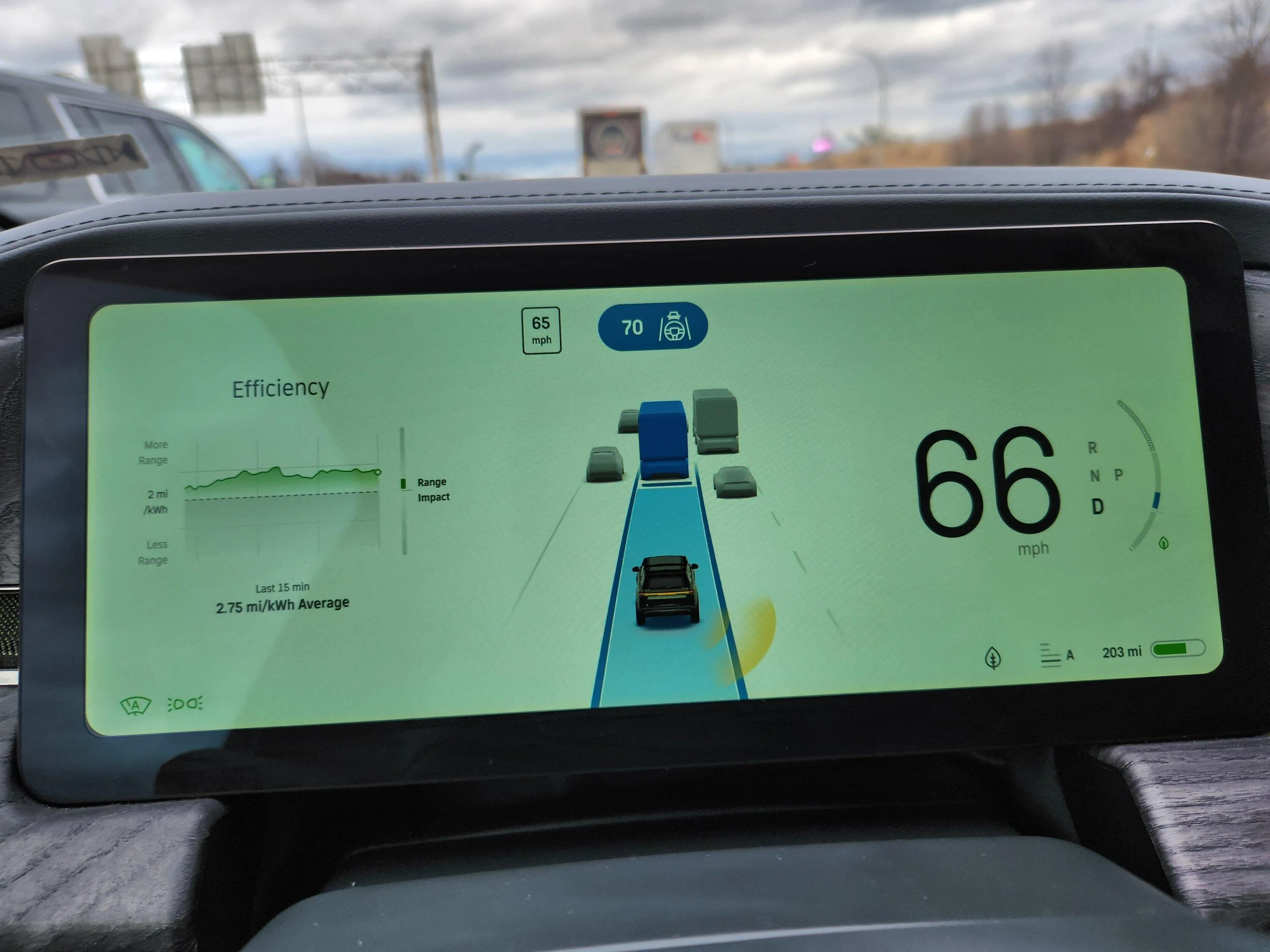

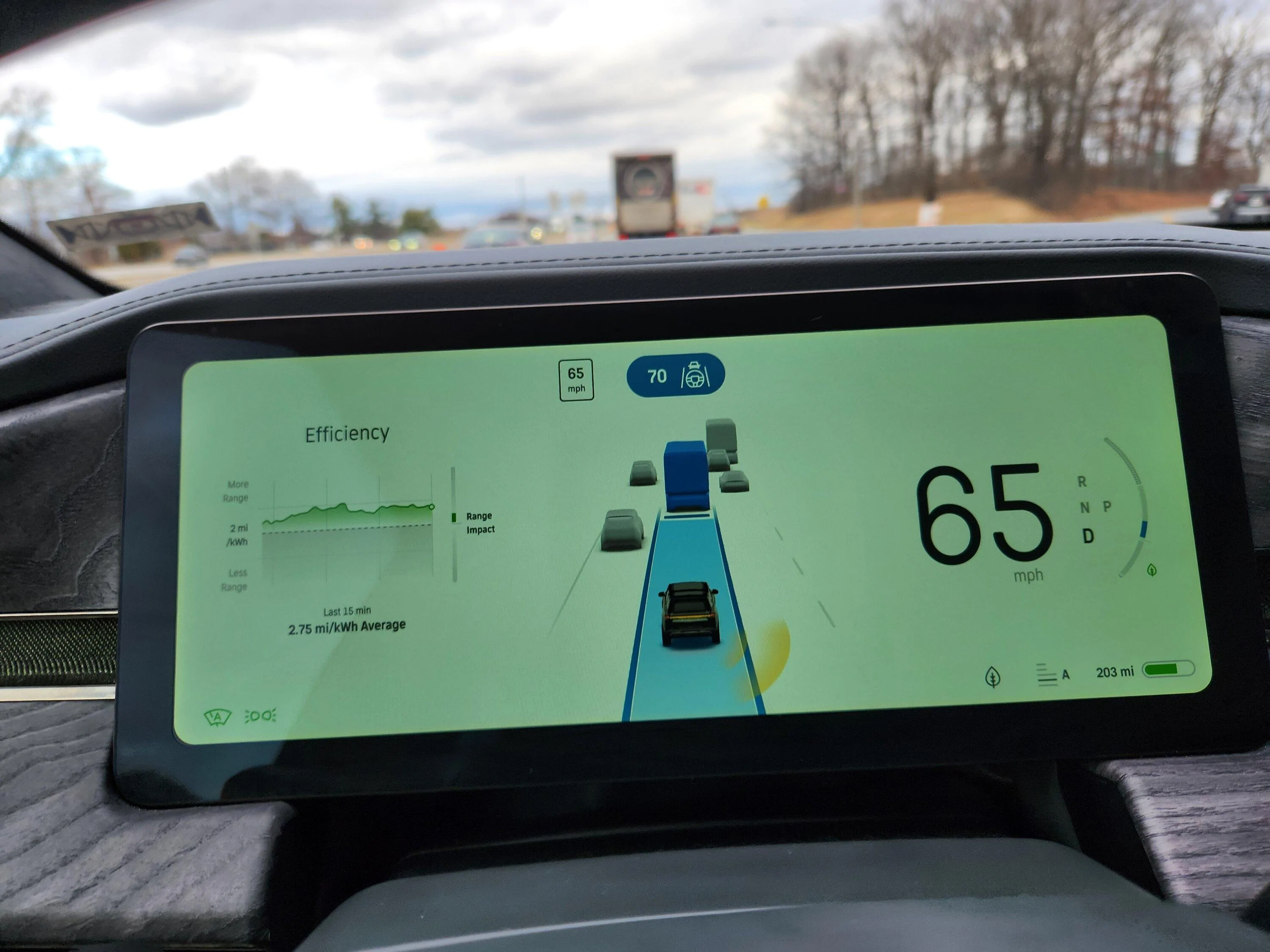

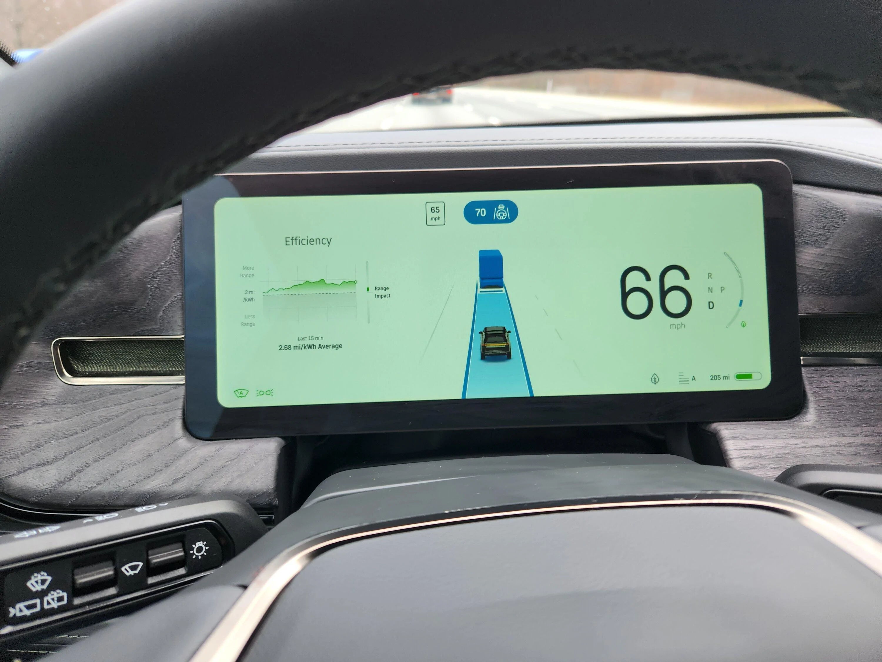

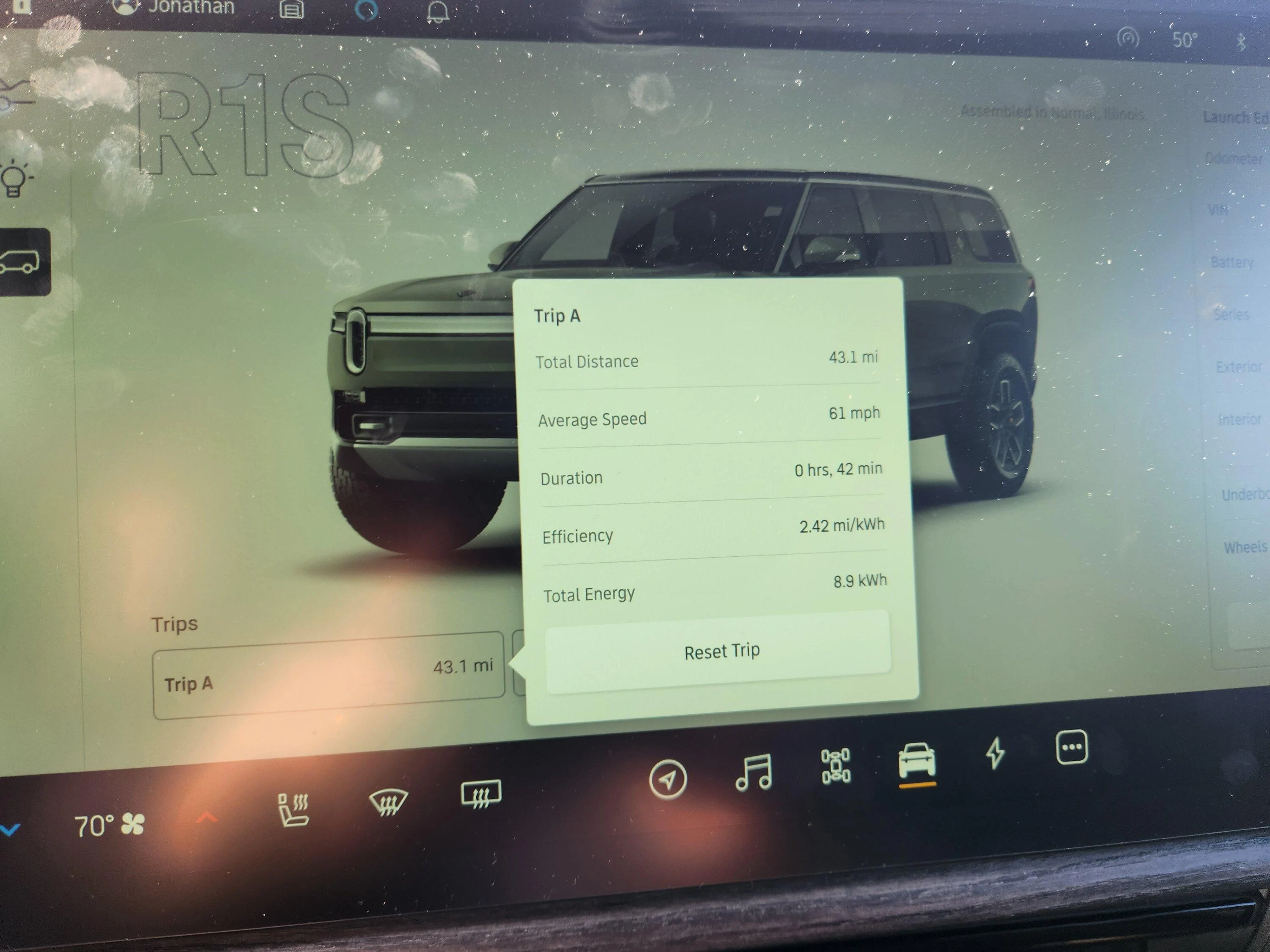

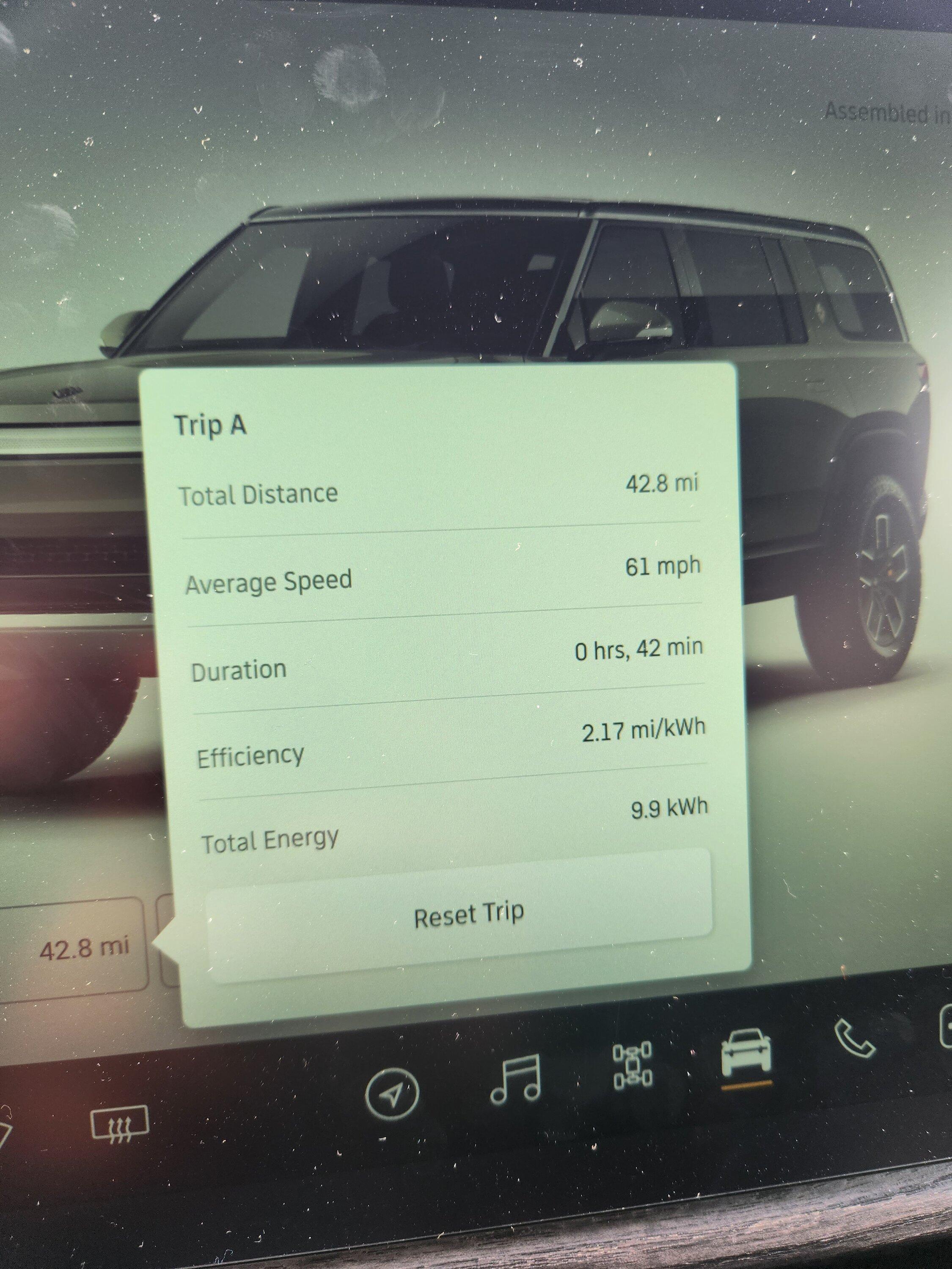

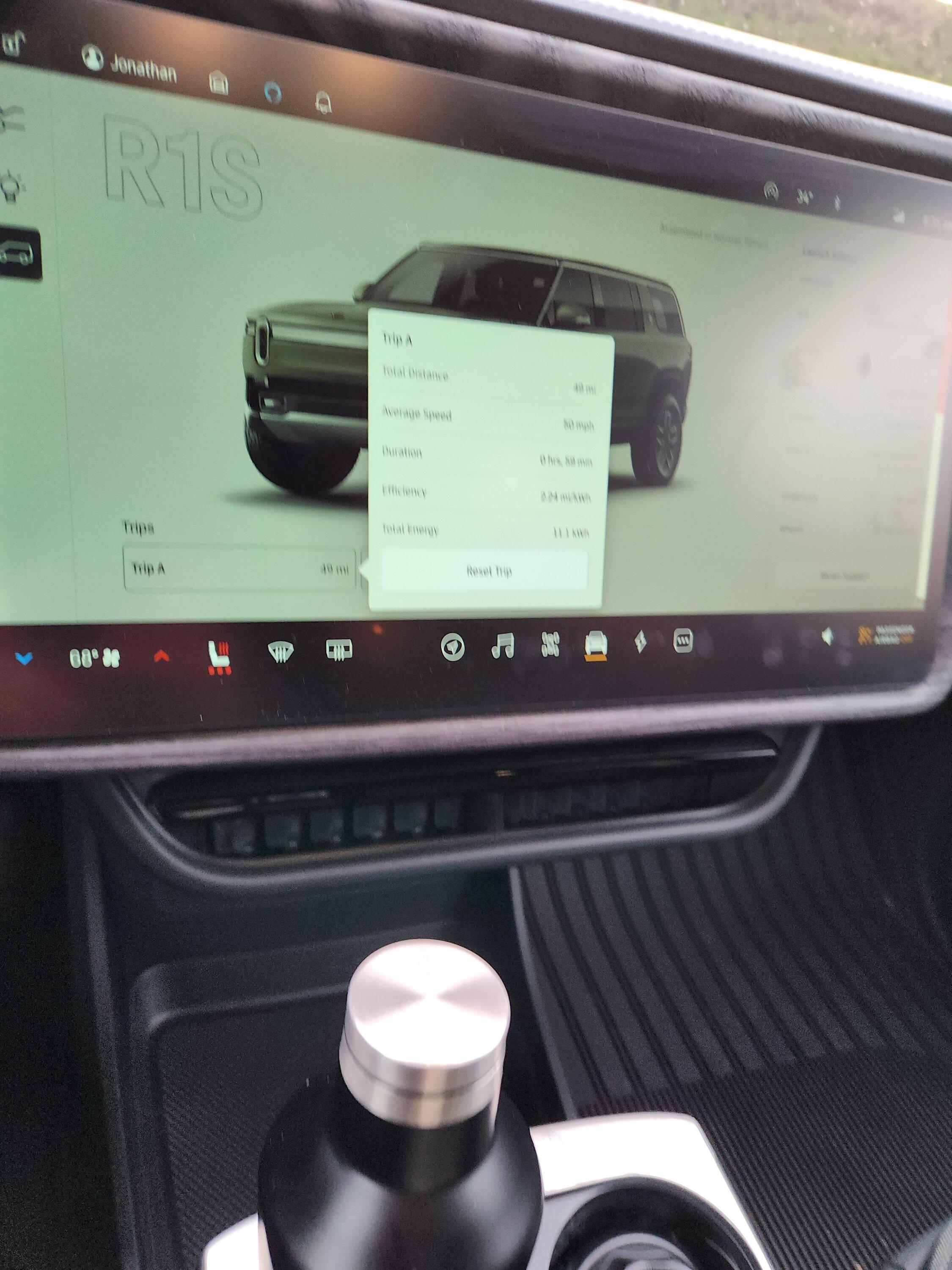

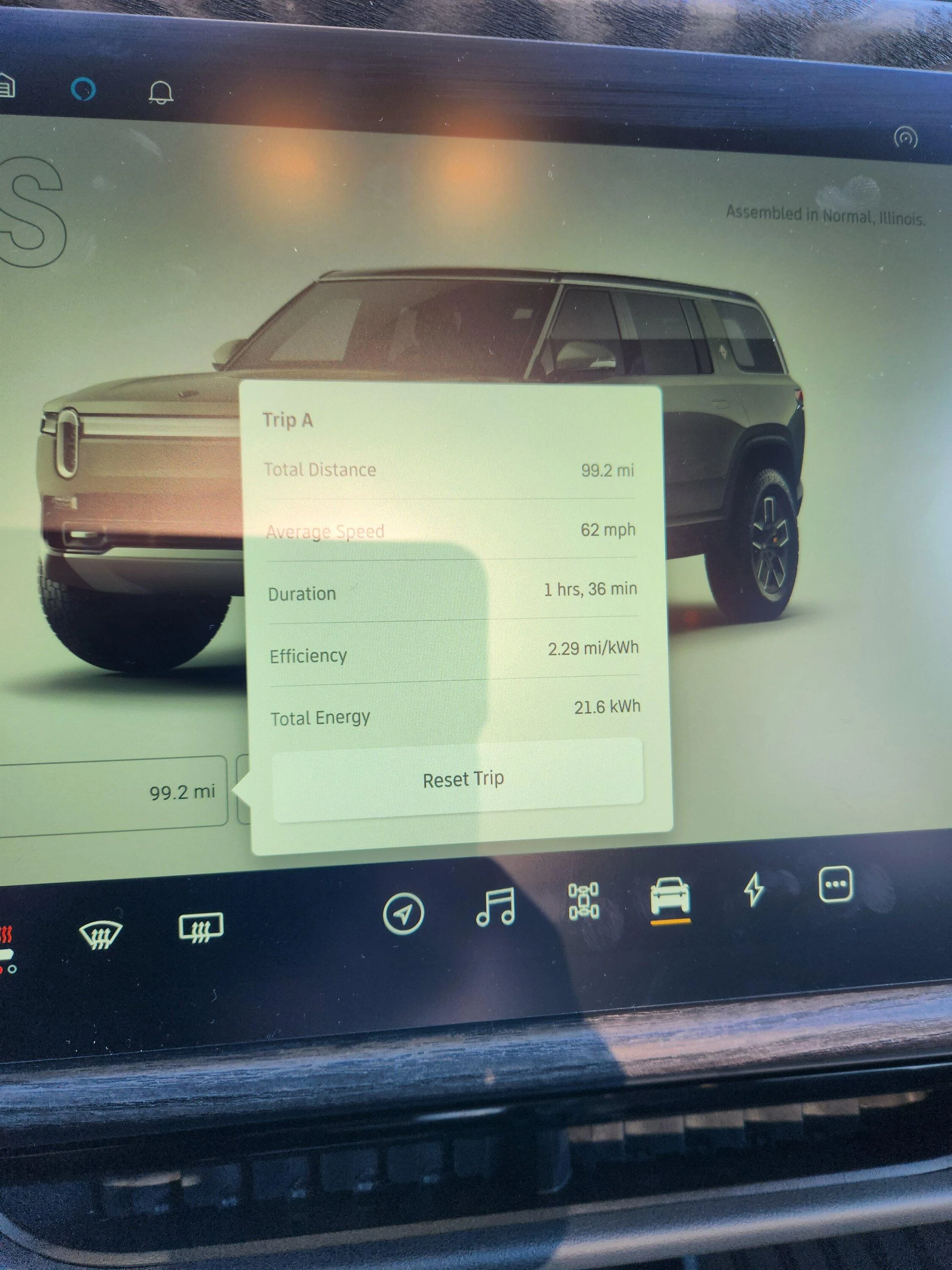

This time from right screen. I was behind trucks and traffic so it may not be instructive for you.
Thank you. Very helpful. I doubt that I would get above 1.8 at 75 without traffic.
