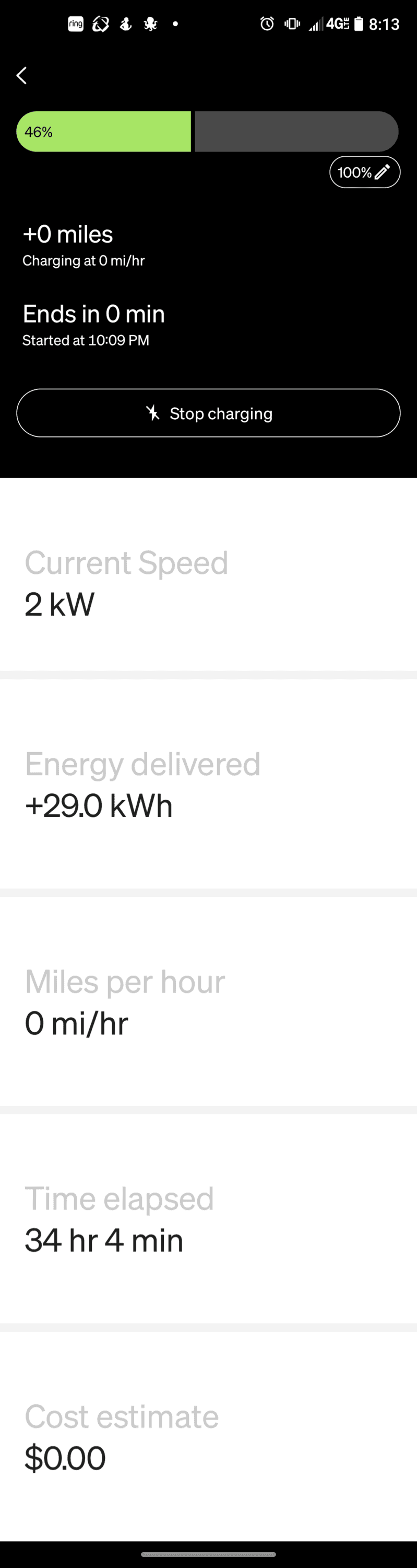

Ok I think I am losing my mind! So yesterday I didn't need my truck so I pugged it in to my portable charger on a 110 outlet figured if I am not using it I will trickle charge the truck. (no I don't have my charger installed yet that happens in Jan) I have done this many times and I pick up about 20 miles overnight. I checked last night and I was at 51% however this morning when I check on the truck it was at 46% for a net loss of 5%. How do you lose rang while charging?? I have never had that happen before. Now it is litterally 0 degrees F outside but still that should not have affected it like that. Also I had my app shutdown (I do that to keep it from using all my cell phone battery) so it wasn't waking the truck up periodically at night. Has anyone else experienced anything like this?

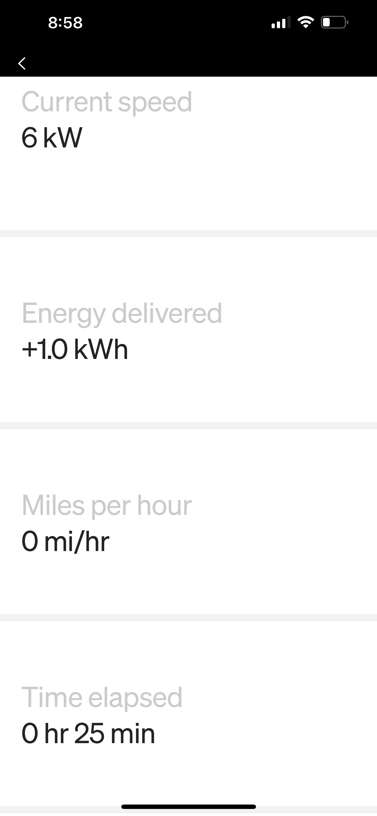

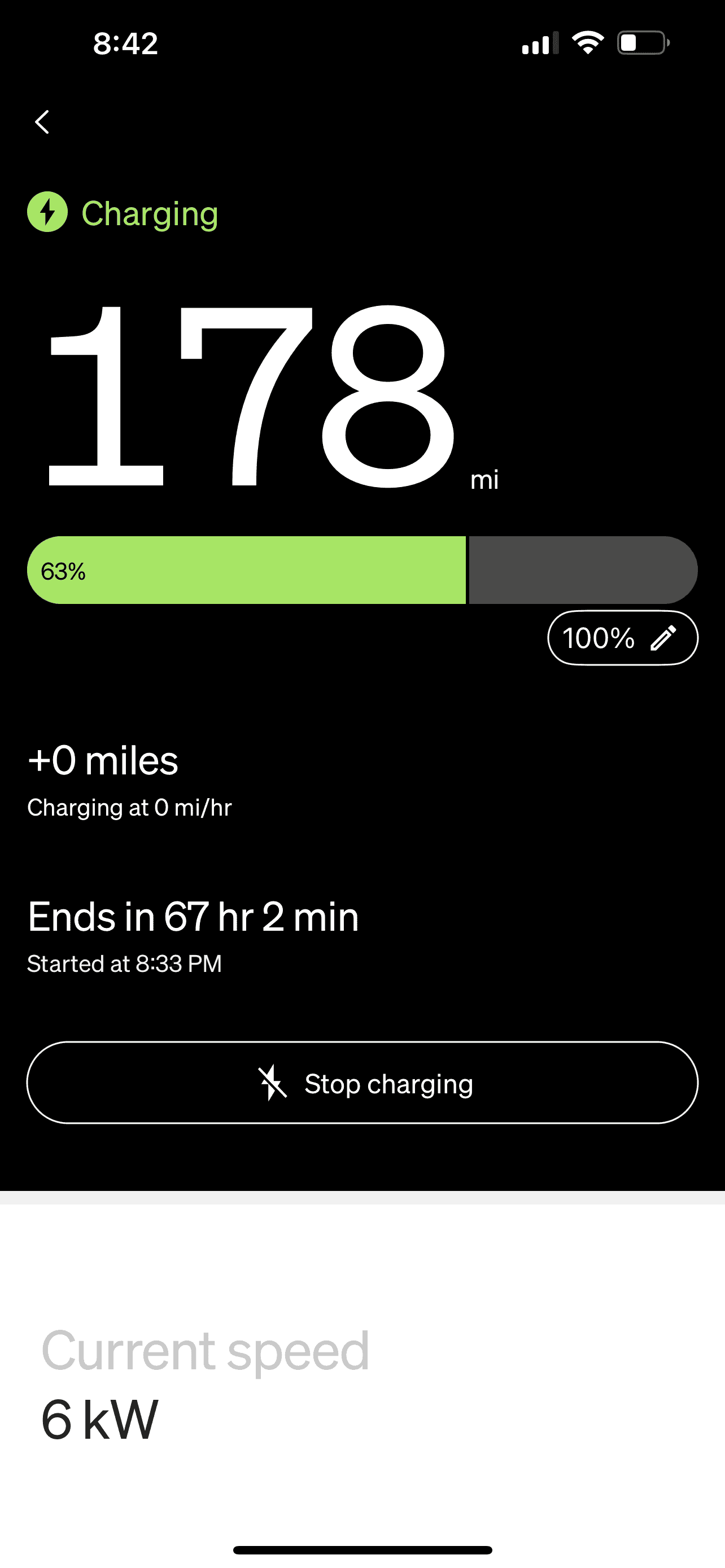

This happened to me couple of days back on a 6.6kw level 2 charger. Outside temperature was -4F or lower.

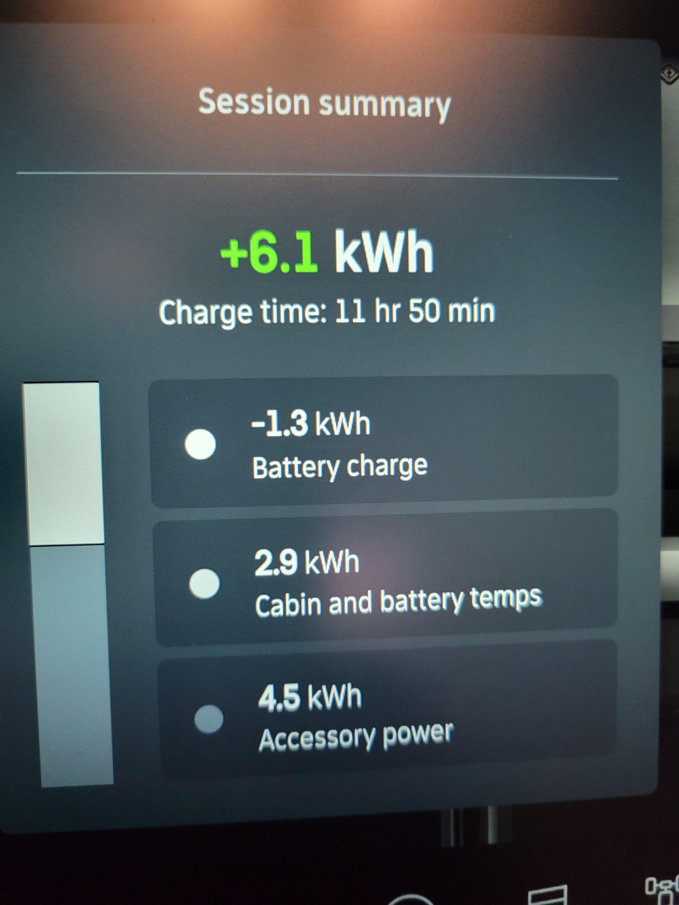

What do the session details inside the truck say about where the energy went?

Lithium batteries’ charging temp is 0C but use/discharge temp is -20C. So, battery heater has to work to heat it 20C more just to enable charging. So in such cold if you don’t really have access to any faster charging, maybe it’s better not to charge at all.
Btw, what are counted as accessories? Consumption for that seems really high!

That was the highest for accessories that I've seen. Nothing was on, no gear guard.

wow! spends all it's power trying to heat up the batteries! I wish I could get details on this

Try what I posted above. Turn off HVAC, music, turn on camp mode and select the all power off option on the right side of the camp screen. You shouldn’t be using anywhere near that much power for accessories or battery temps alone. Sometimes the truck seems to not realize there’s no one in it and keeps everything operating at full power rather than going to sleep. Doing the above steps tells it to turn everything off.
I have charged a number of times in temps close to 0° and mine doesn’t use anywhere near that extra power draw.
