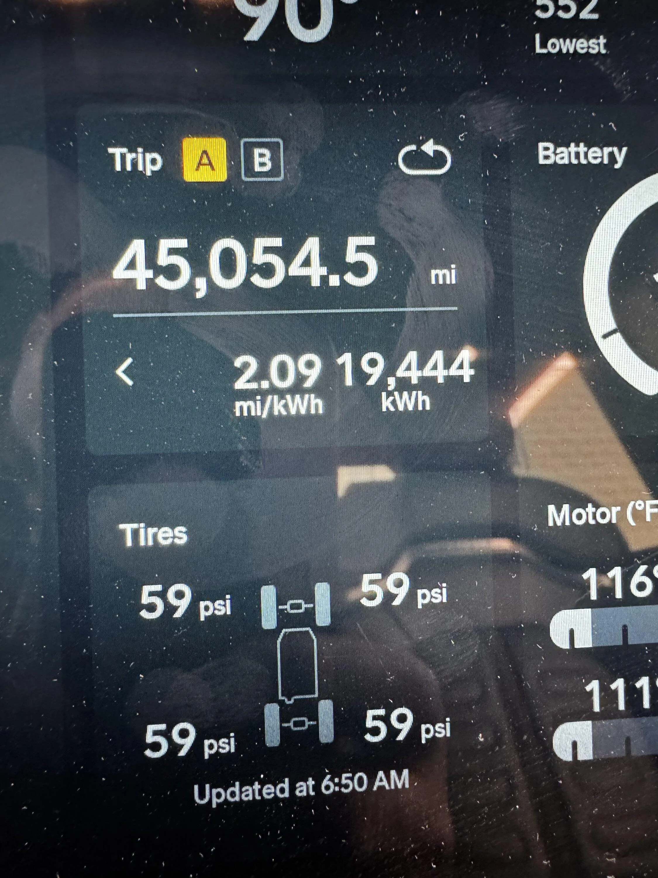

Am I crazy (no need to answer) or I can't do math anymore
Long story even longer:
replaced my Pirelli A/T's at 34,000+ miles with Bridgestone Revo 3's (don't really rock crawl or do highly technical trails so no noise and efficiency were the driving points on the purchase)
Didn't keep up with the efficiency during early ownership - also think it wasn't readily available on the main screen until late '23 or early '24)
I've always kept my app and truck software up to date with no issues
Since I got the new tires I am commuting from Chattanooga to Huntsville weekly
Don't have the home charging station installed yet so having to supercharge at EA and Tesla on the weekend
then L2 (90%) charging in Huntsville during the week to get back to Chattanooga on the weekends
Ignore the dust on the screen

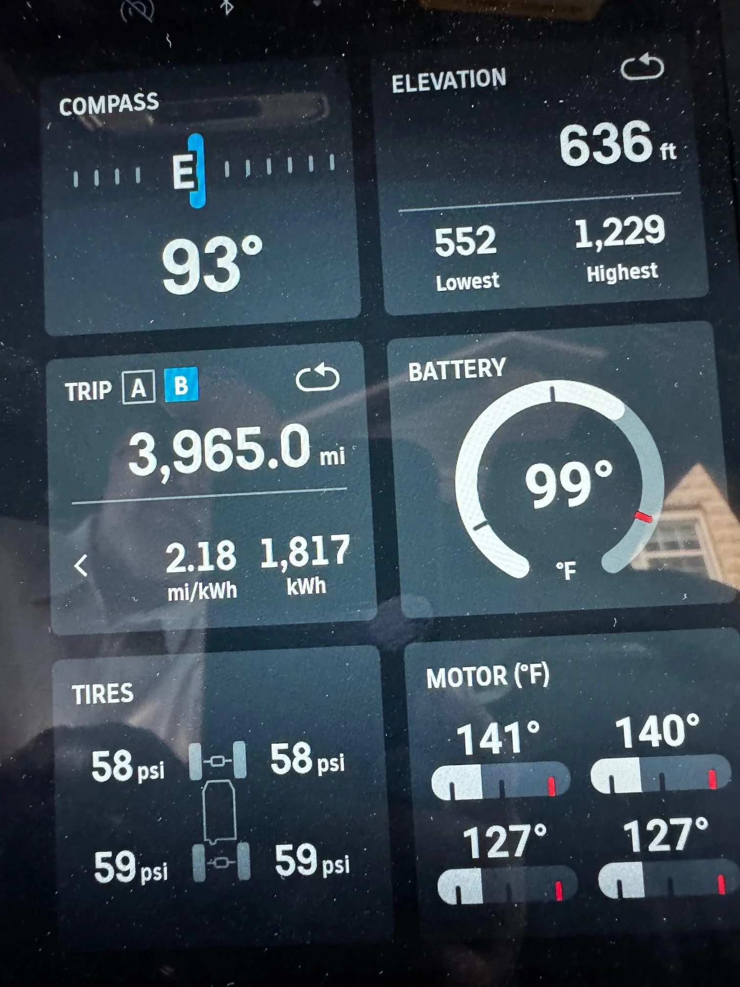

These are the efficiency pics at/near 4K on the new tires - 54 psi cold (June '24)
Rivian R1T R1S m/kWh question for the masses overall eff
Rivian R1T R1S m/kWh question for the masses new tire eff
Note the higher efficiency on "A" assumingly due to the smooth tread on the Pirelli's

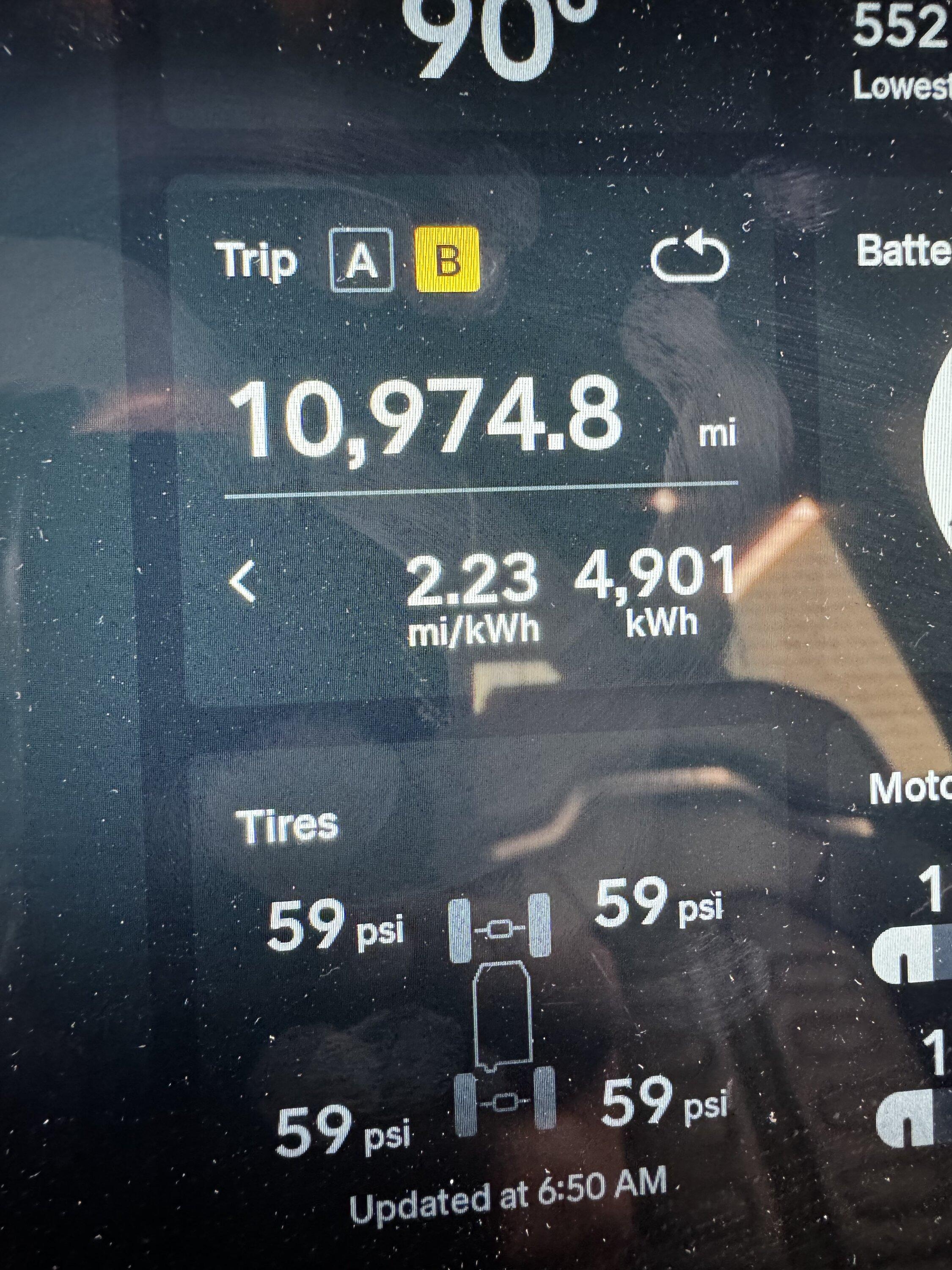

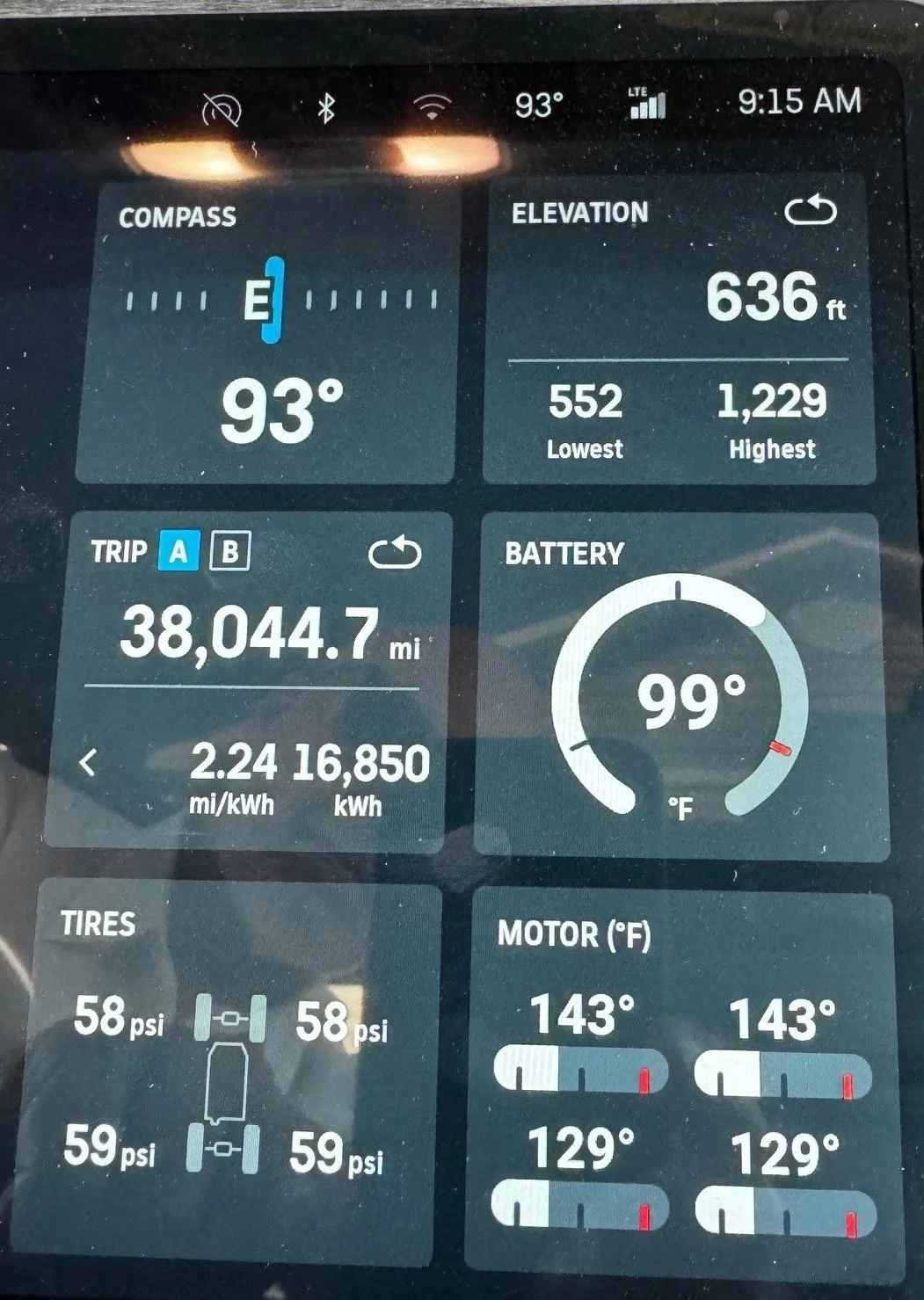

Fast forward to this morning - been running 58 psi cold:
Rivian R1T R1S m/kWh question for the masses overall eff 11-7.JPG
Notice the decrease in efficiency on my total mileage "A" compared
with an increase on the replacement tires "B"
Rivian R1T R1S m/kWh question for the masses tire eff 11-7.JPG
what am I missing not understanding here?

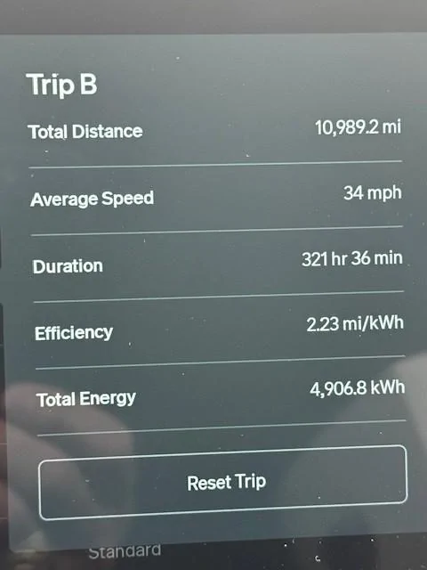

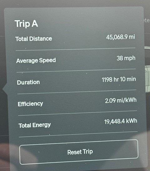

can agree with all you said
my efficiency went up as the Pirelli's got real worn in the last few weeks of their lifespan
Revo's show to be getting better with mileage also
but here is what I am looking at
m/kWh*kWh=miles +/-some inefficiencies in charging, auxiliary needs, drain, etc. = true miles travelled
third pic is way off
2.09*19444=40,638 -----> 45055
that's right at 10% loss
pics 1, 2, and 4 are within 1%
I thought at first it might be high use of the superchargers or driving habits but it should show up in pic #4 also
might not be anything but still wondering

I just can't wrap my head around the increase in EFF over the 11K (B's) vs the decrease in lifetime (A's) and the lifetime (A) being 10% off when everything else is within 1%
was just curious if anyone else was seeing random figures

Well, it doesn't math. 45054/19444=2.32, not 2.09. Can you pull up the full trip screen in settings and send that for A?
Same issue/numbers
might try a soft reset
Rivian R1T R1S m/kWh question for the masses A
Rivian R1T R1S m/kWh question for the masses B
