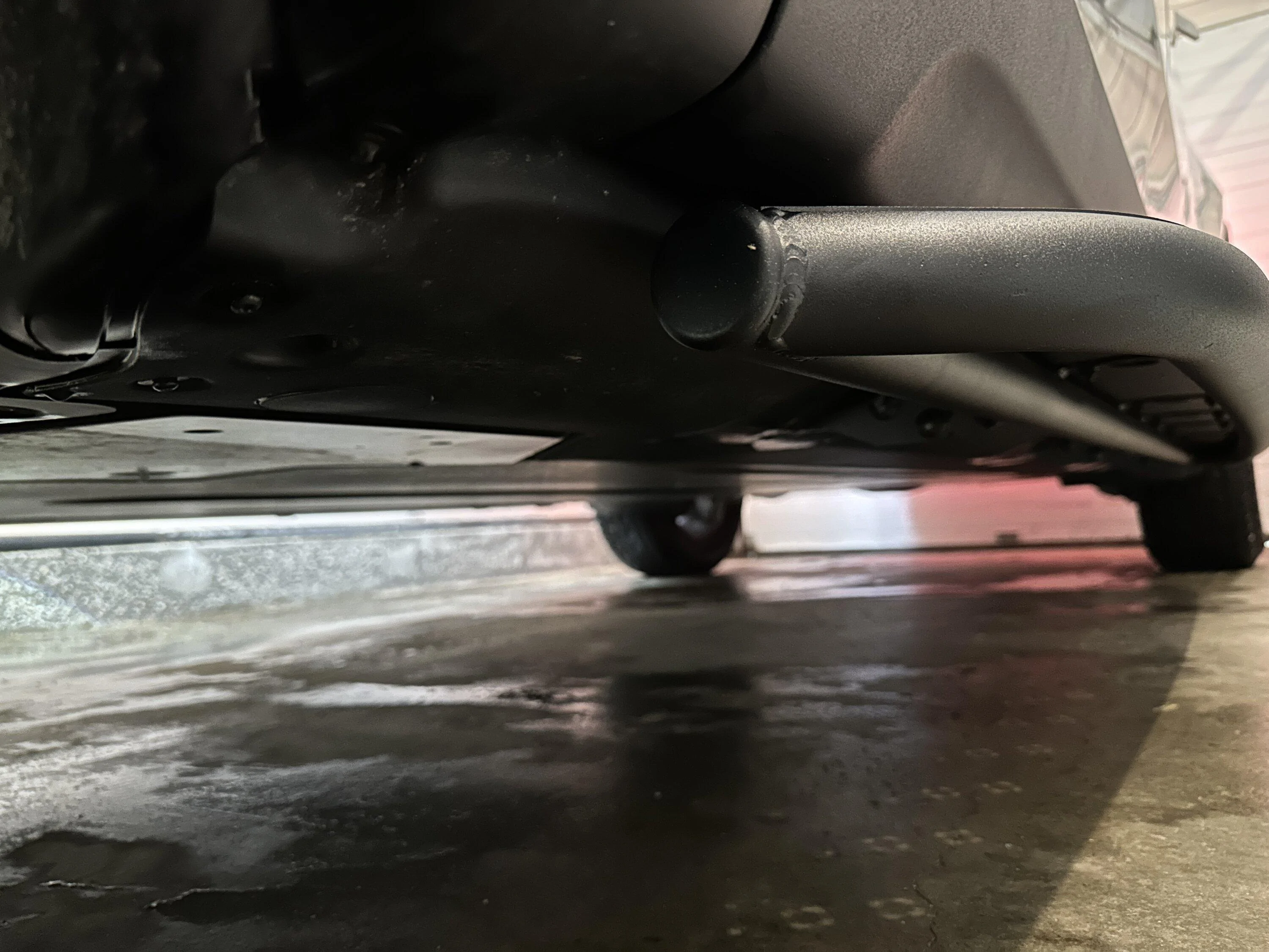

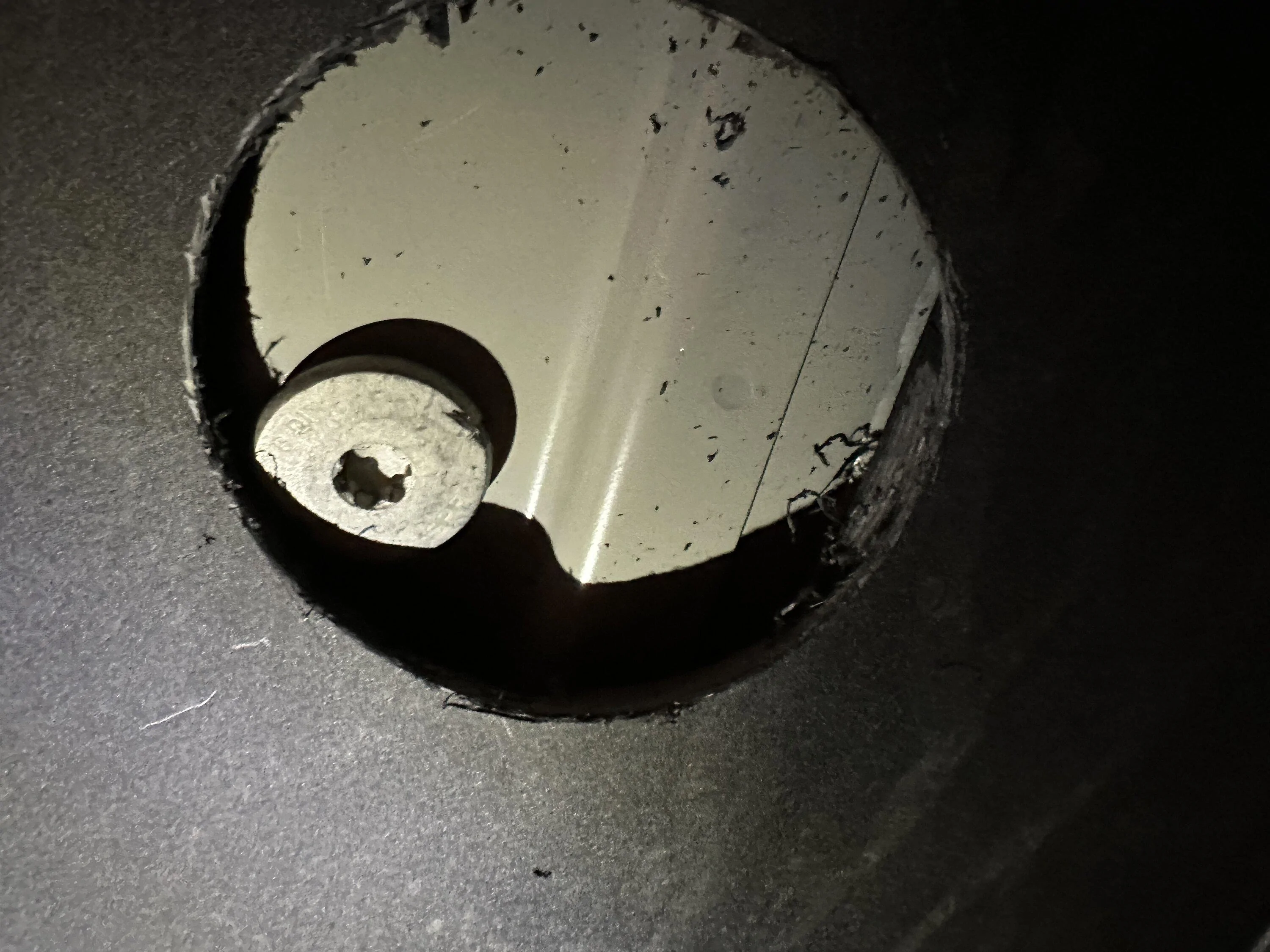

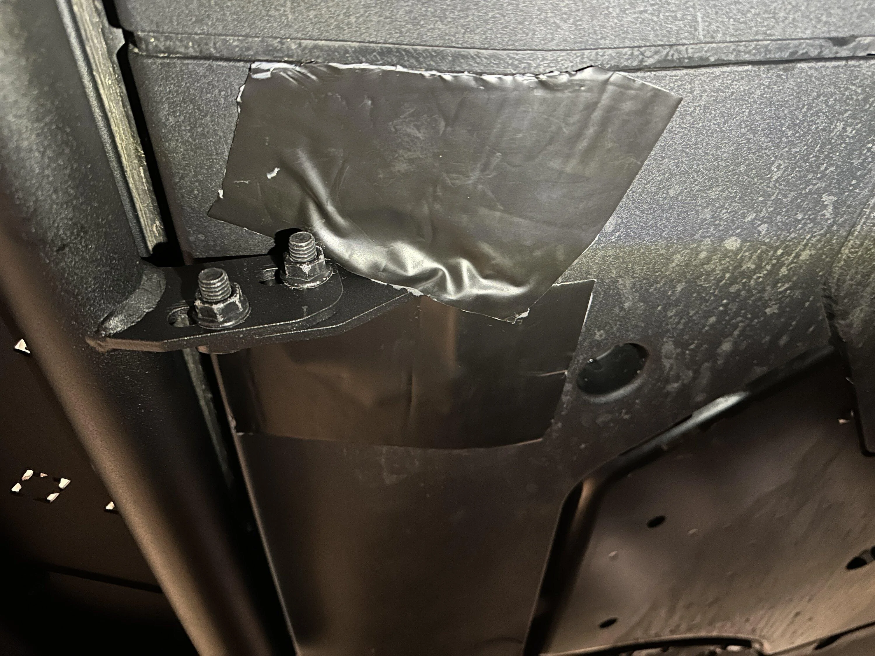

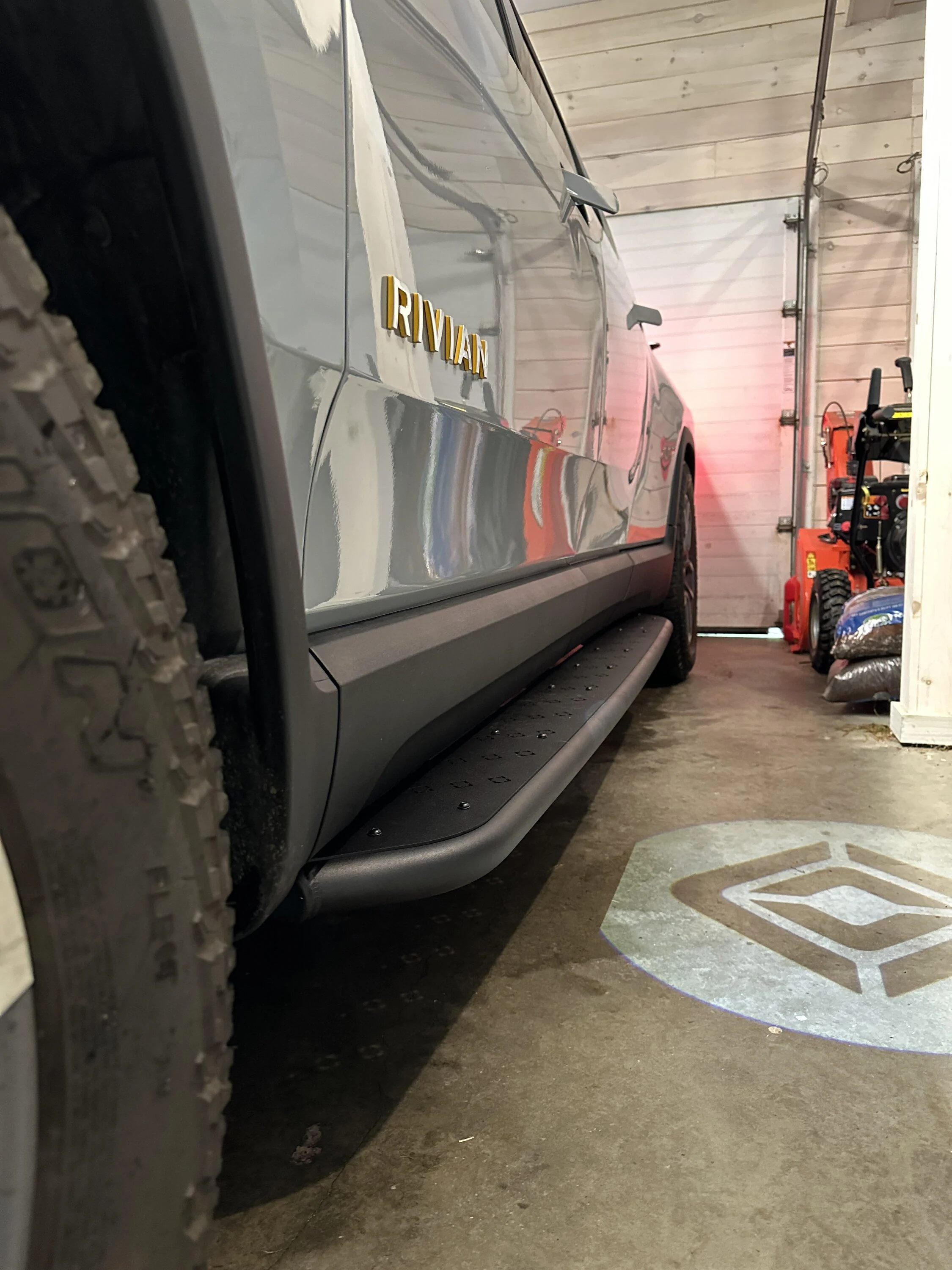

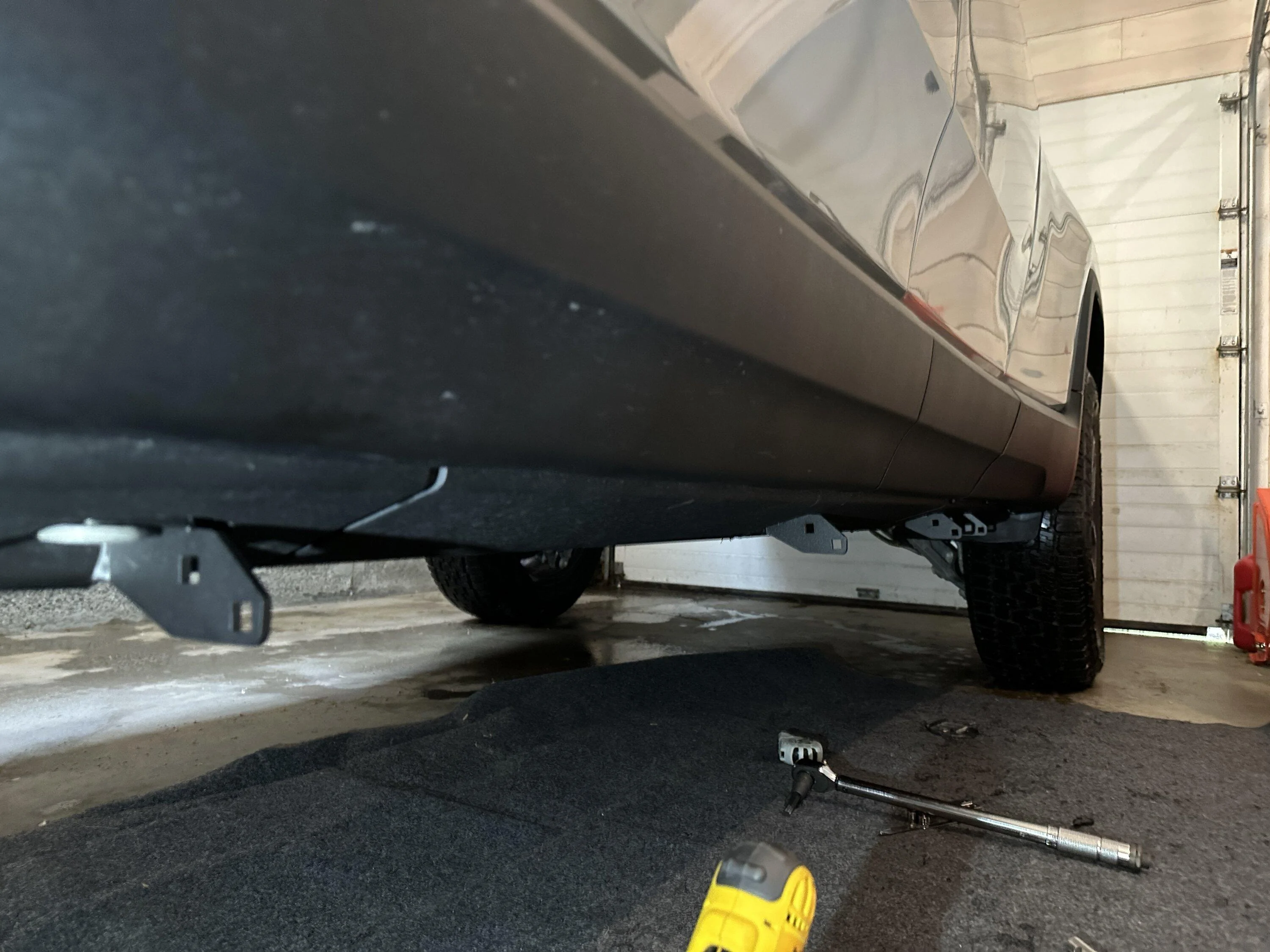

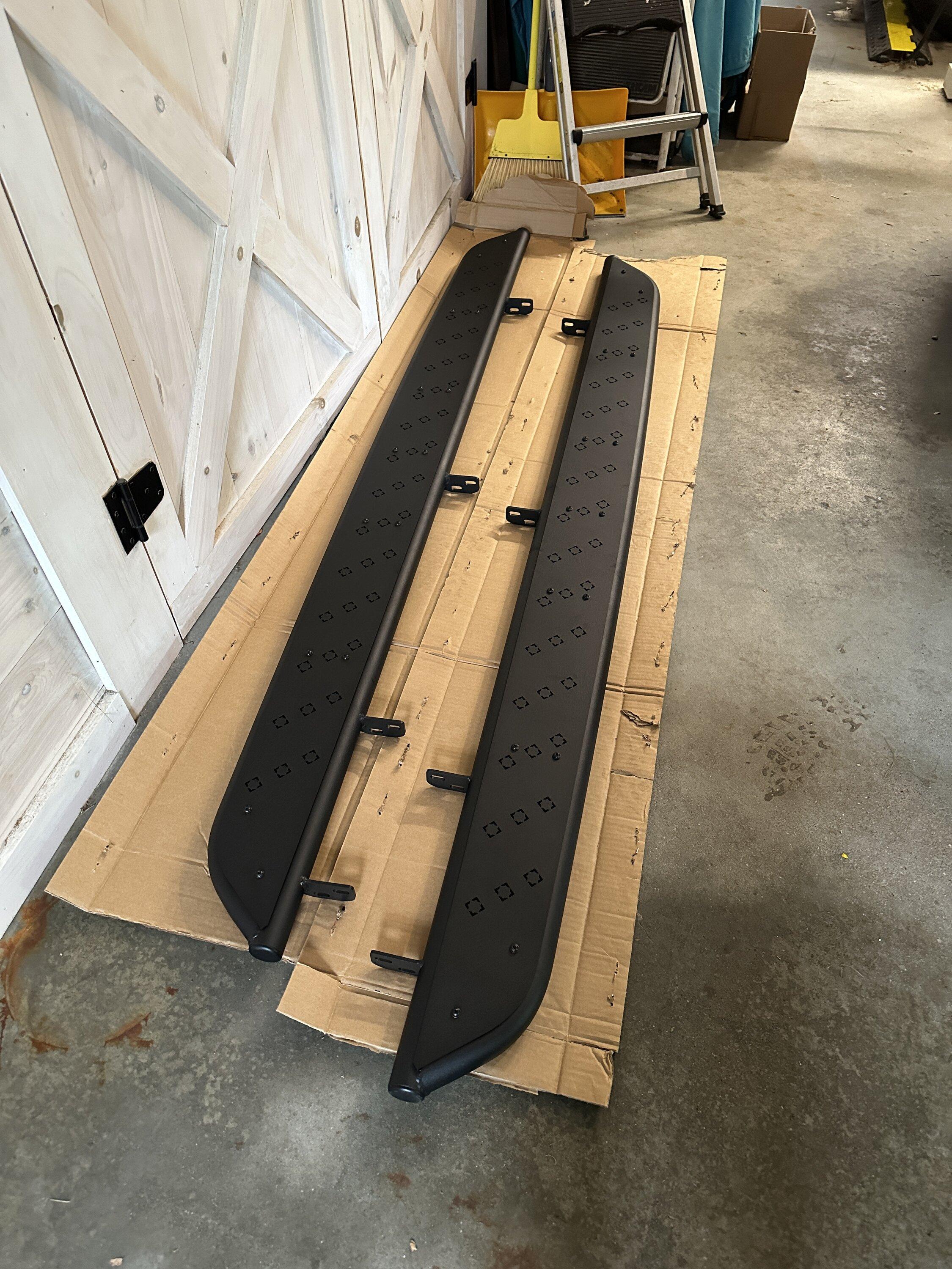

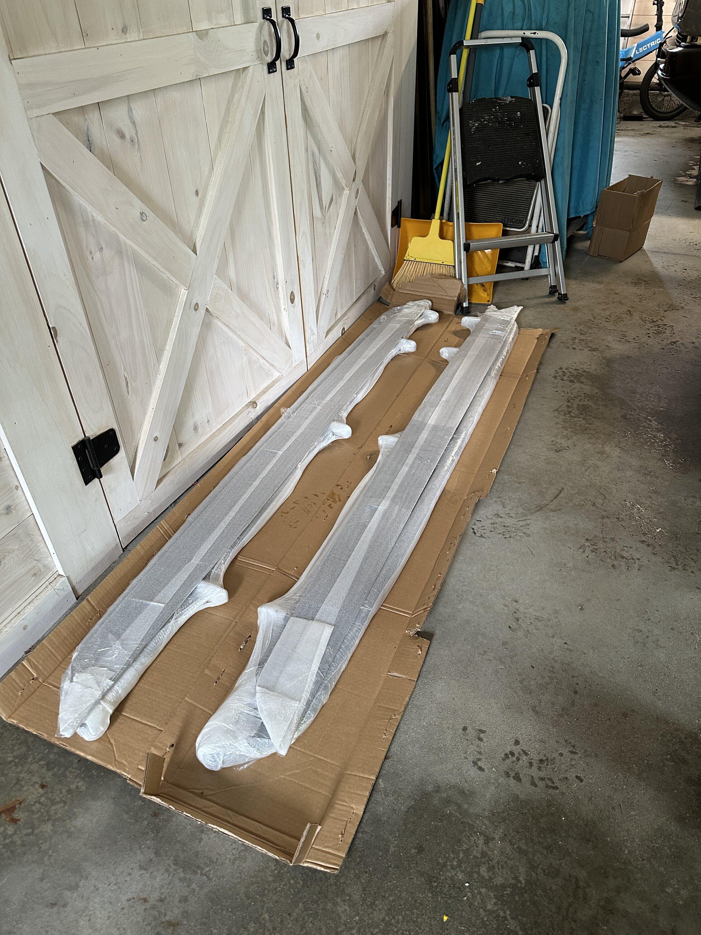

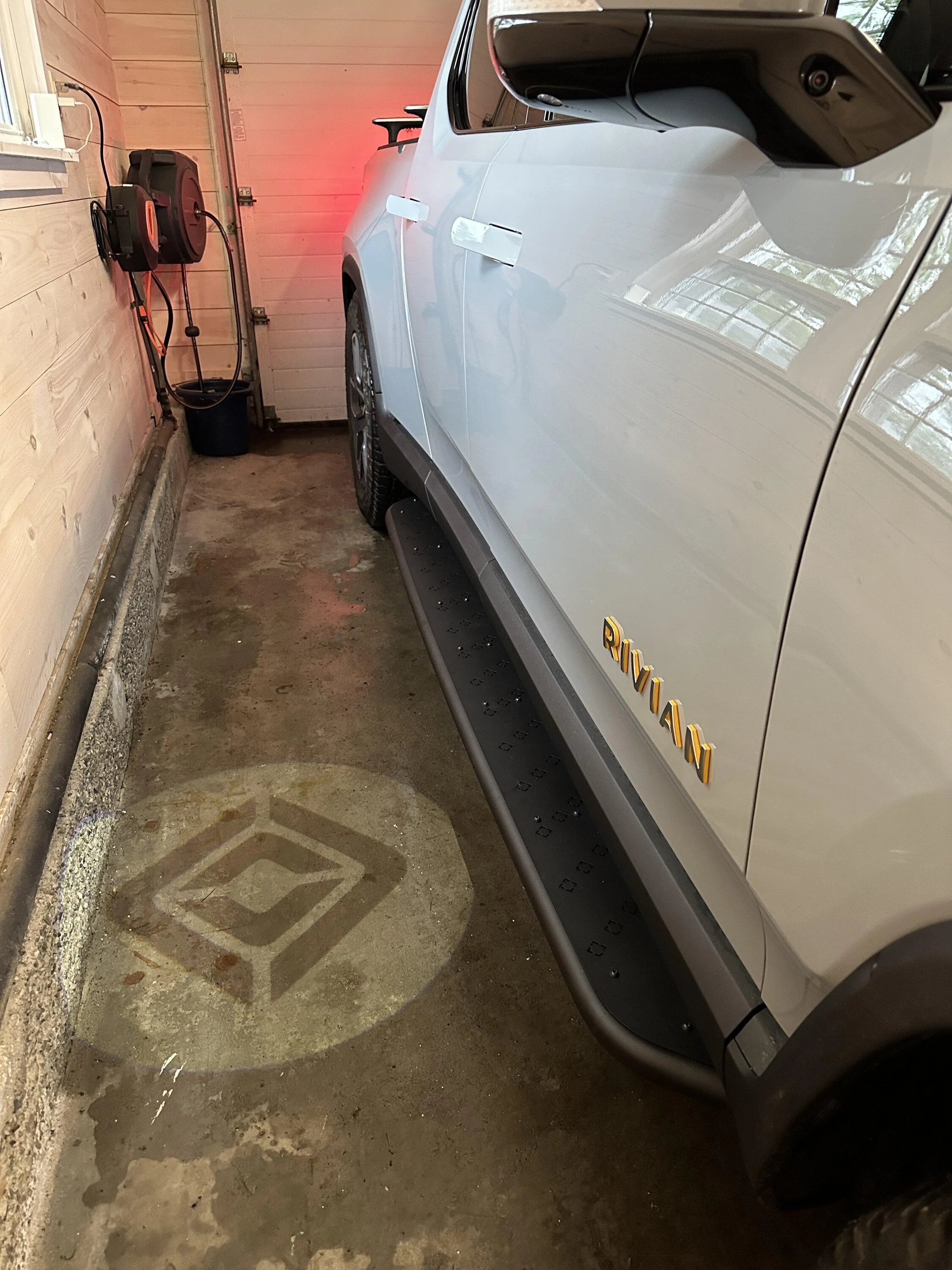

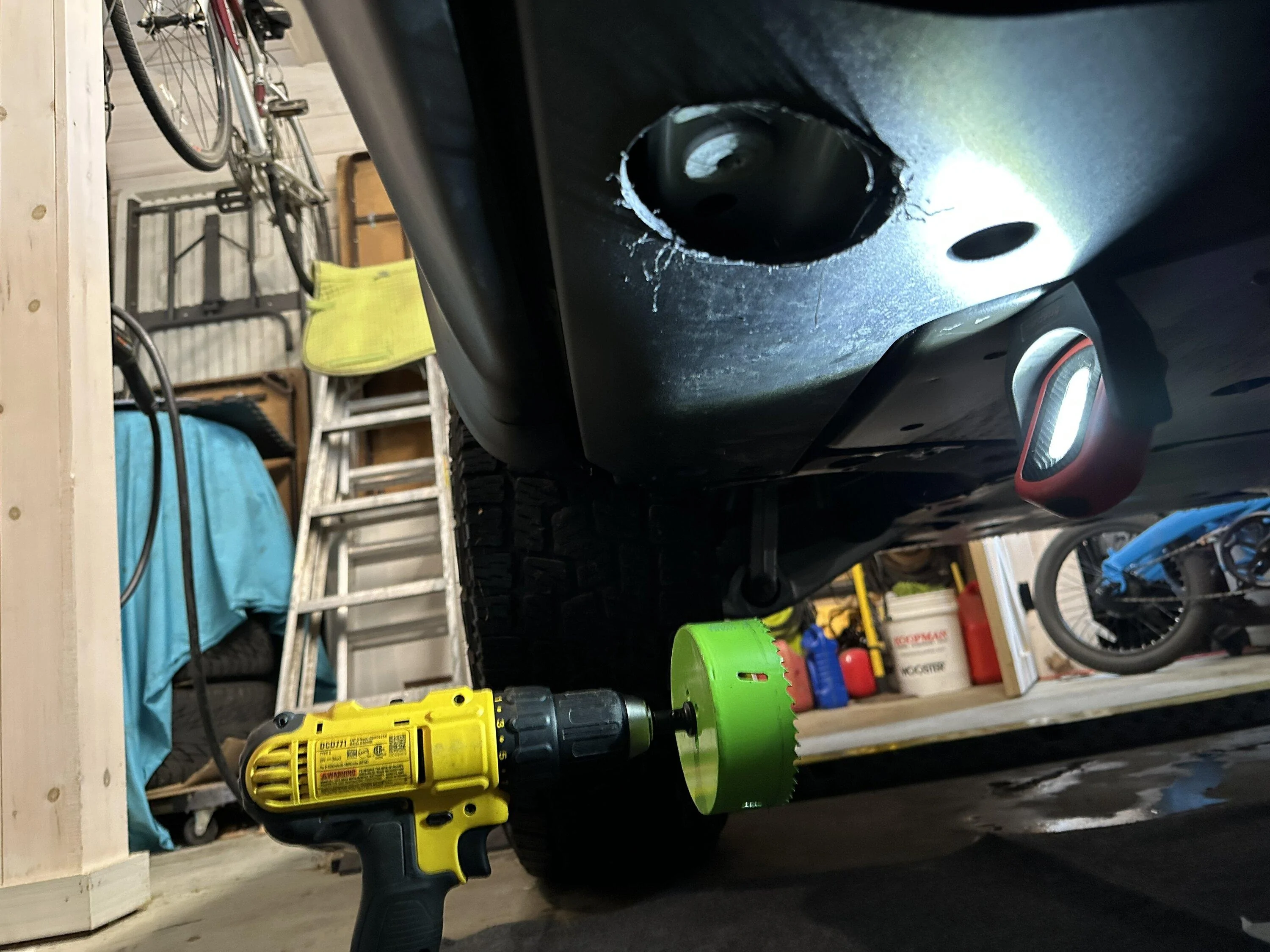

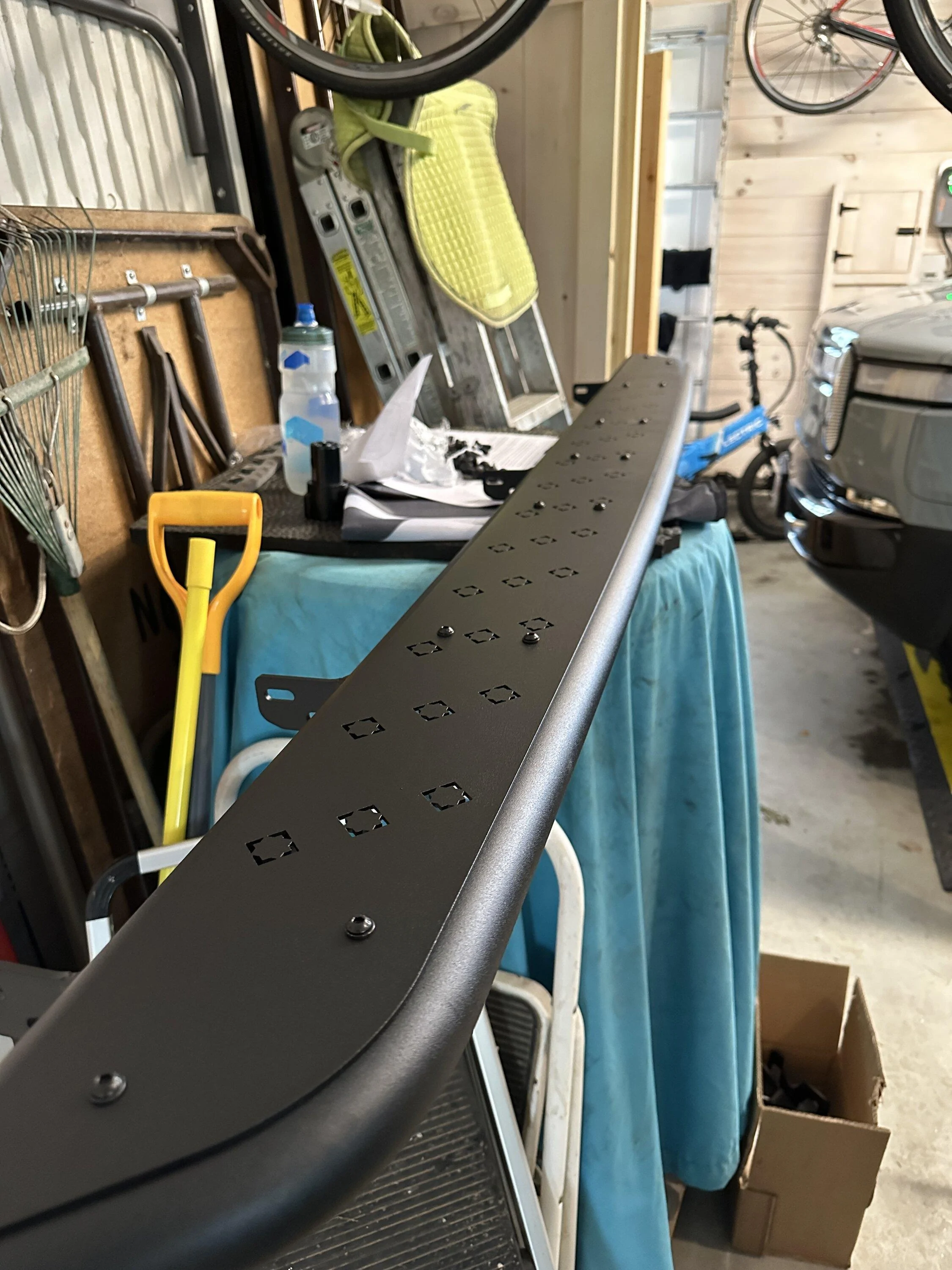

I got my @EV Sportline running boards today and installed them. Only 1 finger damaged and that was just during the unpacking and I cut it on the many staples in the boxes. The boards are well packed.
They came with 2 bits, the Torx Plus TP55 which worked, the other was supposed to be a T20 Torx but it didnt fit the screw heads that attach the plate to the running board but I had something that worked.
The instructions are decent, only confusion was they point to a video which no longer mentions the circular cut approach (and it being the preferred method) as they did before, yet the next video (templating) covers the round hole approach.
I was slightly off on the middle hole of the first side (picture below) but not enough to be a problem. I trimmed it a bit with my knife. I did tape up the holes afterwards but didn't do nearly as clean a job as others did. The whole thing including washing the truck, sweeping the garage, cleaning up etc took 6 hours. I'm nowhere near handy at this sort of thing. If I can do it anyone can.
Some learnings:
  1. My impact wrench is a DeWalt 20v. I had to use an adapter to a socket to get the TP55 attached. The adapter snapped after the second bolt. Would have been nice to have that the whole time but wasnt the end of the world but my arms were sore by the end as everything was manual.
  2. On the first bolt, I tried to loosen the wrong way (doh!), double check your directions. I slightly stripped it but not enough for it to matter. Still got it retorqued to 80 ft/lbs
  3. I did this all solo, you can hang the boards on the holes closest to the truck one end at a time. I'm not big or super strong and this wasnt a problem. Made the install easier.
  4. I didn't have a torque wrench for the smaller items like the plate top screws (8 ft/lbs supposedly) or the bolts for the running board (35 ft/lbs supposedly). I just had the torque wrench for the frame bolts using that TP55 bit. I had purchased the torque wrench (my first) just for the frame bolts. Dont know about others but I dont have all these 1/2" sizes, torque wrenches and adapters hanging around. I spent $100 on tools based on the instructions when I ordered the boards and they got me through.
  5. Even if I had a torque wrench for the running board bolts, the angle there against the plastic underneath doesnt lend itself well to big tools.
  6. There's measuring on 2 points on each side with a tape measure. It wasn't hard and i'm terrible at it, so that was a relief
  7. Once you mark the drill spot, I took the 4" hole saw head off and drilled the hole and then put it back on and used the hole to find the mark. With a pin prick there's no way I would have hit the same spot with the lack of visibility etc otherwise
  8. The plastic from drilling all those holes gets everywhere, be careful
  9. Good light, ground cover, and patience are all needed.
  10. I taped the holes good enough for me. That tape is super sticky and seems like it will hold up. I just didn't want 8 gaping holes collecting crud even if it was ok for the truck.
  11. Very happy with the quality of the product and it made a huge difference for my wife being able to get in and out so it 100% met the needs.
  12. Anyone close to them and can take advantage of their $199 install. DO IT.
Now some pics.
Some learnings:
Now some pics.
Great review and thanks for sharing!
(TP20 is for removing the plastic panels, you don't use that TP20 if drilling 4" holes)

@the_mace, good write up. I've been doing this sort of stuff for 30+ years but it still took a good bit of time. One thing I noticed before drilling the big 4" is that some of my plastic panels were not aligned the same way, left side vs. right side so I spent another 30 minutes rechecking and correcting to avoid misalignment later.
I might have the same Dewalt, it's a half inch drive. Those TP55 bolts are really in there, you definitely need all your adapters to be rated for impact!
Good advice about drilling the center holes first before plunging in with the 4" saw. This also makes the hole cut smother because you are not fighting the center pilot bit as it tries to pull inward.
The tape is messy. I wanted to do this differently, but in the end, it came out fine. I haven't looked down there since...

The Dewalt definitely isn't half inch. Not sure what it is. But I was only using it after using the breaker bar to loosen the bolts and the adapter still broke. I'll have to look into it. Never used the impact wrench before, came in a kit. None of this is my world. Give me a keyboard and i'm dangerous. Give my tools and i'm bleeding quickly.

I did see the grommet approach. At this point I dont think that tape is coming off for anything and i'm unlikely to look down there again. For me good enough. If the tape doesnt hold up (i'd be surprised) i'll maybe look at another way.

So if you don't tape it, how far does crud go under the plastic panels? Is gorilla tape the only way?
Not sure but it’s bound to collect. Figured some tape (even if poorly done) should help

Yup, my wife is 5' and she was getting in there but not easily and was driving something else as it was easier. This was huge for her. She's off at a horse show now with it.

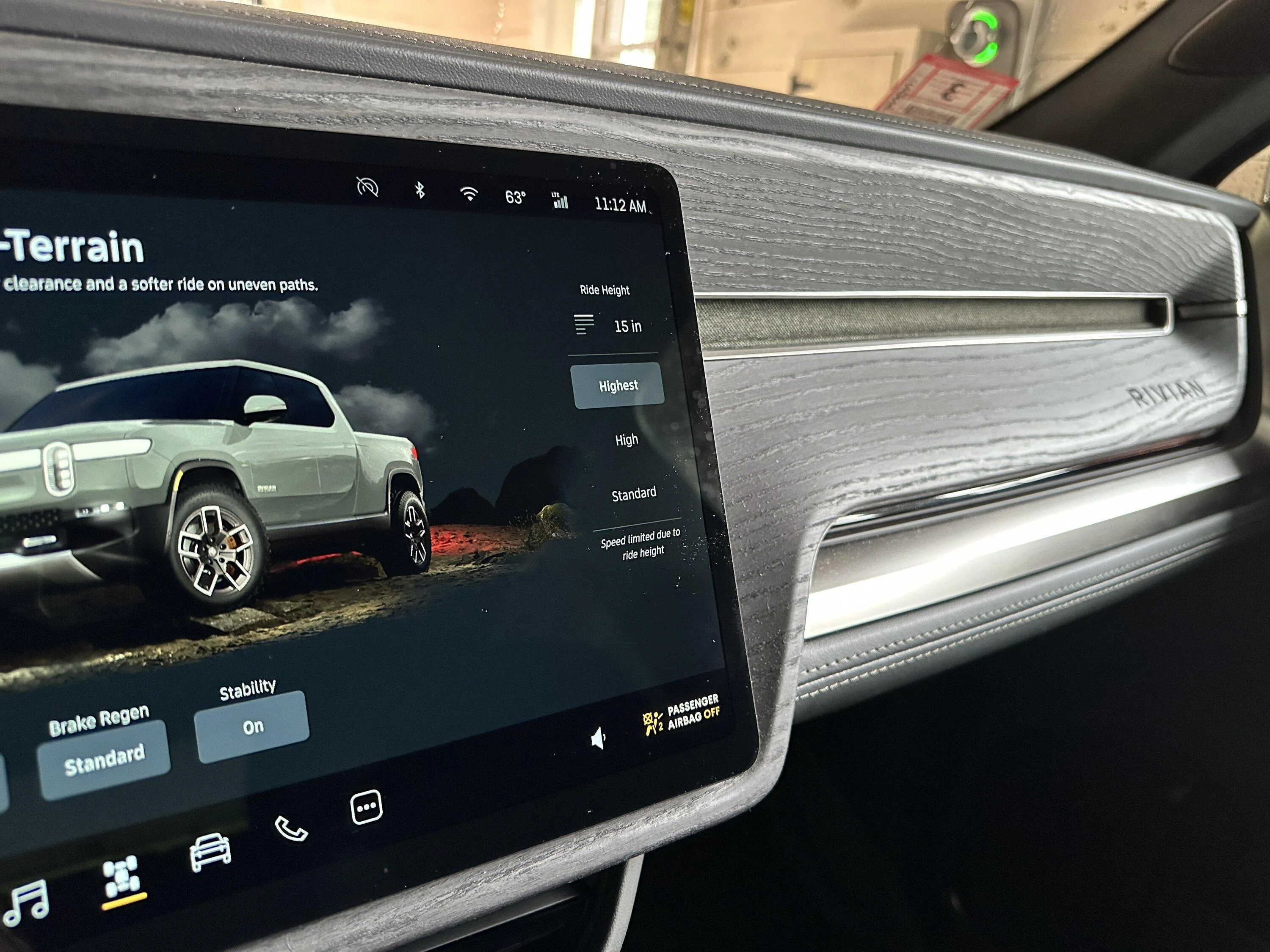

One more thing I noticed last night. I have the boards extended for max foot space but I noticed that the puddle light gets clipped by the running boards. Not the end of the world but wondering if it’s not clipped if they’re pushed in. I don’t want to test by loosening 16 bolts so if anyone already checked this please let me know. I haven’t seen this mentioned anywhere.
