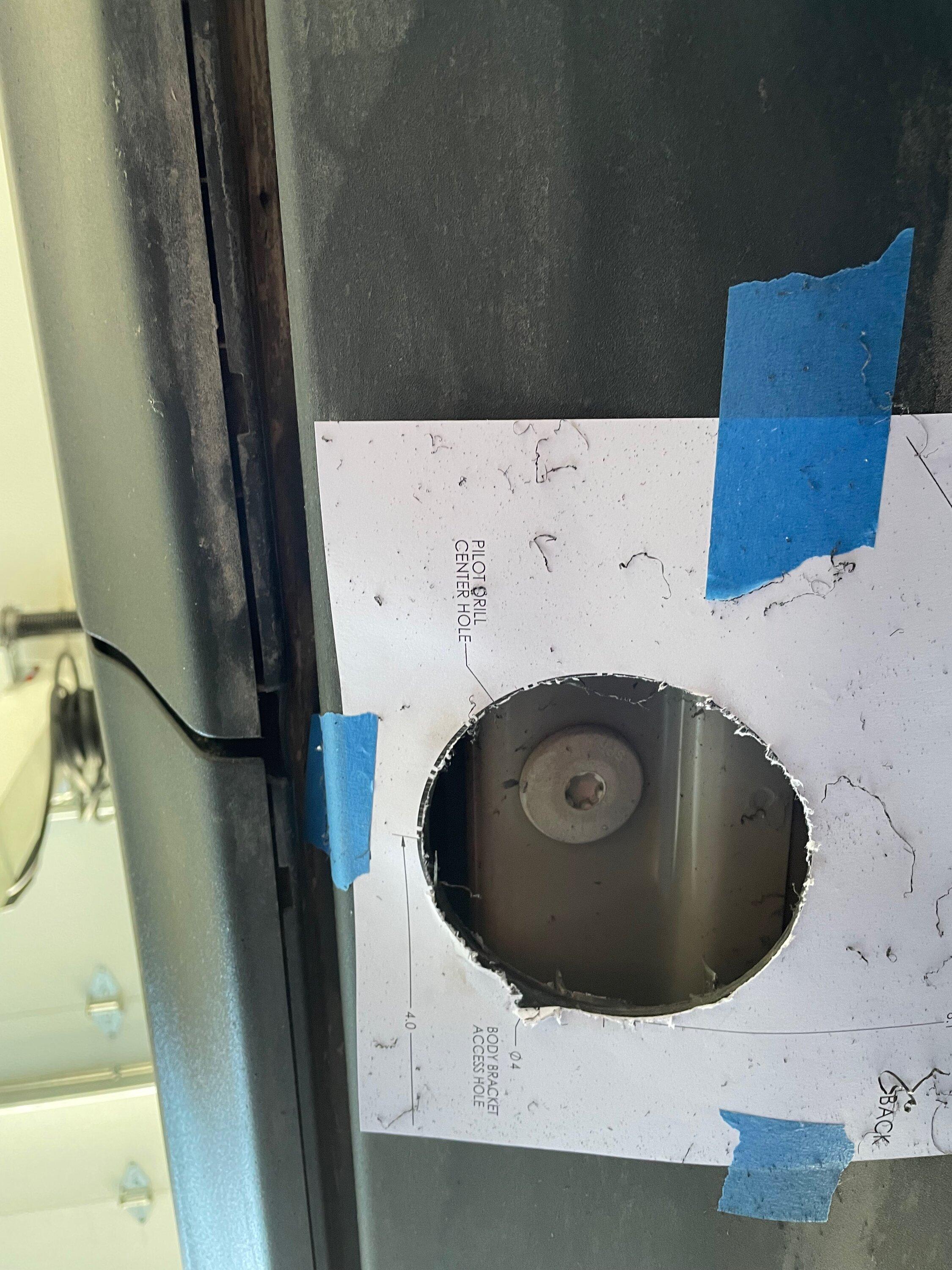

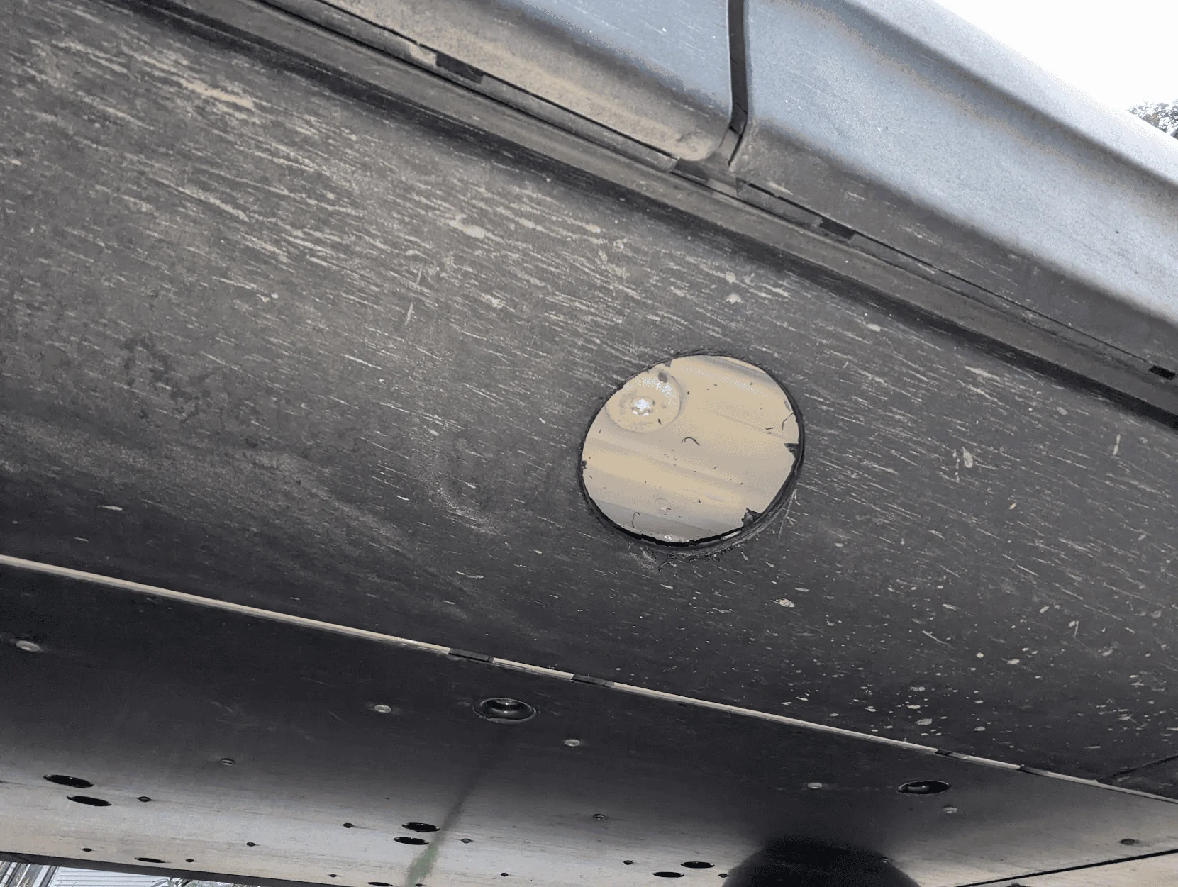

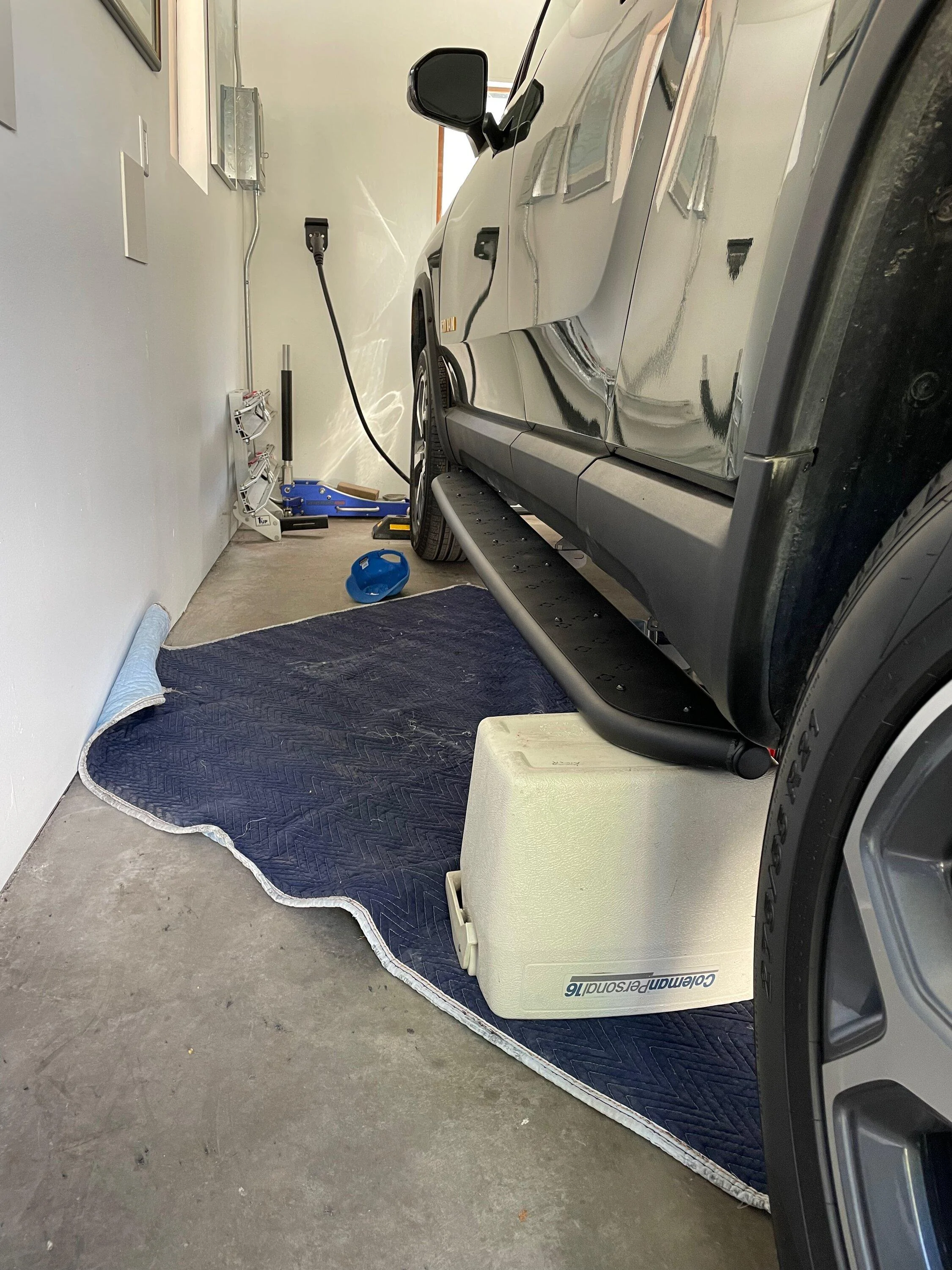

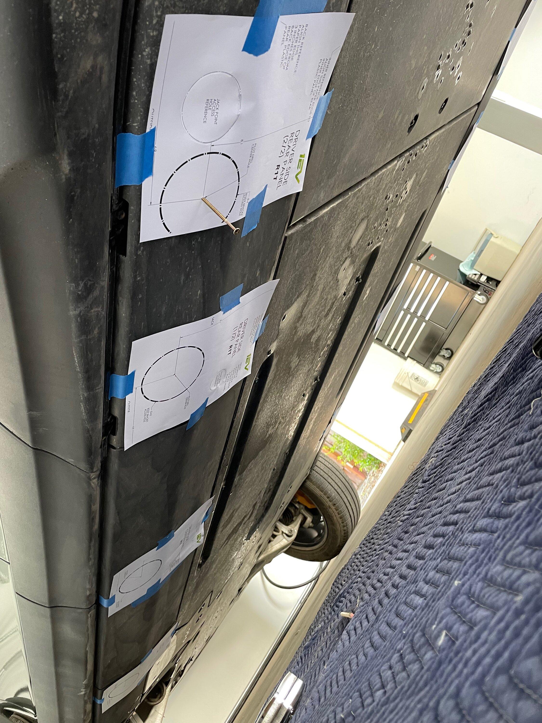

Running boards installed today. Took 4 hrs, from unpacking to assembly to final mounting. Also another hour or so yesterday to clean the underbody panels and mark the 4" hole locations.
A few tips and lessons:
  1. Clean the underbody panels before you do anything else. I used a pressure washer on the underbody, which turned out to be easier and more effective than the brush and soapy liquid I started with.
  2. I taped the templates to the underbody to mark the 4" hole locations (see photos). Then I drilled 1/4" pilot holes thru the templates, and cut the 4" holes right thru the templates. This made it easier to start the pilot bit on the hole saw in the precise location.
  3. Wear safety glasses when cutting the holes - black plastic from the body panels flies all over the place.
  4. No problems getting the big frame bolts off using an 18" breaker bar.
  5. I did the install solo, which was pretty easy until time for mounting the running boards to the brackets. You can't really mount the boards without them being level to the ground, so starting on one end or the other was problematic. You could probably find a way to hold up the (35 lb) board and start with the center bracket, but that seemed too clumsy. I used a small cooler to support one end while starting the bolts at the other end. Worked great - see photo.
Very happy with the results. Quality product, well thought out and engineered. They look great and are the perfects steps for getting in and out of the truck.

How was install? I did holes on one side and the R1S template seems off for the center hole (I think its like 20.5 or so instead of 20. Still have access to the screw just slightly off
The one I did was not that much off. Did you use the downloaded template with the panels not removed? I measure it very carefully from all sides and taped it up before making the holes
Yeap R1S template putting with OUT panels removed (installed on car). measured exactly for the middle panel, everything else worked great.
Maybe it could be a little off too. I was too worried about stripping the screw more than anything. Whatever holes I cut , I was able to slipped the brackets in no problems. Right now , I already taped the holes up with gorilla sealed tape. The hole with the overlapped jack point doesn’t look good with all the taping since I need to expose jack point hole for future use
