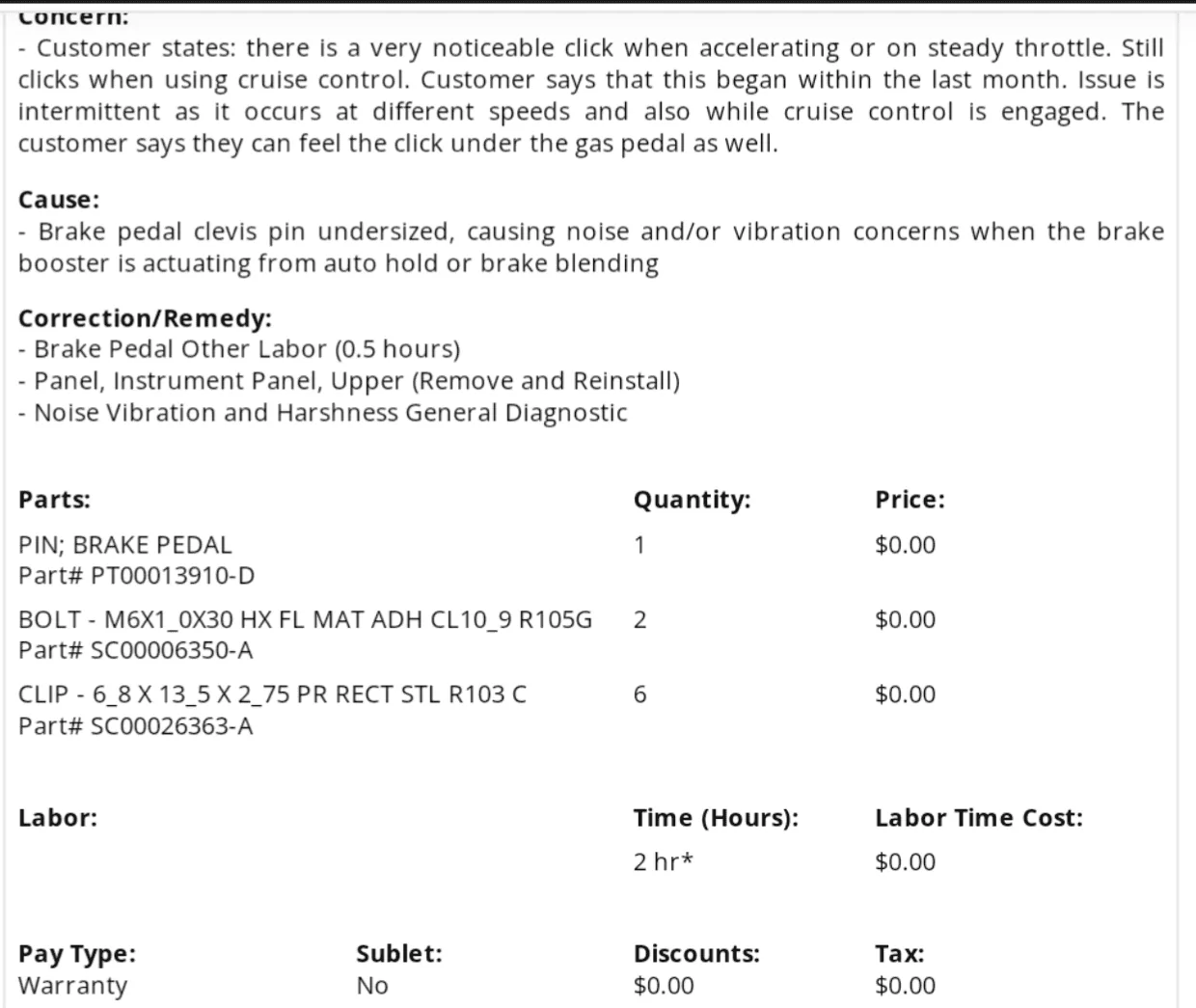

Here's the invoice description for the clicking issue.
Thanks. This is really helpful. I’m going to mention on my ticket. I’m getting the same noise.
